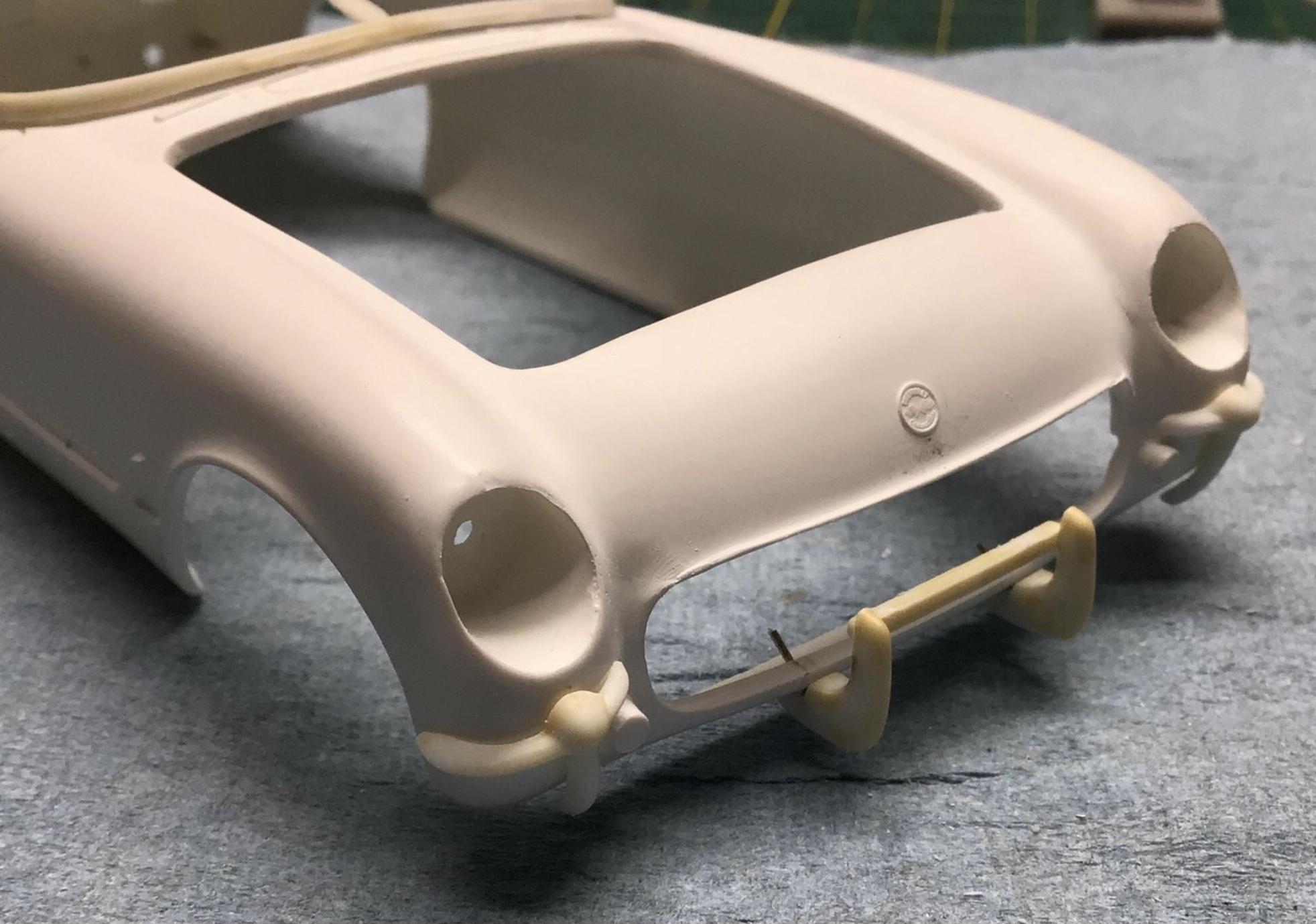

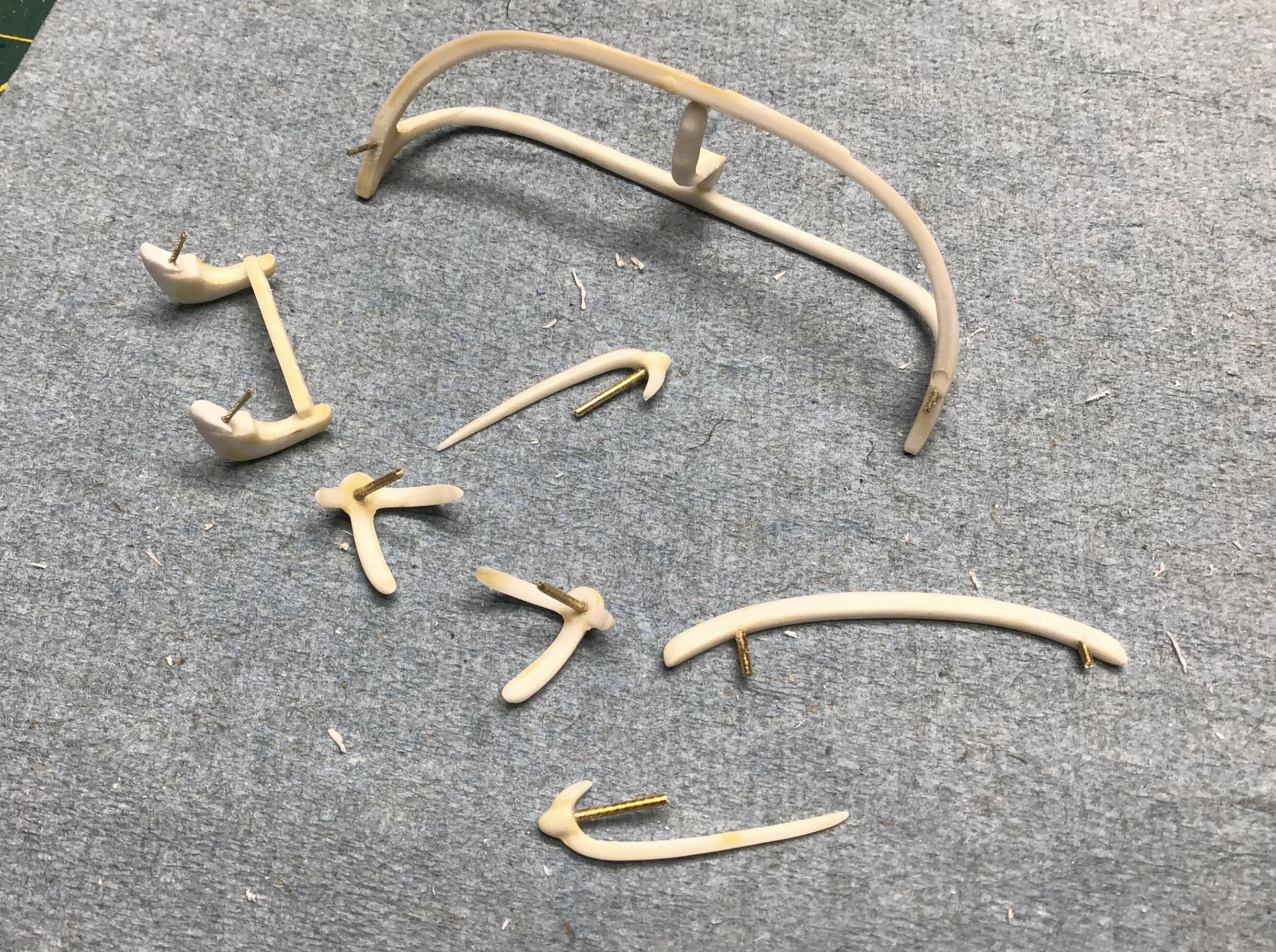

johnyrotten Posted August 30 Posted August 30 With things like door mirrors I pin them. A small locating hole in the body, and I bend the wire over and glue or epoxy on the back. No risk of wrecking the paint. 2
Chris V Posted August 30 Posted August 30 Nothing surpasses pinning the parts with piano wire for precise positioning and alignment. Whenever possible I slightly bevel the edge of the hole with a small mill bit to create a small deposit for the glue so it doesn’t ooze onto the surrounding areas when the parts are joined. 4

NOBLNG Posted August 30 Posted August 30 I also like to pin tiny parts. Even large parts like bumpers and seats. You can use any relatively rigid wire for pins. I like to use 0.020” brass. It cuts easily with my cheap nippers. For tinier pins I have some 0.010” and 0.015” Phosphor-bronze wire that I got at a model railroad shop. 3

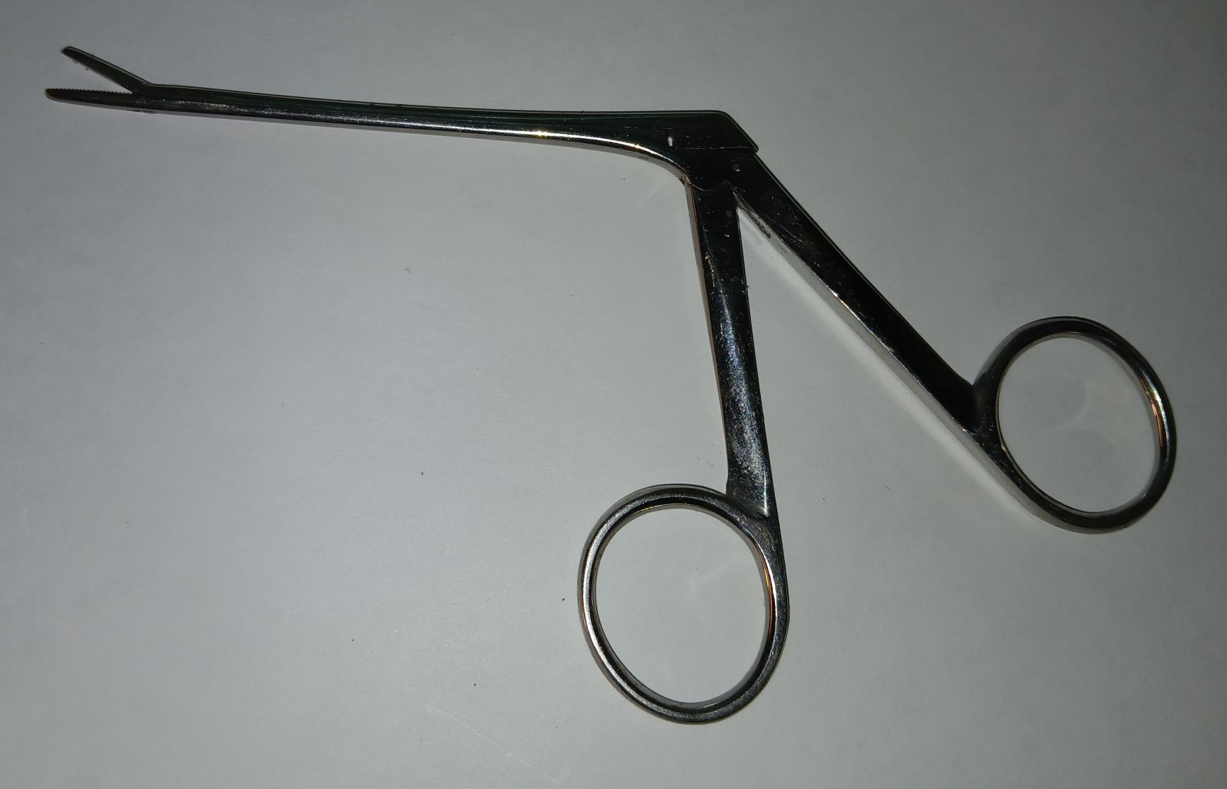

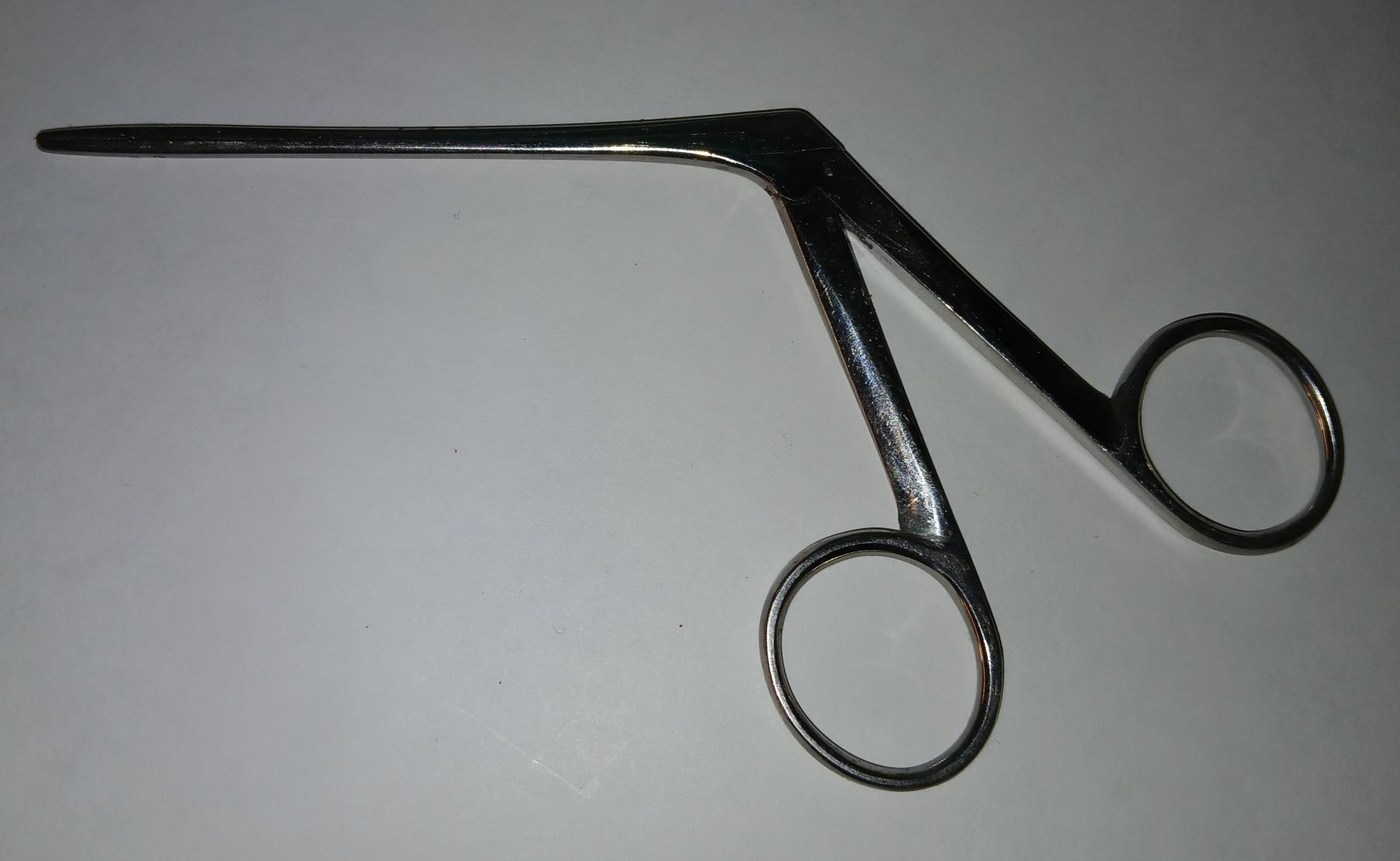

Big Messer Posted 5 hours ago Posted 5 hours ago (edited) I also have this thingmajings (don't know their proper name) that I got at Harbor Freight. Great to pass a little piece thru a hole inside an enclosed assembly. Edited 5 hours ago by Big Messer
