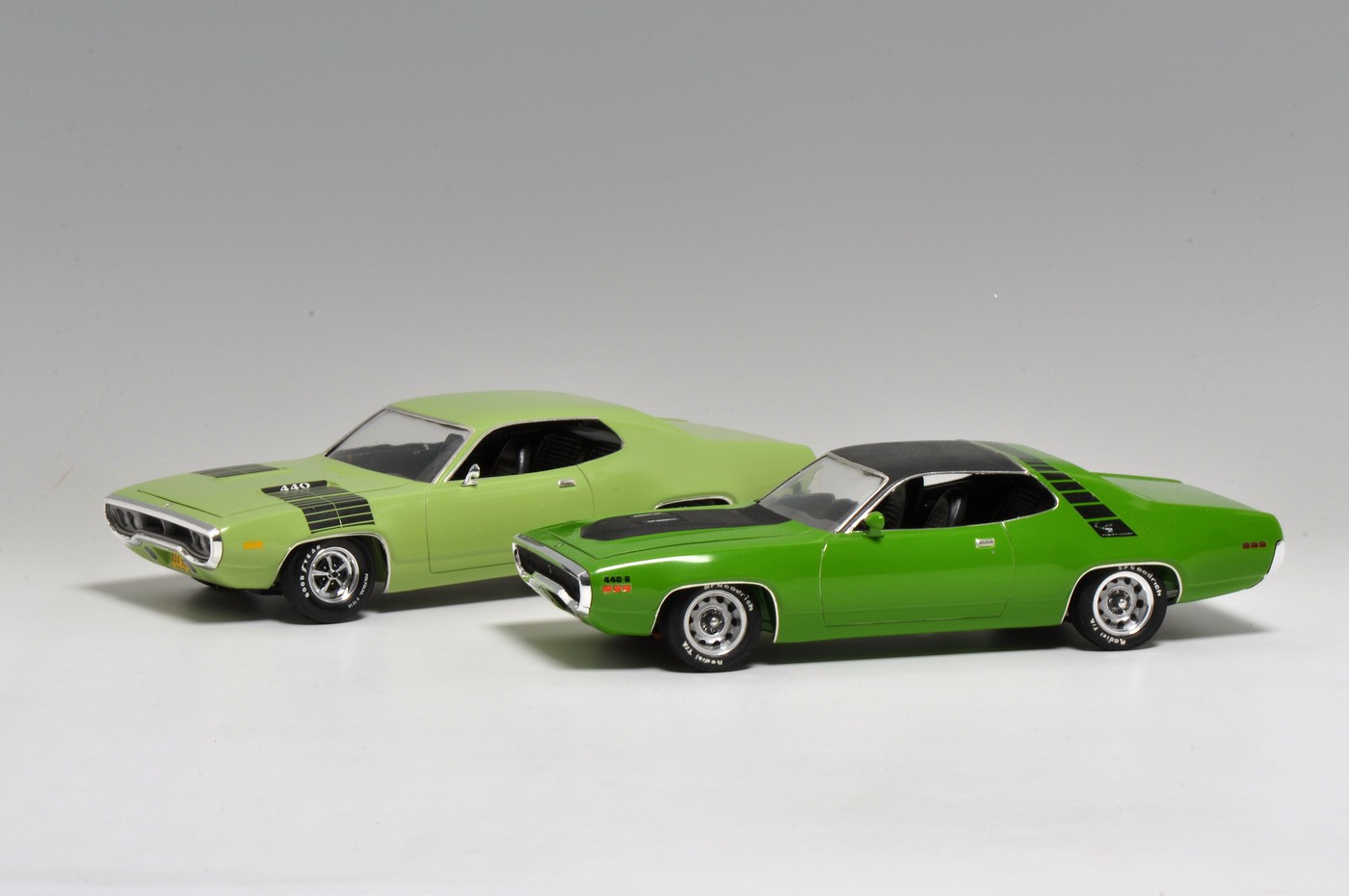

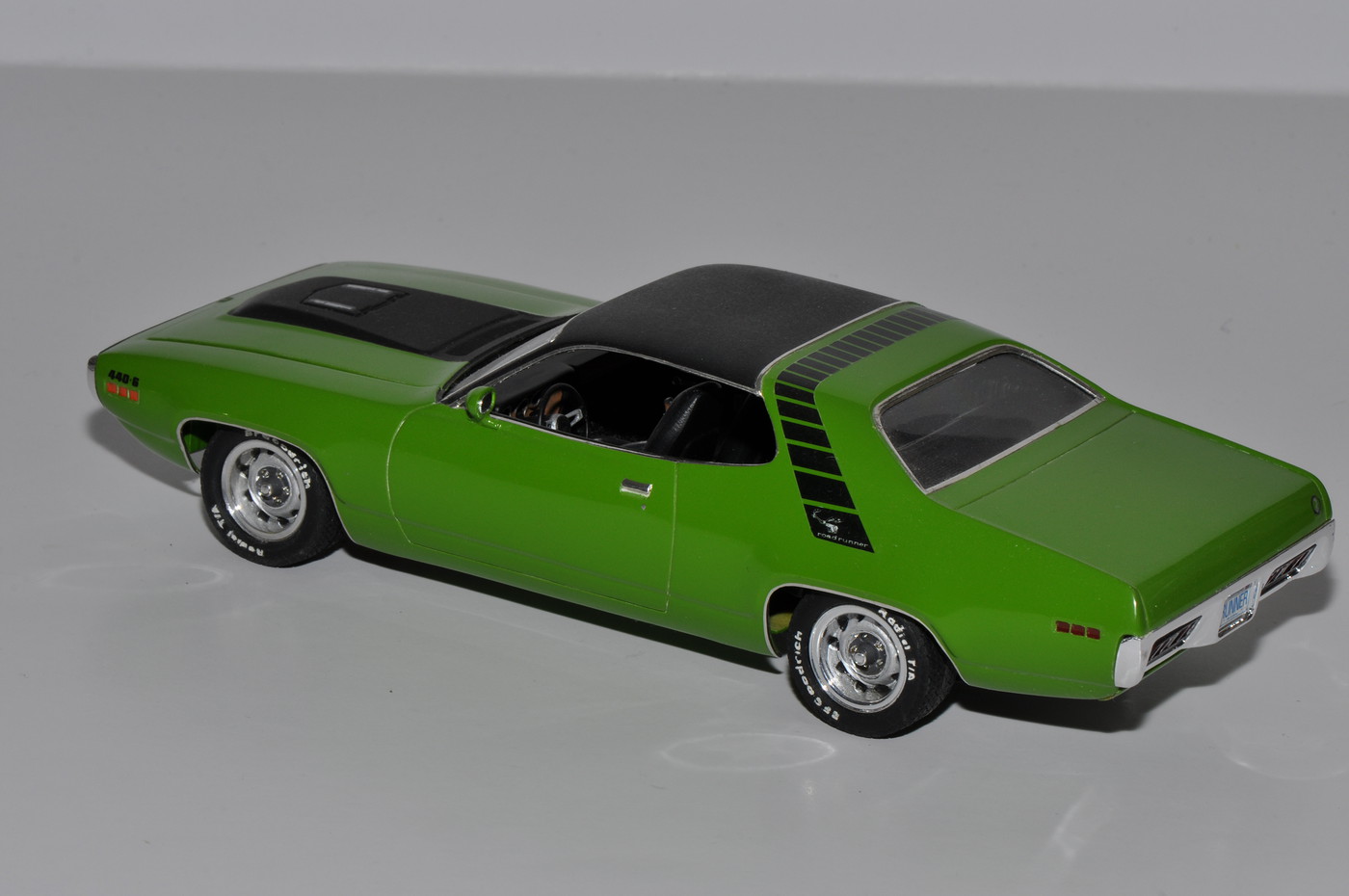

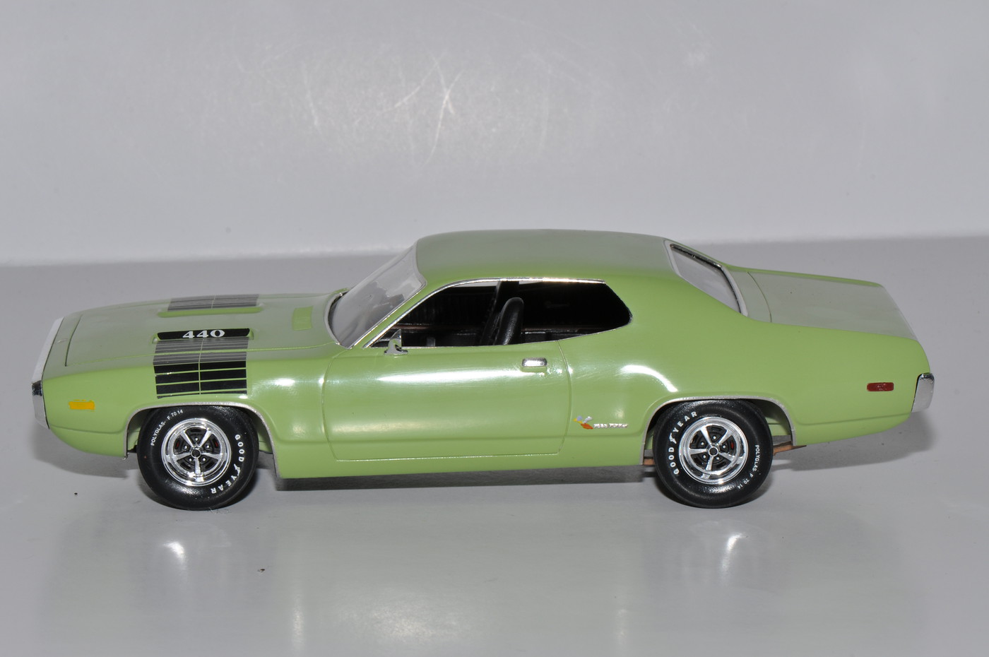

tim boyd Posted 1 hour ago Posted 1 hour ago Interesting discussion on the flaws of the MPC Road Runner. While I don't disagree with the accuracy critiques, I still think the original annual kit and the 1987 reissue could turn out a very passable scale replica, as seen here with both 1971s and a 1972 annual kit...TB 1 1

CapSat 6 Posted 16 minutes ago Posted 16 minutes ago 1 hour ago, tim boyd said: Interesting discussion on the flaws of the MPC Road Runner. While I don't disagree with the accuracy critiques, I still think the original annual kit and the 1987 reissue could turn out a very passable scale replica, as seen here with both 1971s and a 1972 annual kit...TB These really do build up decently as they are- I didn’t mean to make them sound terrible. You crushed these builds, Tim!
