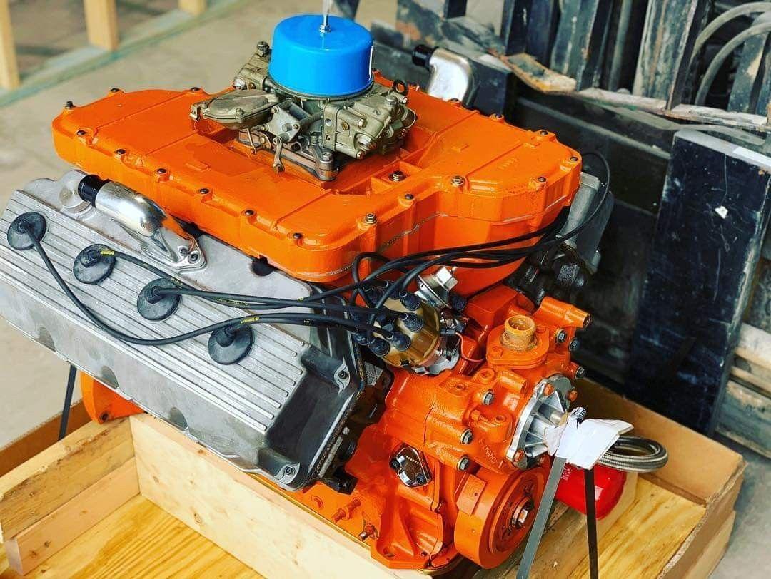

Anybody have such an engine?  What's a good kit to find such an engine?  I am putting a NASCAR chassis, 1/24, under a '69 Dodge Charger Daytona, 1/25.  (I wrote about this some time ago.  I think I am going to need to buy a kit off of 'ebay'.)  Did Ross Gibson ever make one of these?  I think  his engines were more like 1/23 scale, but I would try one.  Thanks.

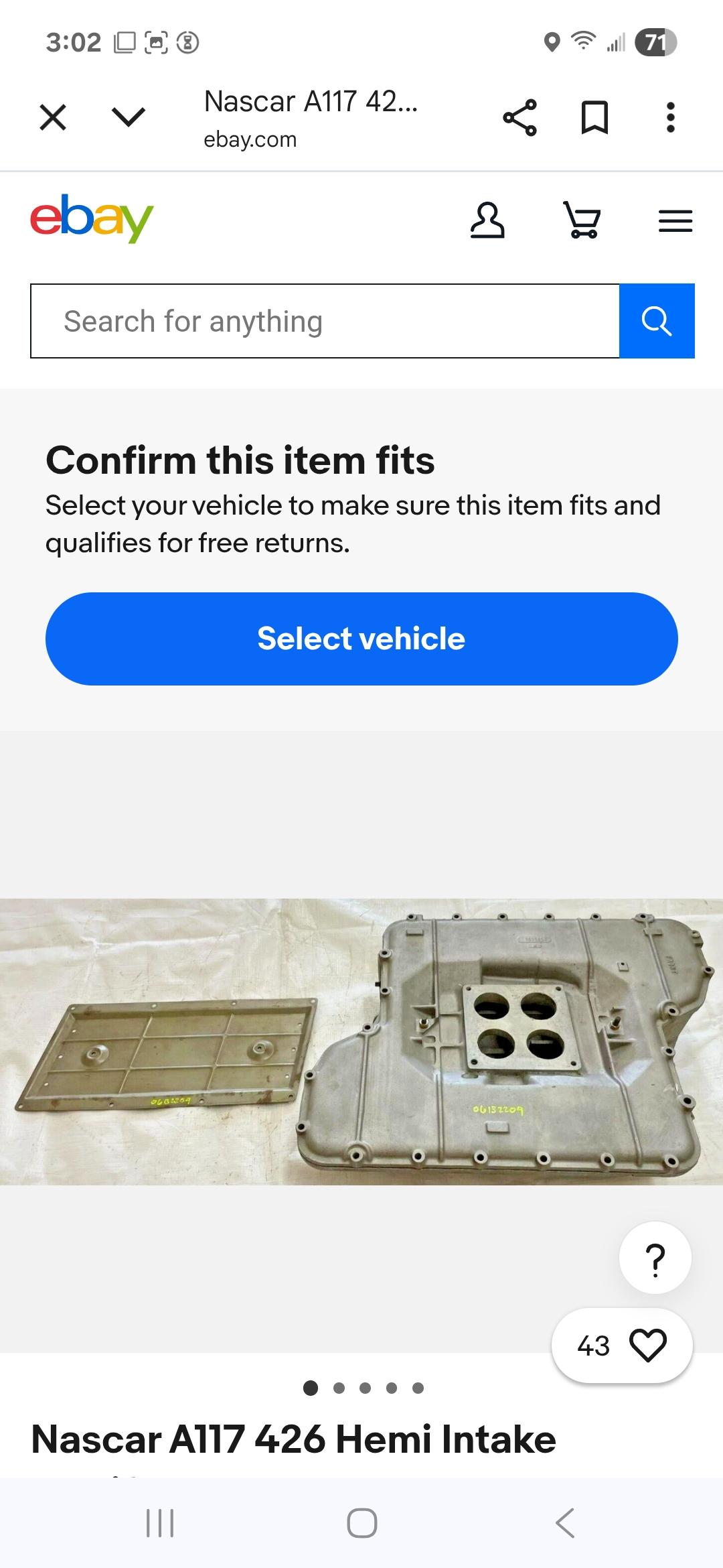

Screenshot_20251001_150242_Chrome.jpg.825c82ec422d76b935b66a8d34ce88d3.jpgI don't remember ever seeing anyone making a correct hemi Nascar intake manifold
You would be correct!
   All though not accurate...the early '70s MPC NASCAR Mopars had as close as similar to the A117 manifold.
  • Like 1

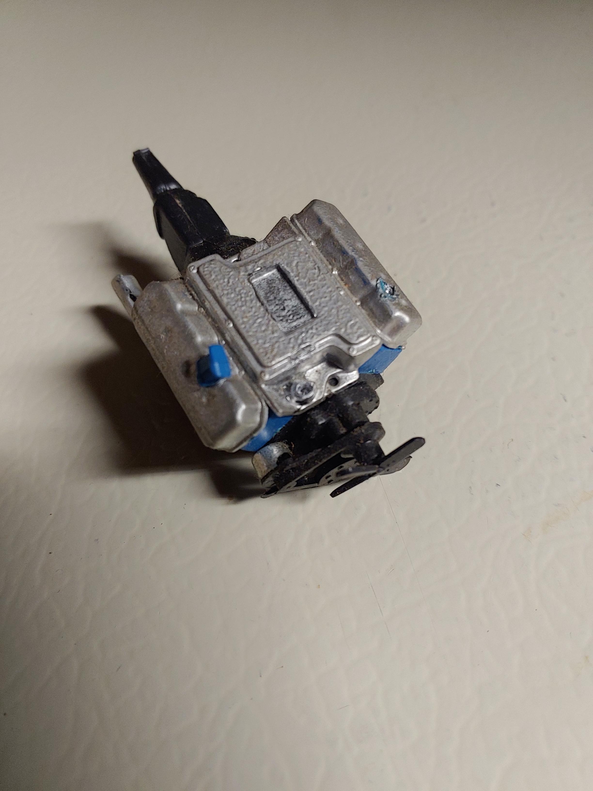

LOL, they got the valve covers on the wrong side. vents go to the front and oil cap on wrong side. Wrong carb too. But a nice-looking engine.

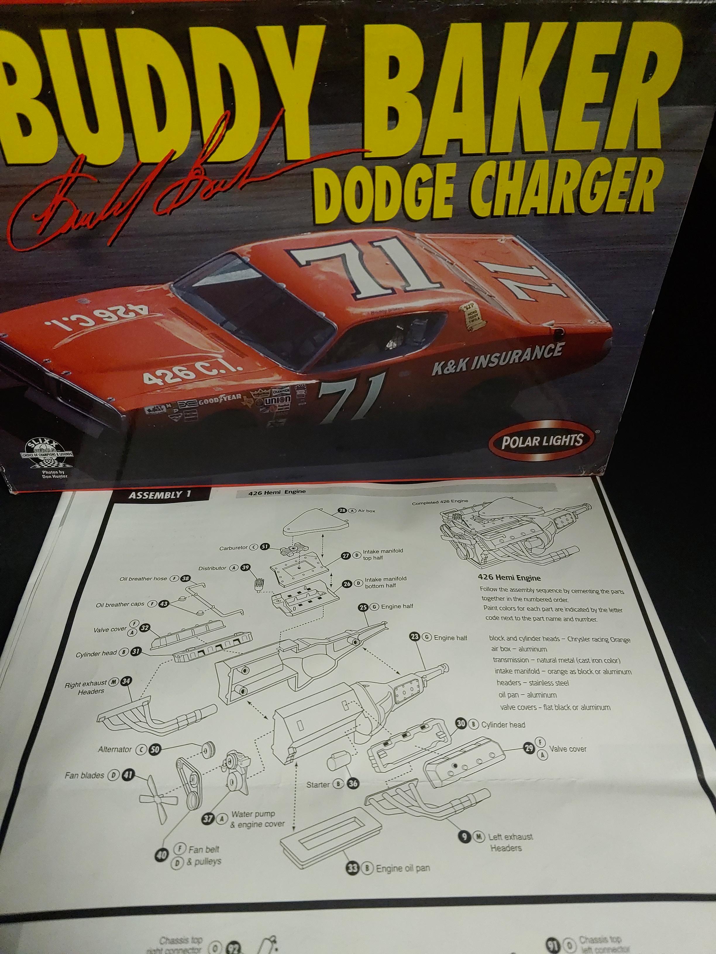

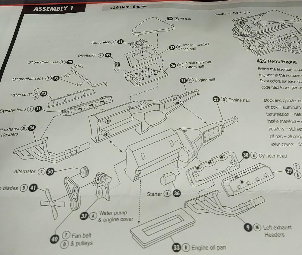

Can anyone recommend a kit?
Sure!
   Outta curiosity... I opened this kit to see "what" it offered for induction & motor.
  This looks to be very viable & readily available source for build project.
  • Like 1
