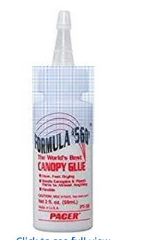

Swamp Dog Posted 7 hours ago Posted 7 hours ago get you some Canopy Glue (Amazon) and you want have that problem. brush it on place your windshield. with a wet brush you can clean up any on the edge. if you have a problem installing it an any of the glue gets all over it you can wash it off under warm to hot water. wipe down with something soft. i have had to do this before with my shaking hands.. 1
Shark Posted 1 hour ago Posted 1 hour ago I'm just old school, rarely use CA glue for anything model related. Just doesn't give me enough time. Plus it can "frost" parts. As mentioned above, I use canopy glue. Tape the glass part in with masking tape and glue the untaped areas. After removing the tape, run some more canopy glue if needed.
