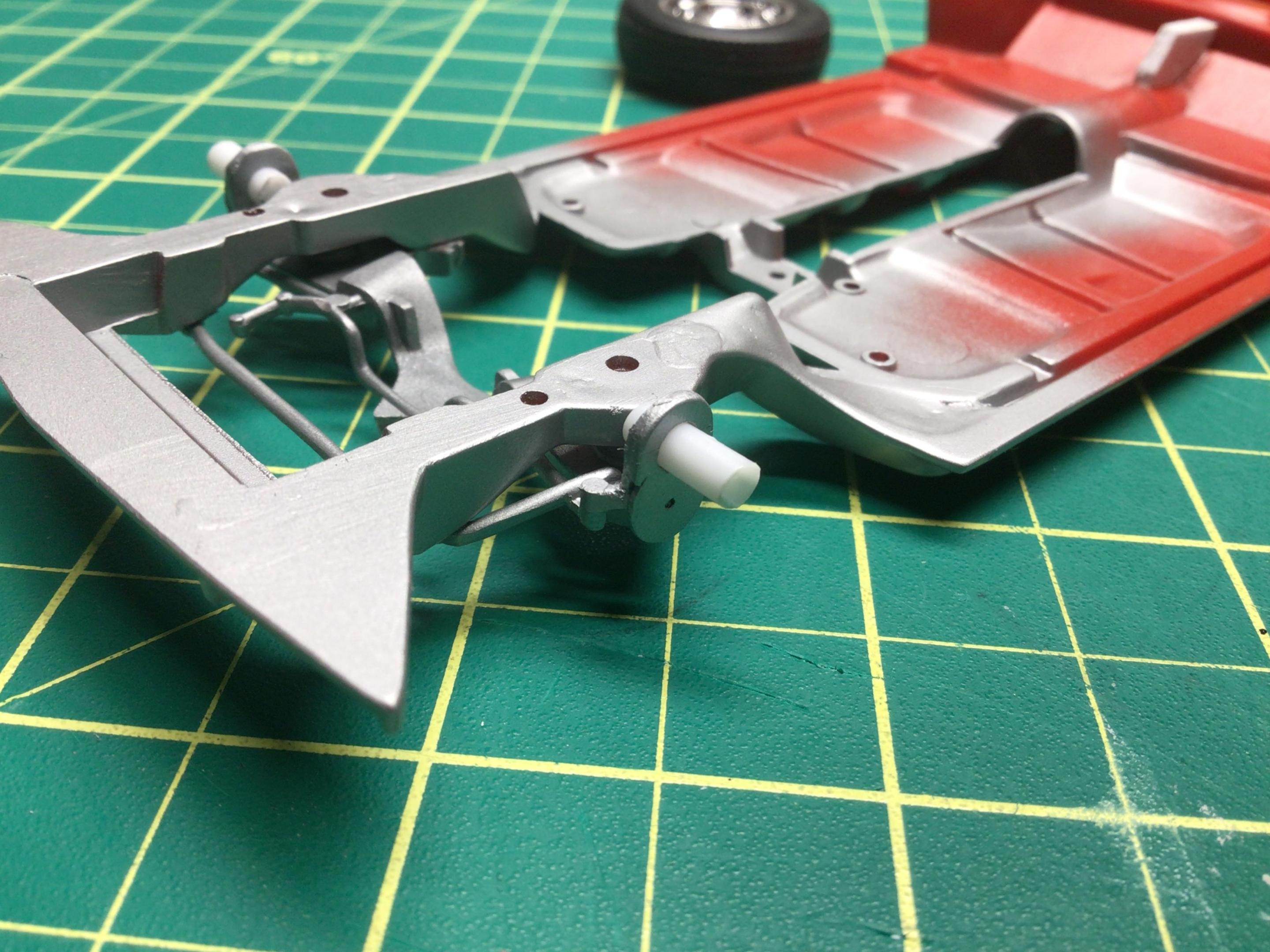

NOBLNG Posted 4 hours ago Posted 4 hours ago This is how I did it on a ‘64 GTO. Looks was all I was after…not 1:1 realism. 3
Ace-Garageguy Posted 2 hours ago Posted 2 hours ago 1 hour ago, NOBLNG said: This is how I did it on a ‘64 GTO. Looks was all I was after…not 1:1 realism. However...it's the same basic concept. Raising the spindles relative to the rest of the suspension is exactly the same functionally as installing 'dropped spindles' in a real car. Models in general can benefit from the builder having real-world knowledge of how things work, no matter the genre. On the other hand, building models is a great way to learn how things work in the real world. 5
