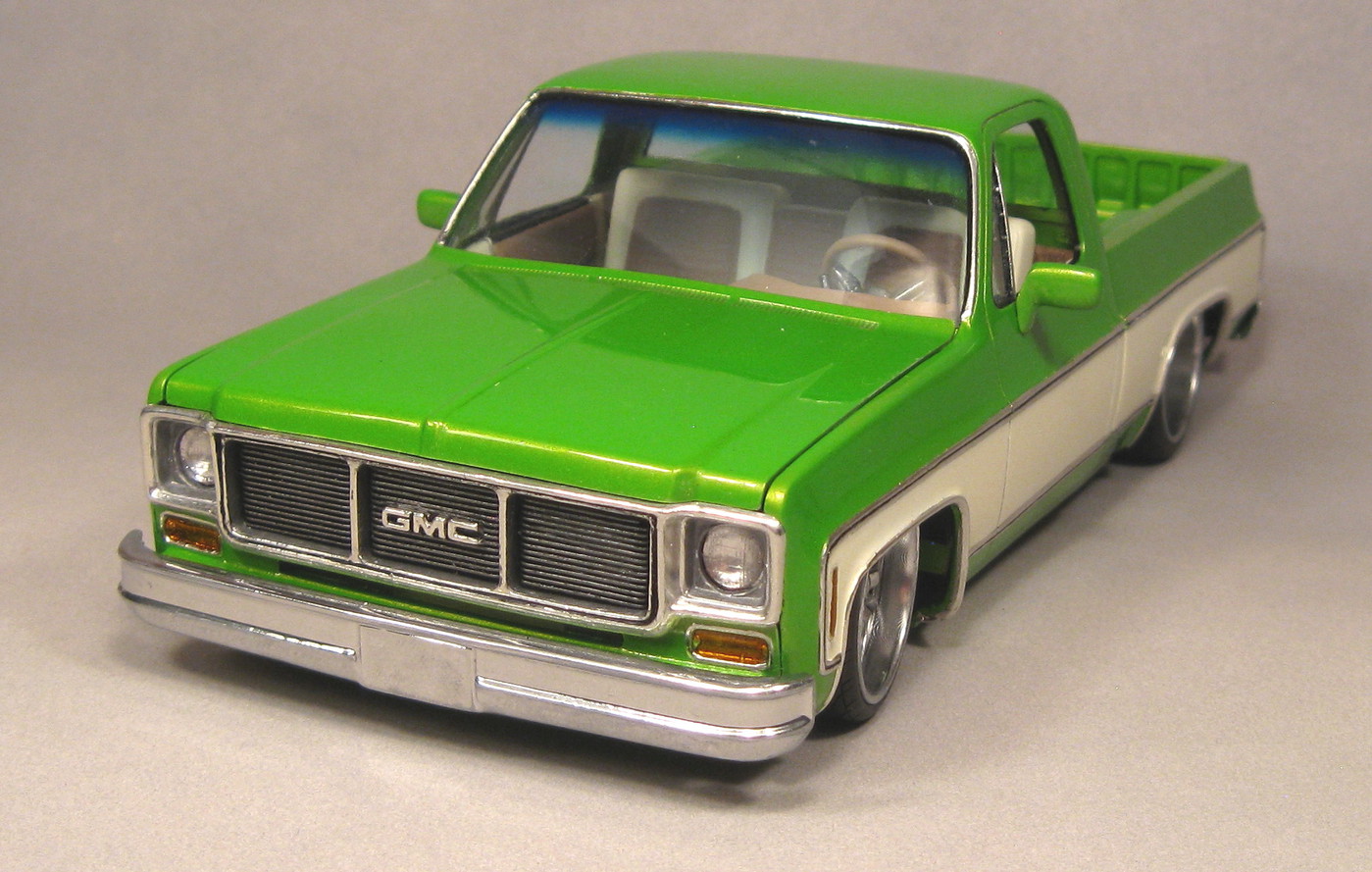

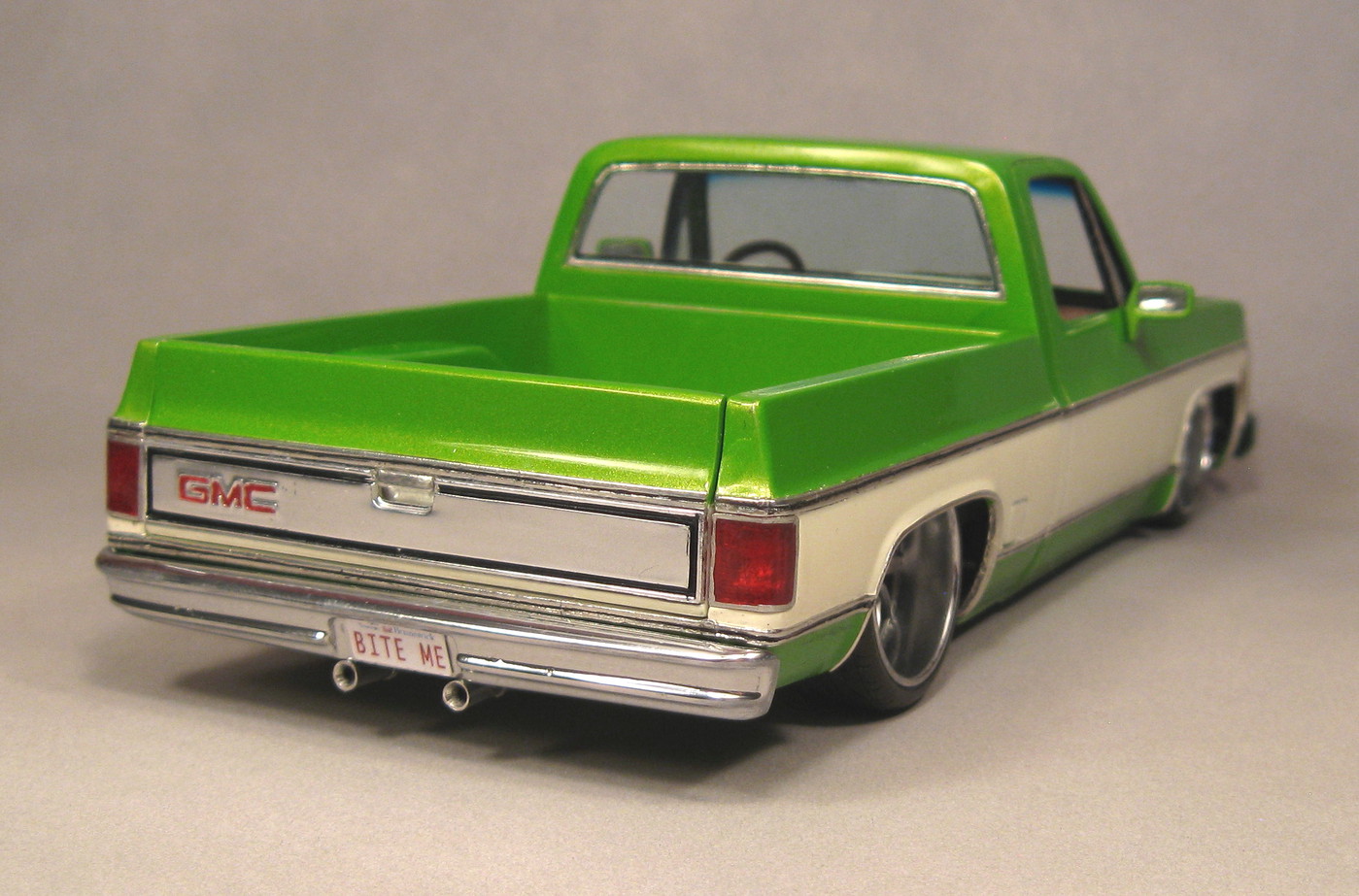

Can-Con Posted October 27 Posted October 27 I've had good luck by not touching it for a week or two and then brushing on a thin coat of Future. Seems most people on here have the patience to wait that long though. I also understand some have had good luck using the Spaz Stixs clear they have for their chrome paint but I don't have access to any to try it myself. That's how I did the bumpers on this truck. 5 1
