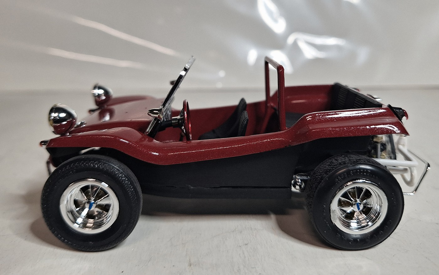

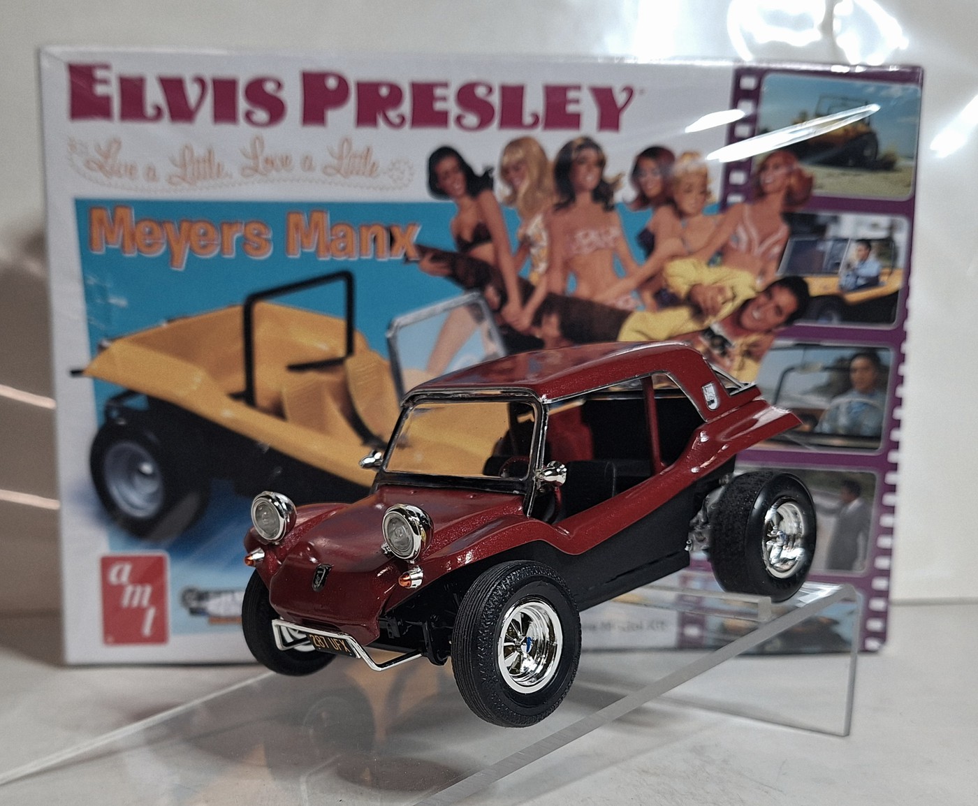

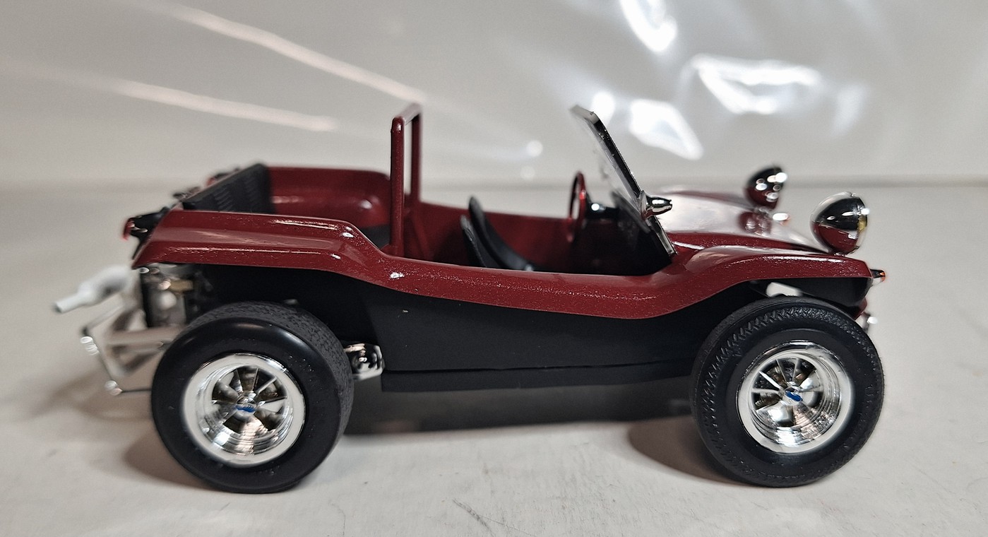

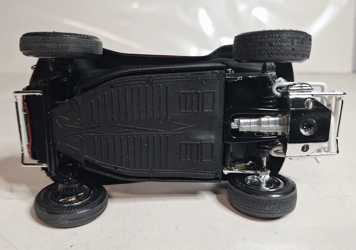

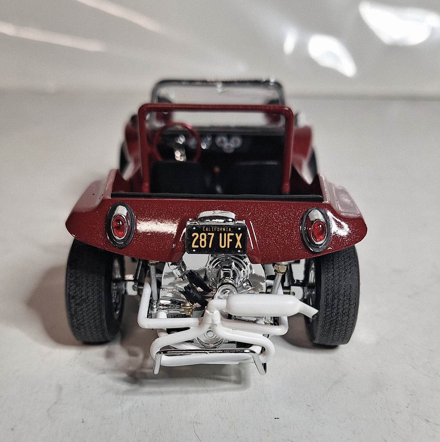

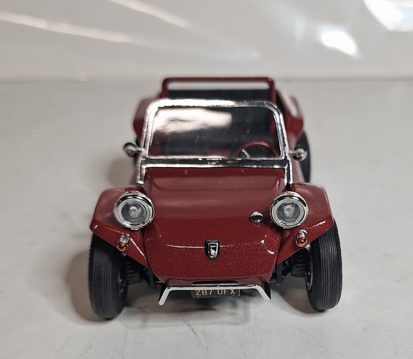

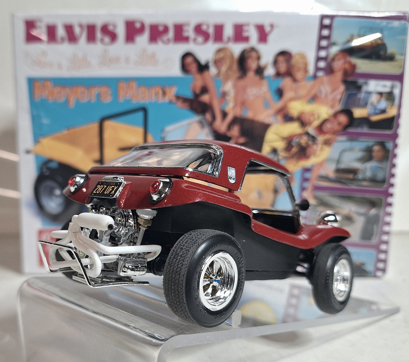

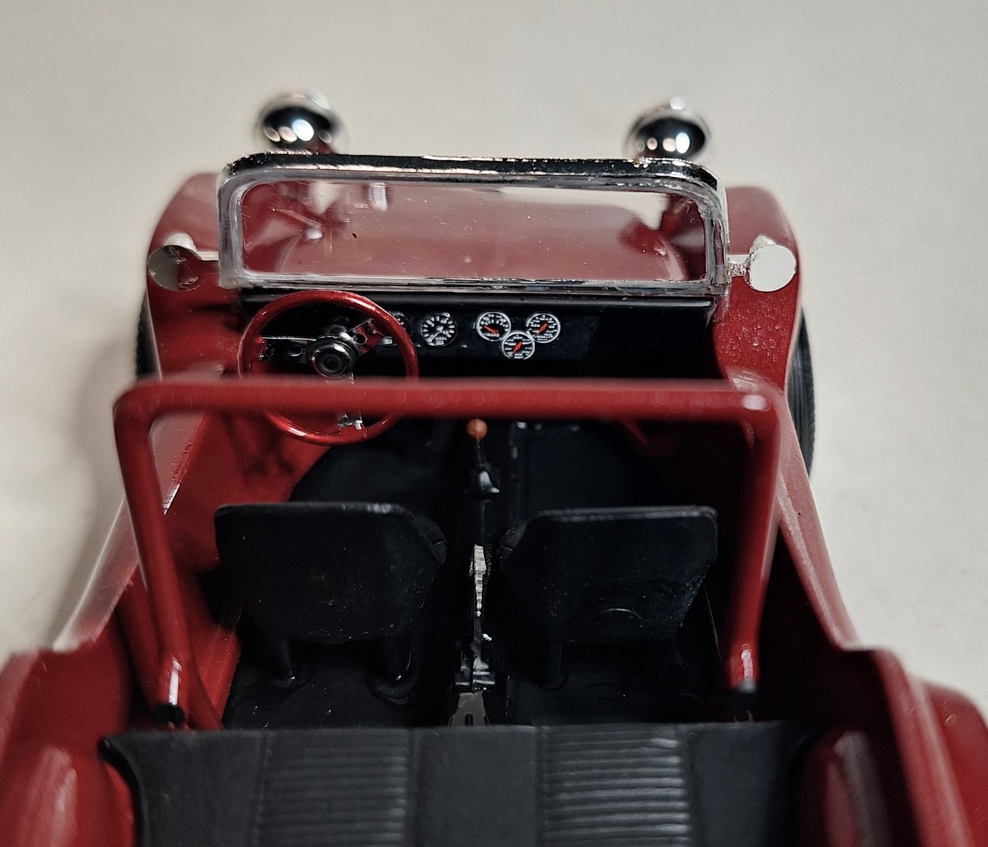

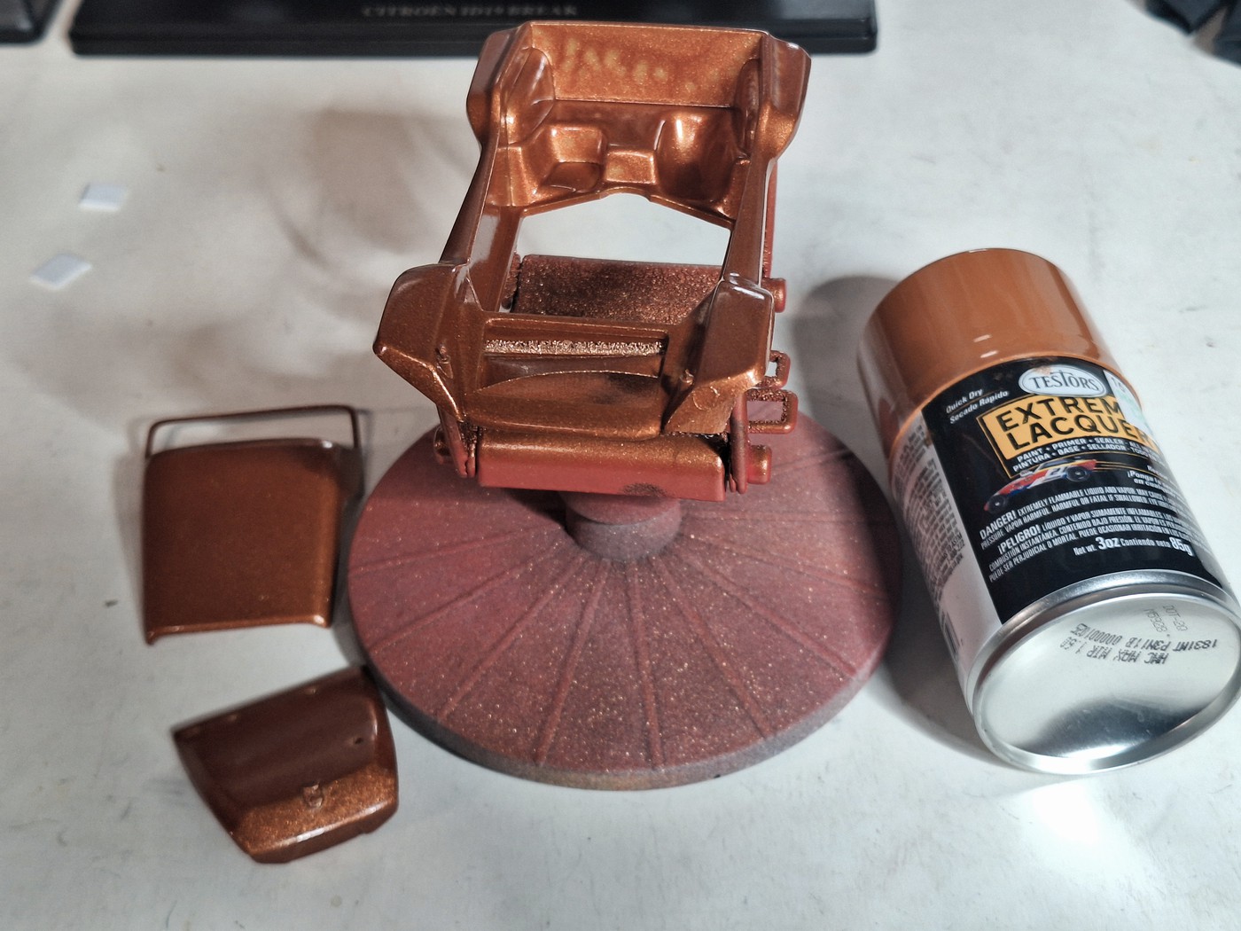

My son and daughter n law gave this to me a while back. I was going to build the Live a Little, Love a Little version until I realized the windshield was wrong, engine wrong, steering wheel wrong, and wheels and tires, of course, wrong. So, I thought I'd just use the kit parts and build a custom. The first paint job was a total failure. Something was just wrong with the paint. I used the same brand and type, Testors Extreme Lacquer, and the second try was fine. Other than small bits of flash, mold misalignment, and parting lines of these old molds, not a bad model to build. The front seats are terribly undersized I realized after installing. Oh, and I managed to lose both wipers. Anyway, thanks for looking!

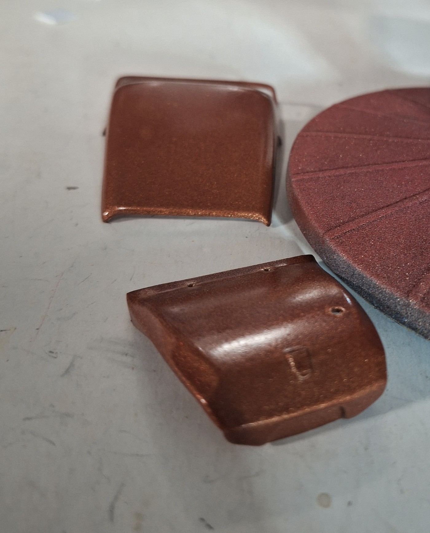

I painted the body and parts like I always have and knew something was odd when the second light coat was kind of grainy. When I added the third wet coat it all went south, fish eyes, and rough texture. The replacement paint did nothing like that.

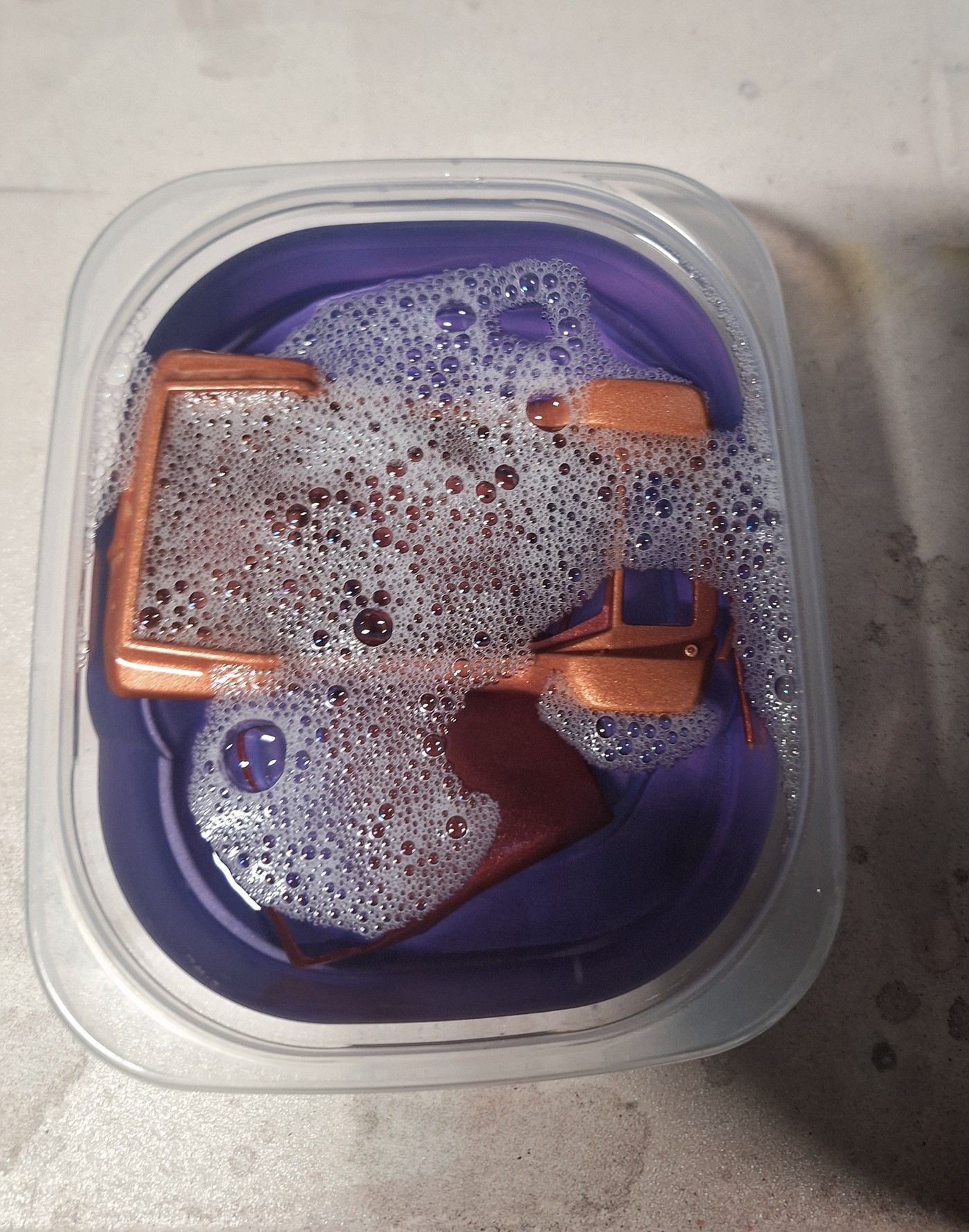

The purple pond, It took most of it off after 24 hours, but I had to go get some 91% alcohol to get it all
