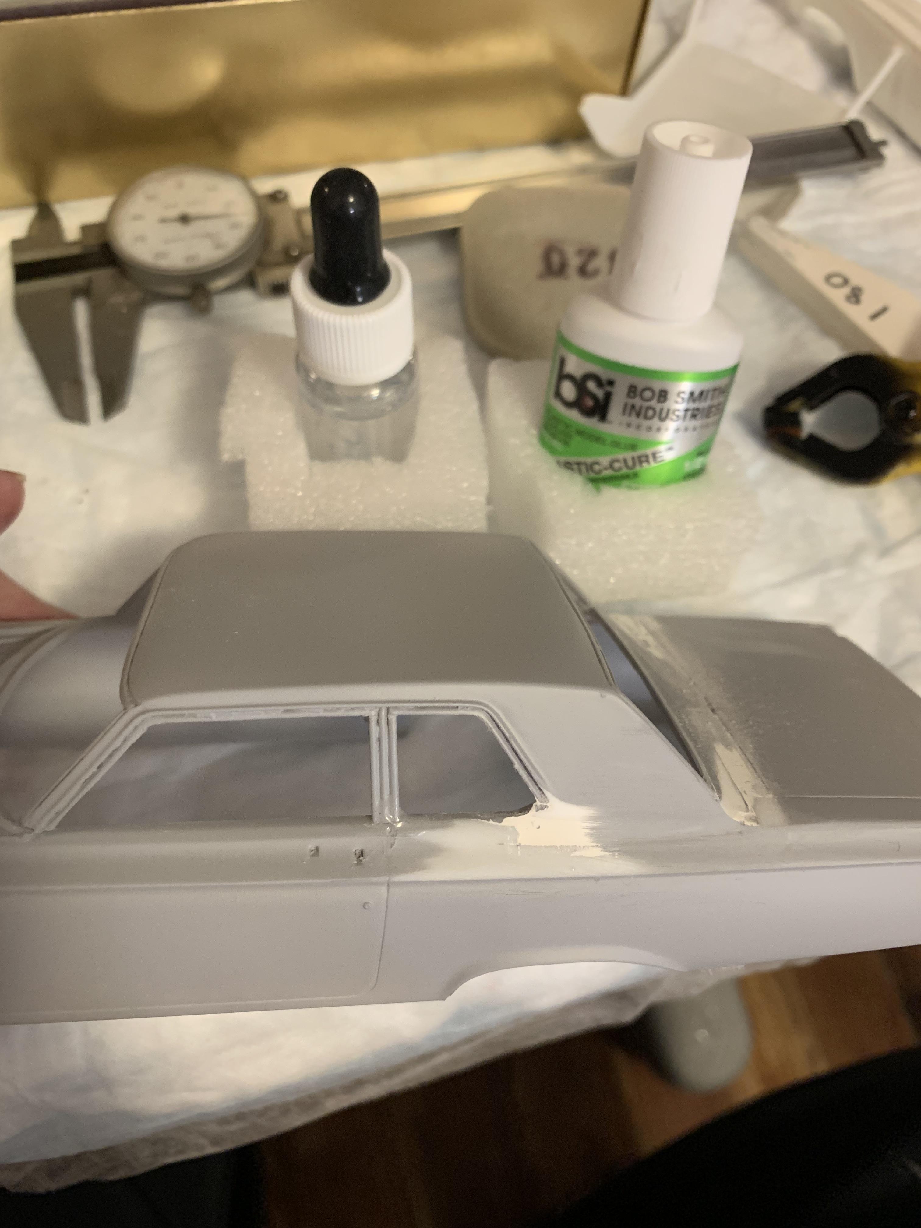

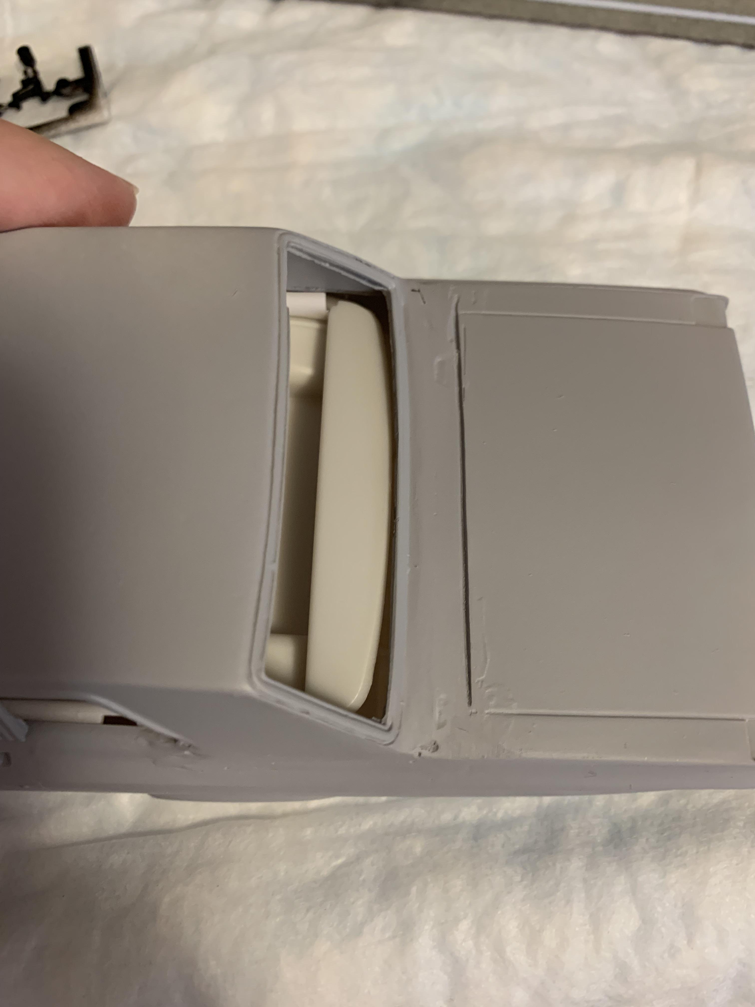

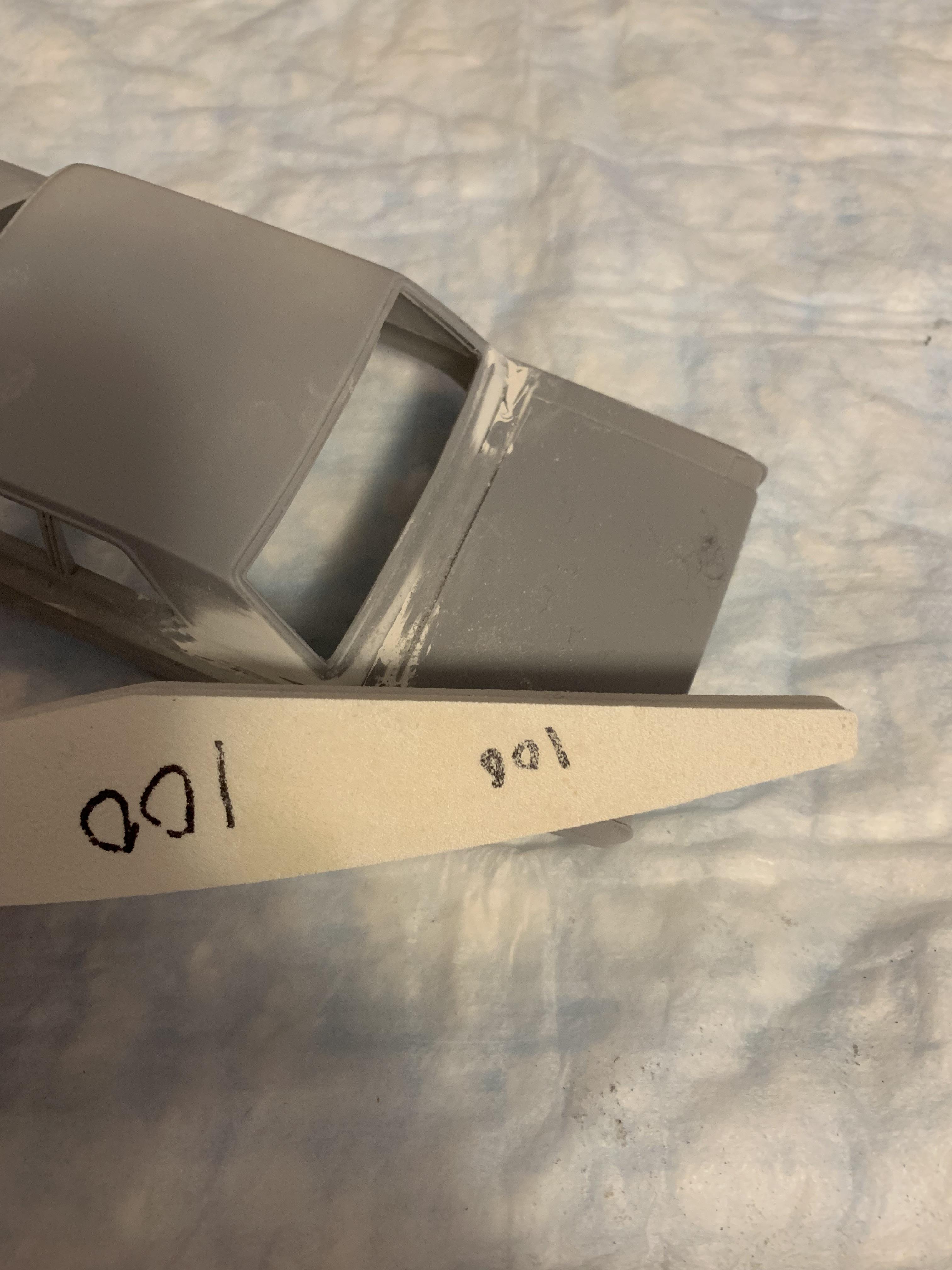

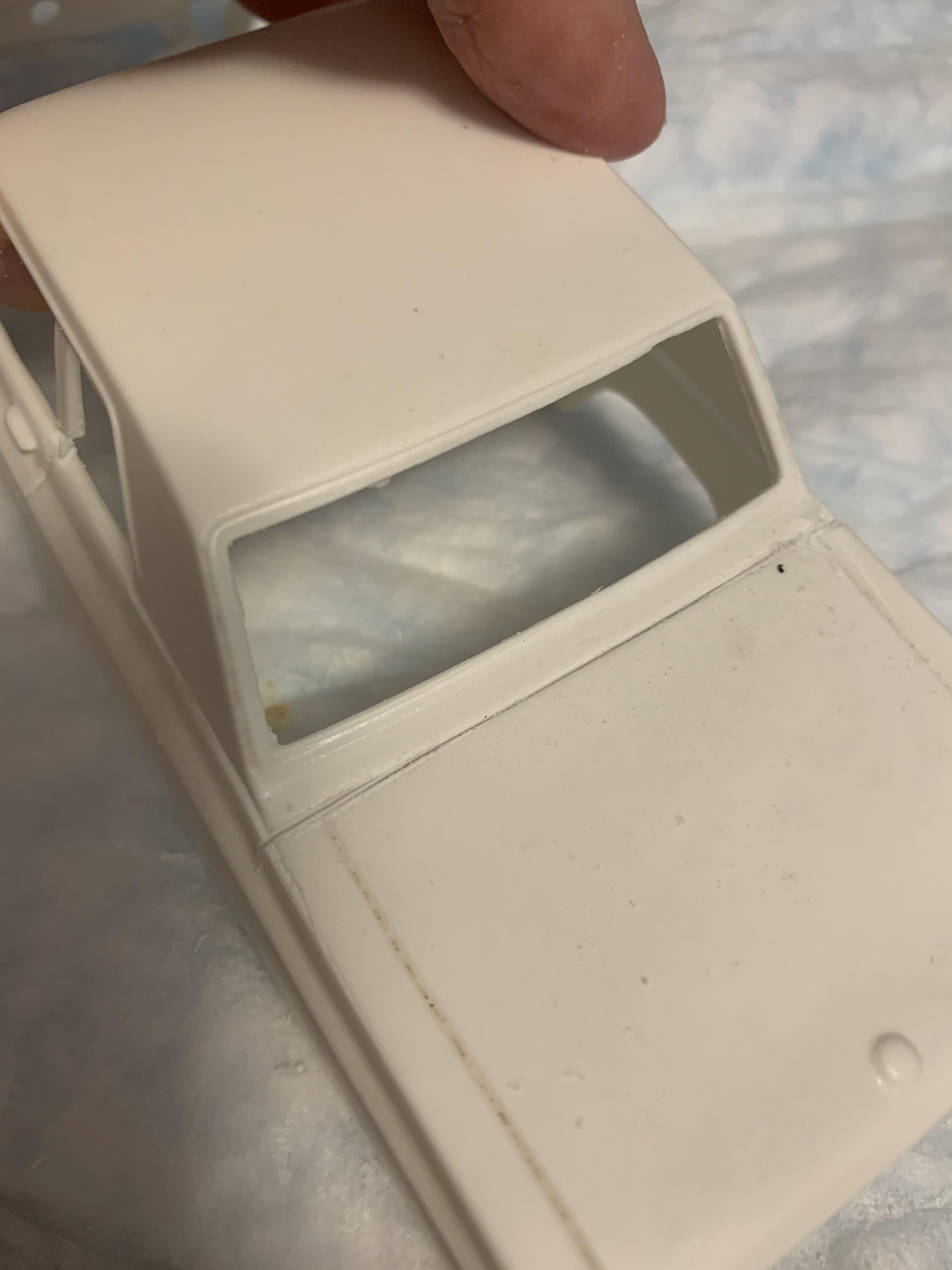

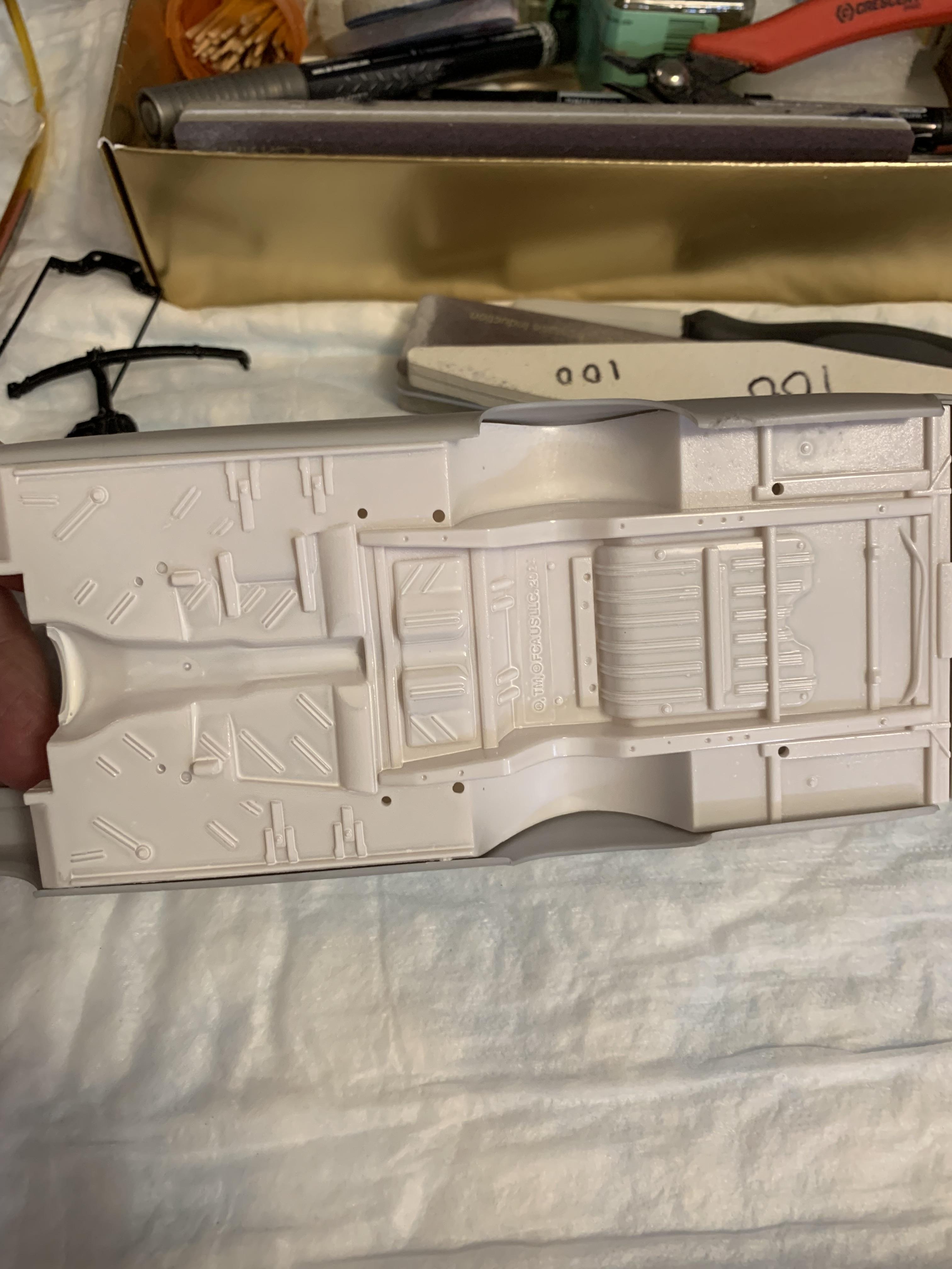

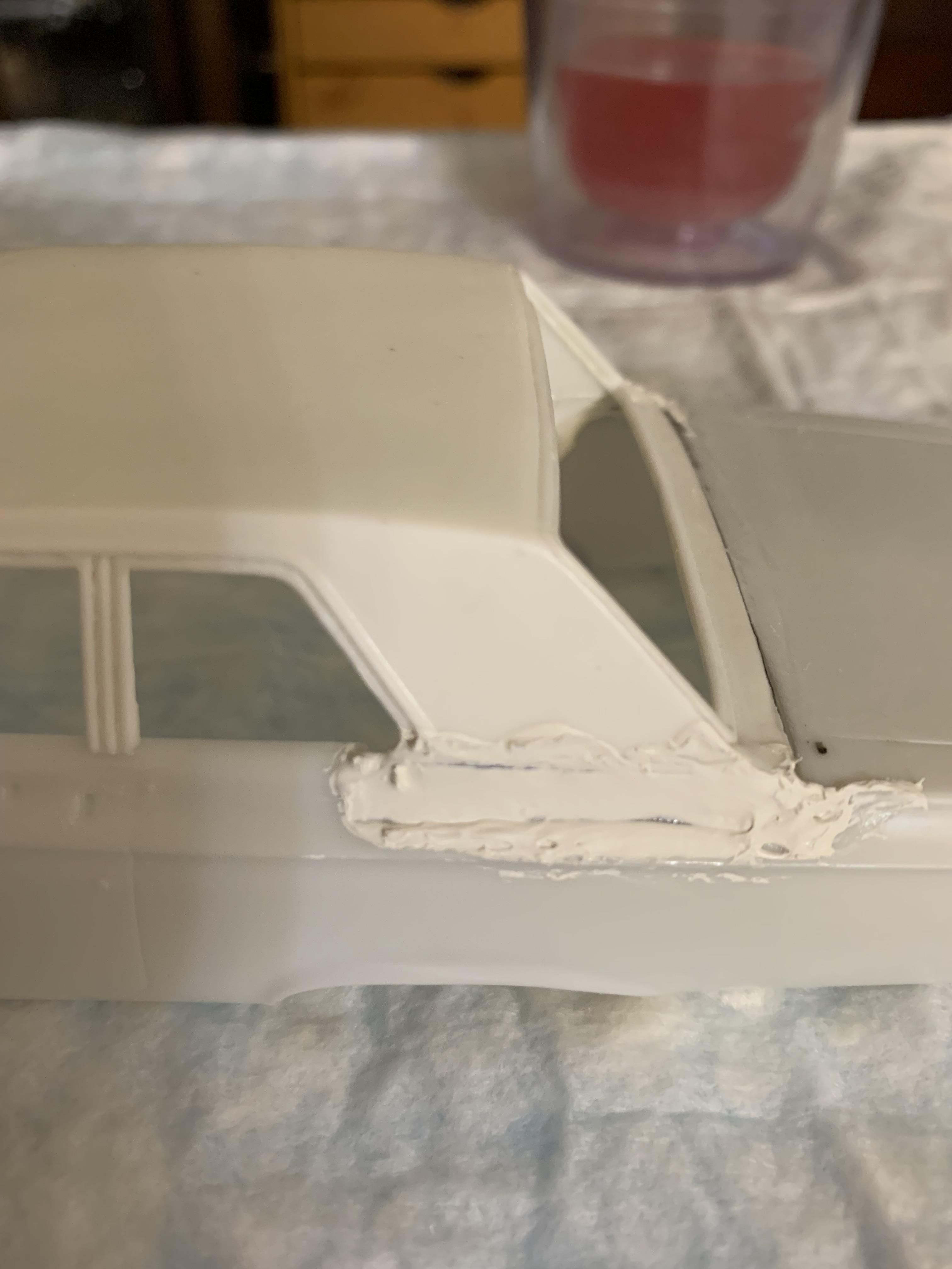

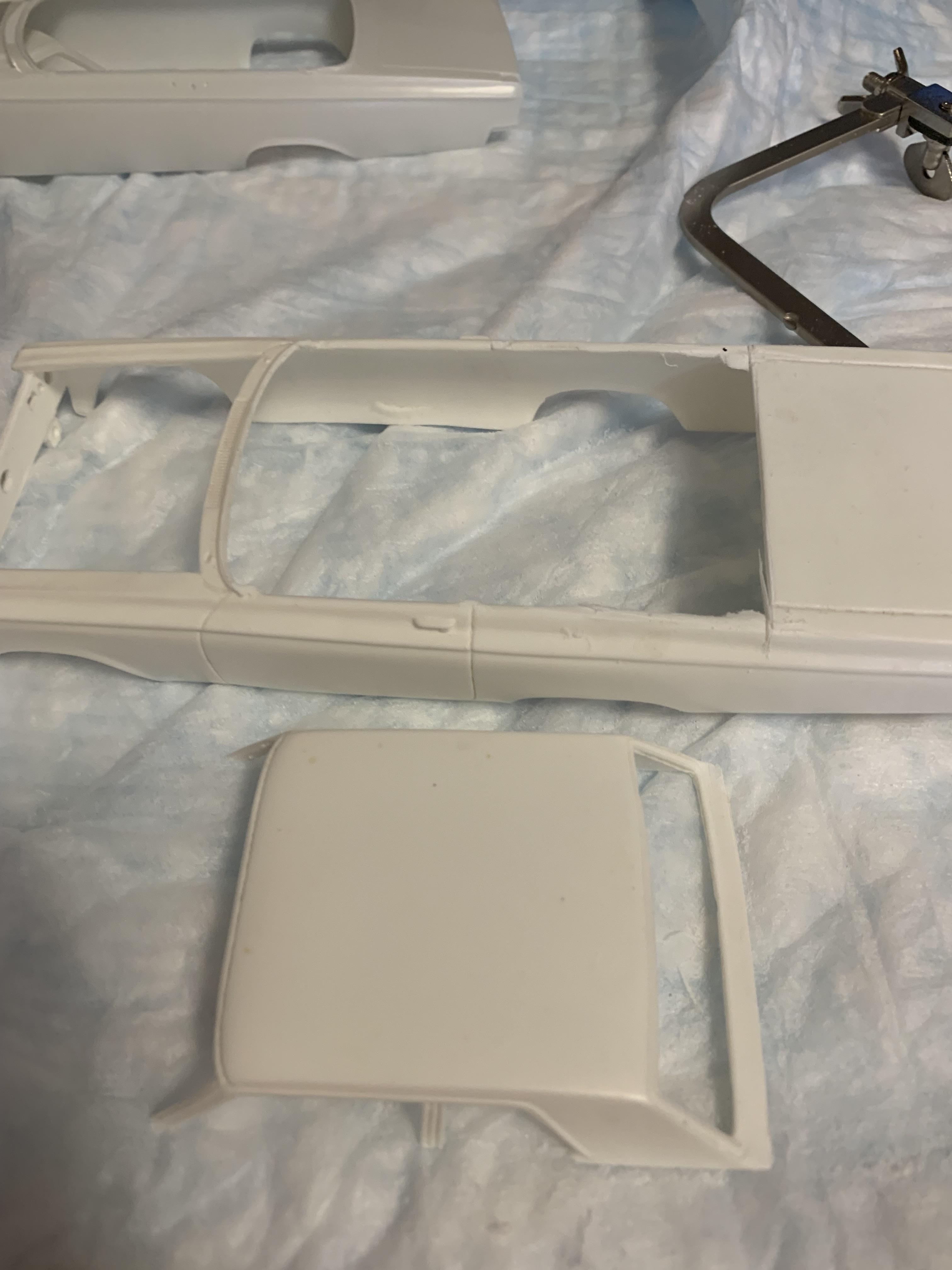

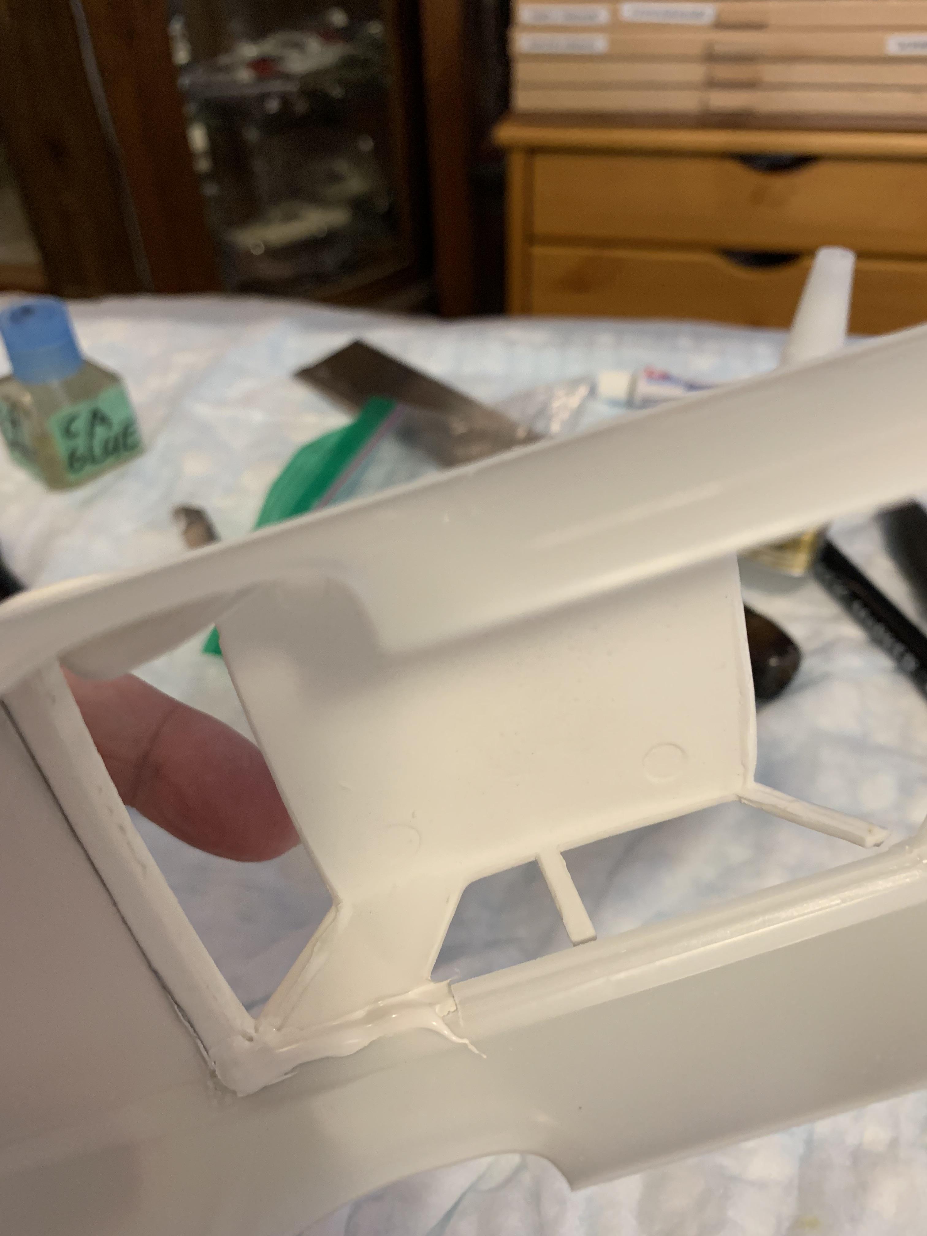

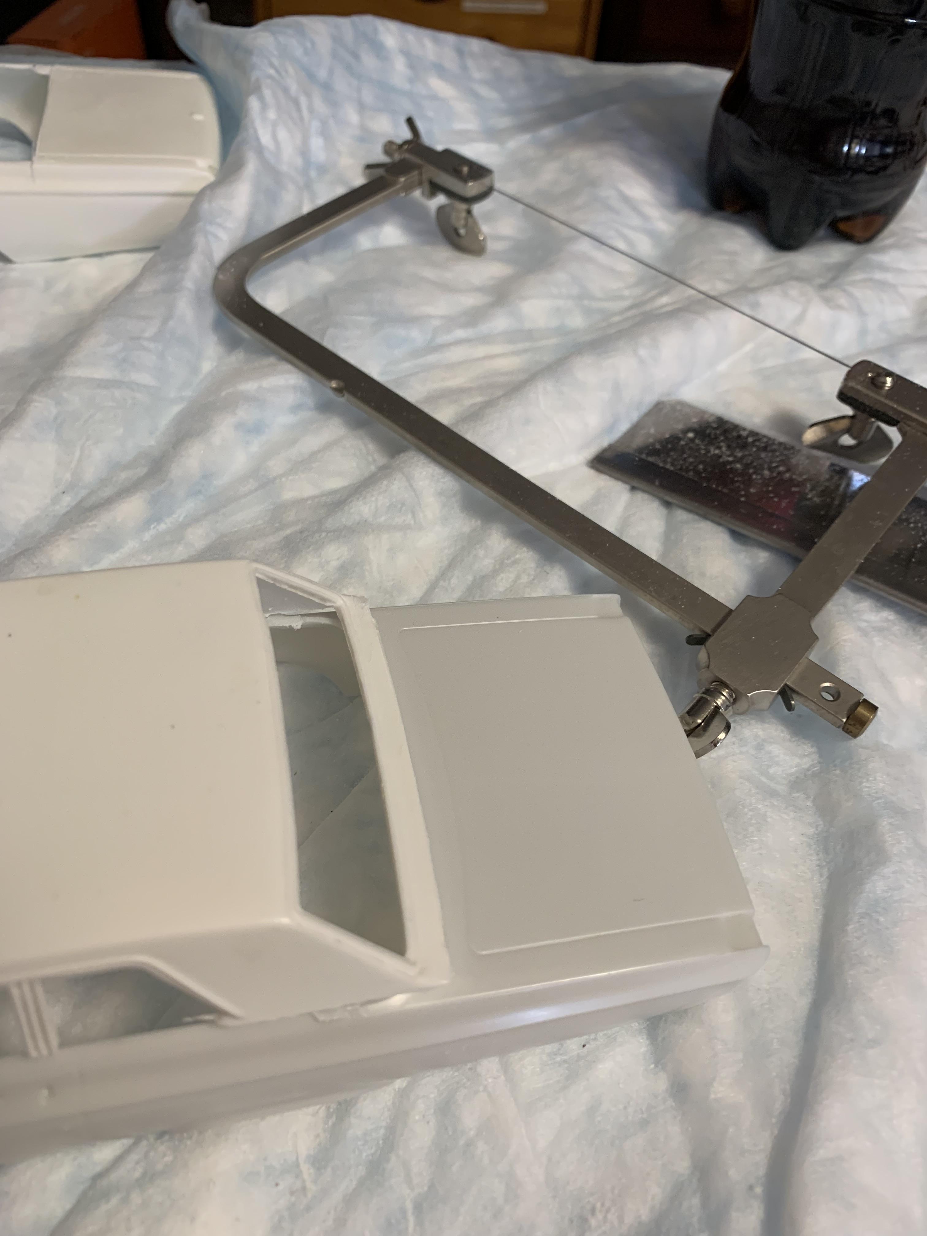

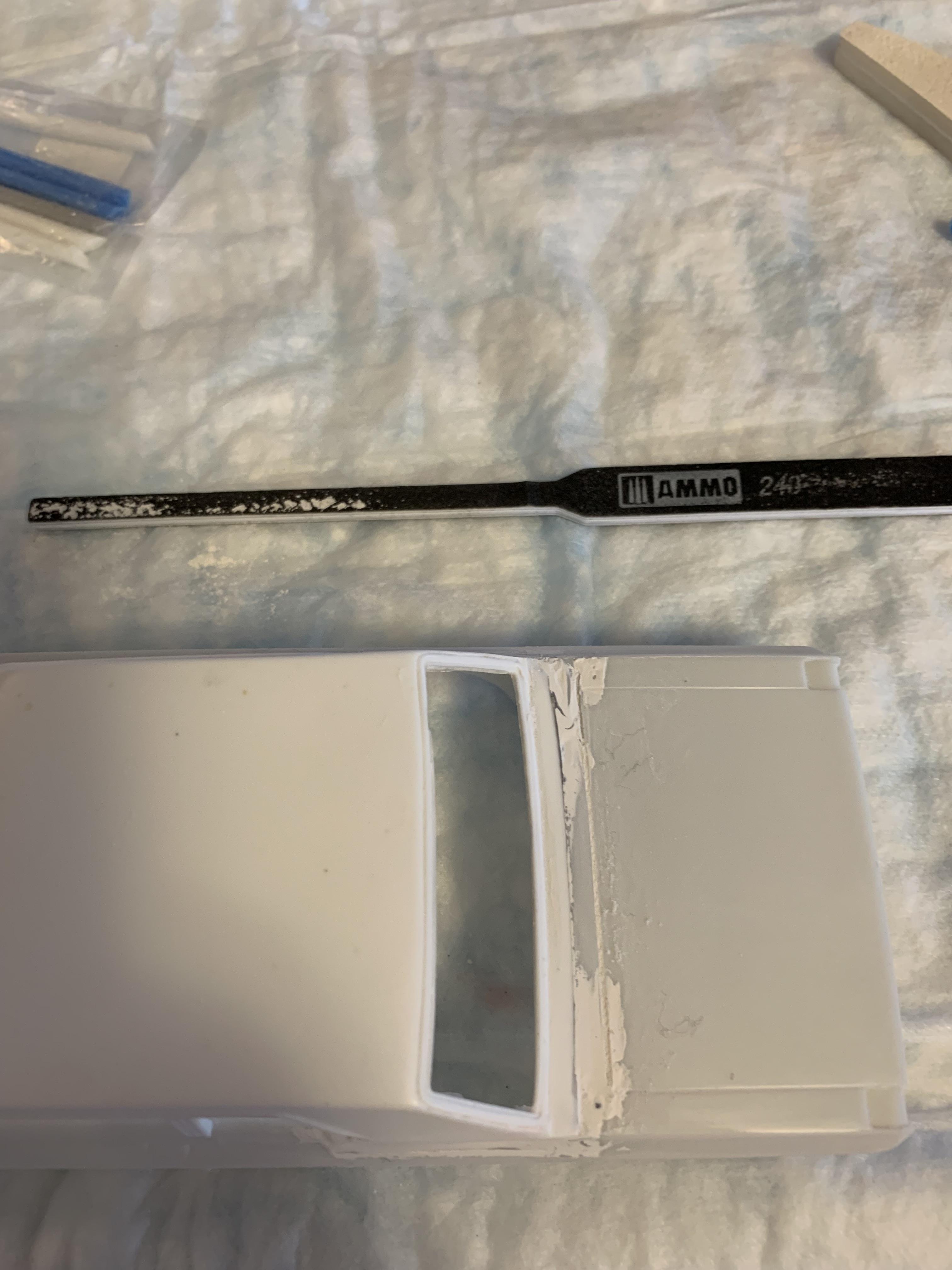

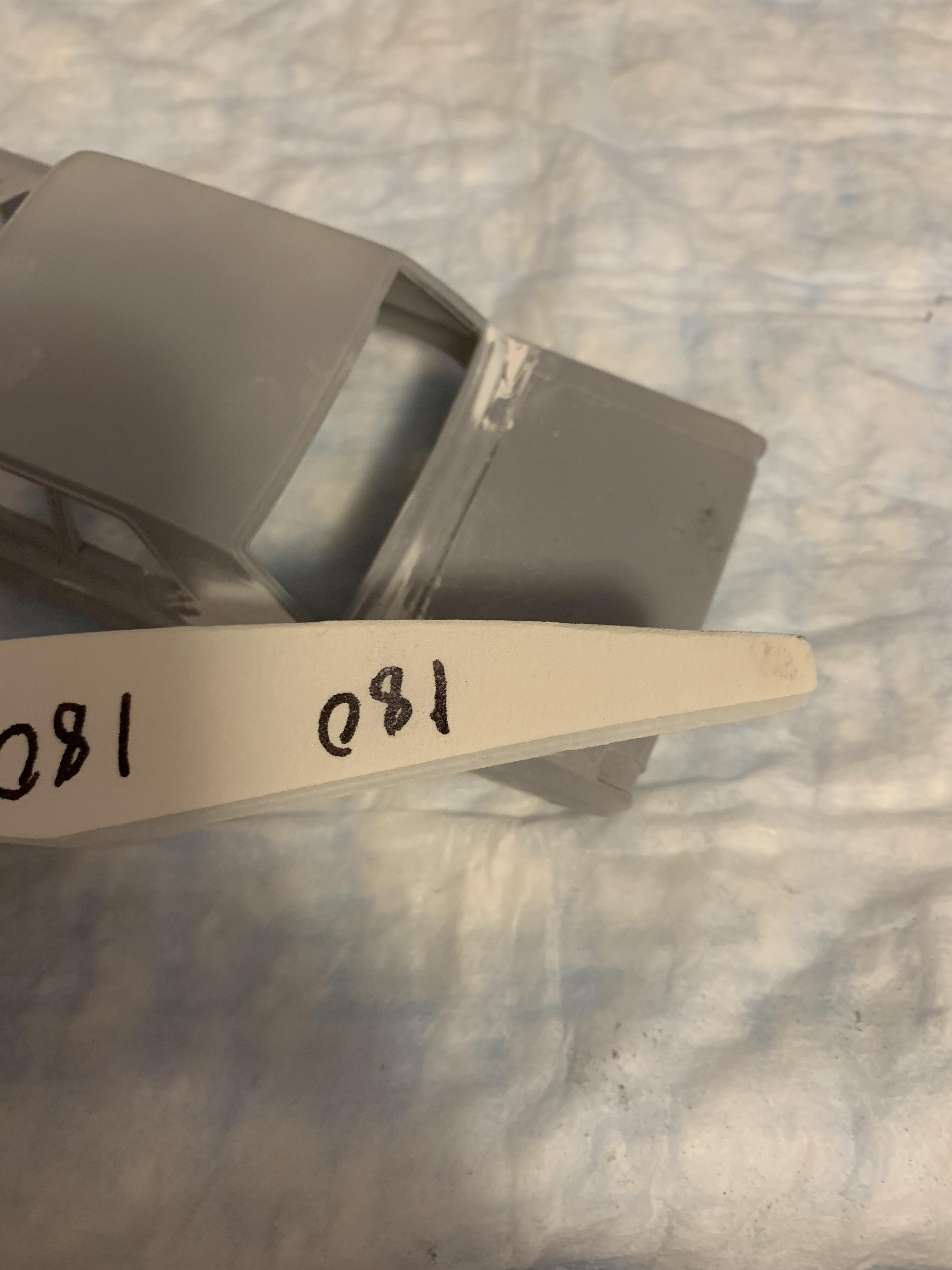

R. Thorne Posted November 16 Posted November 16 I somehow ended up with 3 Fremont resin sedan bodies a while back and just recently acquired a couple Moebius Dave Strickler kits. I always preferred the looks of the sedan, so, hey, why not chop the hardtop off and graft the sedan top on. I would like to build the Kentucky Colonels car, the Grand Spaulding blown car or the Bill Flynn Yankee Peddler car, but no decals are currently available for these cars, so we will see what happens. It may just be a no name car. Anyway, my humble efforts at the surgery involved are presented here. 5

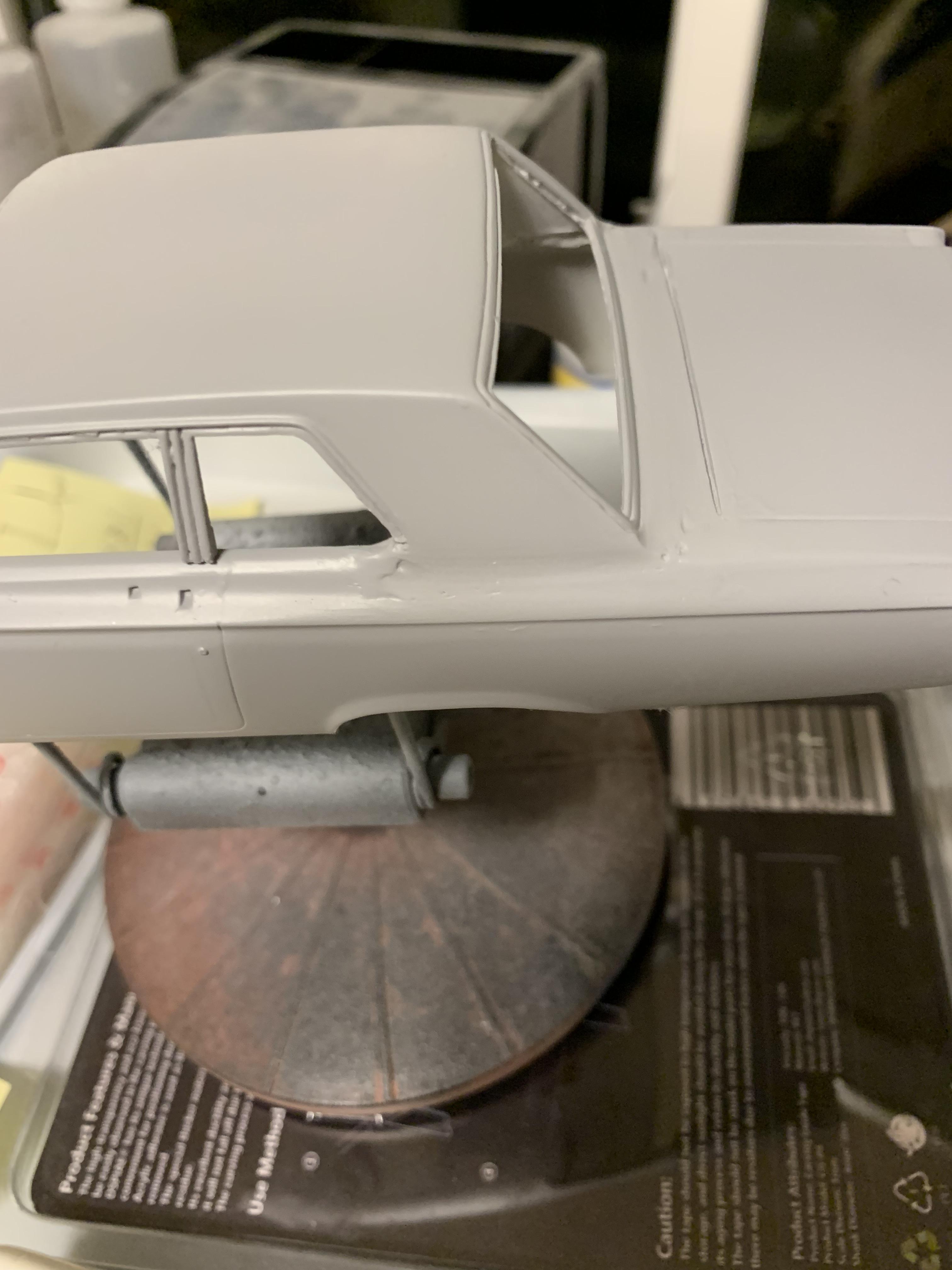

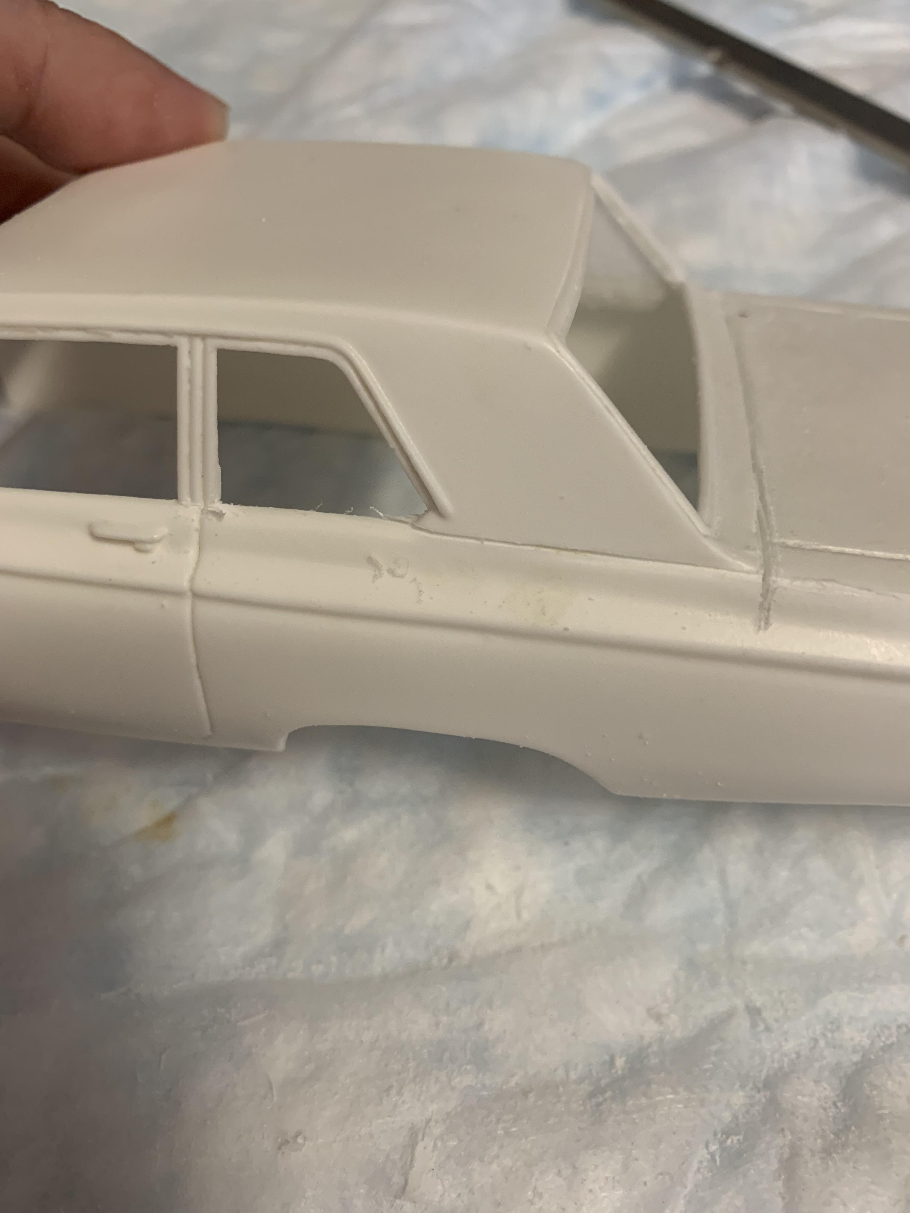

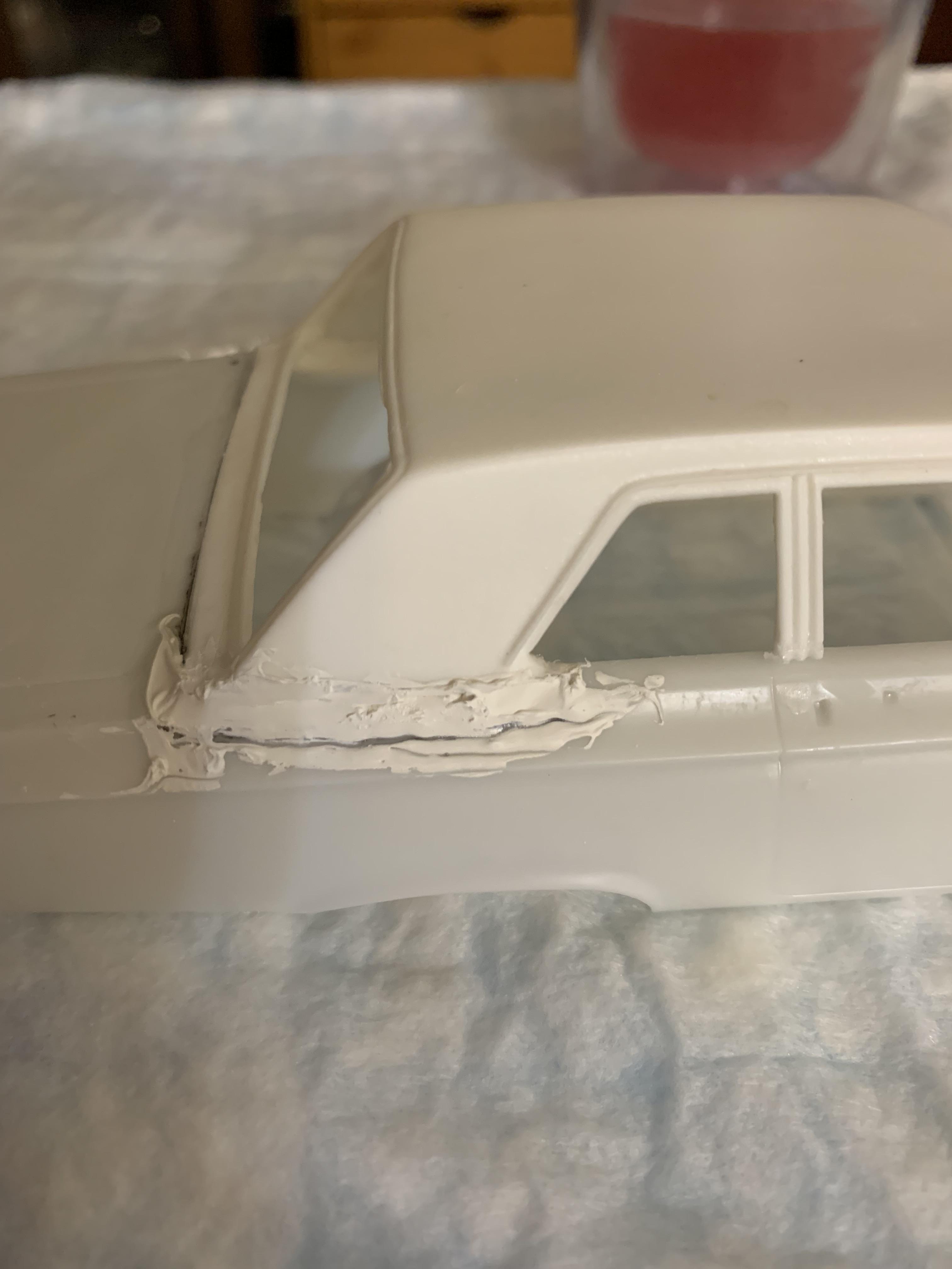

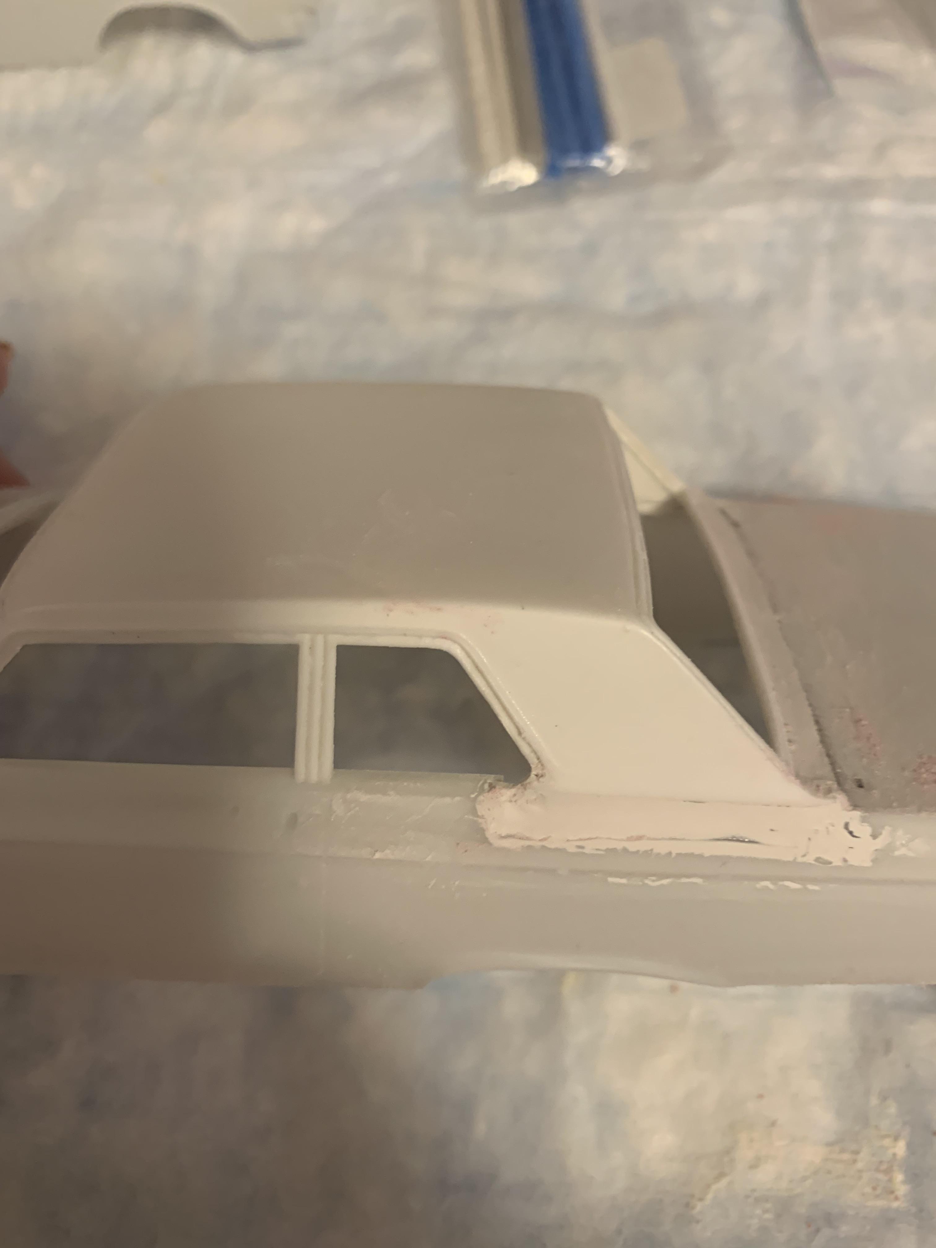

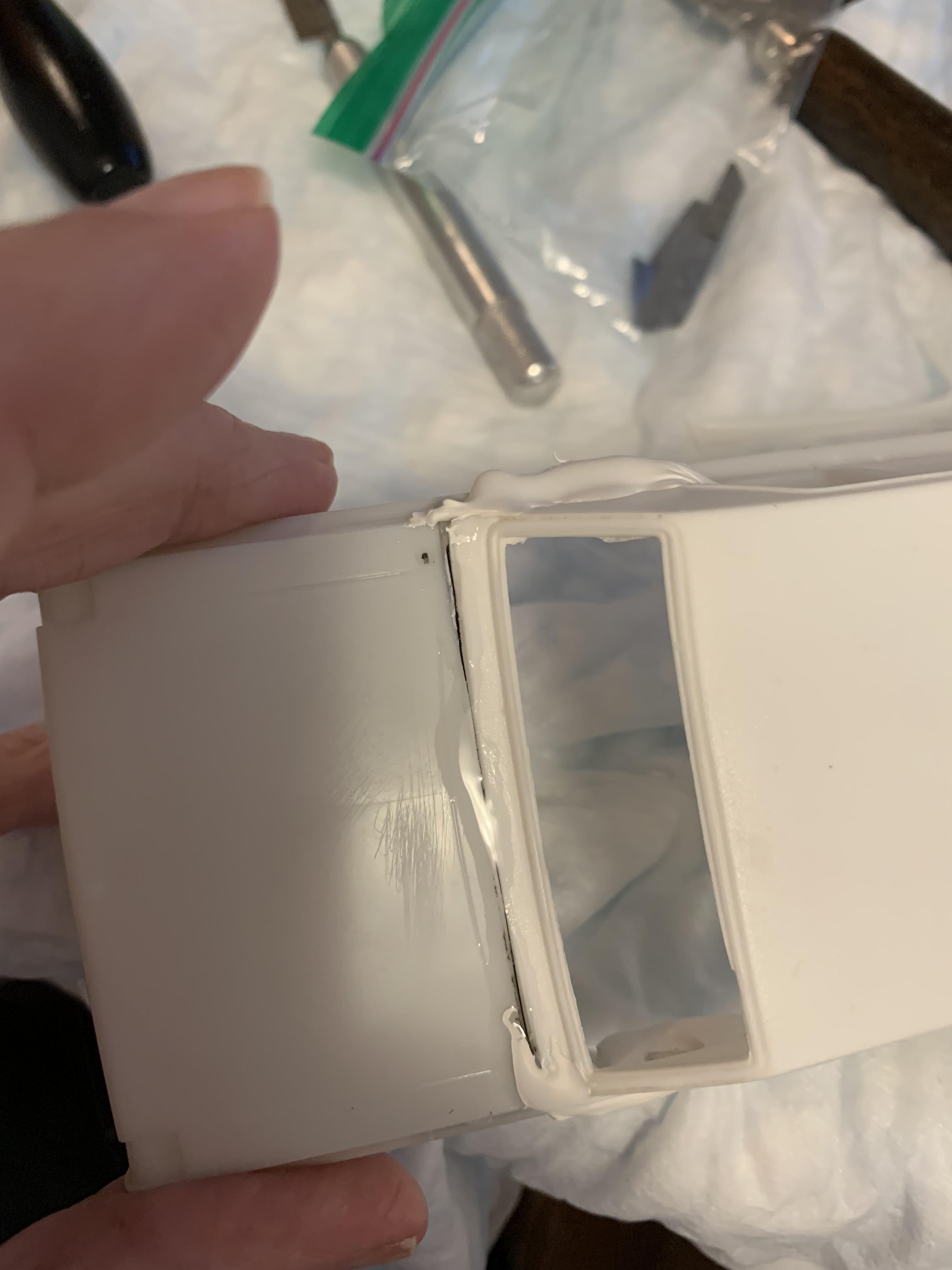

R. Thorne Posted November 16 Author Posted November 16 Some additional cutting, then some ca glue, then Tamiya putty, sanding, more putty, etc. 4

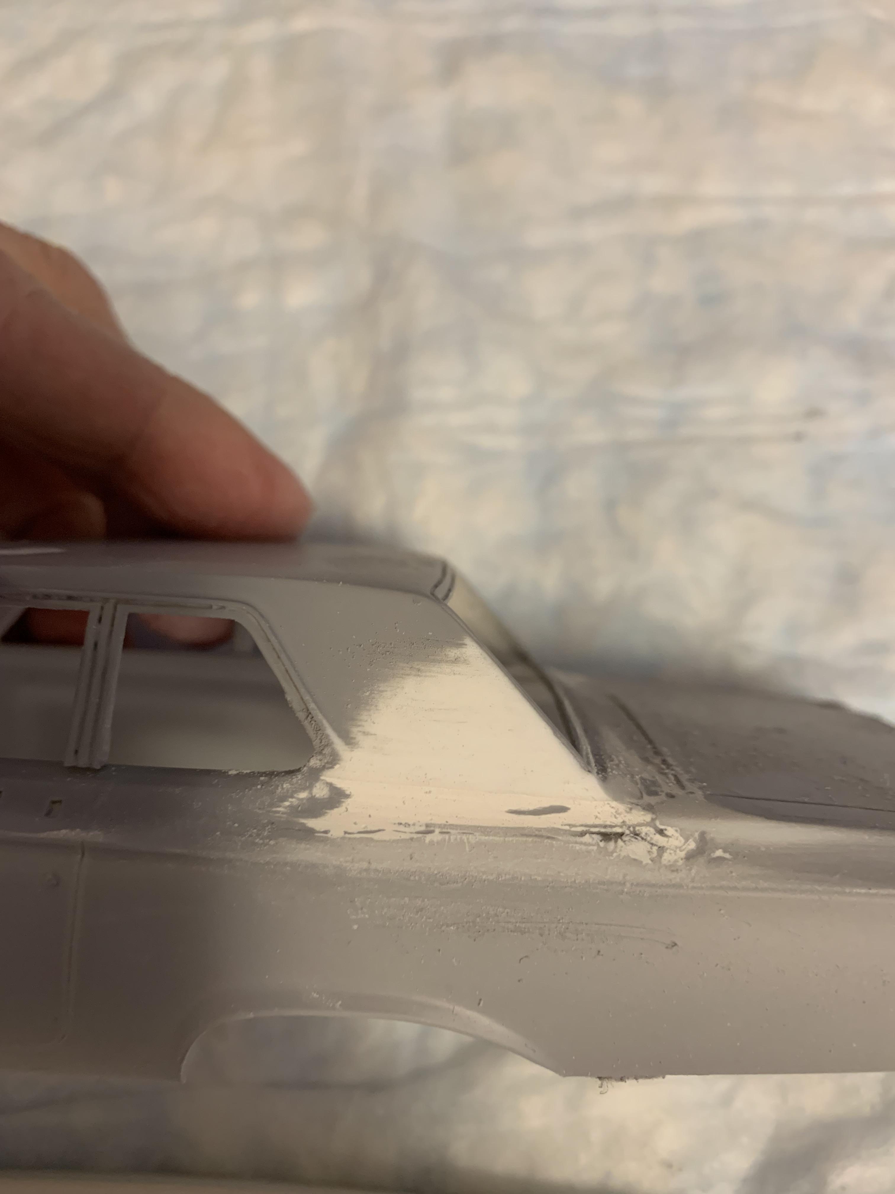

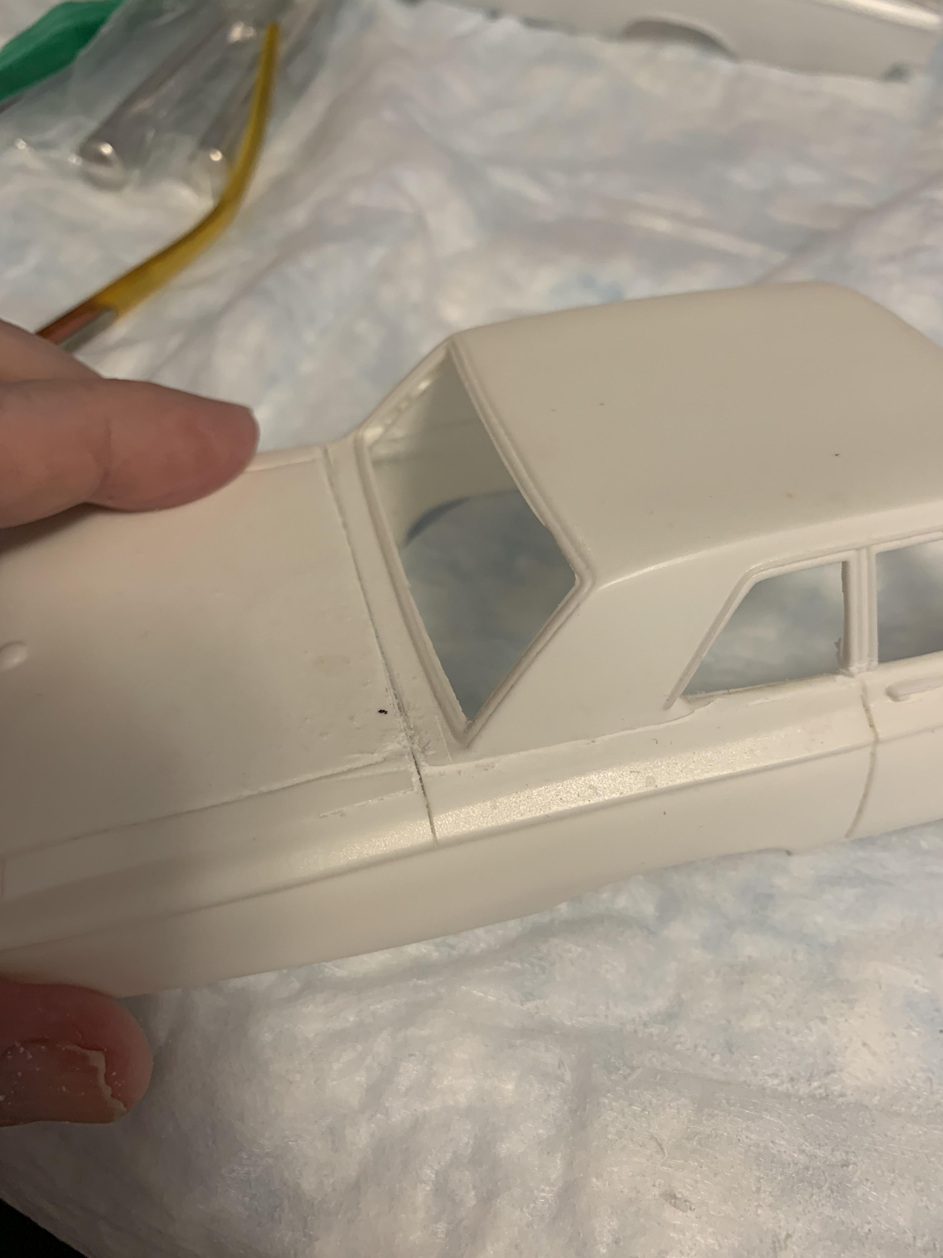

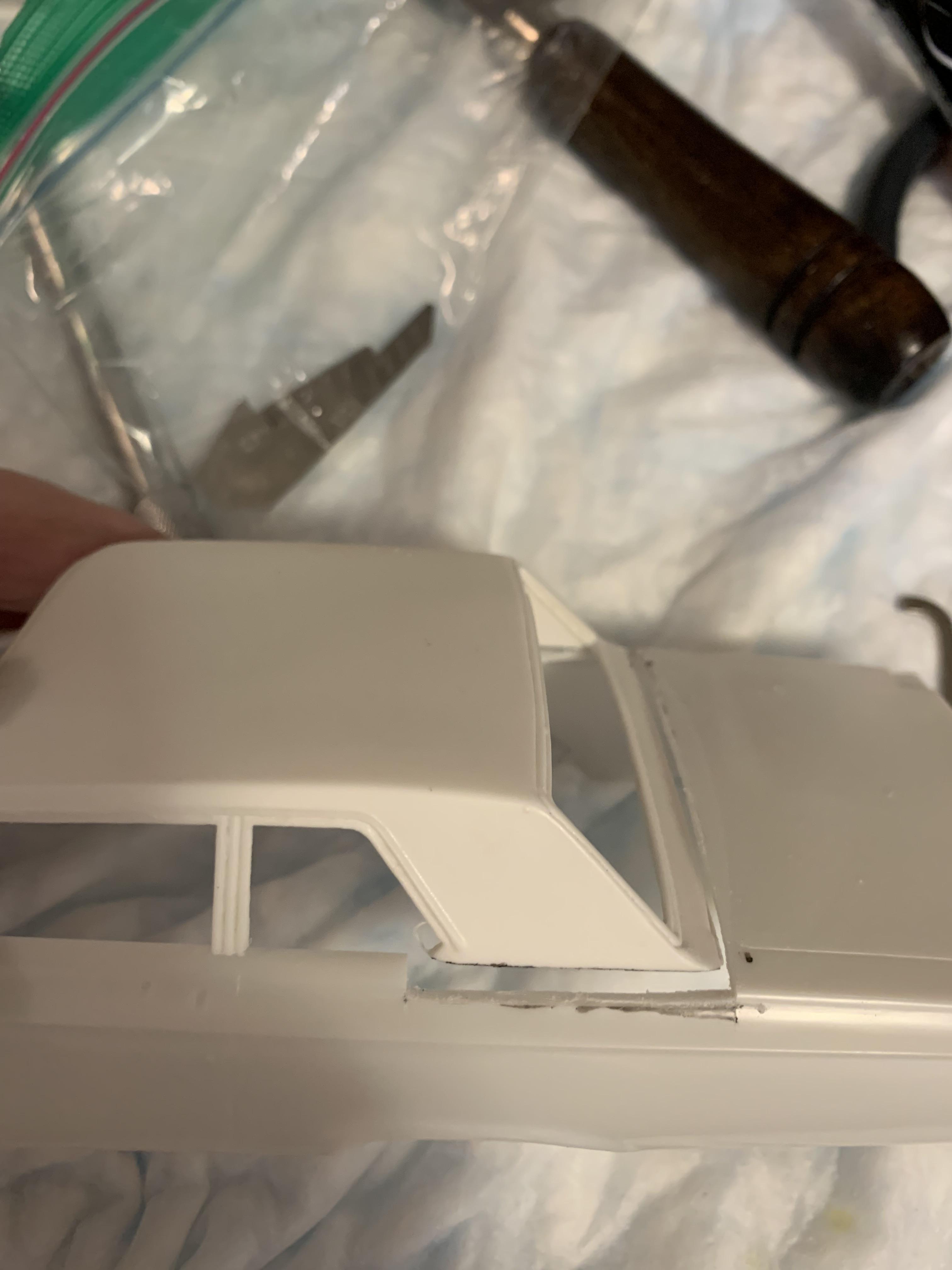

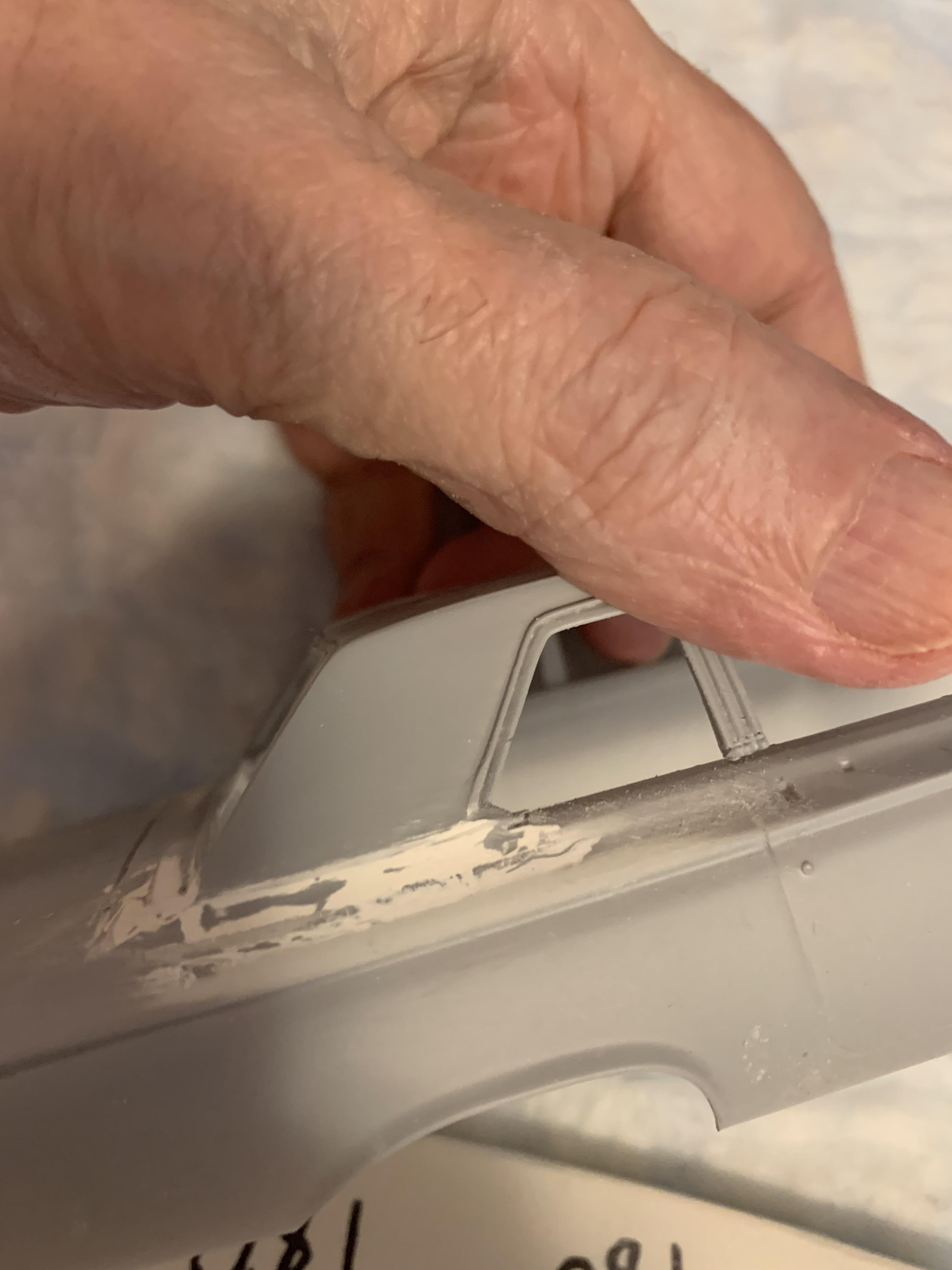

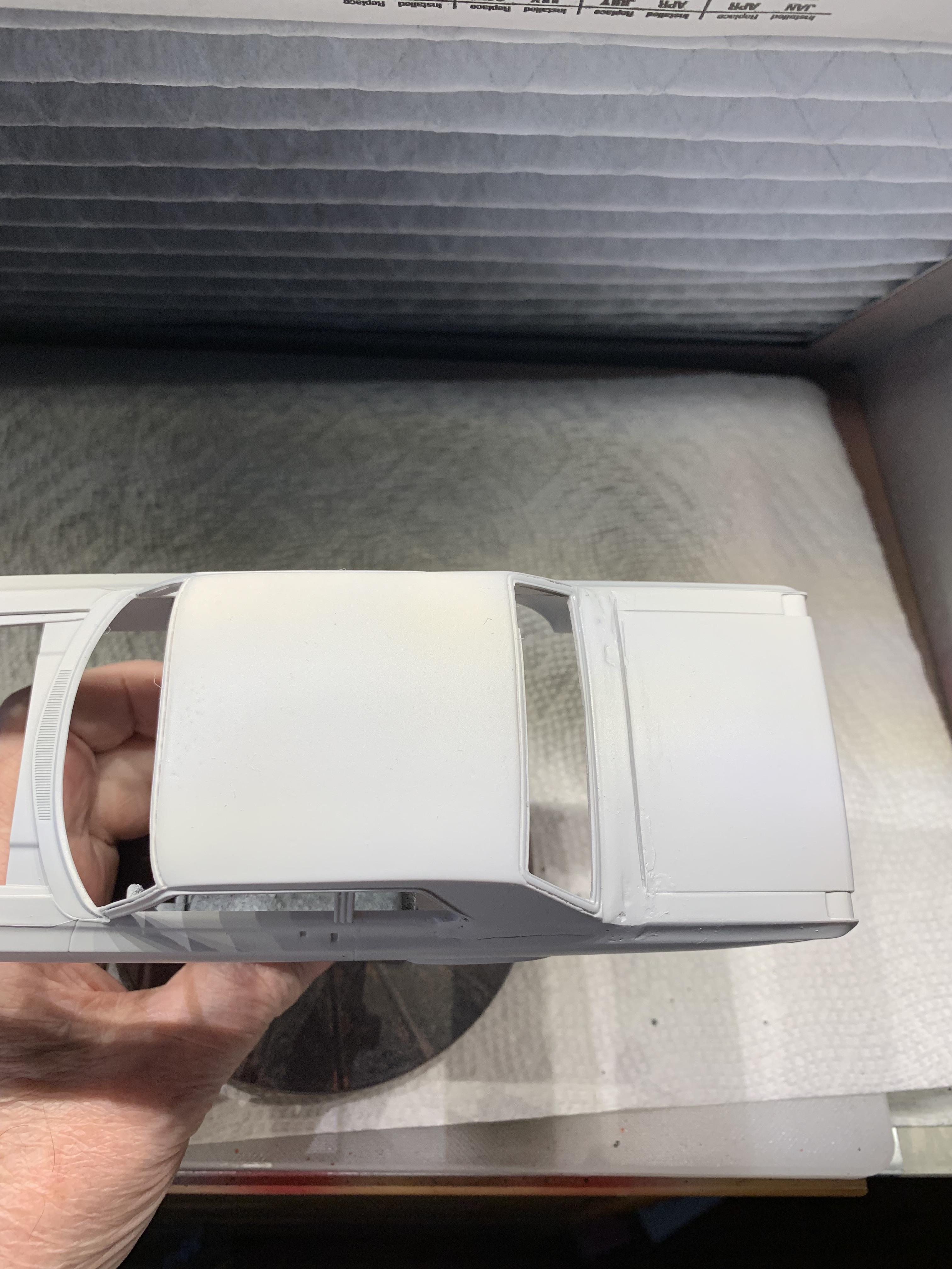

R. Thorne Posted November 16 Author Posted November 16 Closer, now back to my Agatha Christy book, while, hopefully the last batch of putty dries overnight. 6

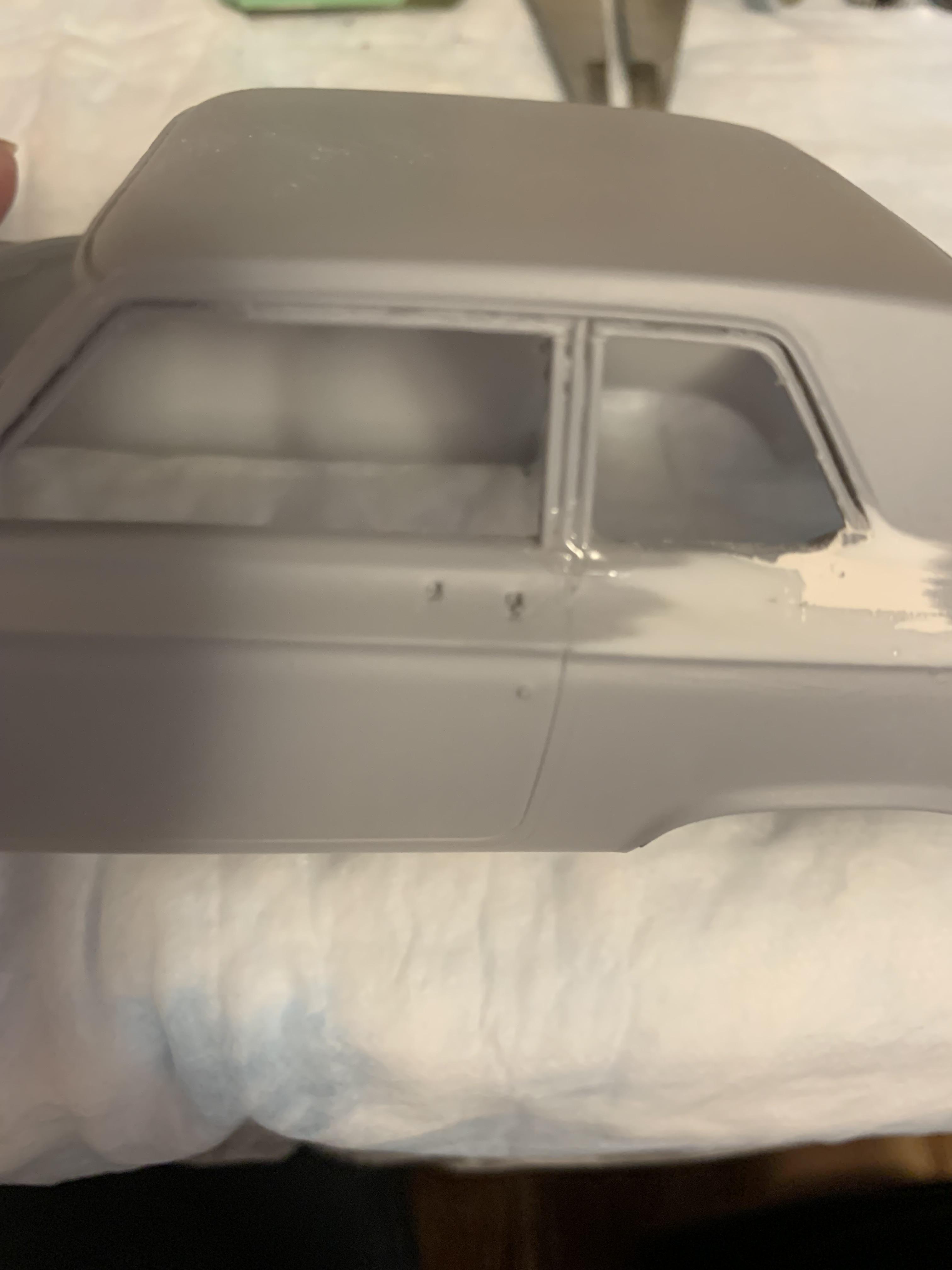

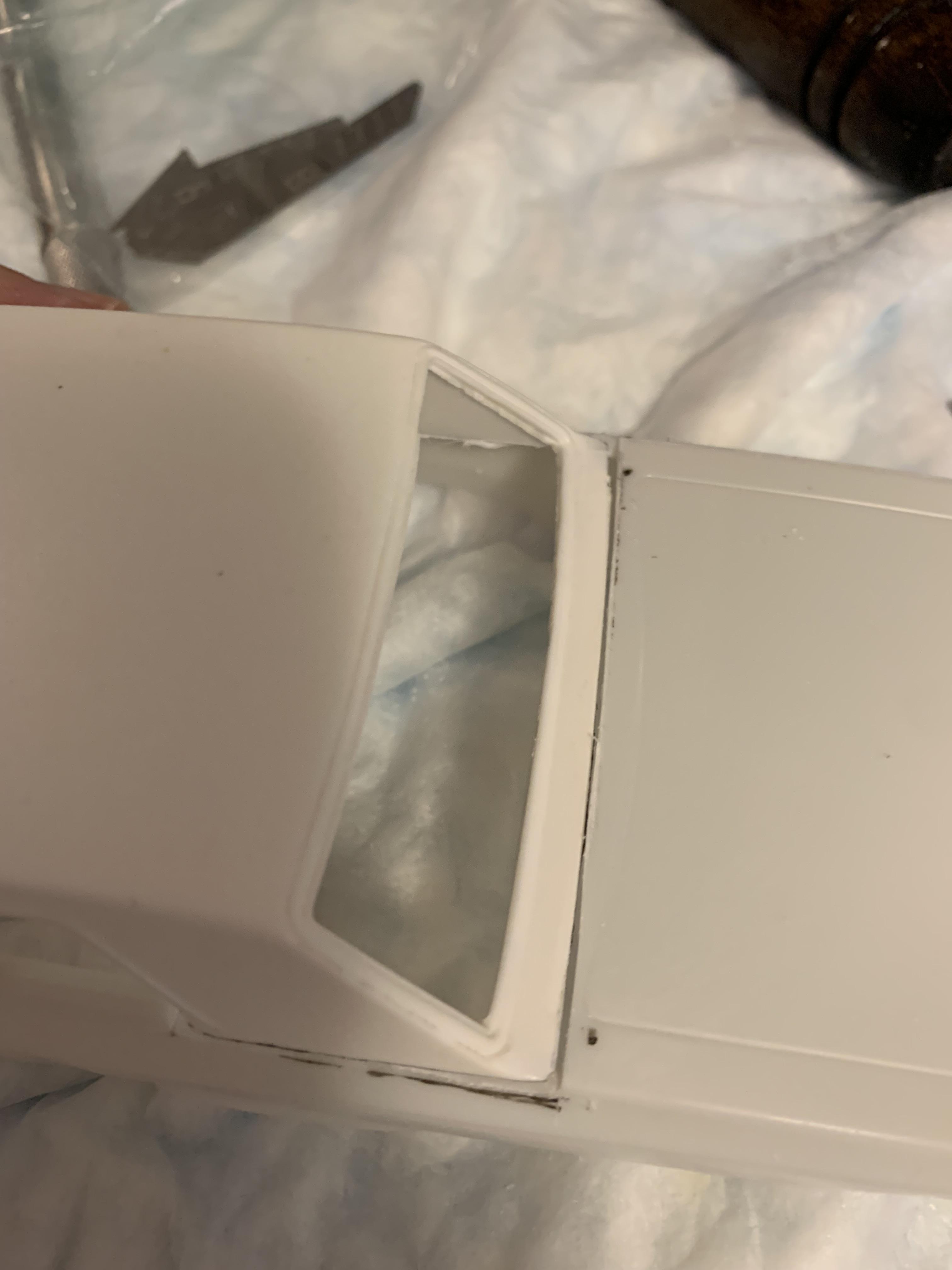

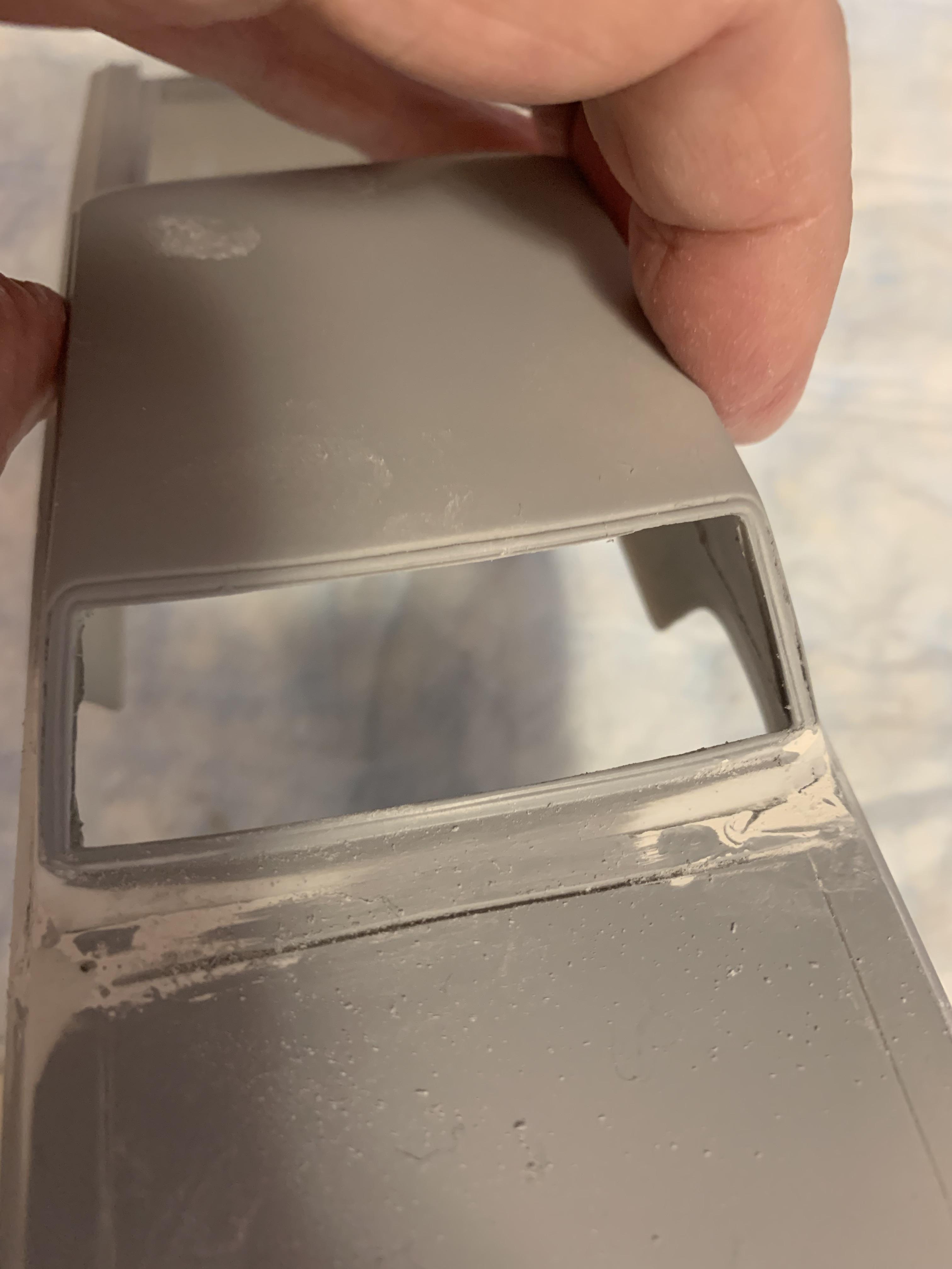

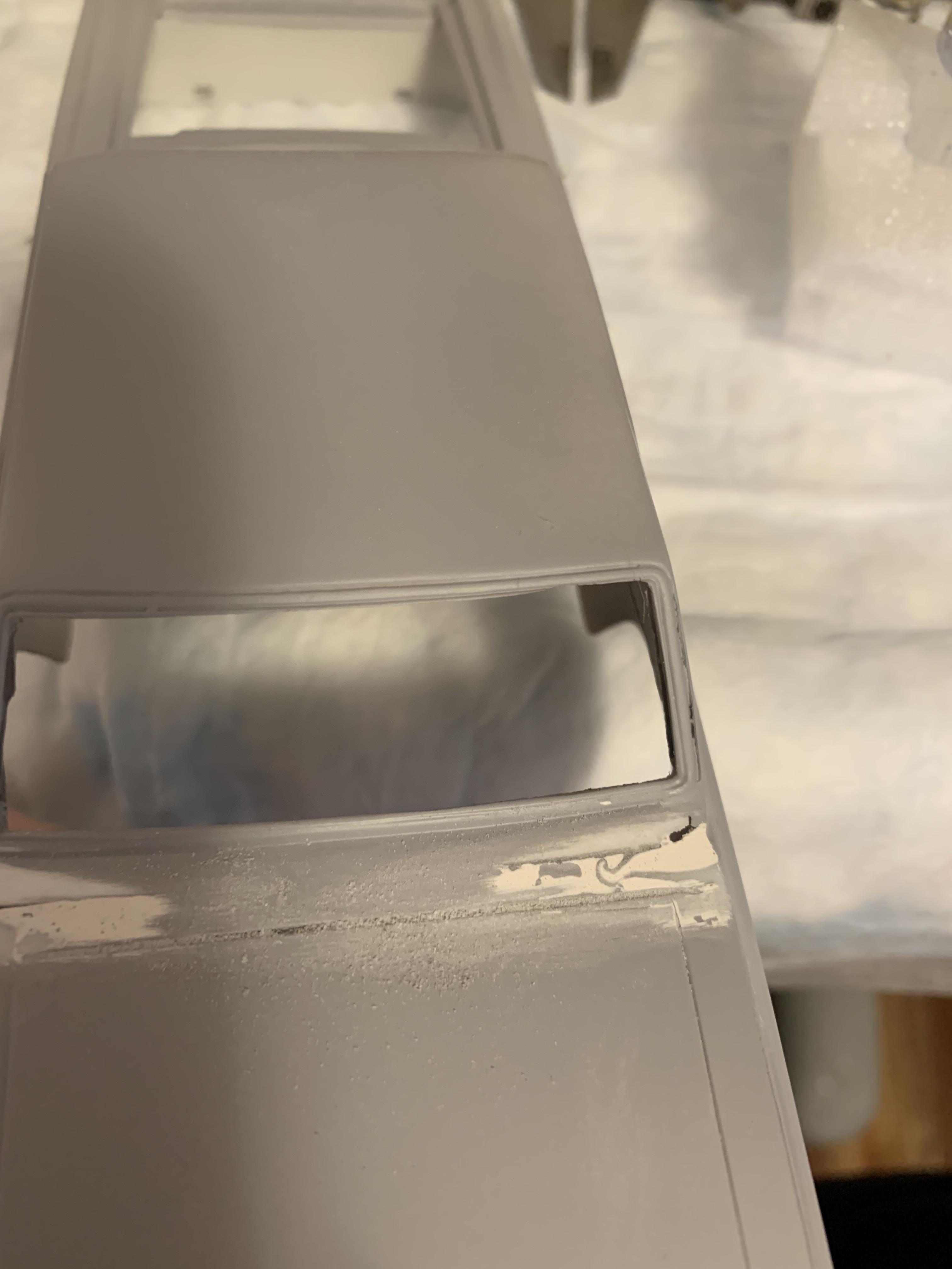

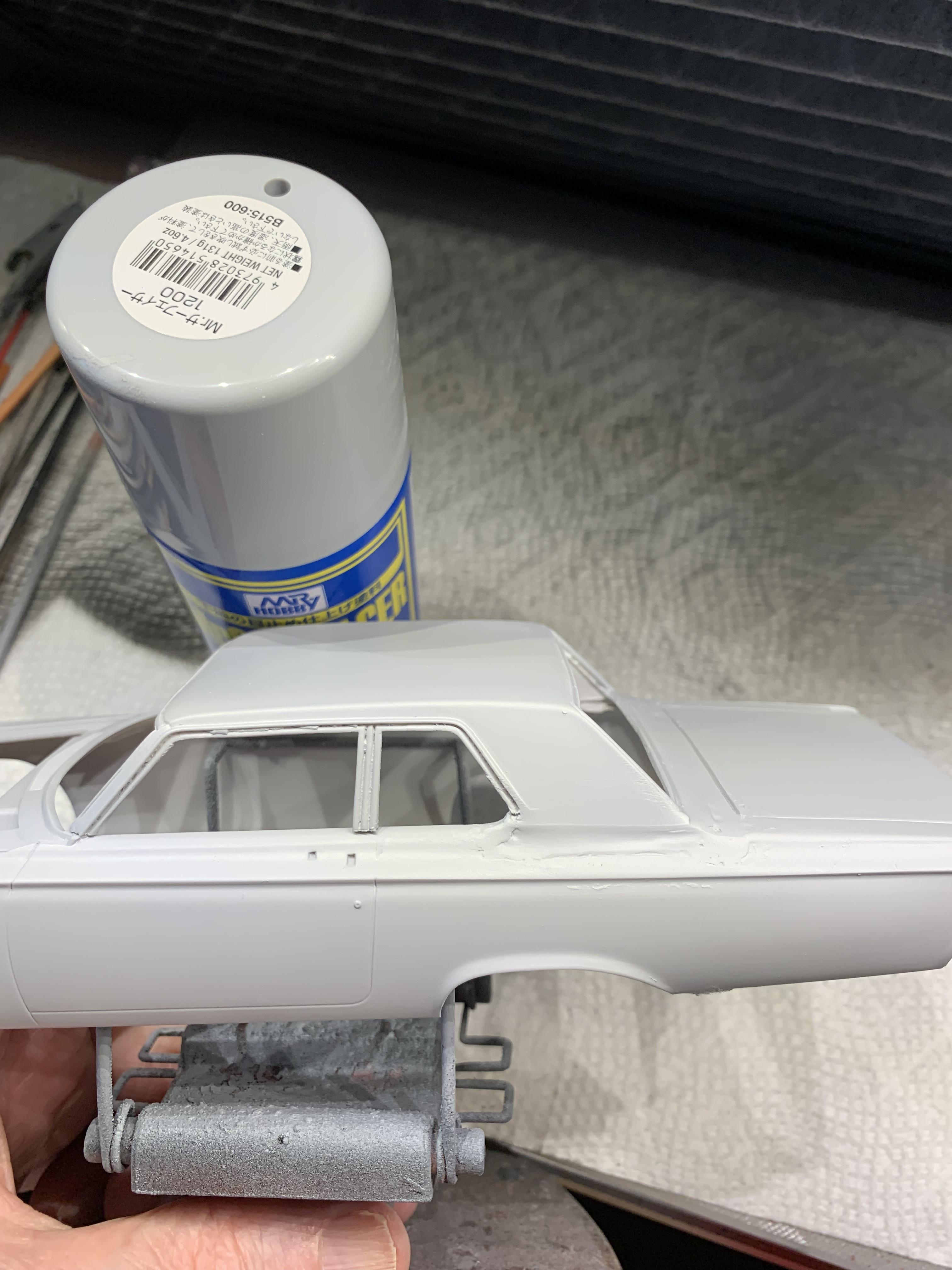

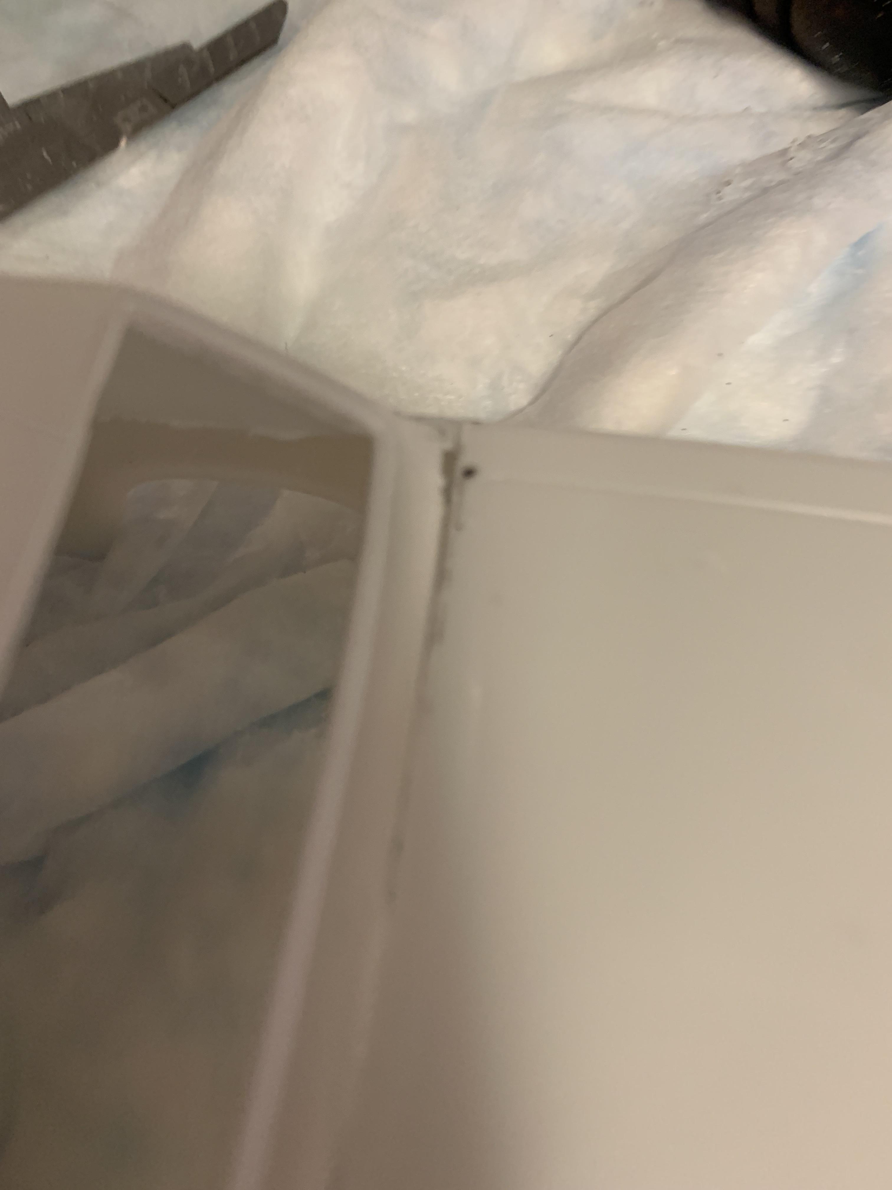

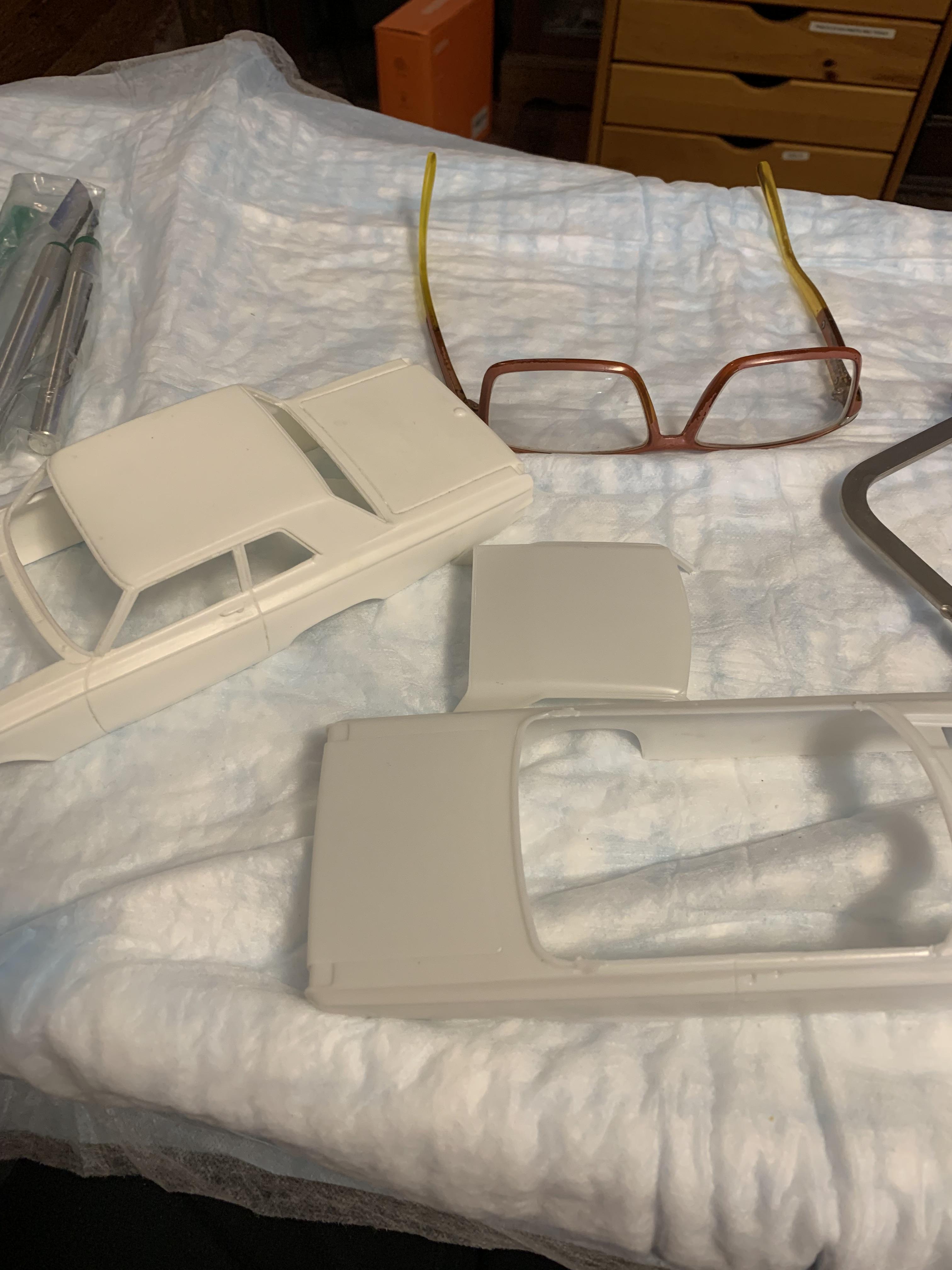

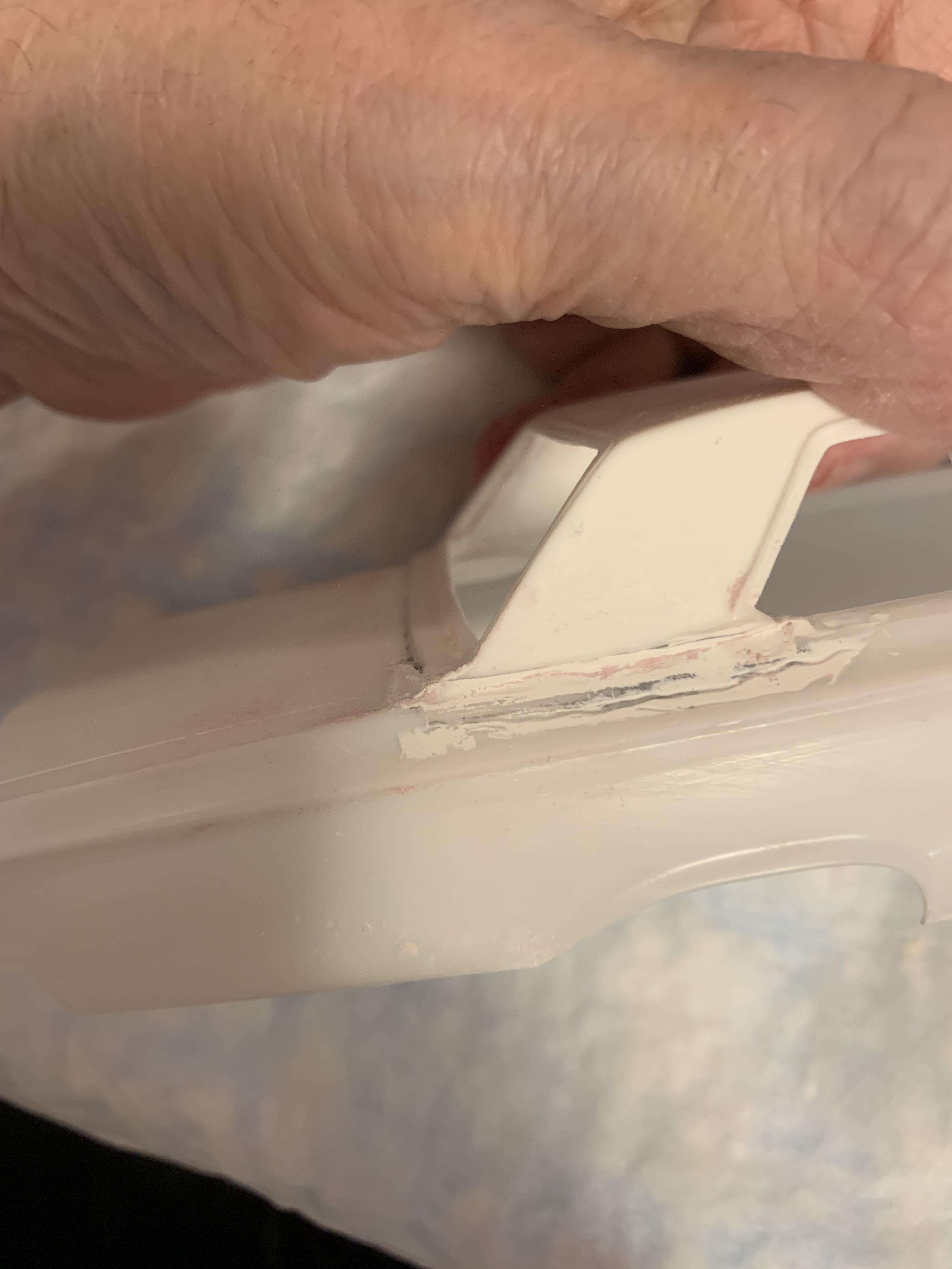

R. Thorne Posted November 16 Author Posted November 16 Some more sanding with the Ammo by Mig sanding stick mainly (wish someone made a round version of them). May just make my own out of 1/8” styrene rod and some foam backed sandpaper. Cleaned the top with some 70% alcohol wipes and put some primer on to show all the bad places up. 1

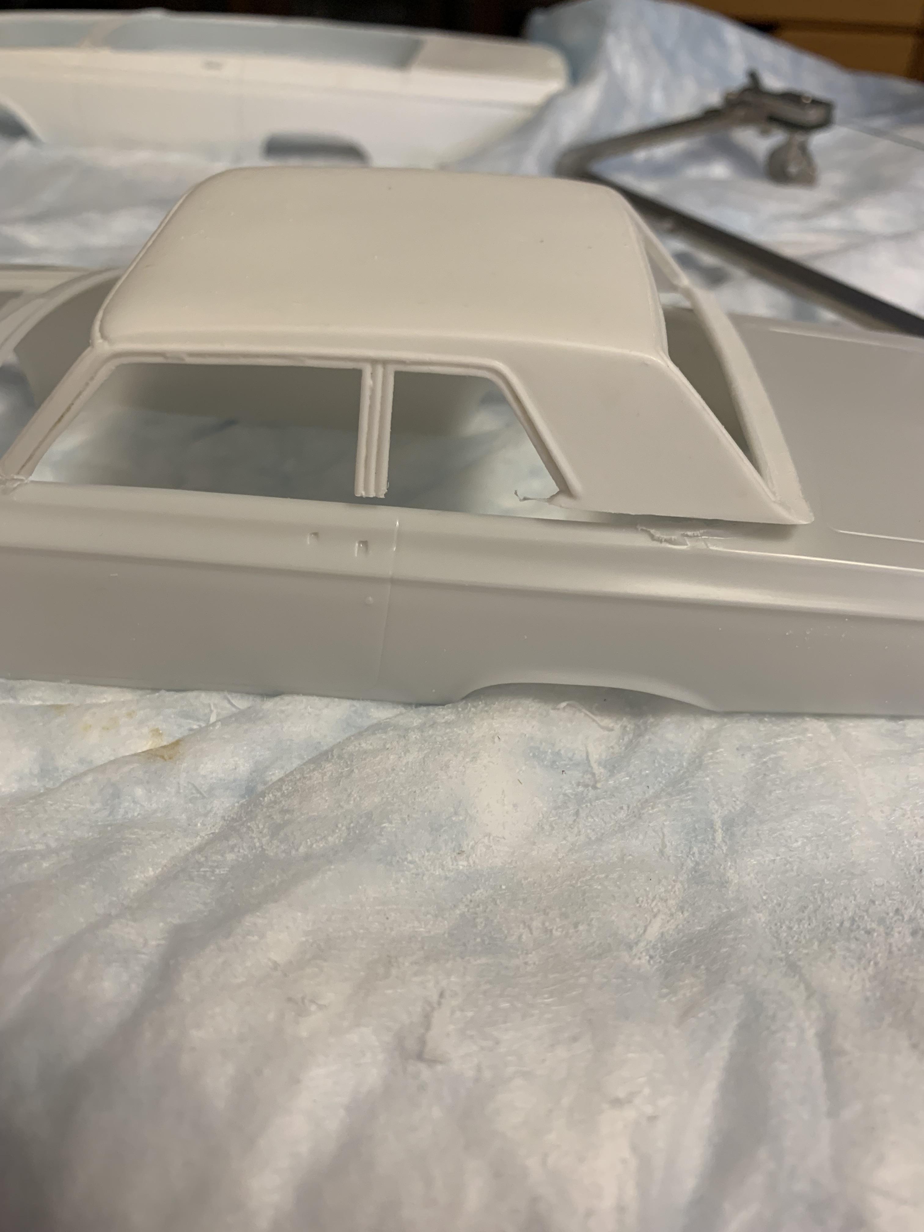

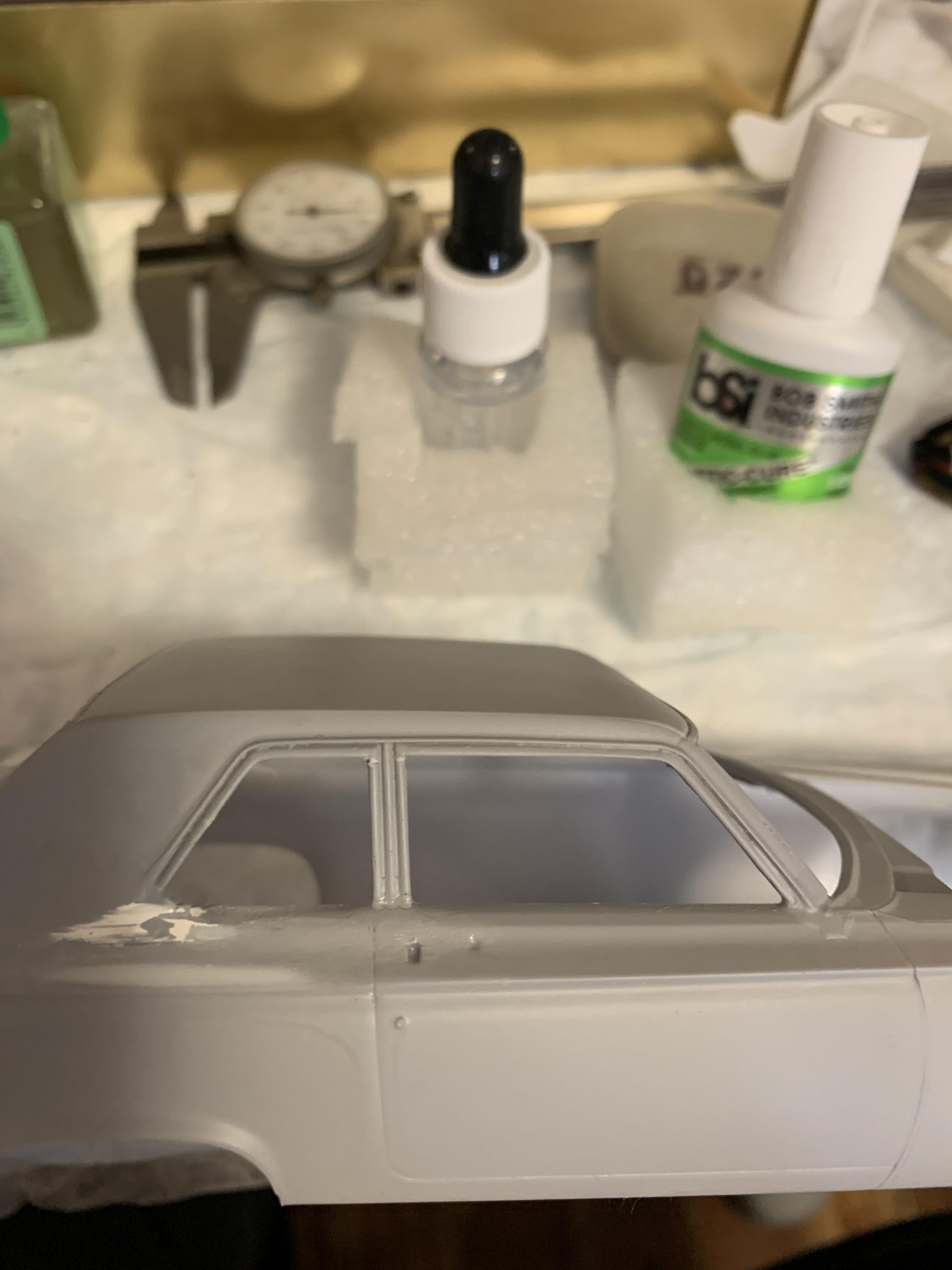

R. Thorne Posted November 16 Author Posted November 16 Showed the wrong picture of the Grand Spaulding blown car. This is the sedan car. 3

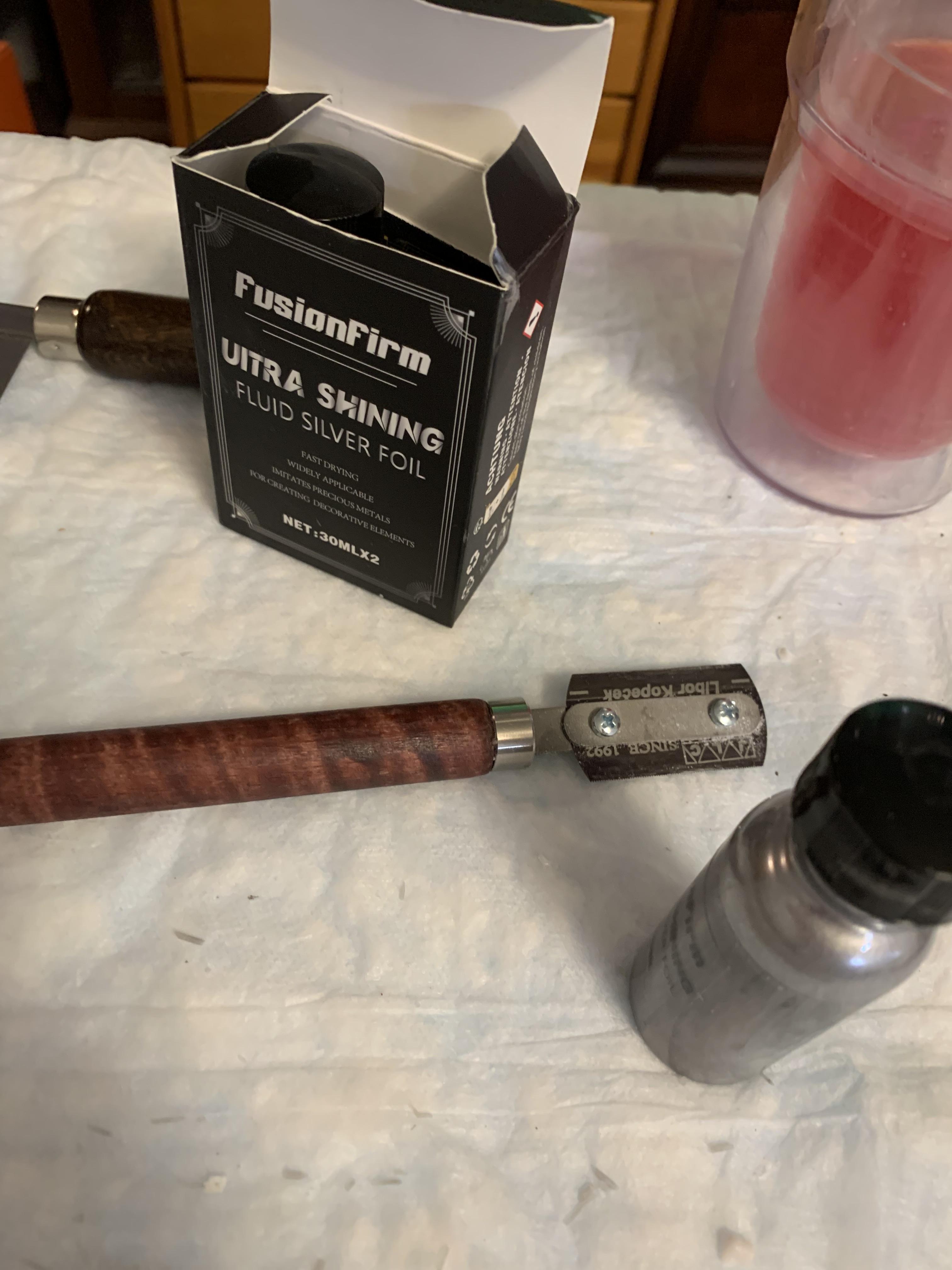

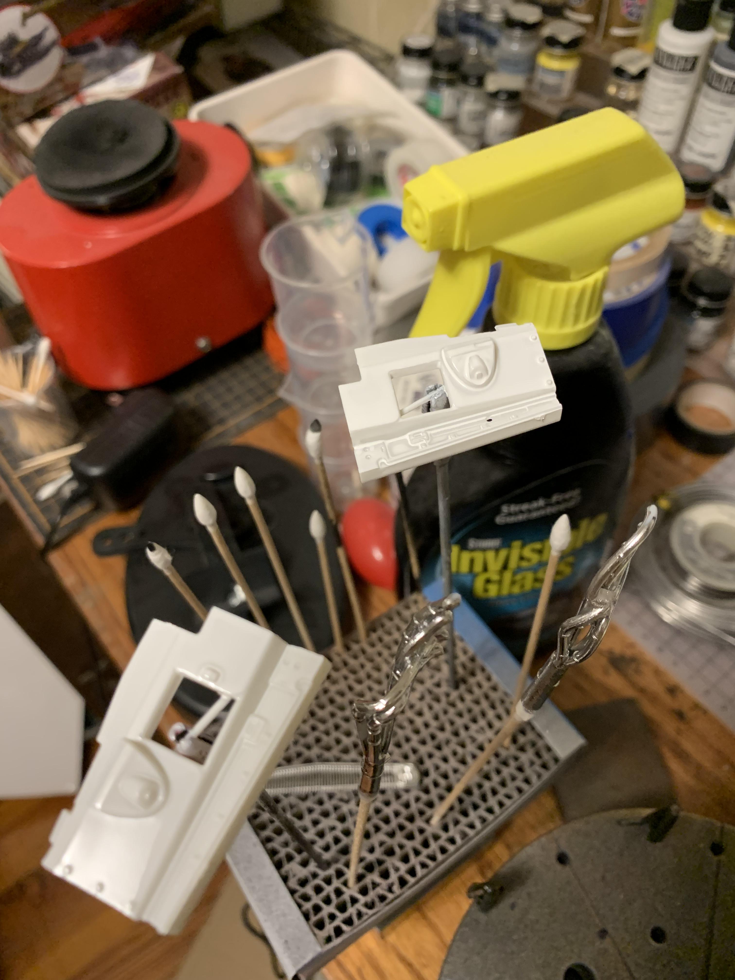

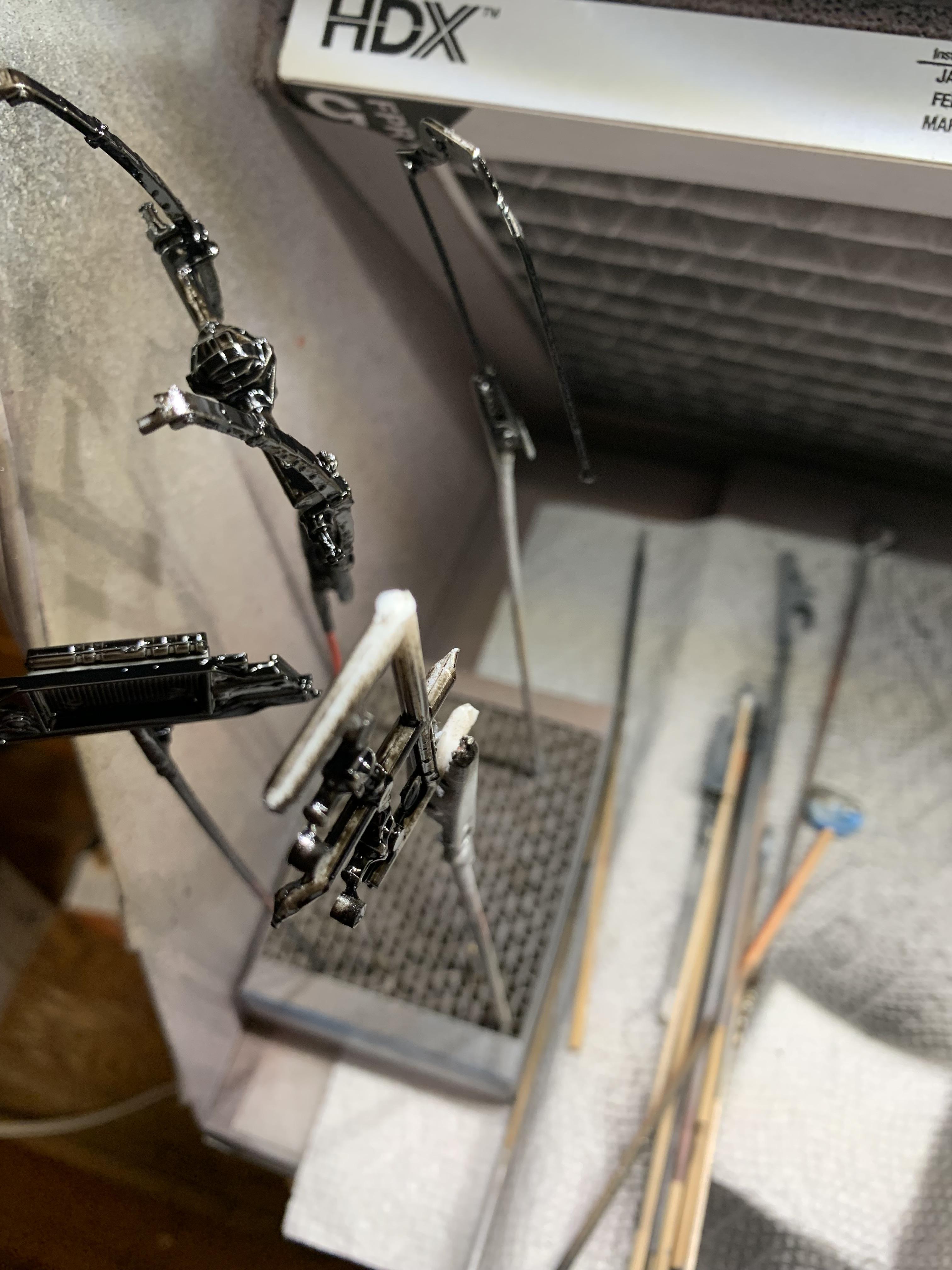

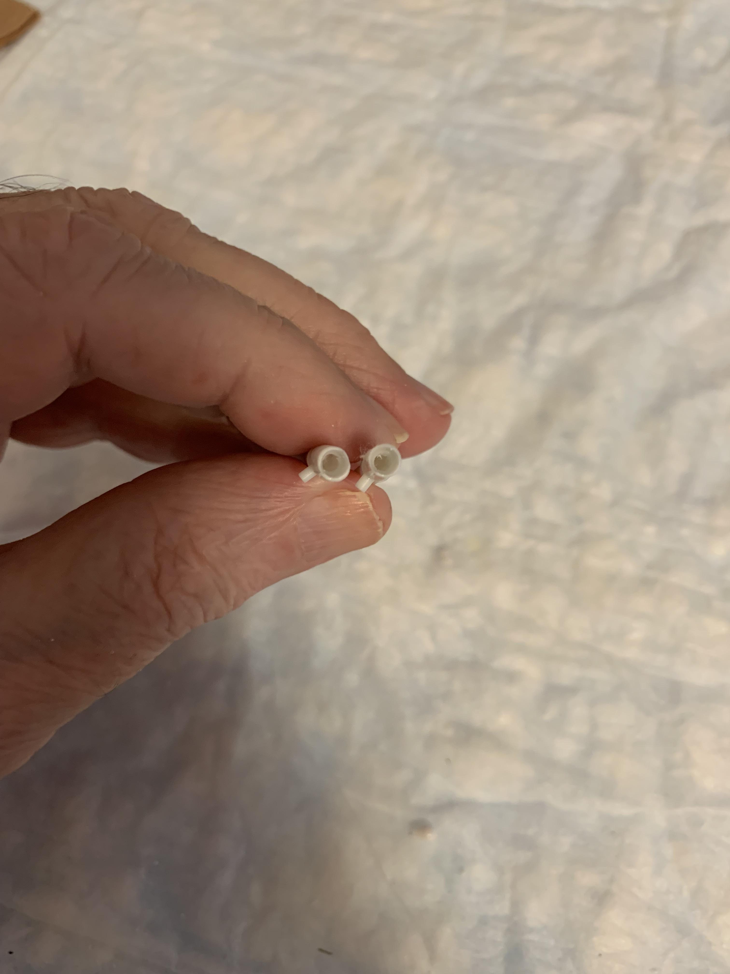

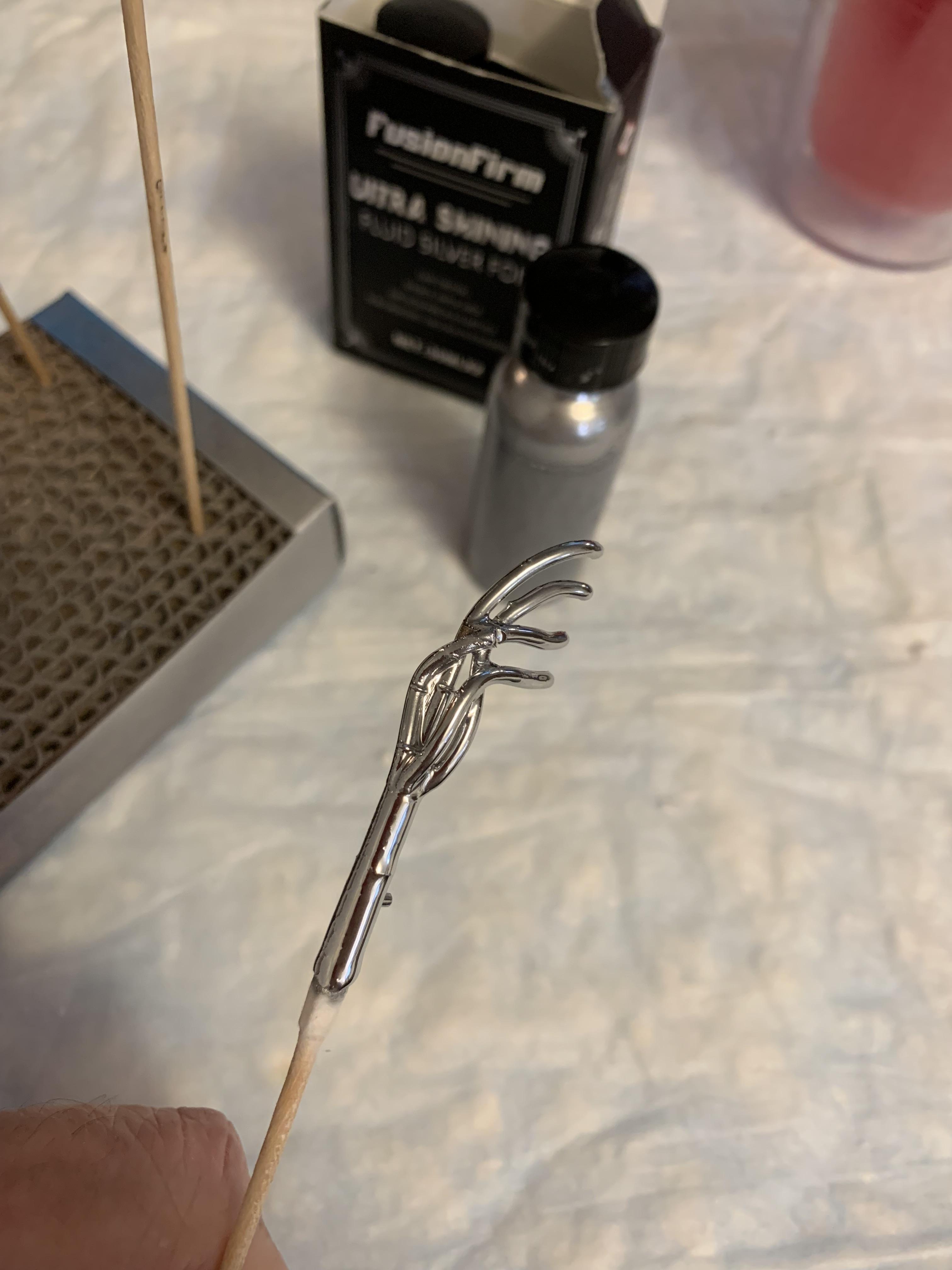

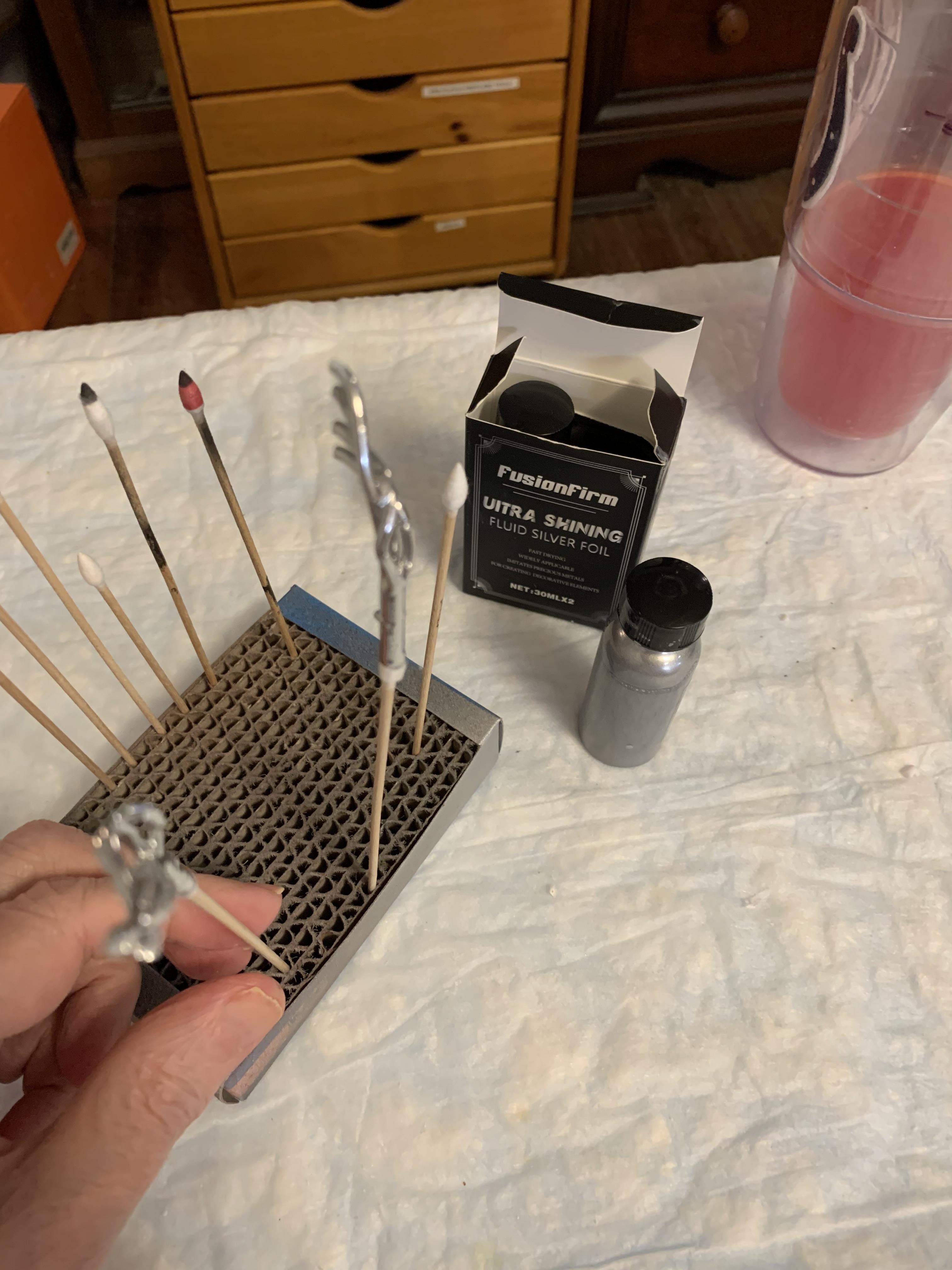

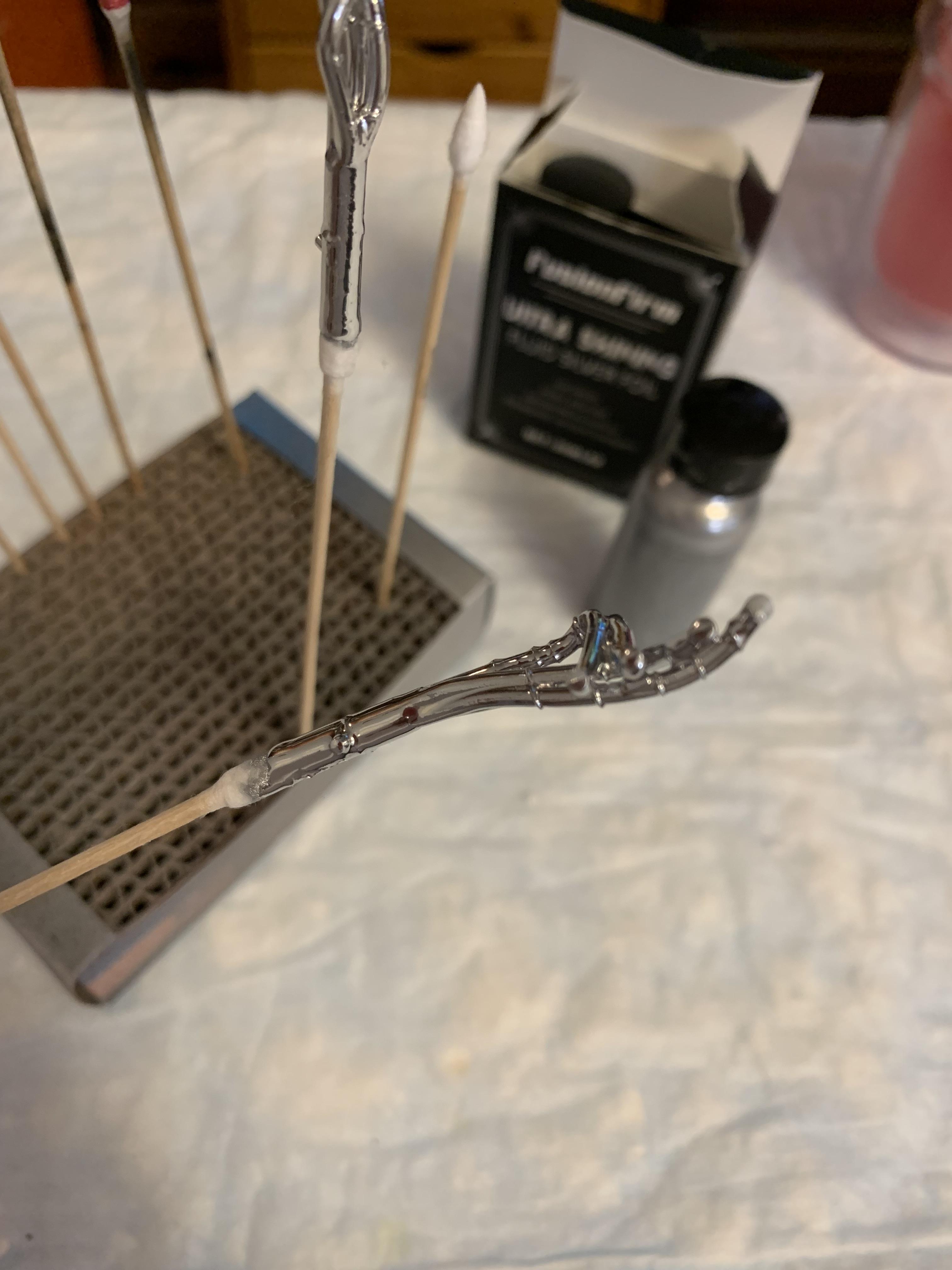

R. Thorne Posted November 18 Author Posted November 18 Reamed out the collectors and put some FusionFirm on. 1

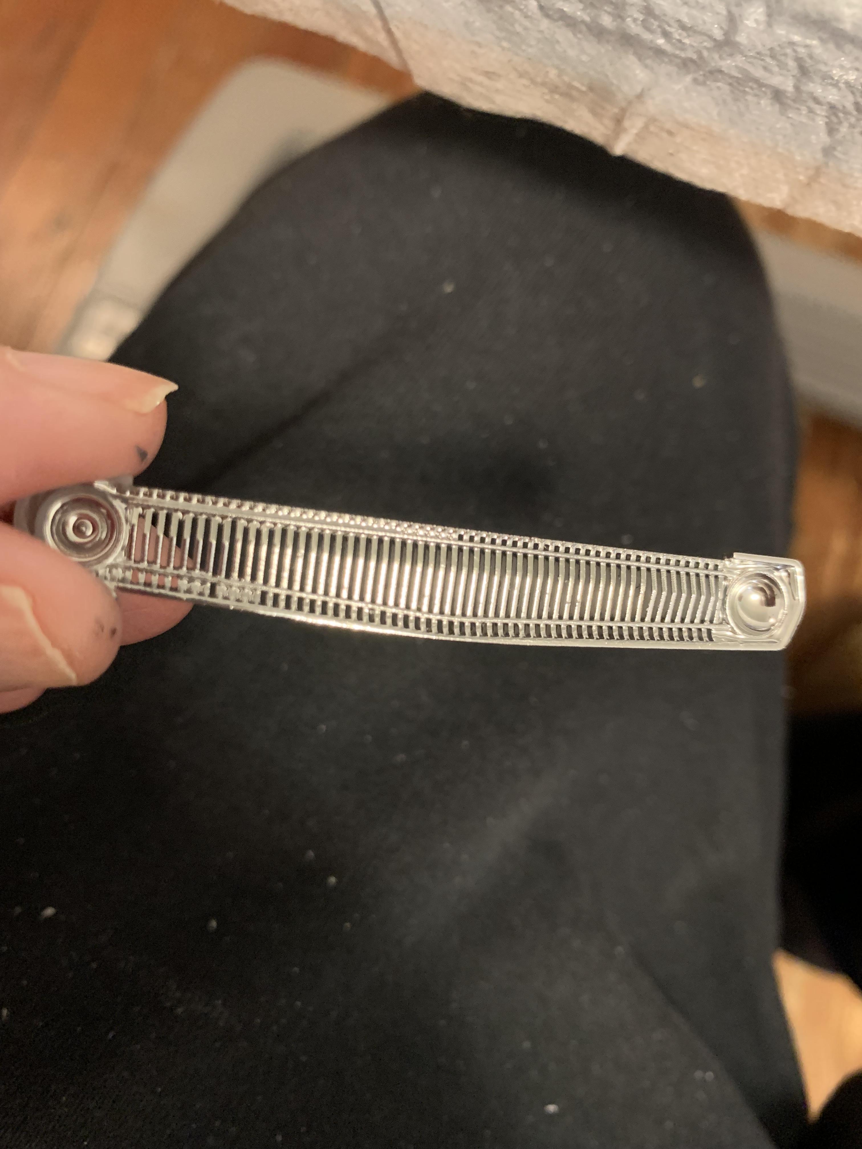

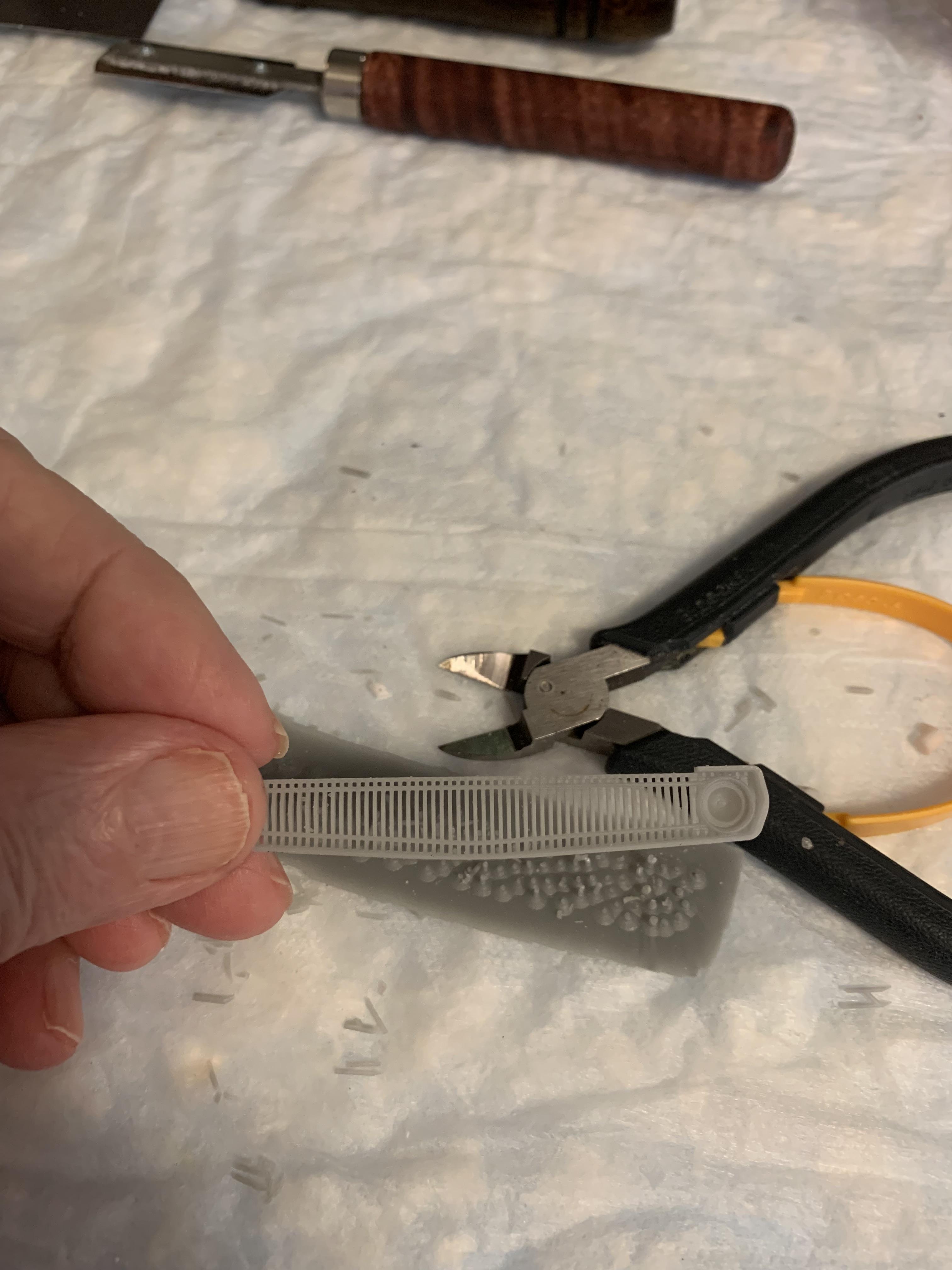

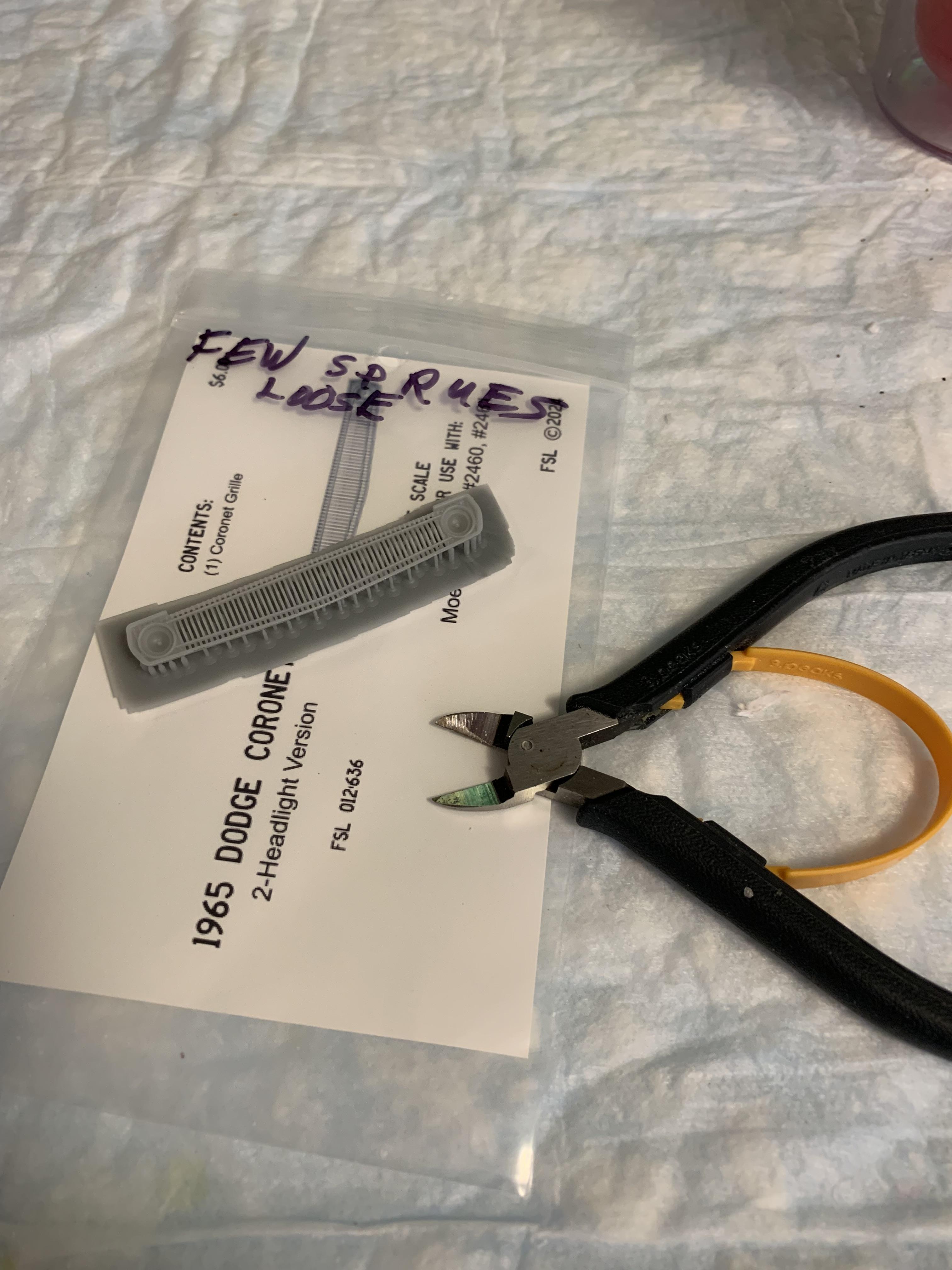

R. Thorne Posted November 18 Author Posted November 18 Worked on my aftermarket grille from FewSpruesLoose. Got it loose from its mounting with my irreplaceable pliars, then brushed on some FusionFirm. I was concerned that it might fill up the tiny holes in the grille, but then I remembered how thin it was when I put some on a 53 Olds resin bumper and it showed all the imperfections. 3

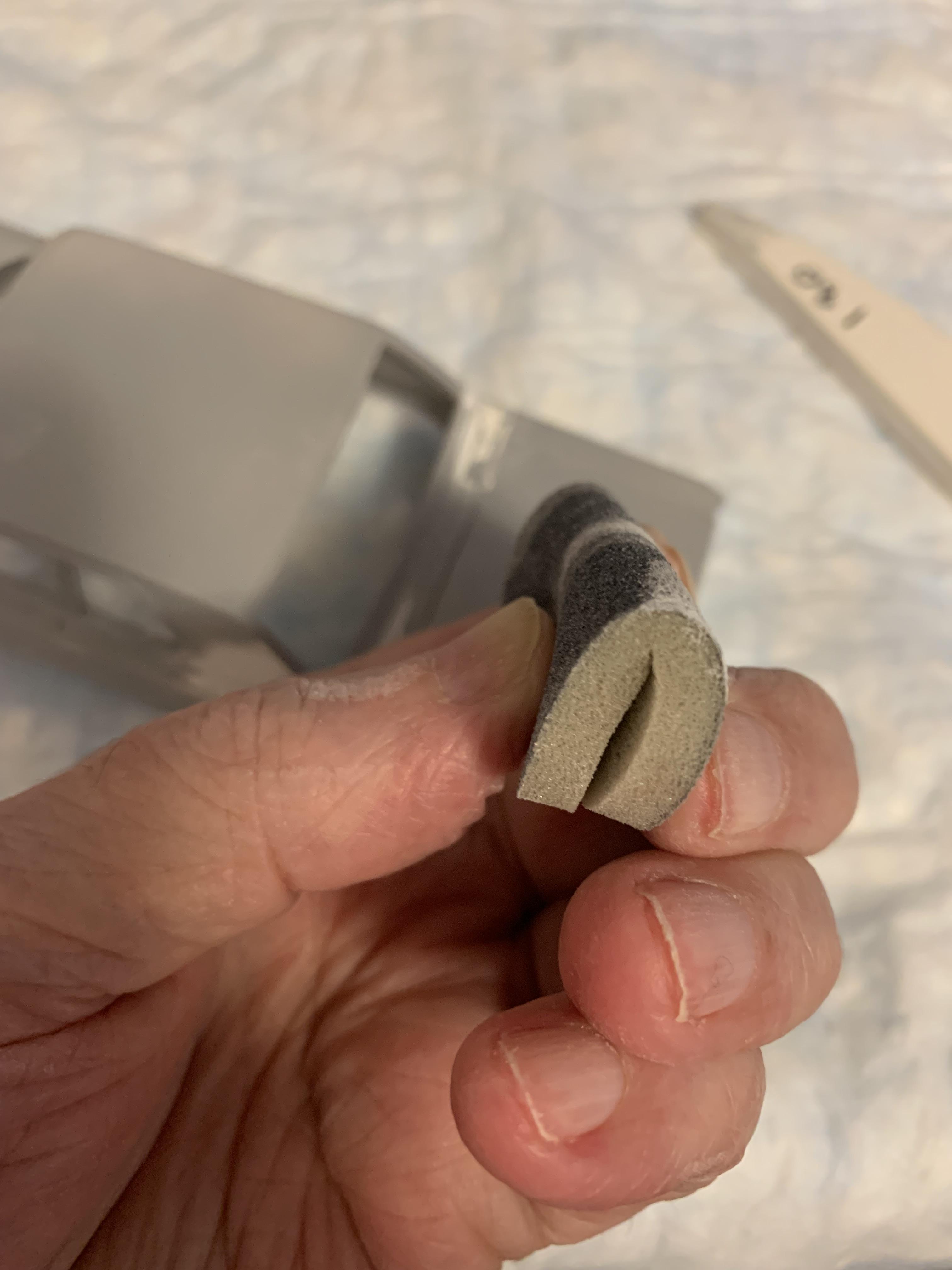

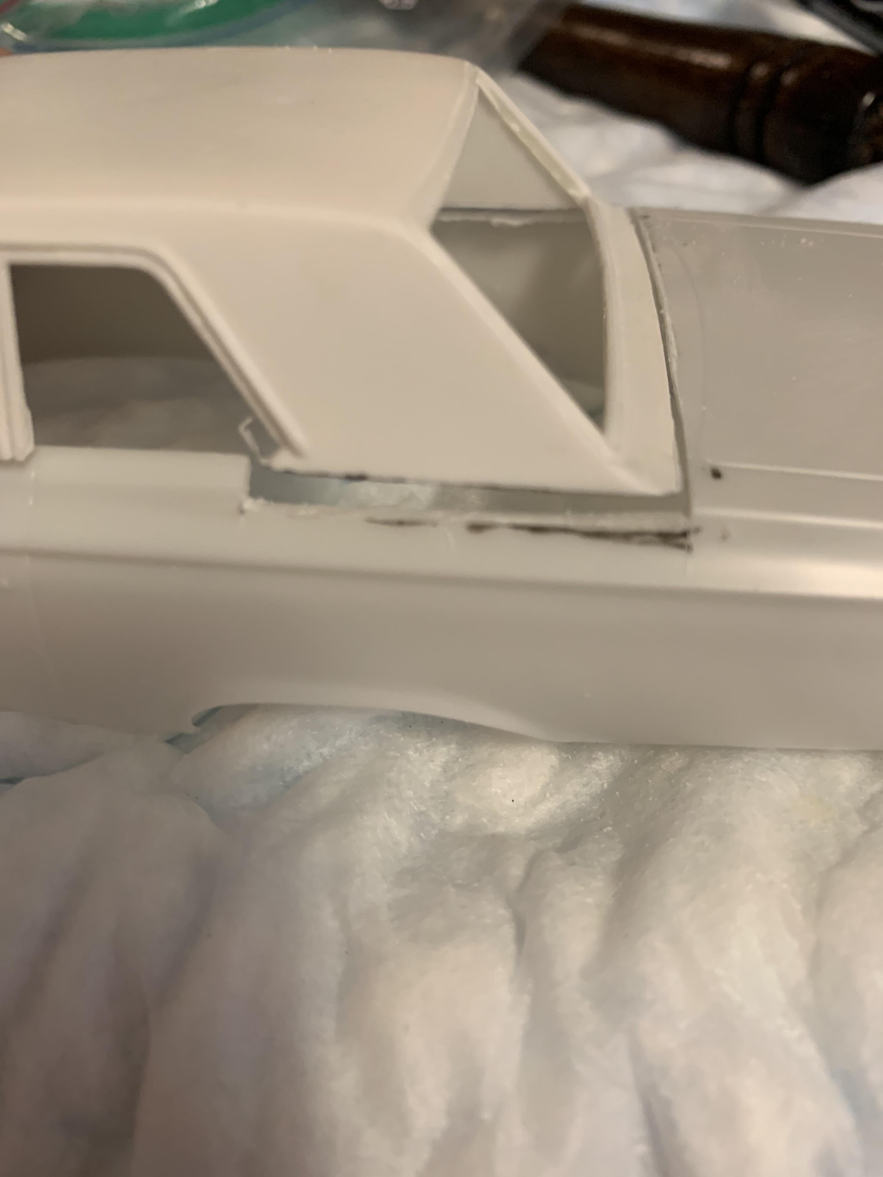

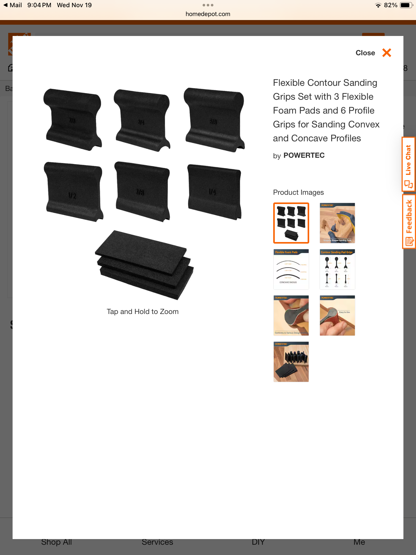

R. Thorne Posted November 20 Author Posted November 20 9 hours ago, Hemifever said: Wow Ron that's a heck of an undertaking, but it looks great so far. Never heard of Fusion Firm, but it looks good on the headers. Grill is awesome. That Nova stocker you built a while back was the inspiration for my current stocker build, and you provided some great research pics in that build also. Always look forward to your builds. Thank you, Dennis. What are we here for if not to help and, possibly, inspire others. If you look on page 2 of the tips & tricks section, you will find a thread I started on FusionFirm chrome. Anyway, got a little sanding done on the top. When it’s dried off I will put some more primer on to see what else it needs. I like the sponge pads doubled over and the tapered foam sanding sticks with a different grit on each side.

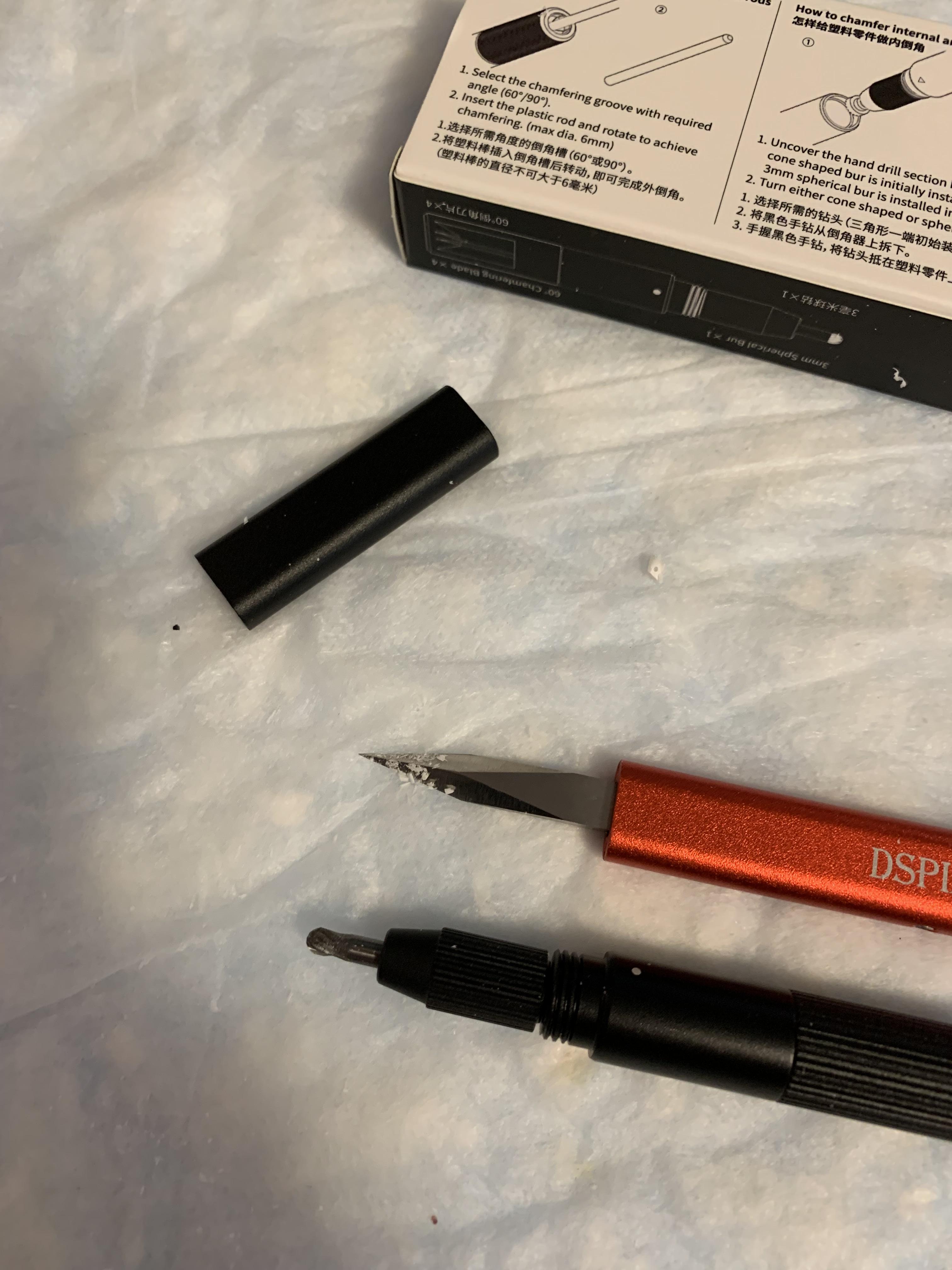

R. Thorne Posted November 20 Author Posted November 20 I did order some of these to try in the future. Free delivery from HomeDepot.

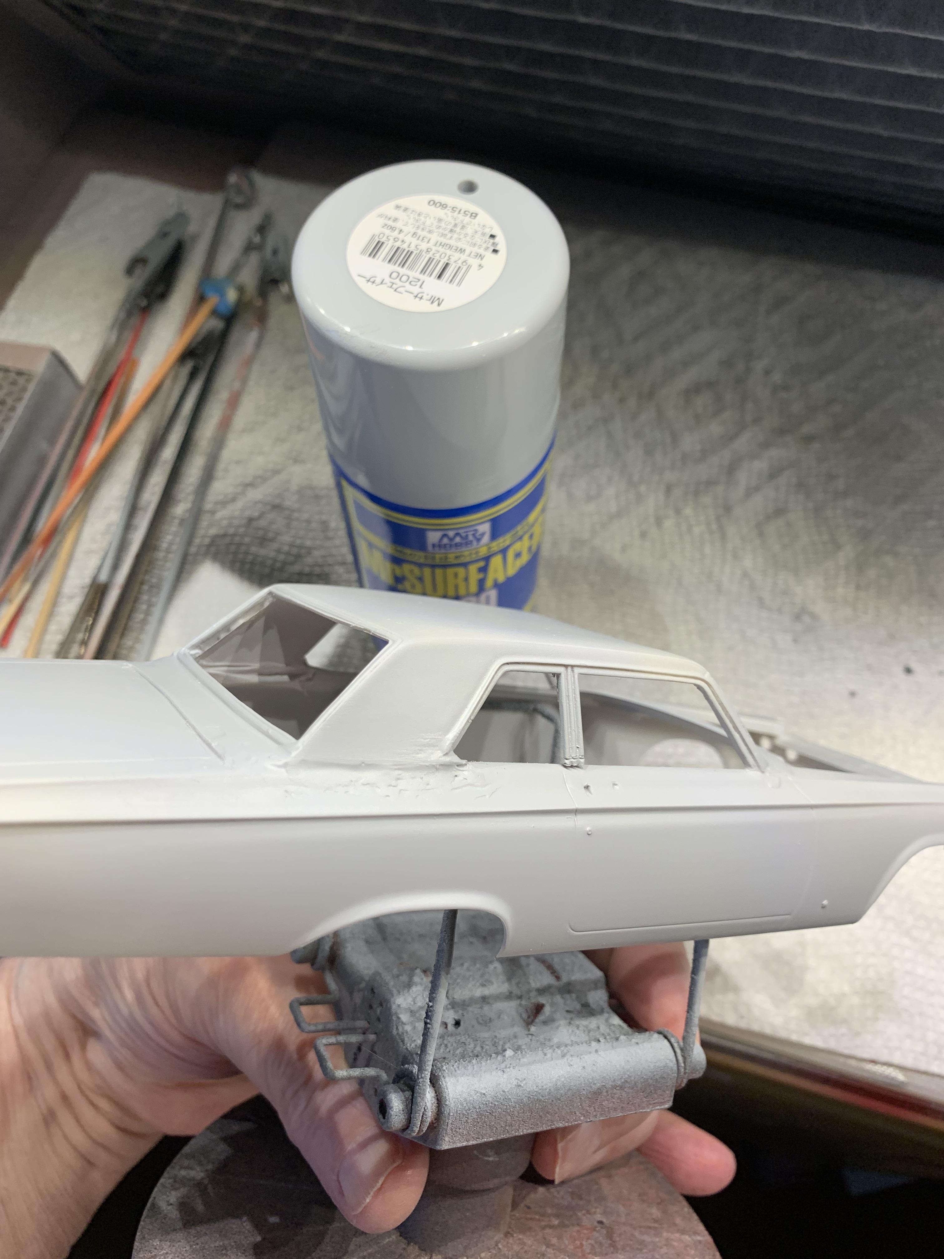

R. Thorne Posted November 21 Author Posted November 21 Painted a few items and put another light coat of primer on the body.

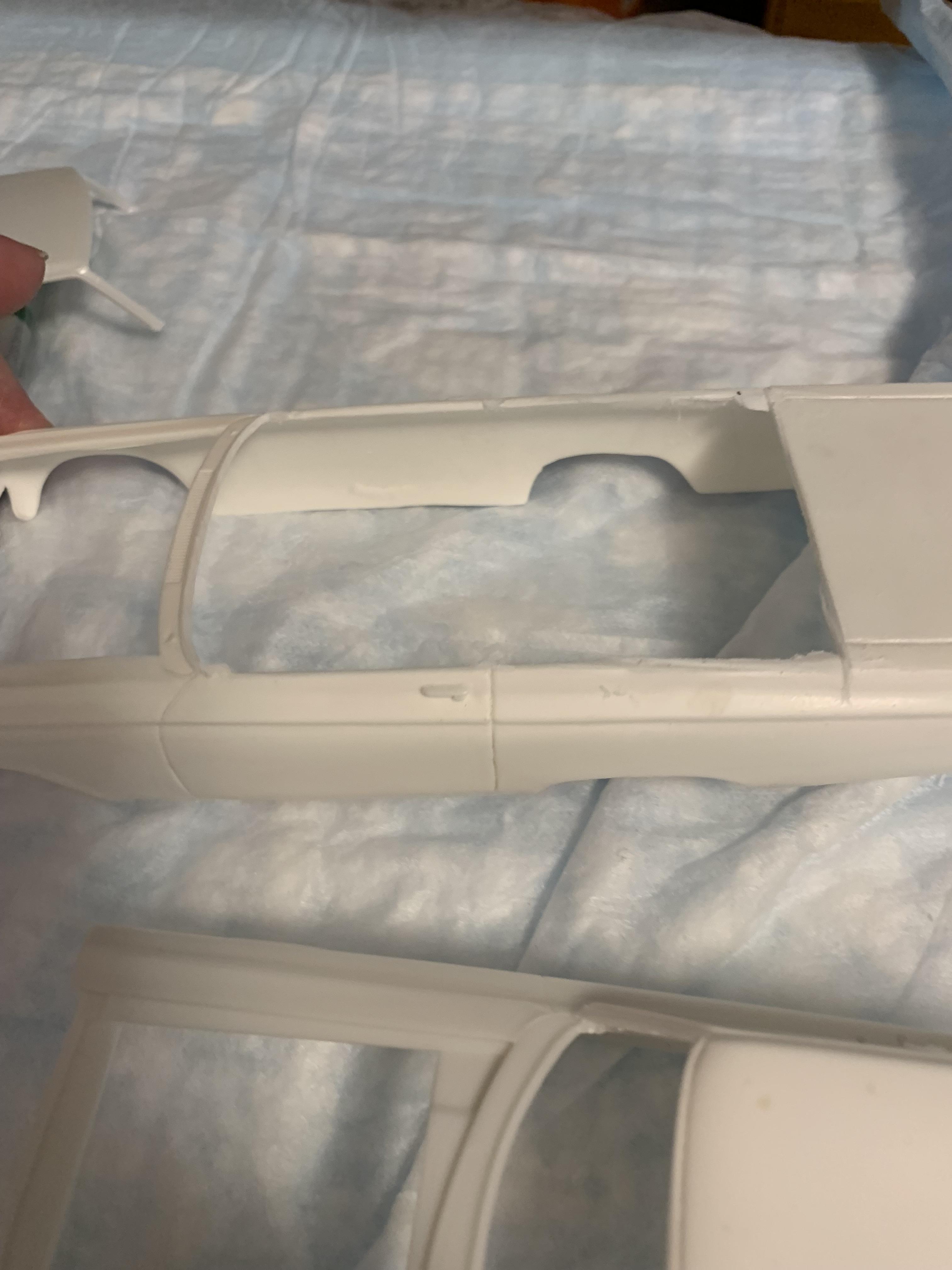

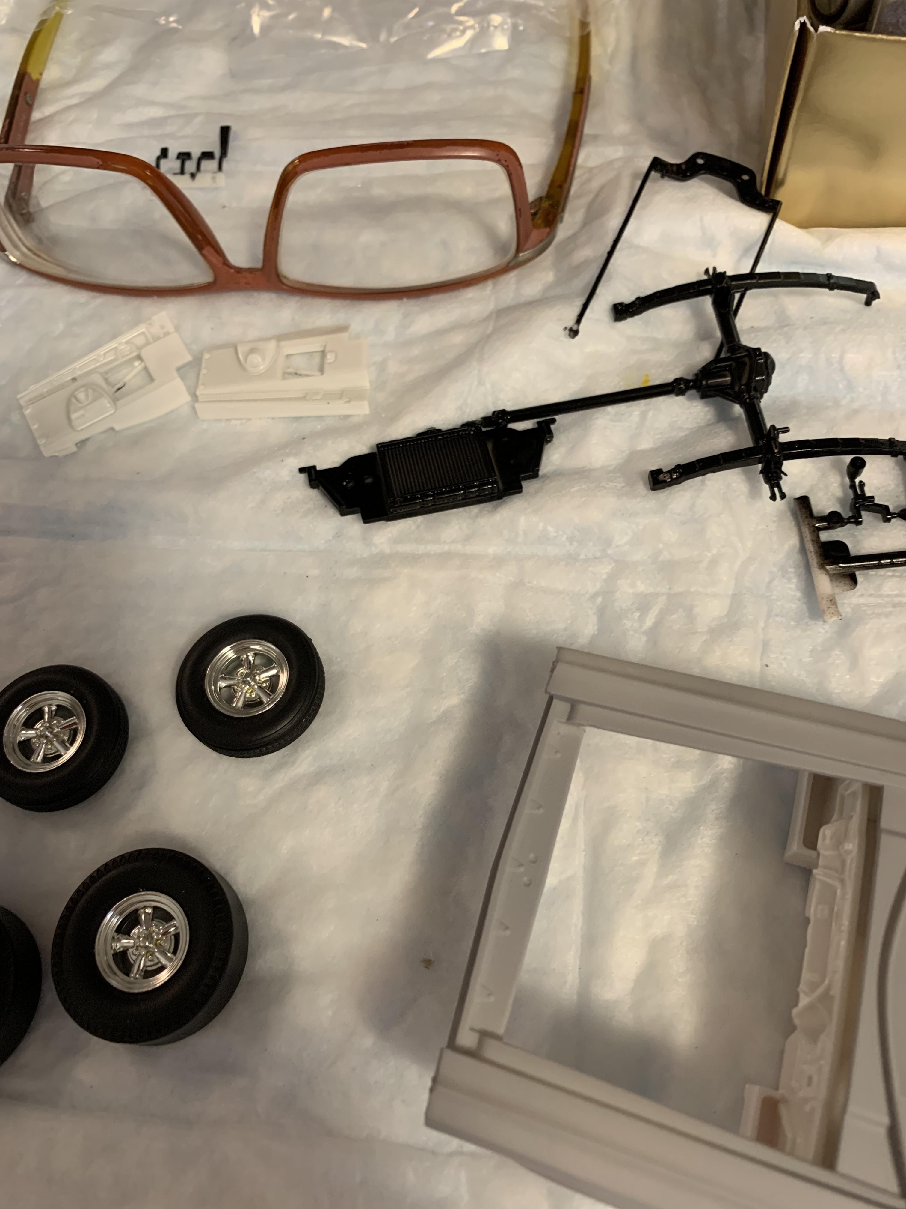

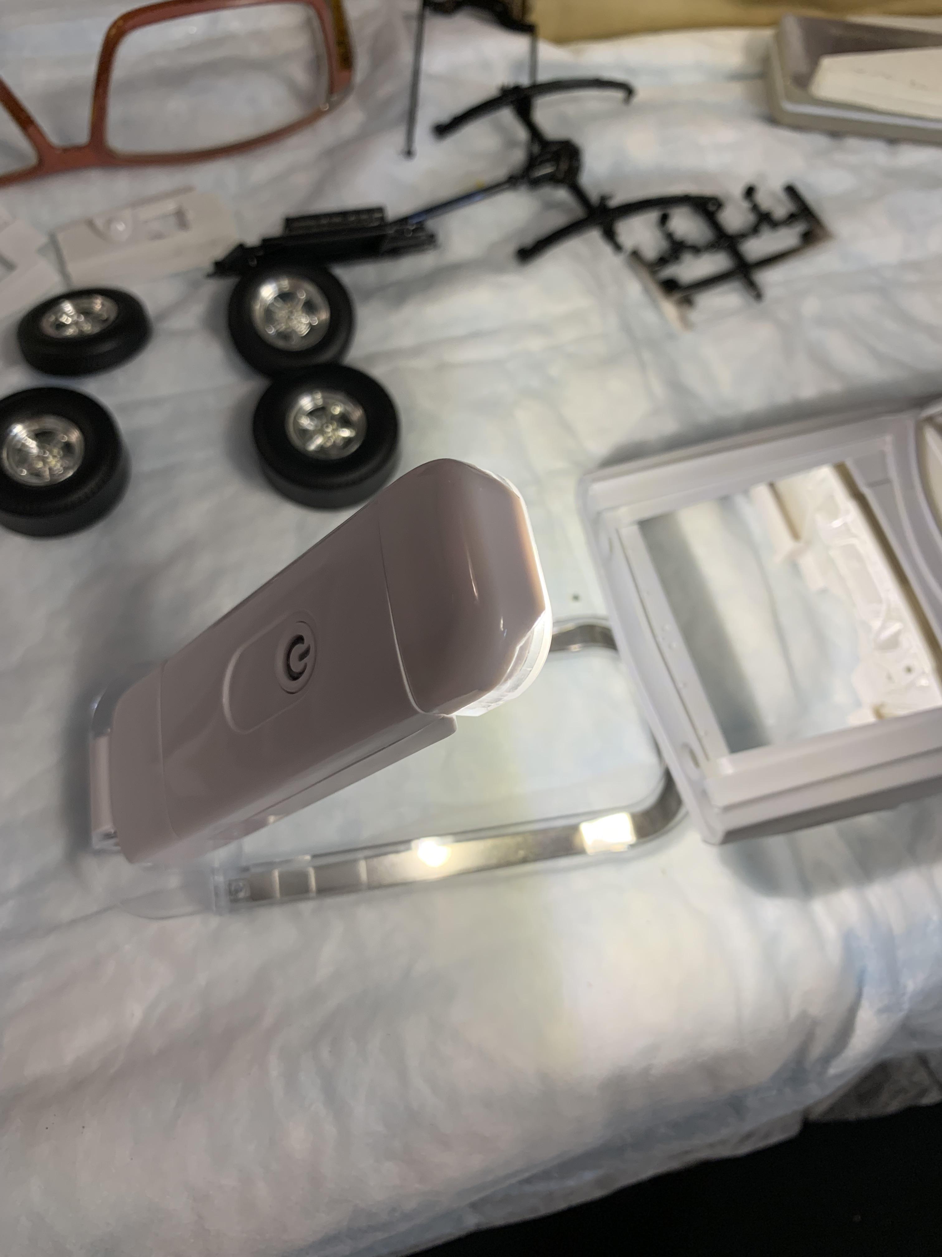

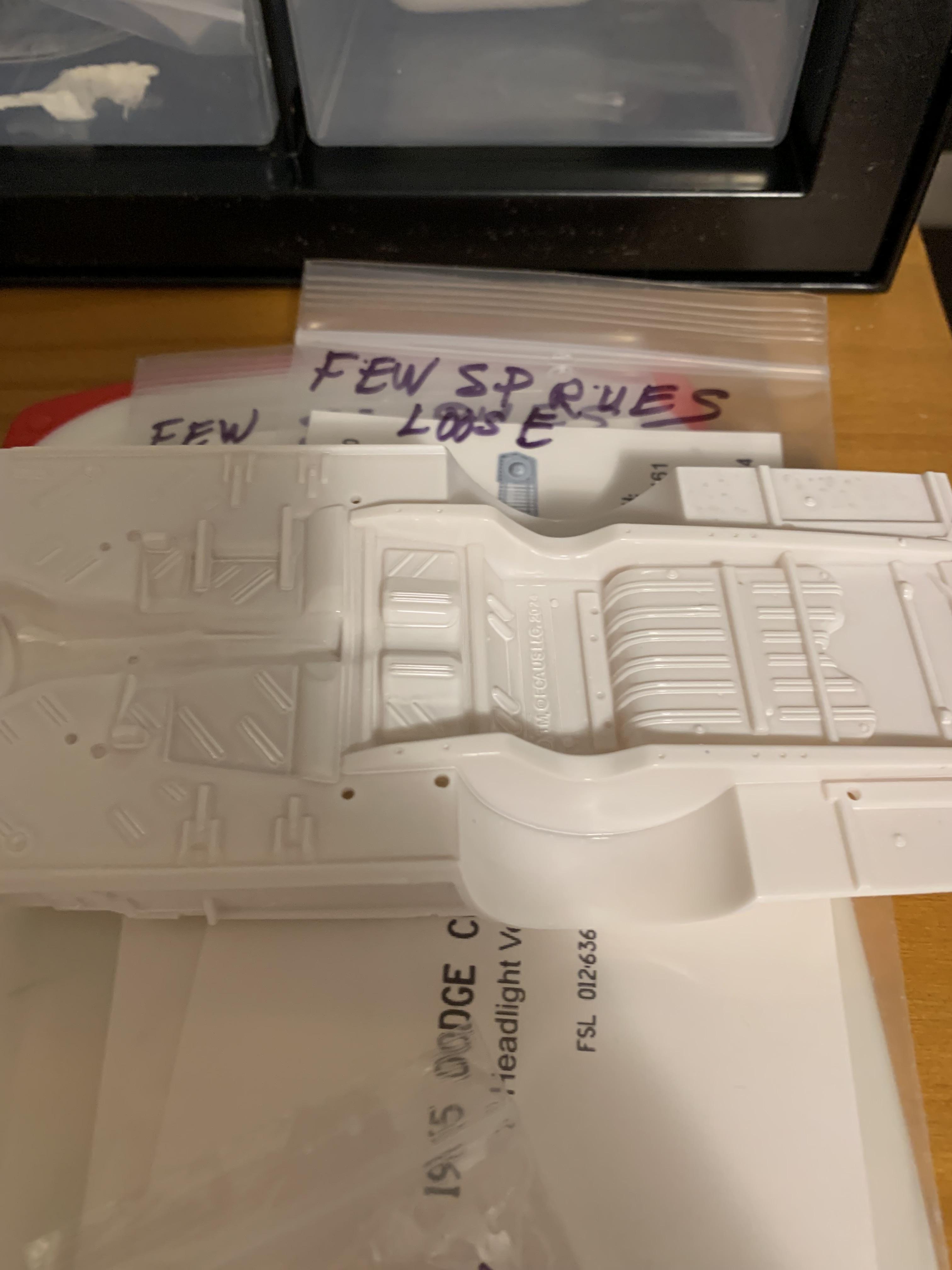

R. Thorne Posted November 21 Author Posted November 21 Upon trial fitting the interior tub I noticed the poor fit of the rear package tray. Not sure whether I am going to do anything about it or not. Also, got in a book light thingy (I read a lot of books), that I may use for a portable light for modeling. 1

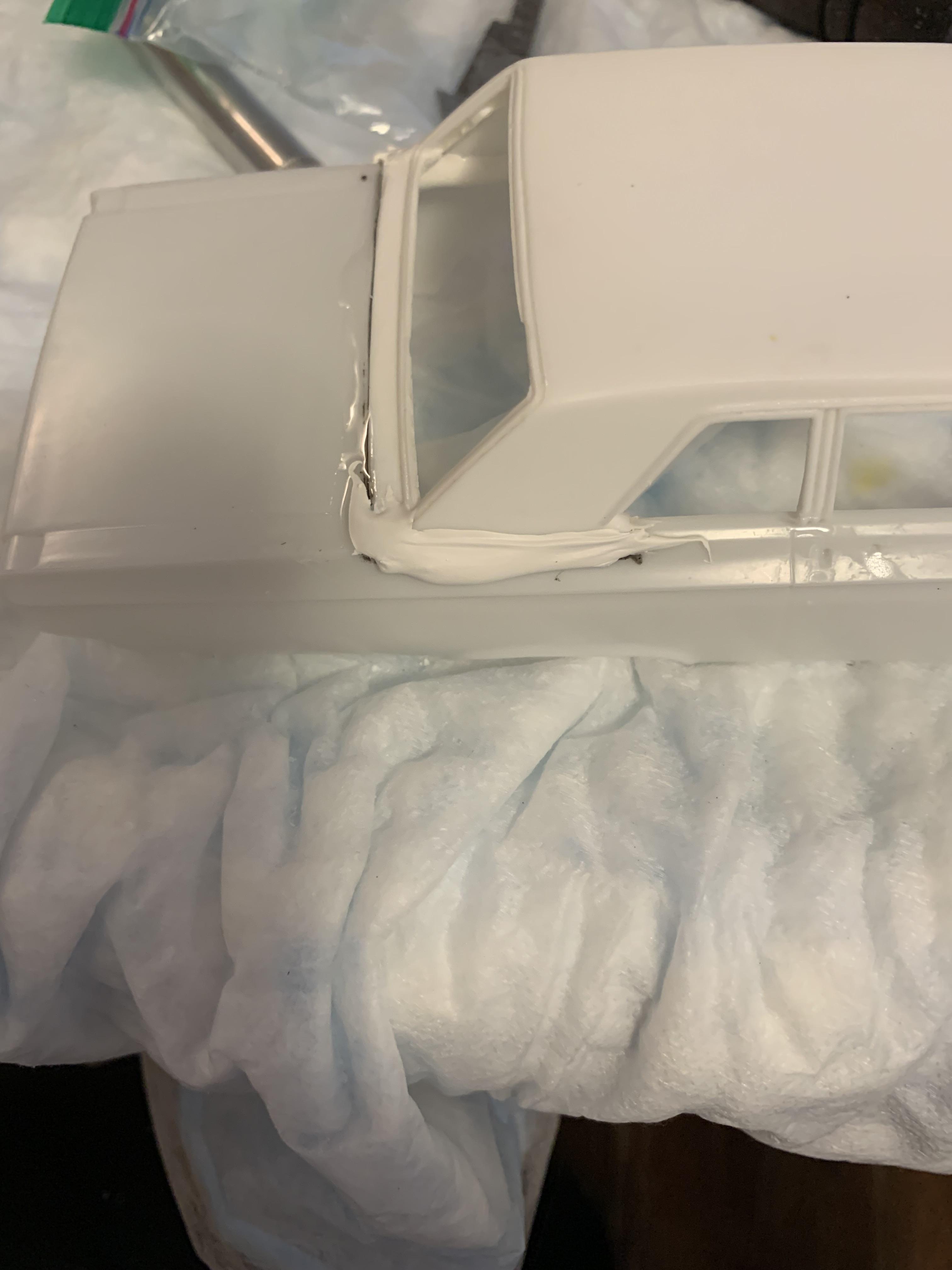

R. Thorne Posted November 21 Author Posted November 21 Some more sanding, a failed attempt with vinyl tubing to extend the package tray, weakened the top of the sedan post by clipping part way through the post, then bending it into alignment, brushed on some ca glue (really like the brush on stuff). Then a touch of “kicker”. Missed it a little on the passenger side. Got to fill a hole (on the underneath side) with some putty. 1
