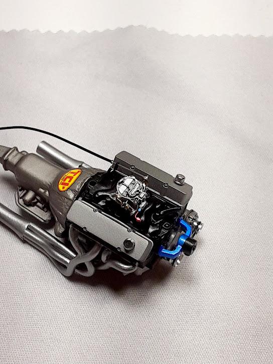

Hemifever Posted November 17 Posted November 17 This is my version of a '69 Nova that would have raced in the 2025 season. I wanted the body of a plane jane car, maybe a 6 cylinder, with a 350 installed. Car will have electric water pump, Fireball carb, relocated alternator to lower left of engine. turned pulleys and various 3d printed items. Cal Tracs, tied frame as well as a roll cage. Started out with the COPO Nova, because of it's flat hood and non SS grill. I removed all the badges and side marker lights, they will be replaced with The Model Car garage detail set. Also removed the vents on the front fenders. Filled in the recessed areas for the door handles and mirror, as I will pin the door in place. The body was sanded with 2000 grit paper and primed . I'll shoot a couple light coats of MCW white primer next. Just can't decided on a color. Engine pics coming next. All comments welcomed. 5
Hemifever Posted November 17 Author Posted November 17 Removed the transmission, going with a Turbo 350 from Competition Resin. Filled the seam down center of the block with Slow Zap, also fill the area where the stock water pump would attach to the block with some pieces of styrene. Everything was sanded smooth. Drilled holes for the electric water, as it will be pinned in place. Block is primed and will be painted Tamiya semi gloss black. 3
Hemifever Posted November 17 Author Posted November 17 Painted timing chain cover Alcad duraluminum and added bolt heads from Pro Tech, painted matt black. Made a alternator bracket, not sure I'm going to use it, not confident it will hold the alternator in place. Made another alt bracket, going with this one. Pinned the water pump in place, glued from the inside, the installed the transmission. 10

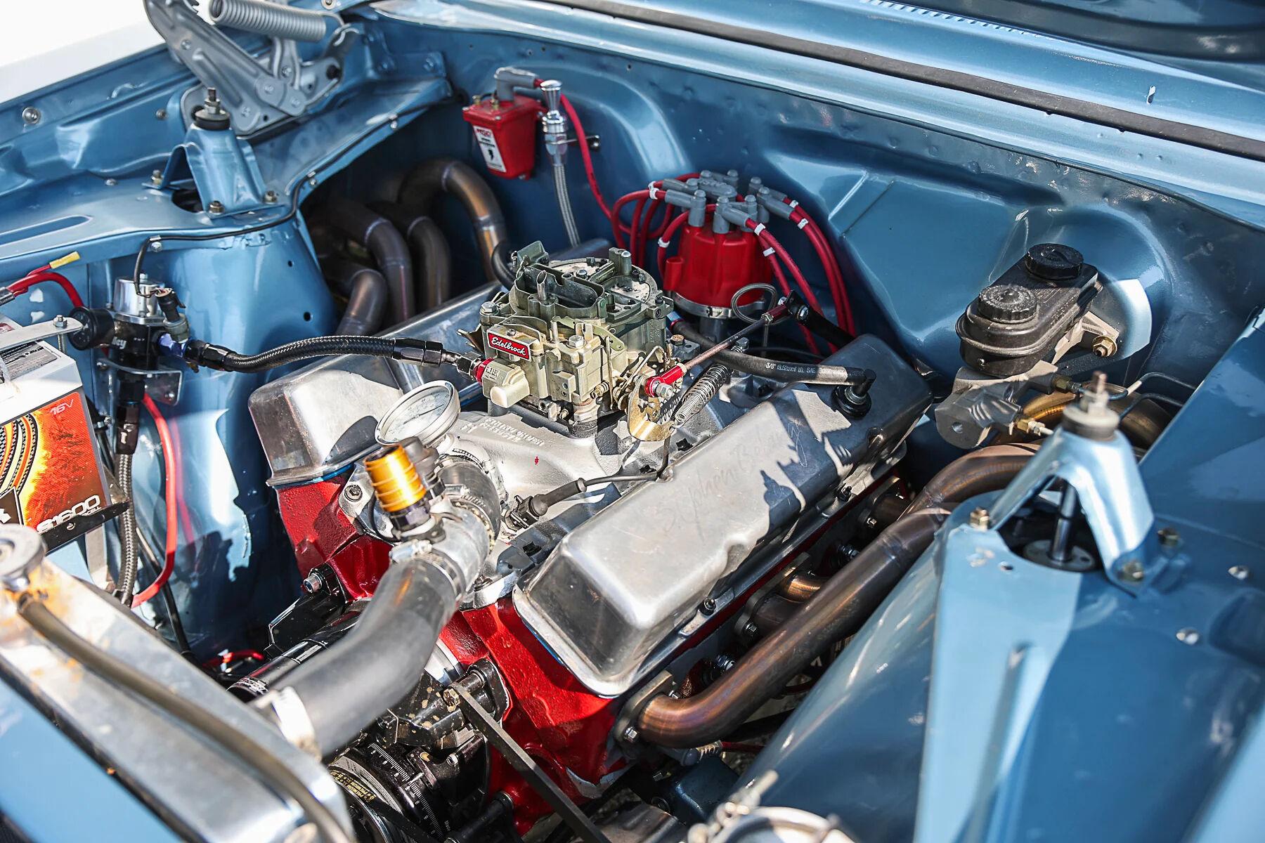

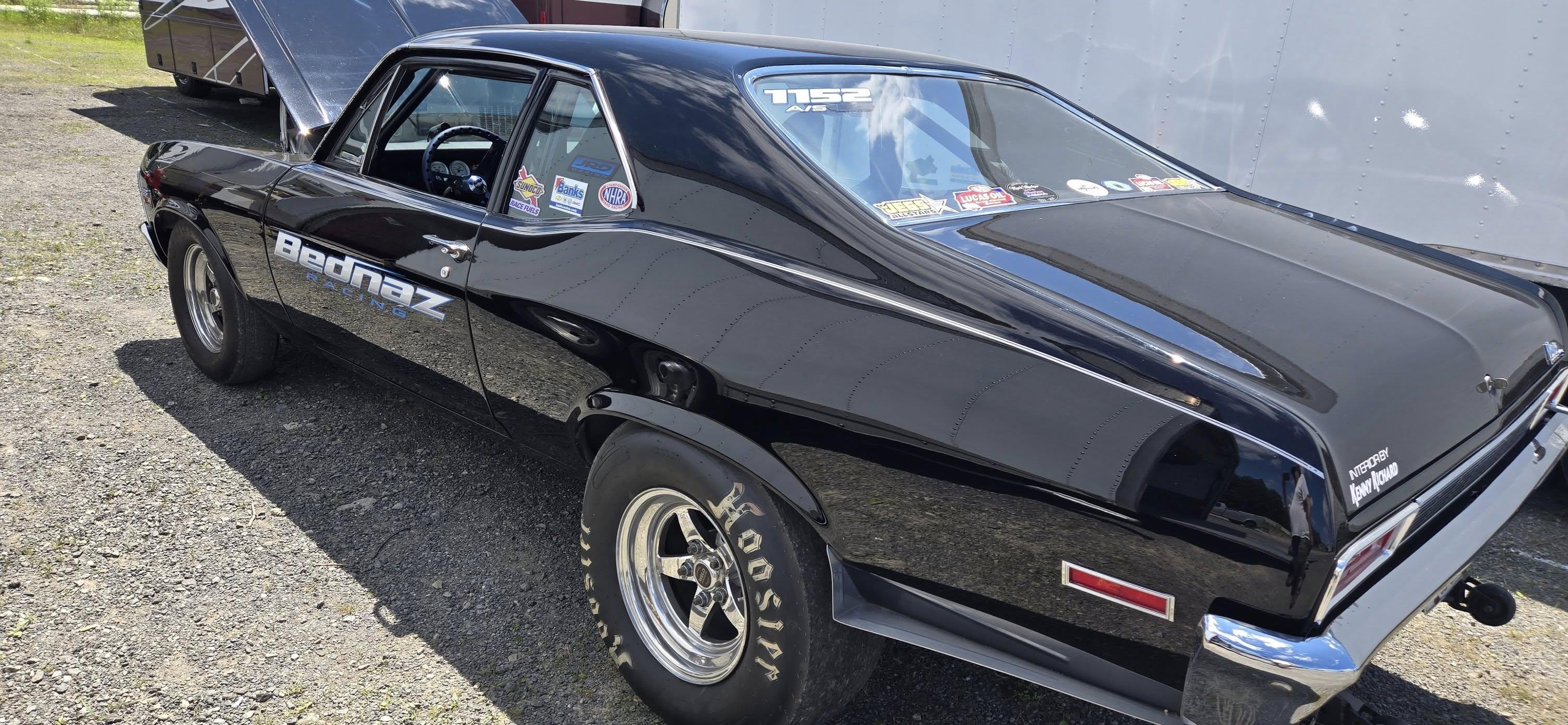

R. Thorne Posted November 17 Posted November 17 You’re off to a great start, Dennis. Color is always a head scratcher. When I did Mike McDonald’s F/SA Nova, I didn’t think I would care for his orange color, but I really liked the color afterwards. Of course, there’s always basic black. Here’s one on my list (big block A/S). 1
bytownshaker Posted November 18 Posted November 18 17 hours ago, R. Thorne said: You’re off to a great start, Dennis. Color is always a head scratcher. When I did Mike McDonald’s F/SA Nova, I didn’t think I would care for his orange color, but I really liked the color afterwards. Of course, there’s always basic black. Here’s one on my list (big block A/S). Ron It's amazing how much Stock eliminator cars have evolved since I was around any of them. I always enjoy your builds. 2

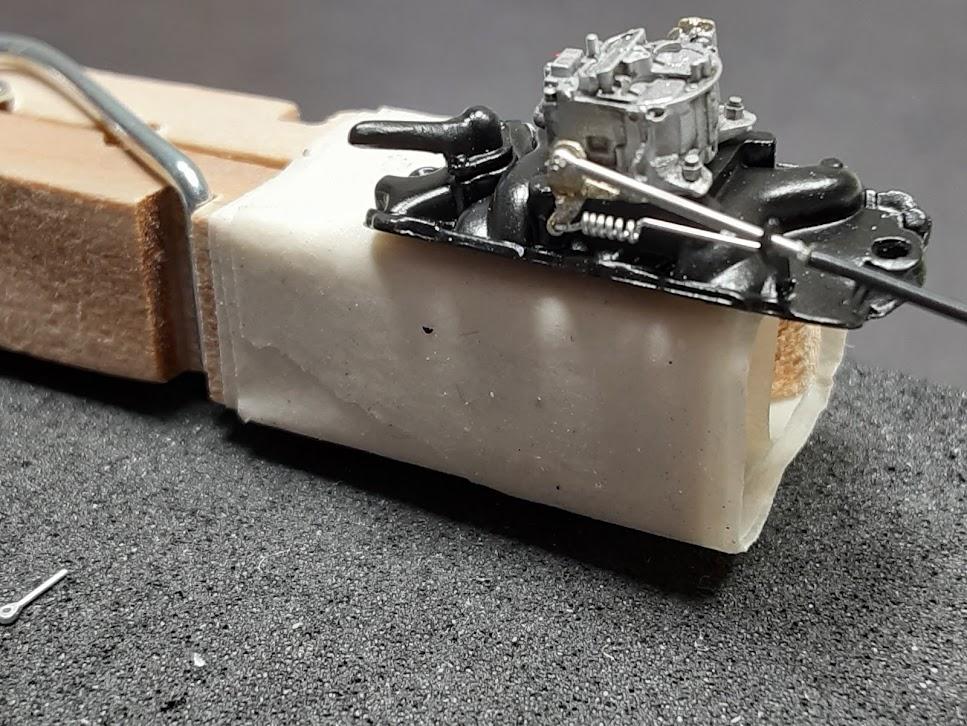

Hemifever Posted November 18 Author Posted November 18 Fireball carb is done. Added RB Motion A/N fitting, scratch built the linkage and added RB Motion nut and stud pins to the base. 8

Hemifever Posted November 19 Author Posted November 19 Awesome, a rainy day here in the desert, I'll be at my bench all day. The intake has already been painted. That hump that would have held the stock coil was drilled out and fill in, and I made a bracket for the throttle cable and return spring that will go in that area. All the parts I'm using are from RM Motion expect the thin aluminum rod, from Detail Master, .010" which I'll use for the return spring. I'll post pics later today. 4
Hemifever Posted November 19 Author Posted November 19 The RB Motion parts are for the throttle linkage.
R. Thorne Posted November 20 Posted November 20 (edited) Man, you take good close up pictures of tiny parts. Way beyond my smart phone capability. Looks like you extended the water outlet snout for a scratch built hose to slip on easily? Water pump is sweet. My ocd commands me: why do the rear studs on the quadrajet look like a bolt head with another bolt head on top? Some guys probably use just a bolt instead of a stud and nut. Great job on that tedious work. Edited November 20 by R. Thorne 2
Mike Holland Posted November 20 Posted November 20 On 11/17/2025 at 11:36 PM, R. Thorne said: You’re off to a great start, Dennis. Color is always a head scratcher. When I did Mike McDonald’s F/SA Nova, I didn’t think I would care for his orange color, but I really liked the color afterwards. Of course, there’s always basic black. Here’s one on my list (big block A/S). Yep. Your basic black is a sensational black! Hands down. Mike..

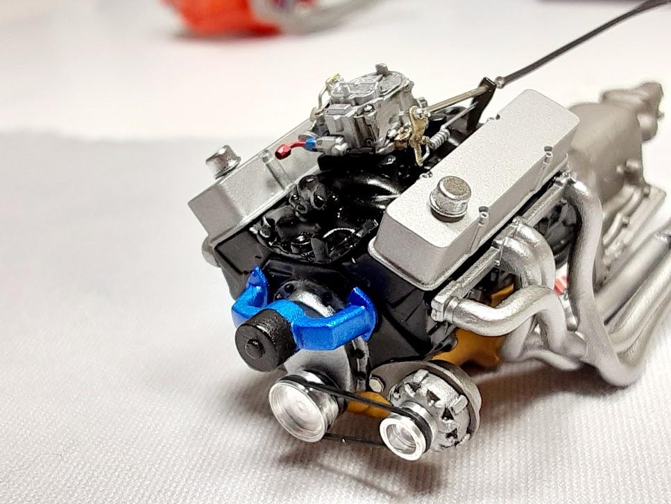

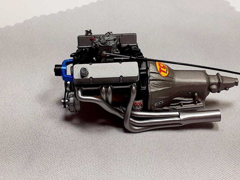

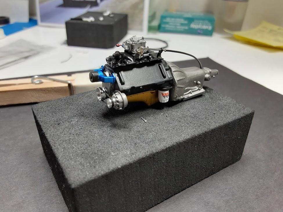

Hemifever Posted November 20 Author Posted November 20 Getting a little closer. Will install distributor, water pump and alternator wiring next. 7
bytownshaker Posted November 21 Posted November 21 That is one nicely detailed SBC, can't wait to see more.
