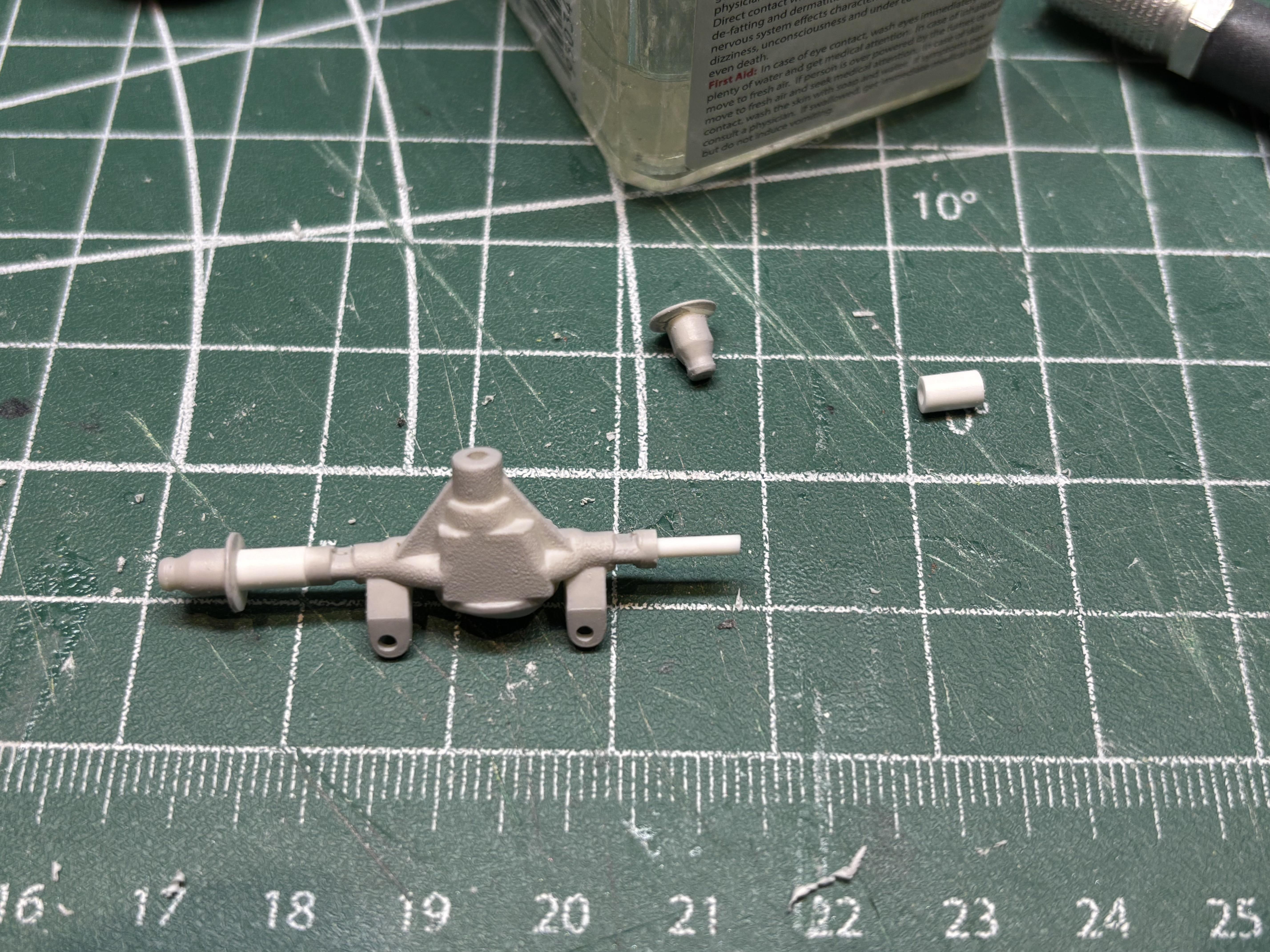

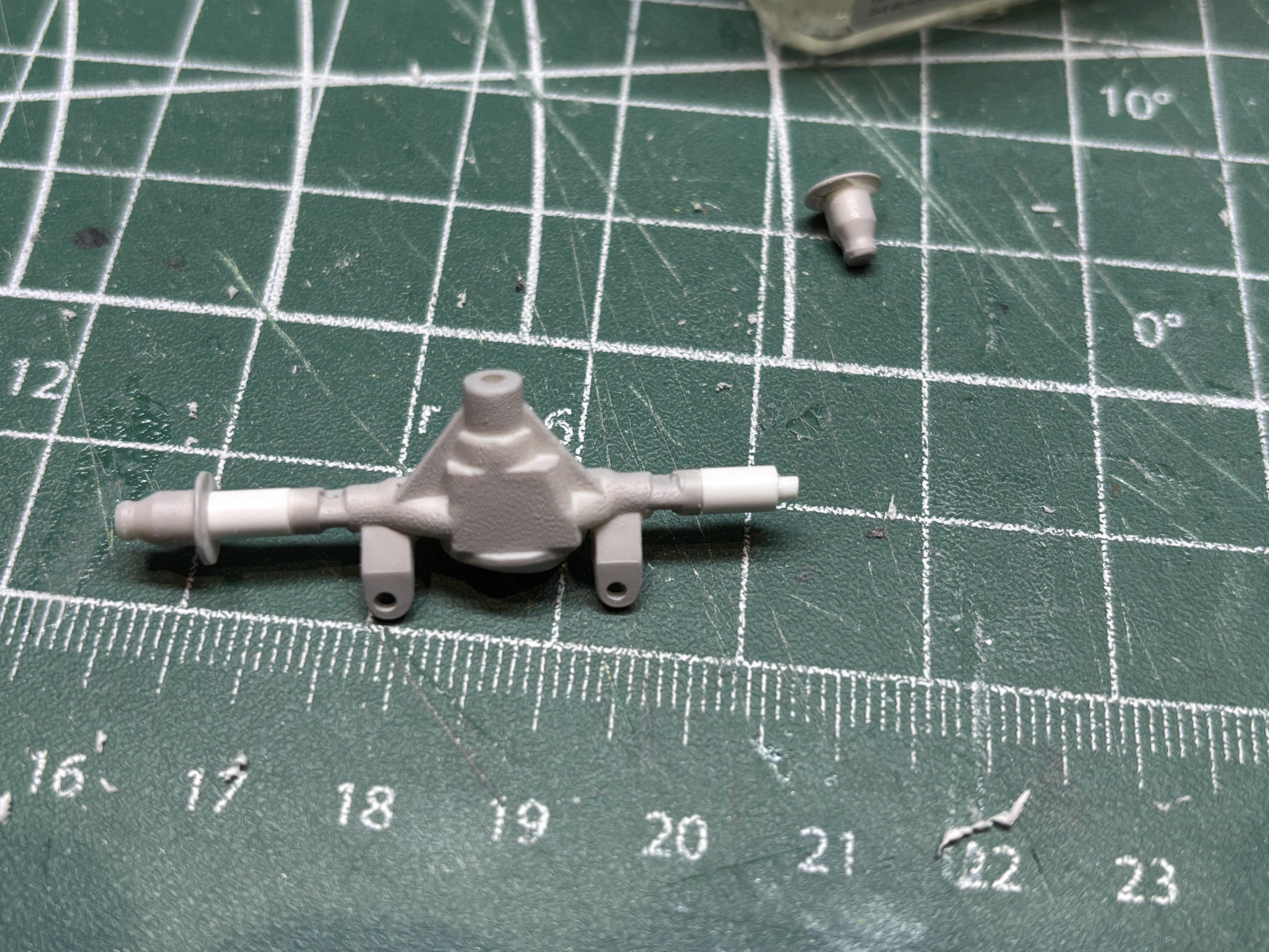

I had a fairly productive day at my desk today.

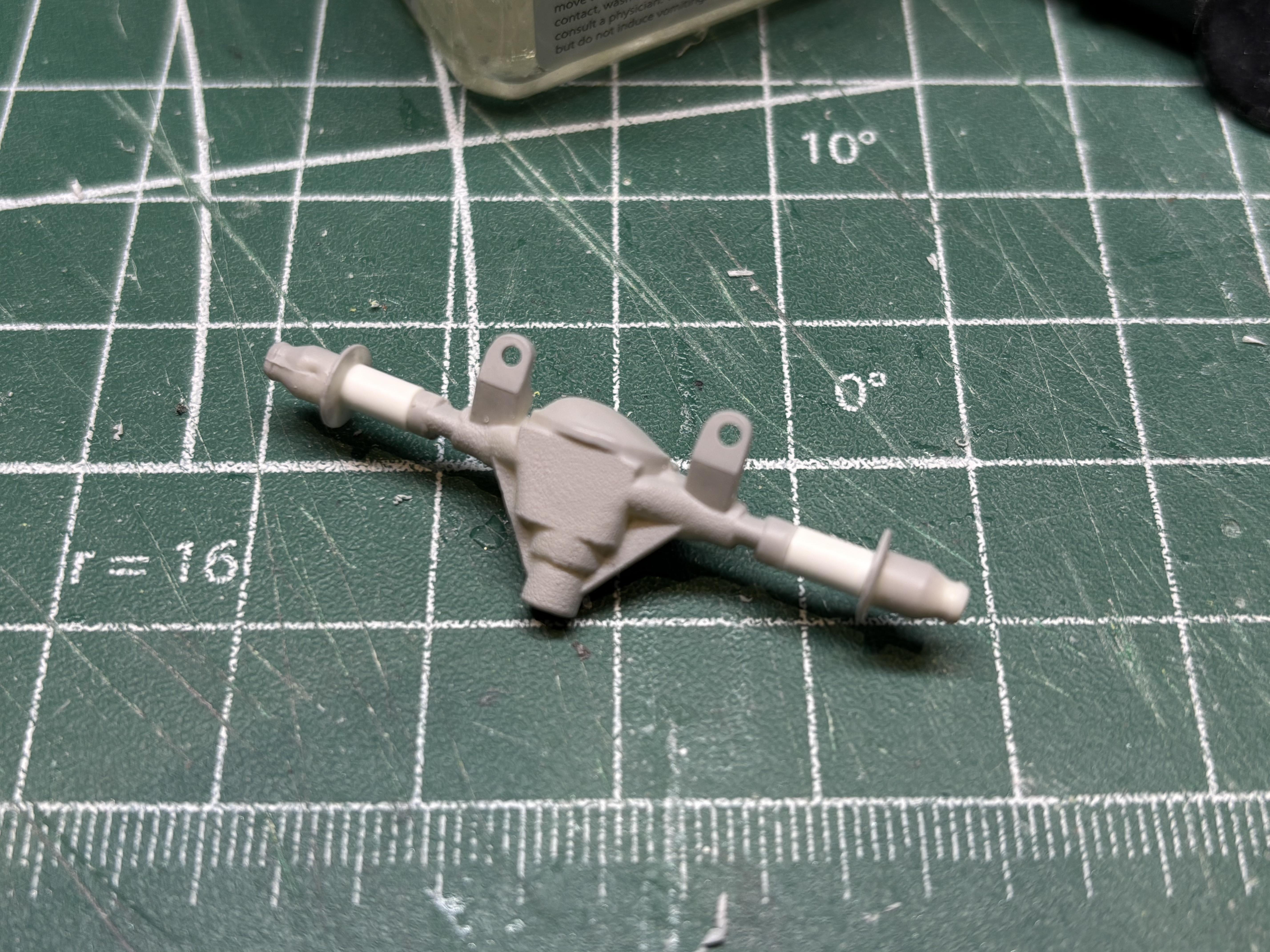

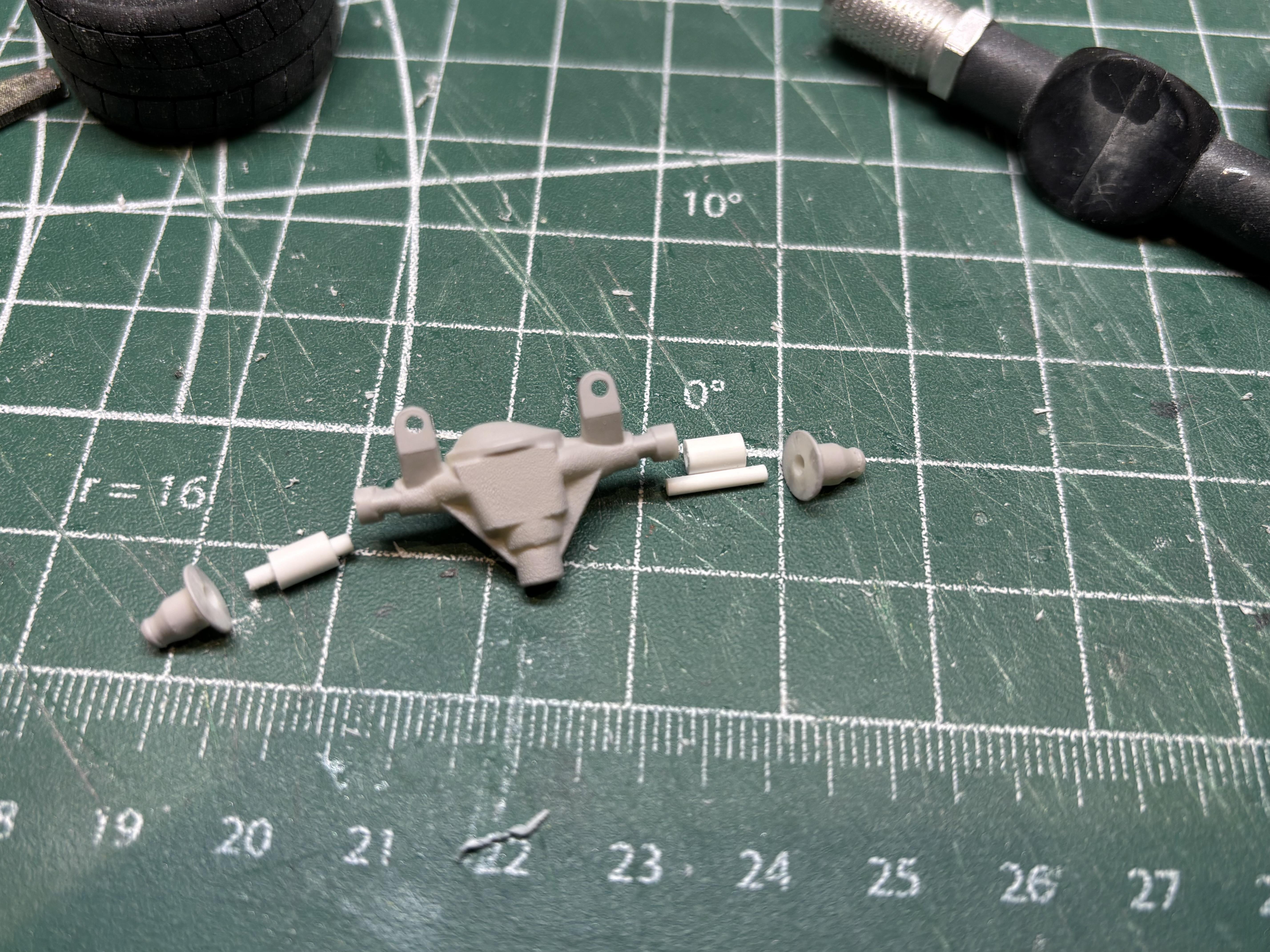

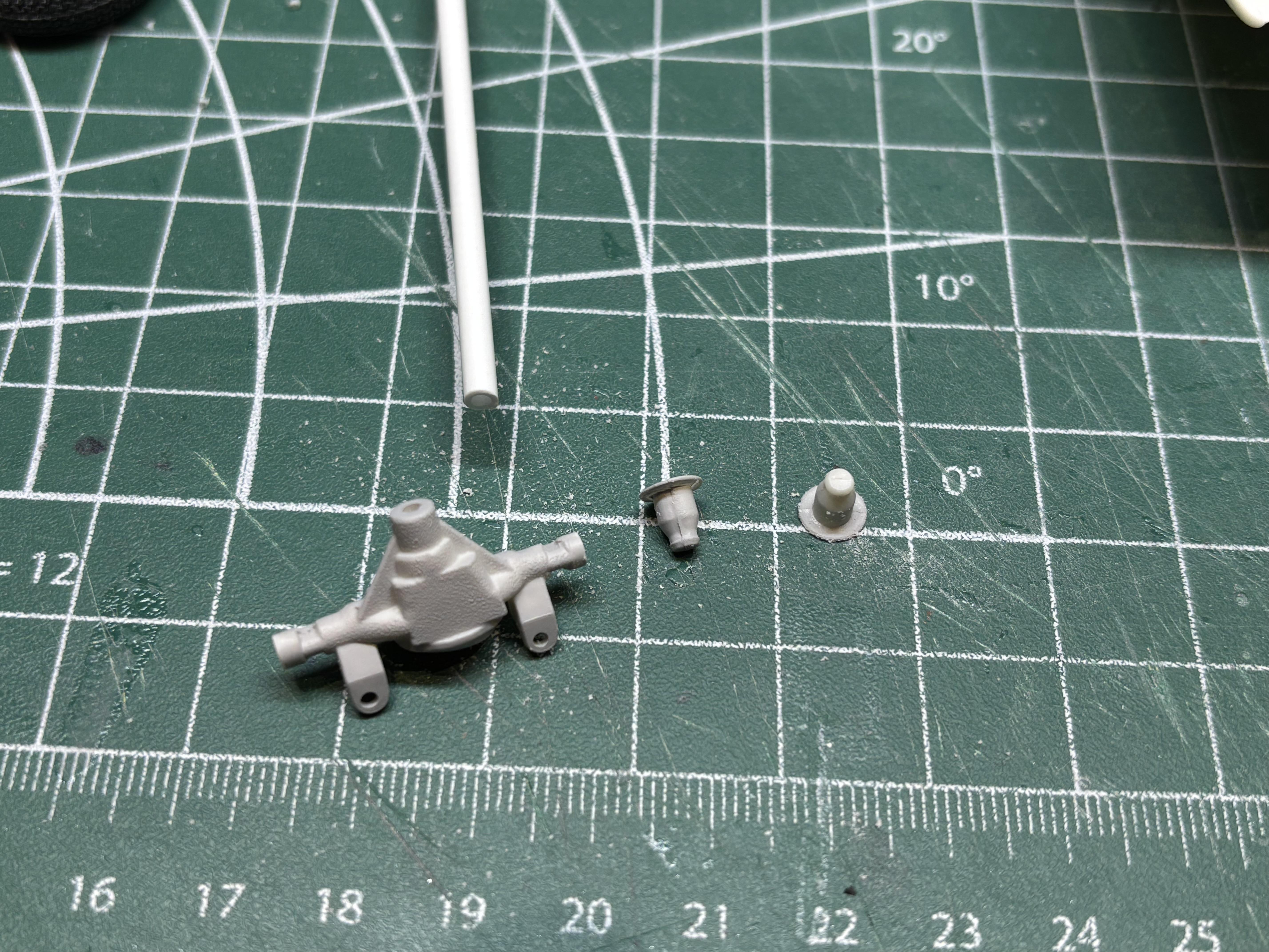

Needed to adjust the rear track width, but wanted to use the kit axle. I will let the photos do the talking…
IMG_2751.jpeg.5e6f4a862aedcfa5f0632c686e2c9858.jpegIMG_2752.jpeg.fbf143cc8cf2e59acd9caa4946cb4a89.jpegIMG_2753.jpeg.9e85441697a58d262f4db97f1279d970.jpegIMG_2754.jpeg.b92859a6c04f8496c792800cef8ba454.jpegIMG_2755.jpeg.7d93032a95d2f3c1f38c2f8fe517018e.jpeg

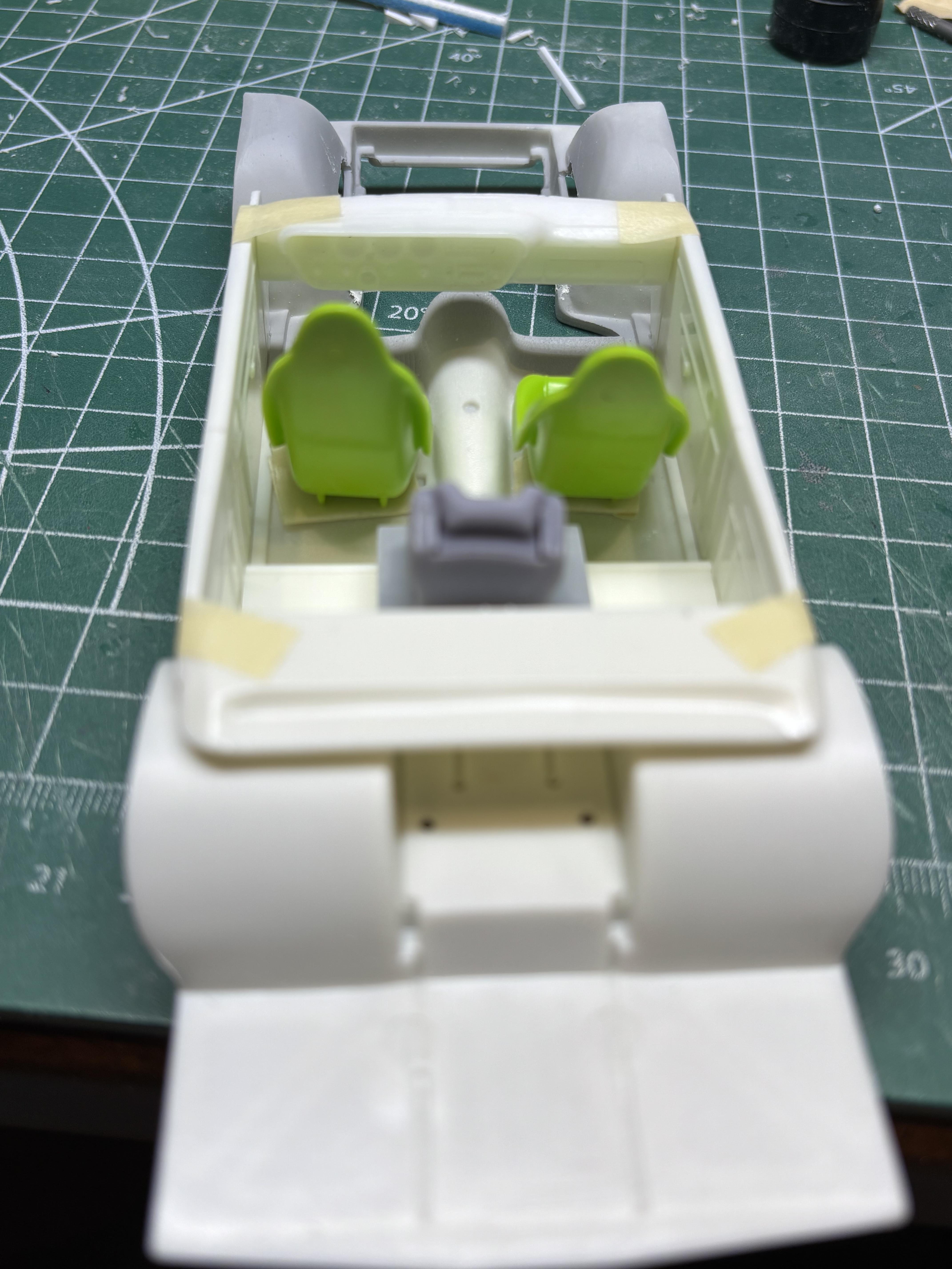

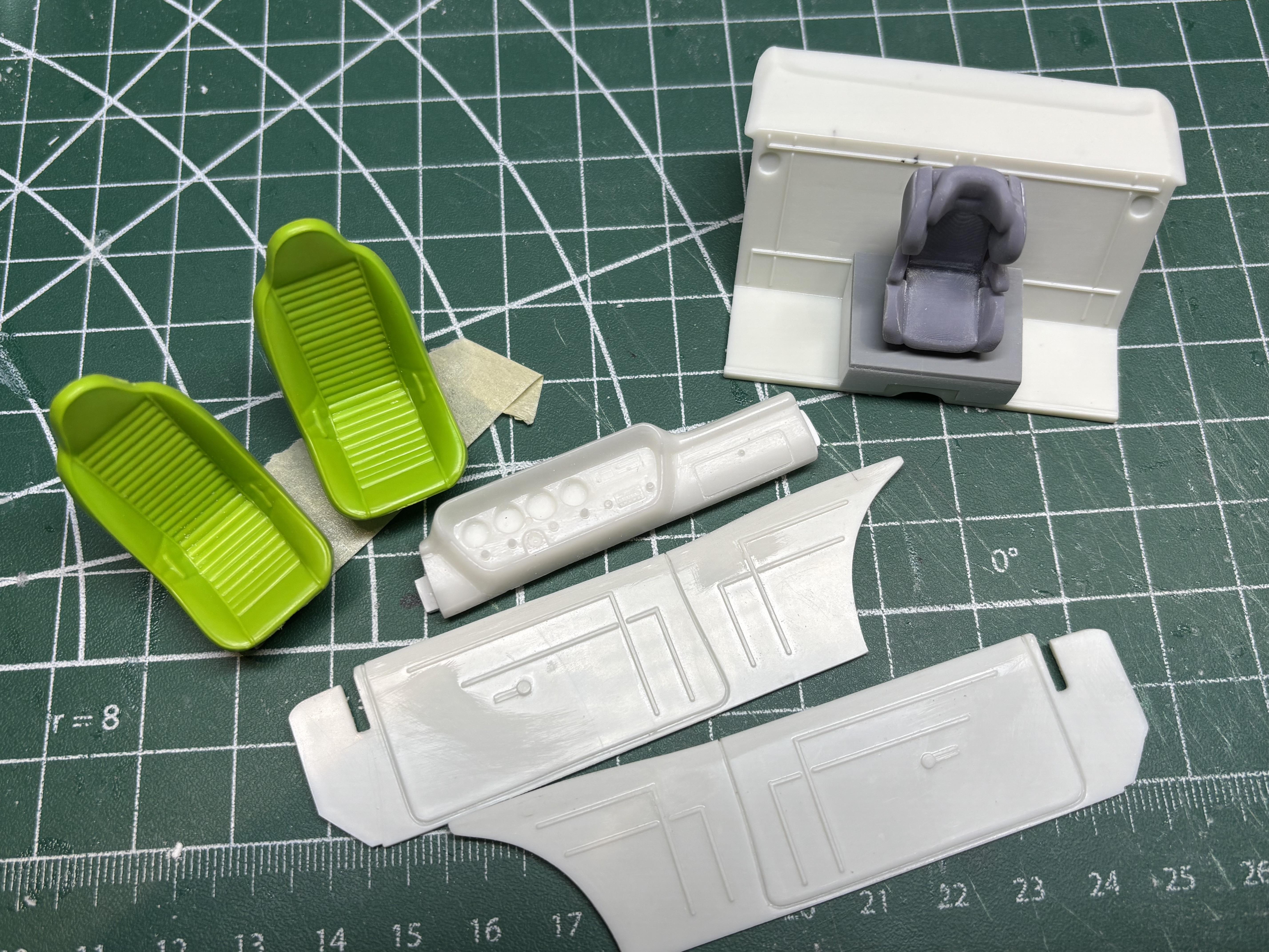

Next up was some interior work.

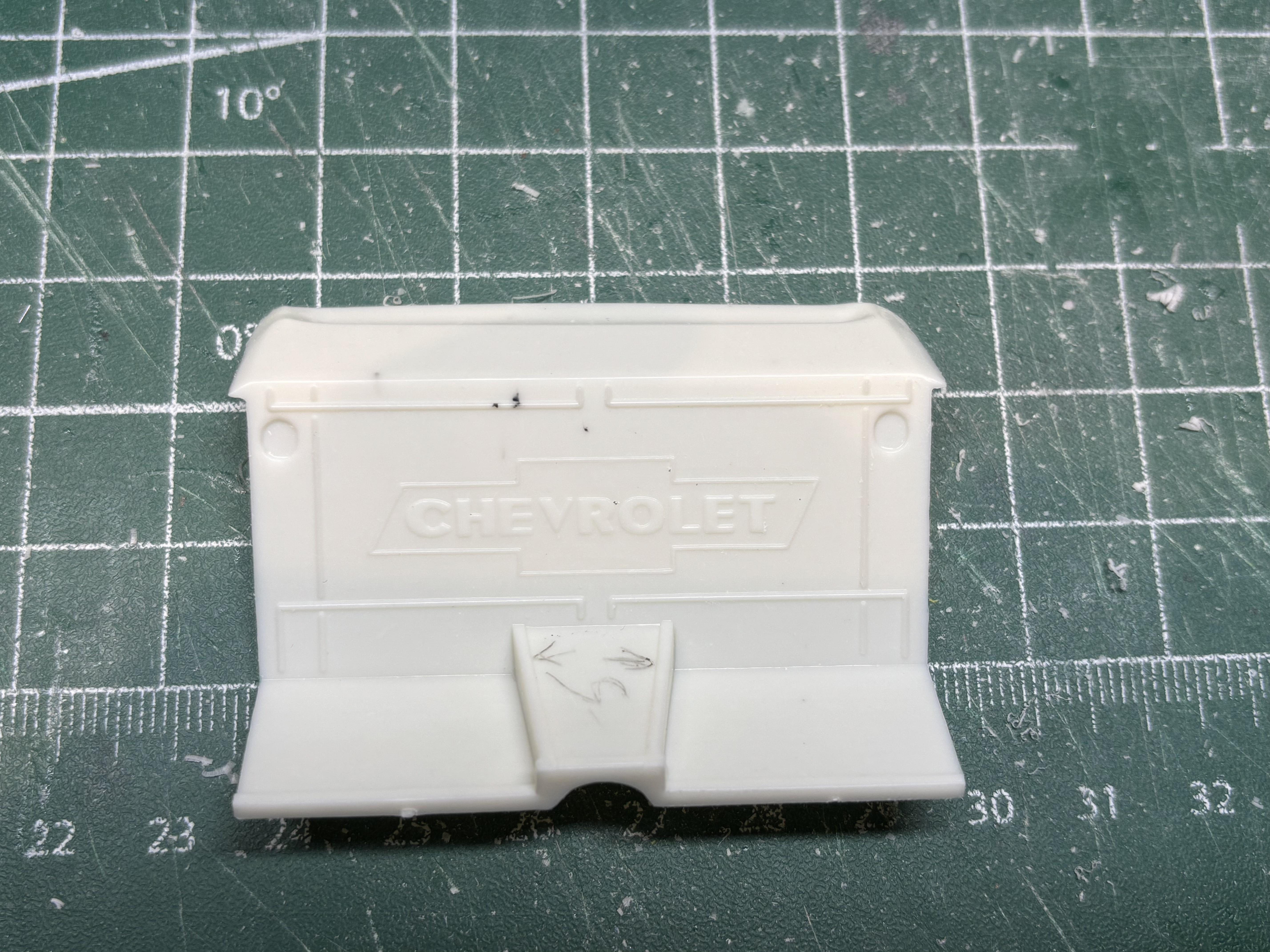

Will be removing the bow tie and “Chevrolet” from the rear tin work.

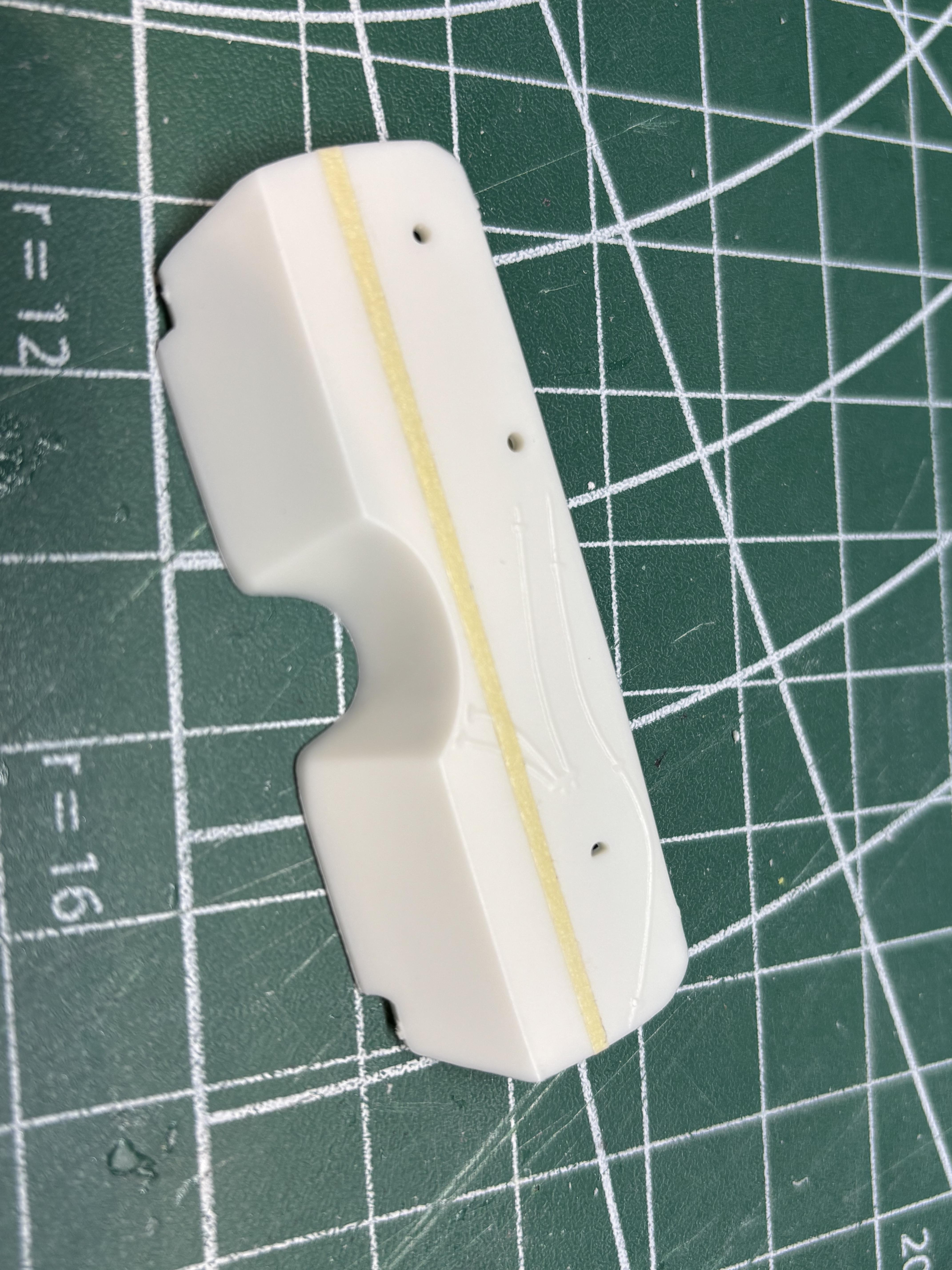

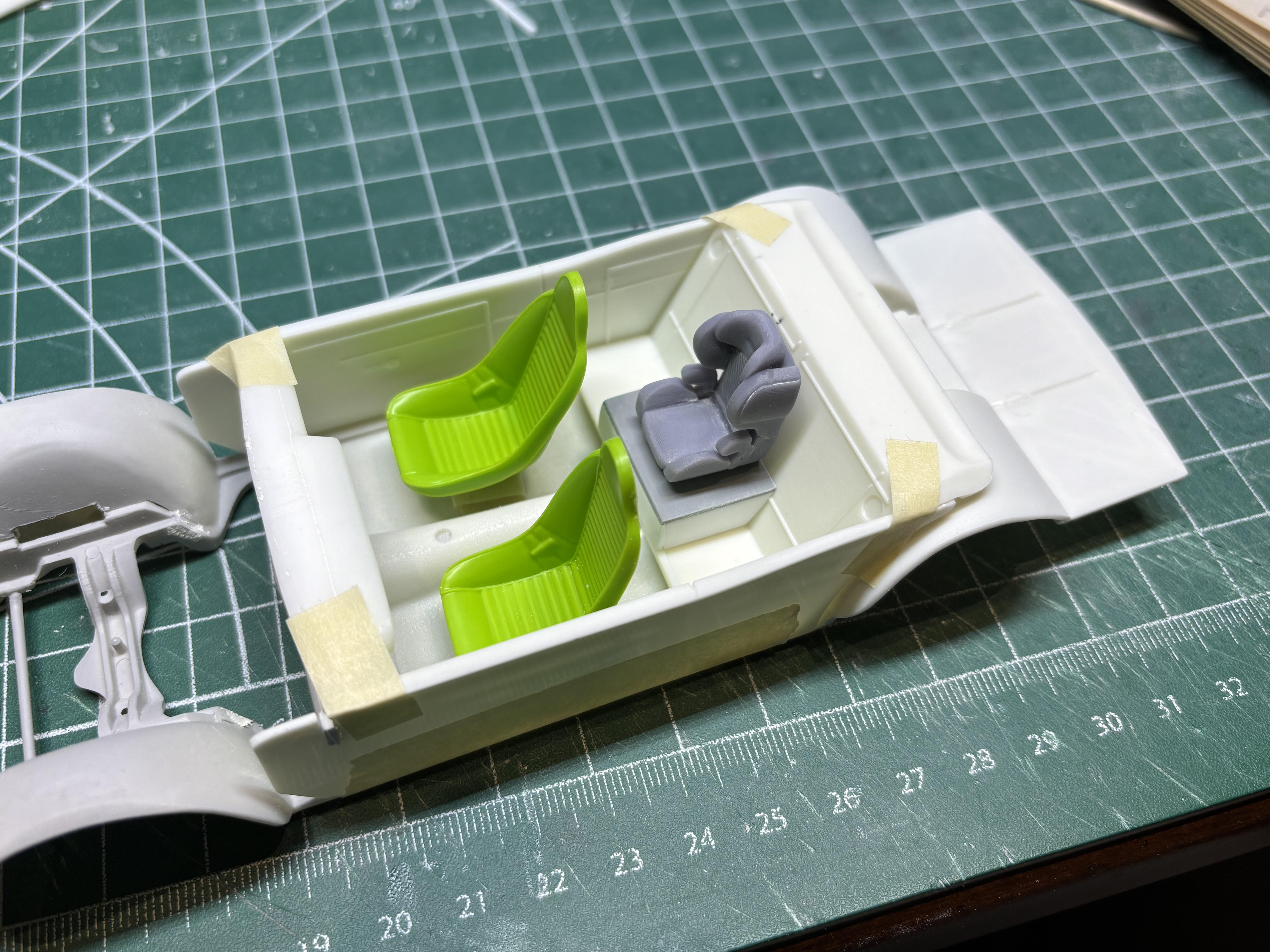

For the door cards, I removed 0.5 mm from the bottom, and about 1.5mm from the top. This “channels” the body over the frame about 1.5”. While at it, I removed the window cranks, I’ll add power switches later. The dash that I received from “the Beaumont guru” needed to be narrowed about 3mm to fit. Haven’t decided on the front seats yet, but the Revell ones are in the running. Oh… the baby seat is from Iceman.
The “perch” for the baby seat was scratch built, and you can see the bow tie etc. has been removed.
The firewall will get 1.5mm removed as the tape indicates.
