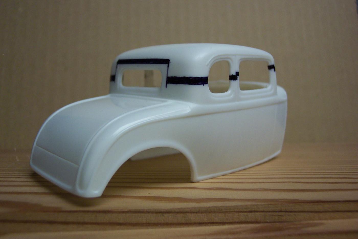

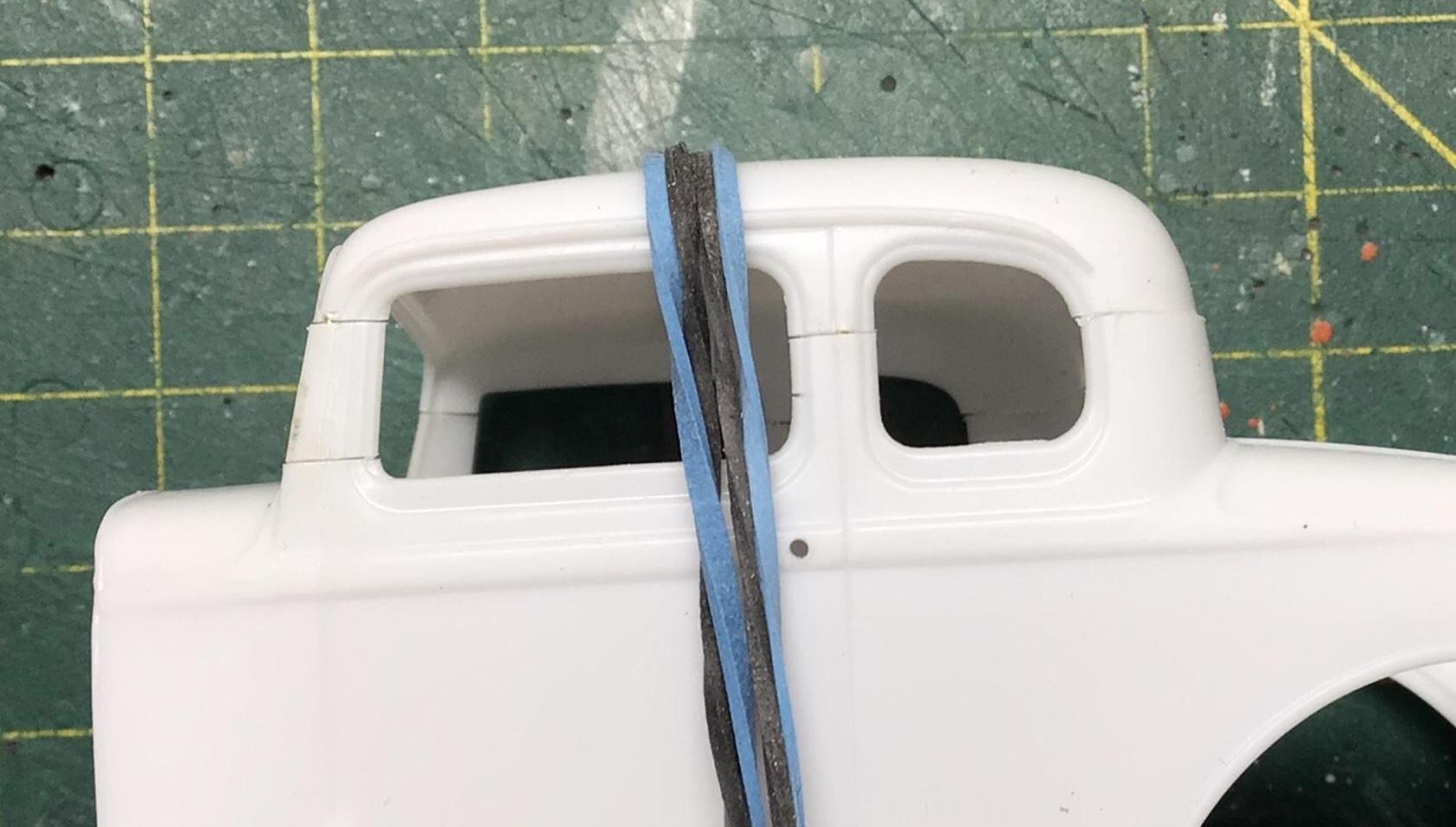

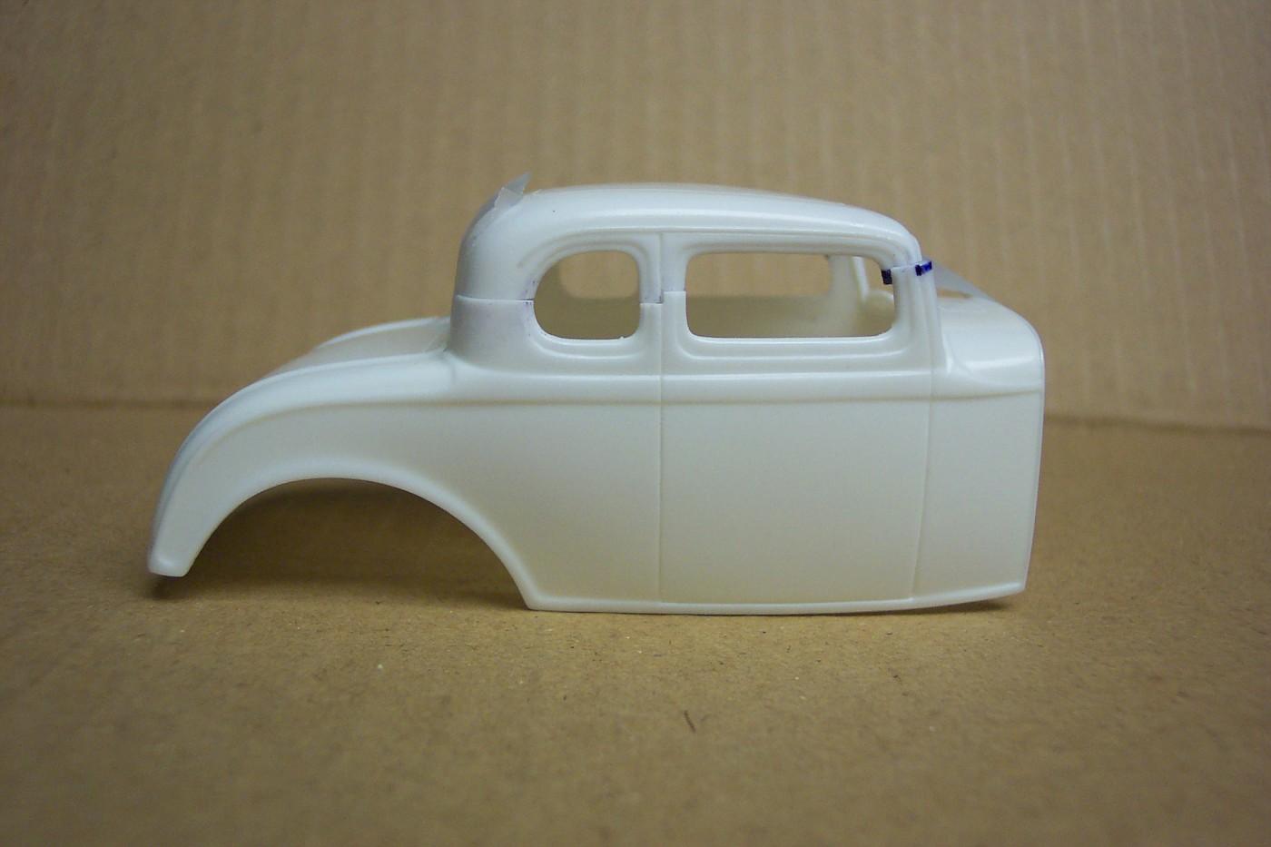

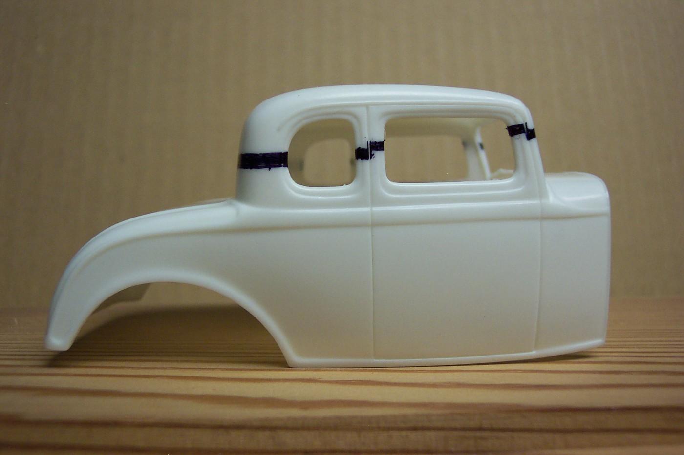

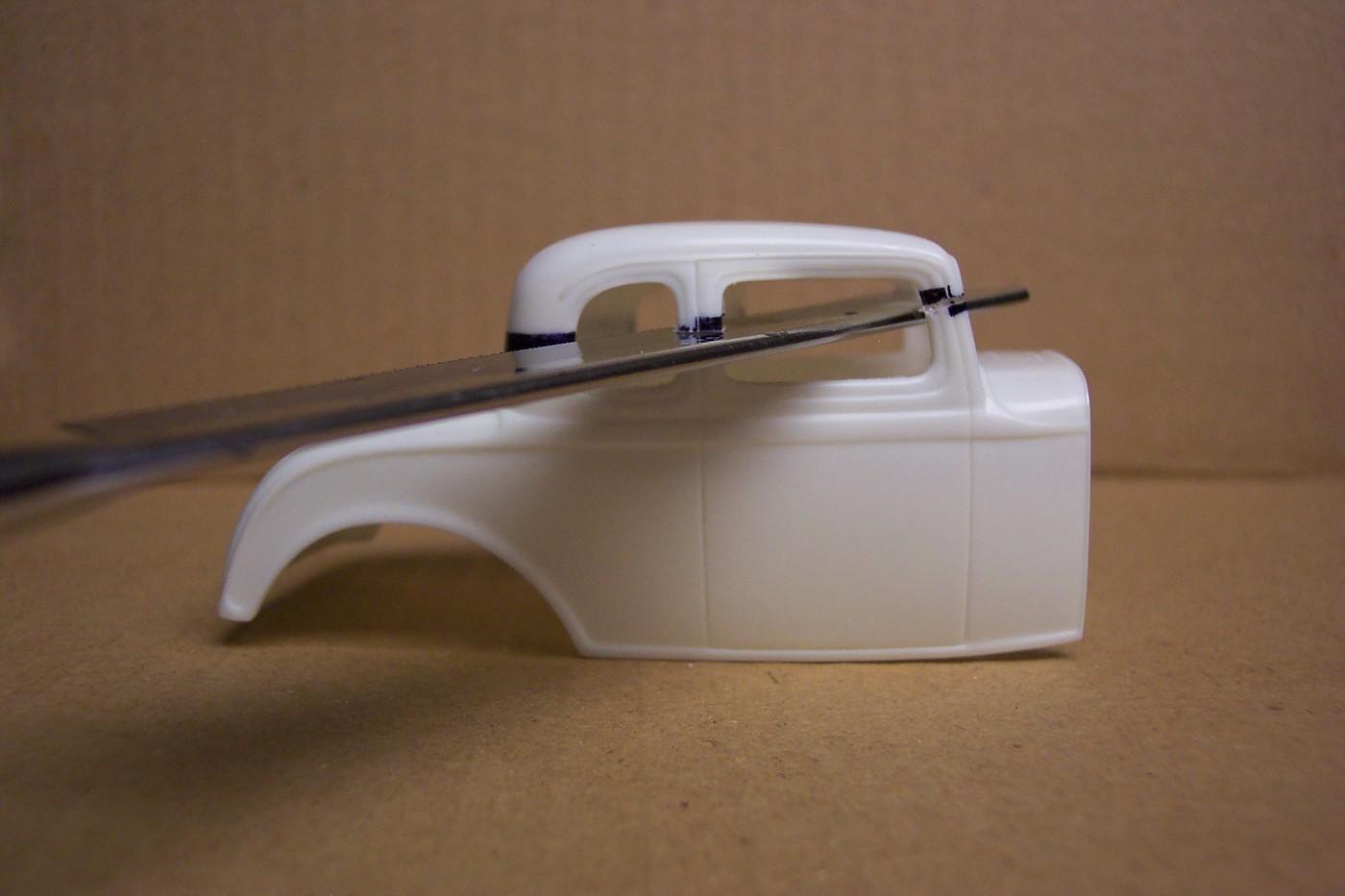

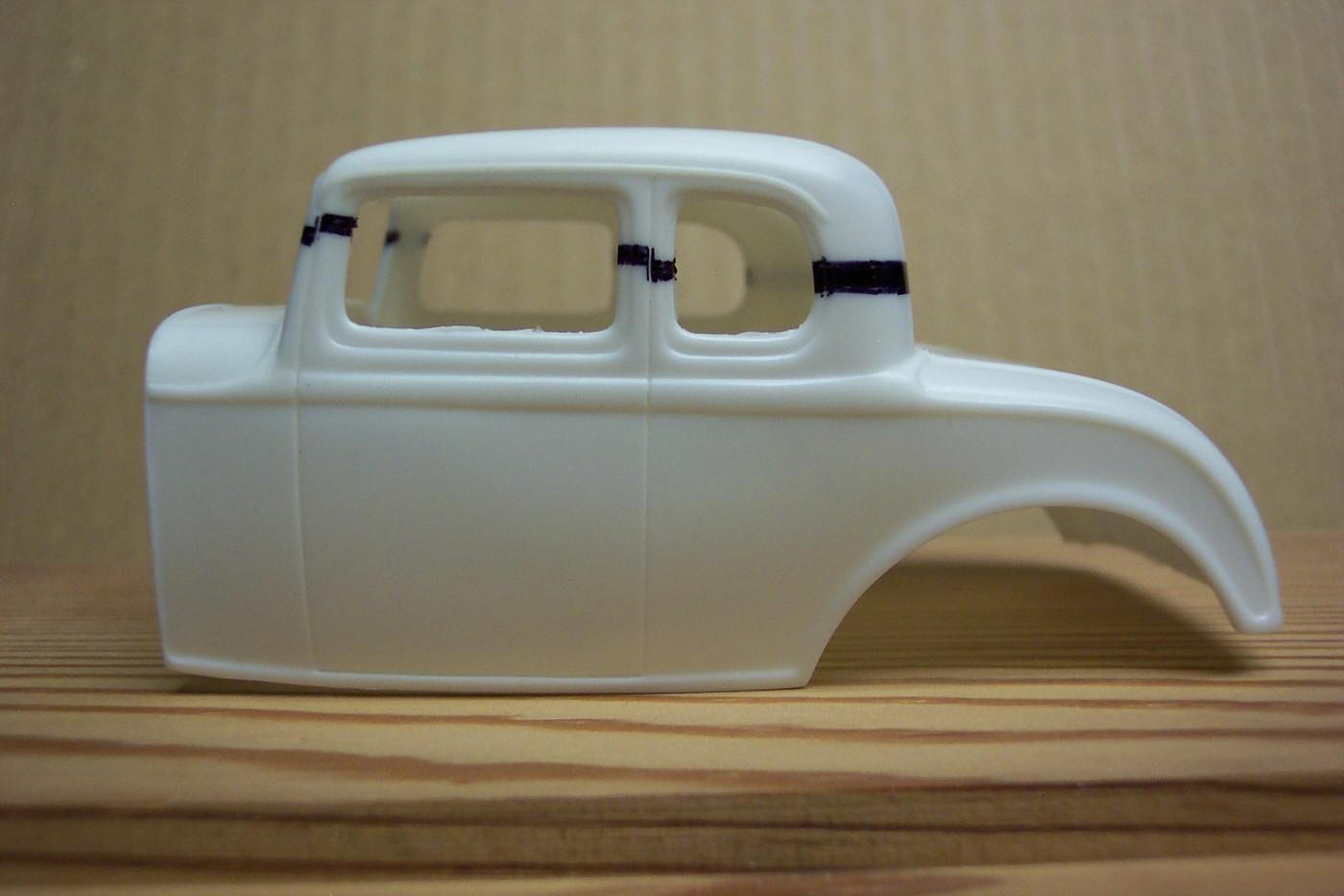

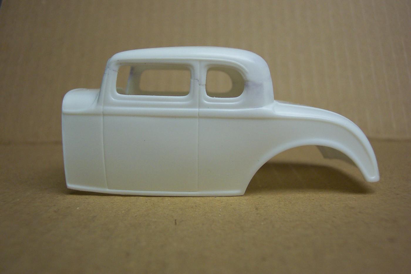

Here's a series of progress pictures for Step-Chopping a '32 Ford Five Window Coupe:
  • Like 2
  • Thanks 2
Thanks to everyone that replied to my post.  You guys are the best!  That is exactly the info that I was needing.

I tried KiT Karson stair step method. It gave a much better and stronger result than any other method I've tried. I did it with a sedan and the result was first class.
