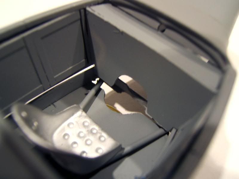

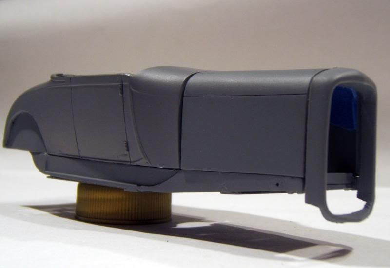

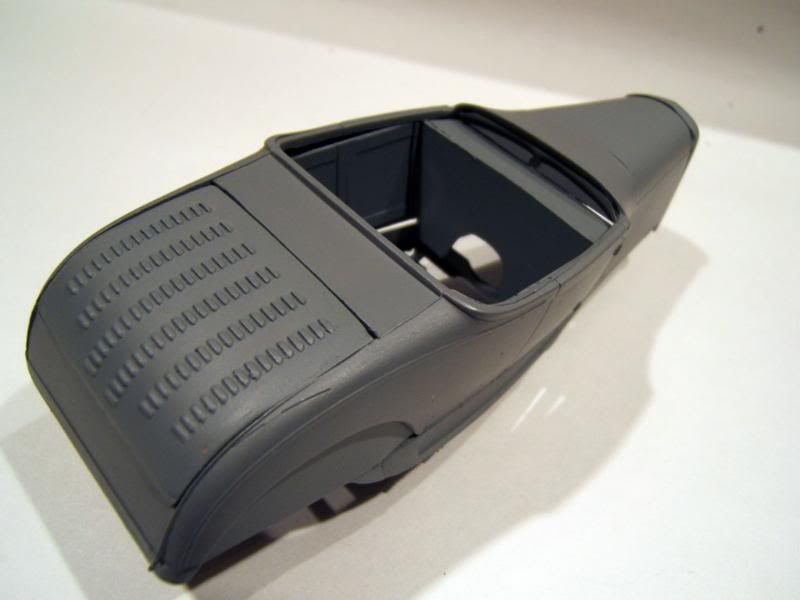

Progressing steadily… More interior panels were fabbed, some primer/sealer layed down to mask the differing colors of the plastic, and a color mockup of the paints scheme made up in Photoshop. Chassis and grill will be blue with red body with white paneling on the hood. Minor bodywork and chassis cleanup needs to be done and front wheels fabbed up to allow for a brakeless front setup. I hope to have a roller by the end of the week and maybe some paint, weather permitting. Here are some pics:

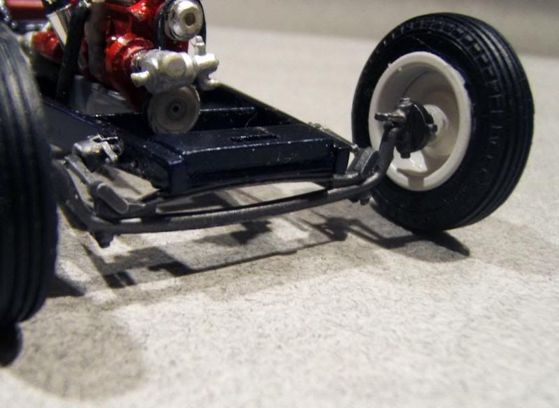

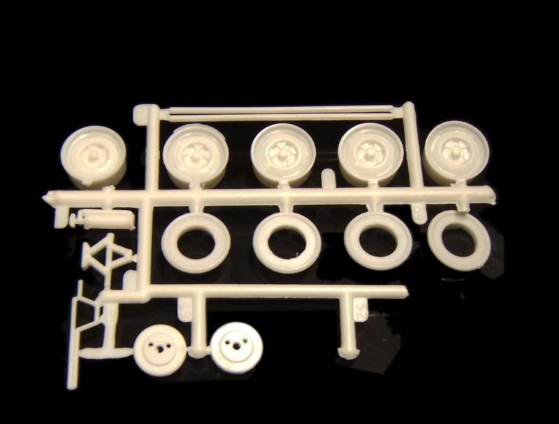

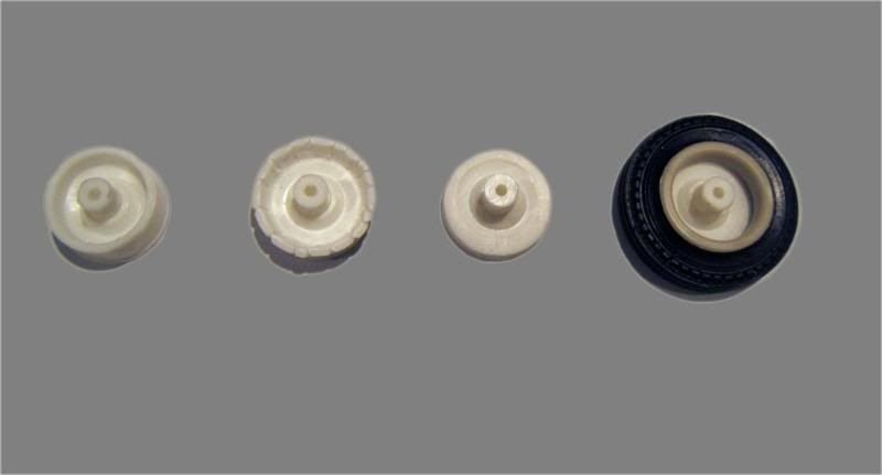

I needed a pair of '40 Ford style steelie front wheels that had good inside back detail since I wanted to run the front end without brakes with just a spindle and kingpin. Most kit steelies are completely flat on the back or have crude brake backing plates molded in. I wanted to avoid having to sculpt a groove in the back of each wheel if I could since duplicating them might be difficult. Here’s my solution. Not absolutely accurate but very reminiscent of the back of wheels on track roadsters and dirt track cars in the 40’s and 50’s.
I found these wheels in a bunch of parts I got from my friend Raul Perez when he let me graze through his parts stash last winter. I don’t know what they come from but there are five of them, they’re all exactly the same but there are only 4 wheel backs. They’re very deep. I’m guessing they’re some kind of truck wheels. Anyway, they’re just about exactly what I had in mind. I’ll trim down the mounting post as needed in the final installation on the front axle.
Al I had to do is trim off the flanges on the back and mate them up with some AMT ’40 Ford rim backs. The fit was perfect for the set of Modelhaus 110B 5.45 width tires I’m using.

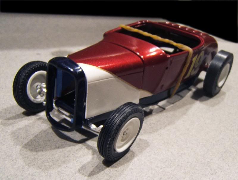

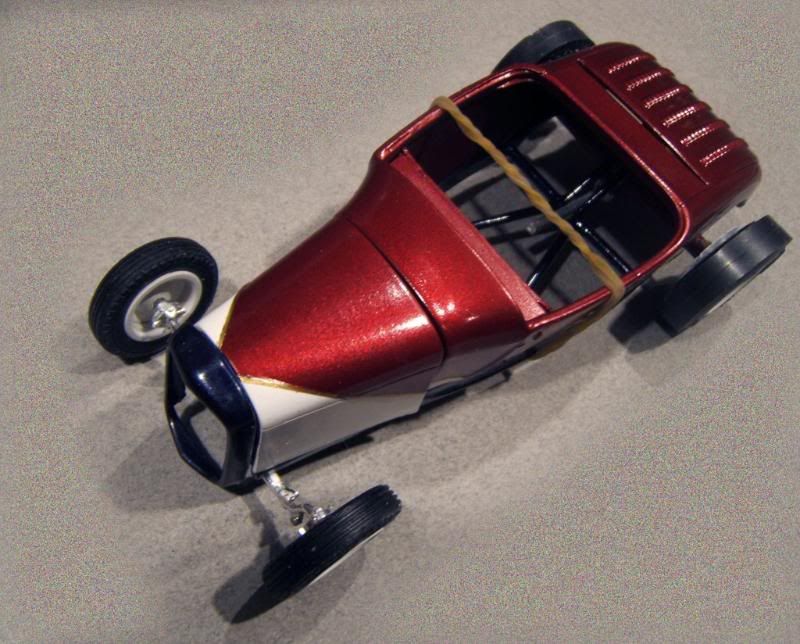

This build is going very slowly for me. Sometimes I feel a little over my head with this thing since it's mainly scratch built or heavily modified kit bashing. I've gotten the main body work done including paint. The frame and grill shell are Tamiya Dark Metallic Blue, the body is DupliColor Cherry Mietallic with Duplicolor Oxford White panels outlined in gold Pactra Trim tape. The numbers are gold leaf decals from the old Monogram Classics Super Modifed Dirt Track Racer/Kurtis Kraft Indy Racer double kit.

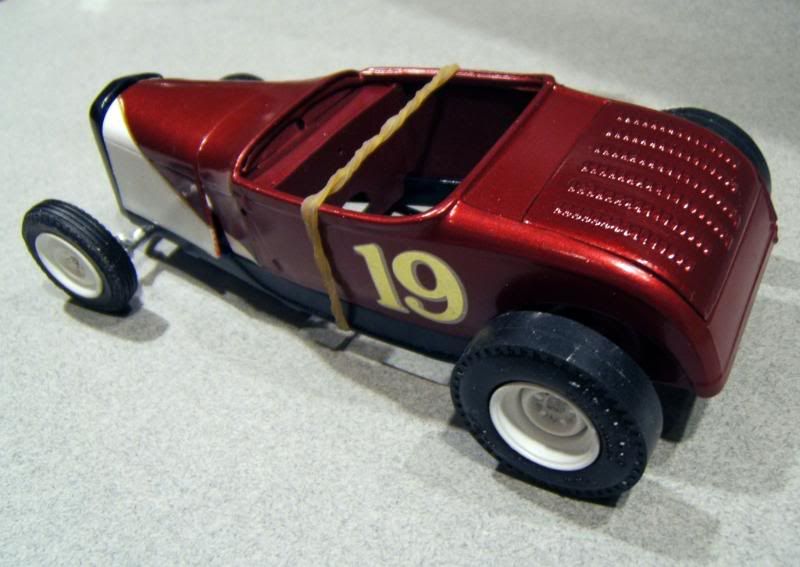

The only major problem I'm facing is the the back half of the hood, which is a resin piece from RepMin, has splayed outwards and no longer lines up with the cowl. Does anyone have any tips on how to return it to it's proper shape?
Below are some pics of the completed wheel sets and the painted body.

WOW!!
The paint scheme looks awesome!! I really like the look!!
You know I'm not much with resin, but I'm pretty sure that Dave is right about using hot water to get the shape back...
Keep up the GREAT work!! I can't wait to see this one Under Glass!!

Dave, the inside of the body is all painted red metallic like the exterior except for the hood. The inside of the hood was painted, too, just not the final color. I'm running a p/e grill so you can see the motor (no radiator) through it. I haven't decided whether to paint the inside of the hood white for contrast against the red motor, or red metallic for continuity with the rest of the interior surfaces. The other thing I haven't decided on is what color to paint the interior panels I made, red metallic or perhaps some sort of dark metallizer for a more funky/realist look. I plan to leave the rear deck removable so you can look at the back end of the frame and rear suspension by removing it. I'm also going to leave the tonneau cover I'll be making removable to show off the frame and interior. I will, however, glue the main body in place.
And thanx for the advice on the warm water. I'll try it. I think the distortion is the result of too many trips to the dehydrator!

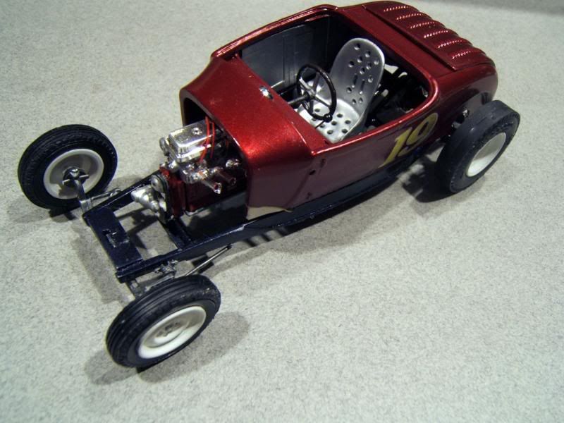

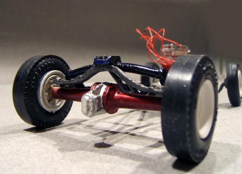

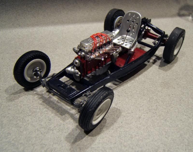

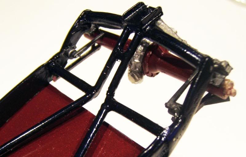

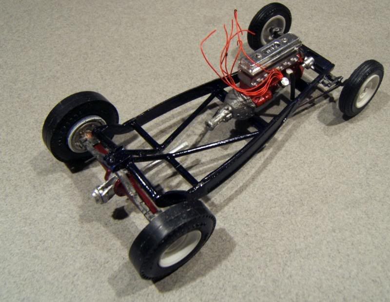

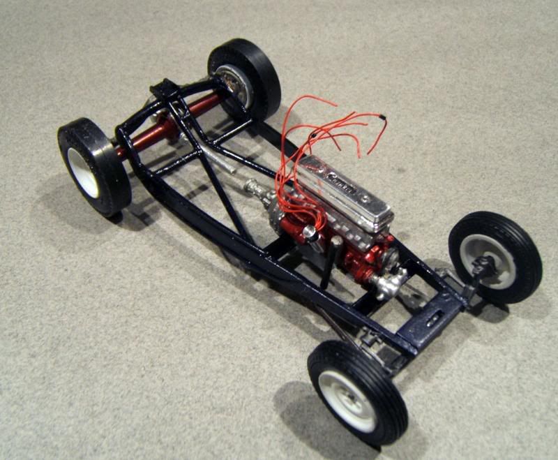

It’s a roller! The front and rear suspension are largely complete. The front end uses a tubular dropped axle from the Revell ’32 Ford series with the shock mounts removed. The top two leaves from the spring have been removed and the mounting tab cut down to lower the front end some more. Vane type shocks (so-called “friction†shocks) from the Revell ’29 Ford RPU have been adapted. A steering arm has been installed on the left kingpin. The actual steering is mounted in the body so it hasn’t been installed yet. Split wishbones adapted from an AMT ’29 Ford Roadster are used. The rear suspension is almost entirely from Early Years Resin, quick change rear end and spring. Vane shocks from the Revell ’29 RPU and split wishbones from the AMT ’29 Ford Roadster haven’t been installed yet. Most suspension parts are finished in Testors Metallizer Gunmetal. Also included is a picture of the interior panels which are installed and finished out in Testors Metallizer Magnesium. Next up is fabrication and installation of the steering mechanism, finishing up the remaining suspension bits, and then detailing the interior. Final assembly can’t be too far away now!
Thanx for the tips on bringing the resin hood back into shape. I combined the hot water and a rubber band to align it with the frame rails and it did the trick!

Yes Raul...Bernard is having too much fun :P
coming along just fine - I like it!
lookin' forward to seein' this model in February
Have we reserved our table yet??

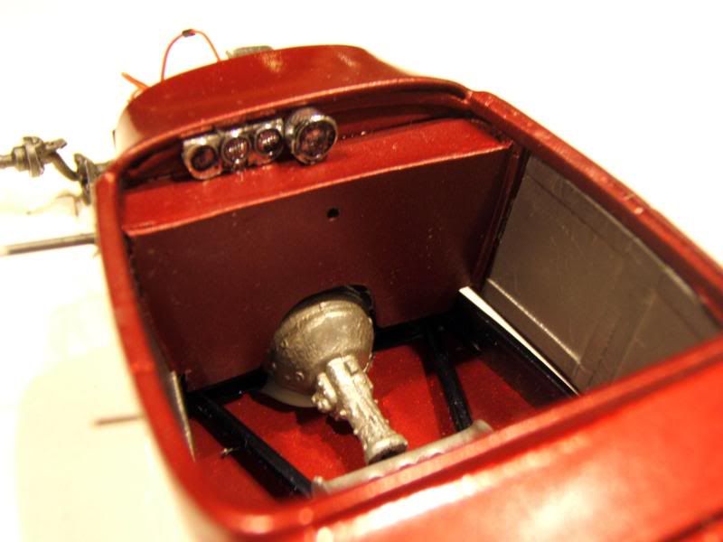

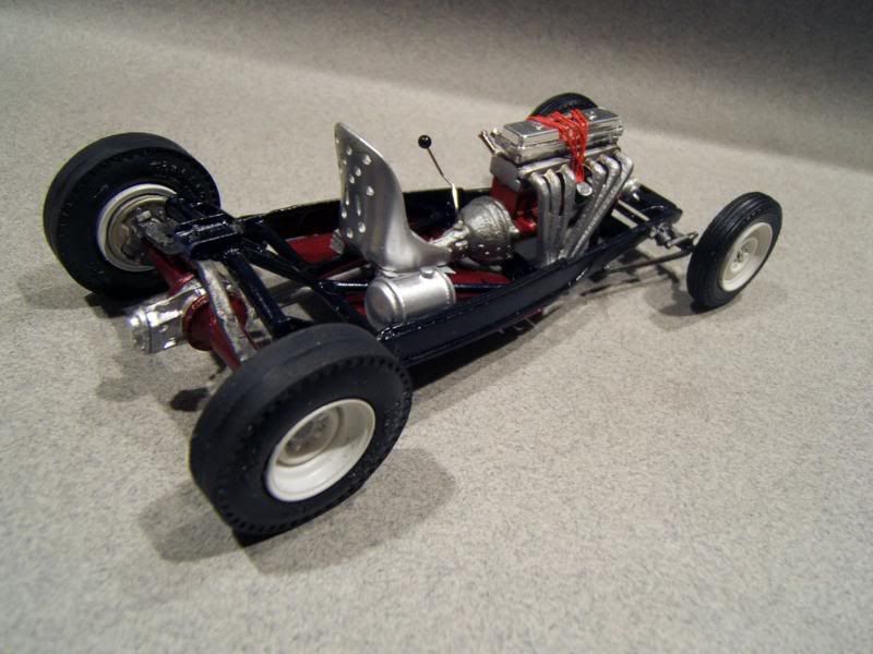

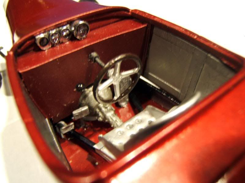

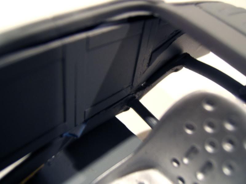

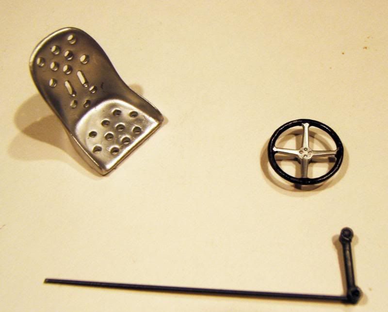

Thanx for the encouraging words. This project continues to crawl along. Lots of scratch building and trial fitting. This one will probably make it to the NNL if I don’t screw it up too badly on the home stretch! It’s definitely my most challenging build so far. Gary, I used the Inliner website for reference work when I built the motor. Great place full of cool info! Here are some more detail pics.

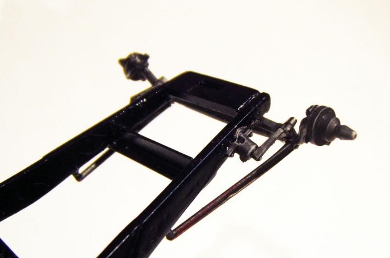

The interior is almost completed. I have to fabricate a driveshaft and install the engine in order to determine the correct seat height to clear the drive train. The steering is completed including a tubular Pitman arm and tie rod. The gauges are standard aftermarket tach and gauge cluster typical of the period – nothing fancy since it’s a race car. They come from an AMT ’40 Ford sedan kit. The seat is a resin piece from The Parts Box in Australia and the steering wheel is the Bell race car wheel from the AMT ’53 Studebaker kit. Both are finished in Testors Metallizer Plate Aluminum with a Testors “Rubber†enamel painted steering wheel rim. I’ve also included some more detail pics of the front and rear suspension as everything is completed and installed now. I landed up making shorter track-style radius arms for the rear because of height and fit issues involving the floor pan.
Things left to do are final detailing and installation of the engine, the aforementioned driveshaft, mounting brackets for the seat, pedals, shifter, etc., etc., etc. Details, details, details… The final two steps will be installing a p/e grill so you can peak through it to see the engine and making a removable cloth tonneau cover. I’m shooting for next weekend to get this one Under Glass!

Your firewall design looks pretty cool, but I'm really diggin' that seat and steering wheel. The silver you used looks great.
Comin' along real nice B :D Love that seat! Don't look real comfy tho :P;) Did they use seat belts back then in these things?

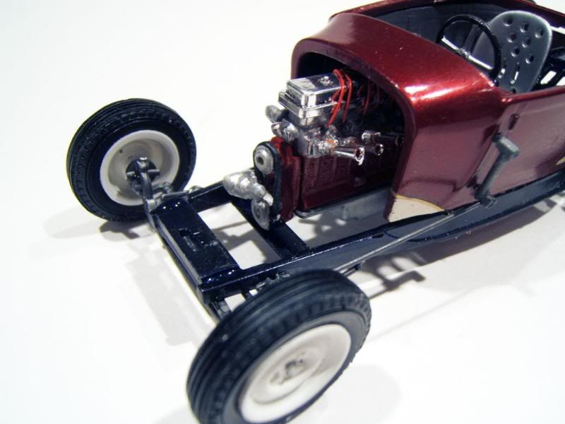

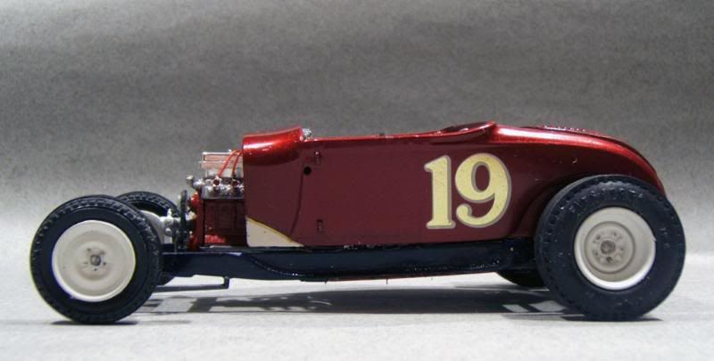

At last I’m getting a sense of real progress on this build. I thought I’d get this one done last weekend but for some reason all the details are taking me a long time to do. The motor, chassis, interior and most of the body details are all done. Since the body will be permanently mounted to the chassis I took some final chassis pics and then began assembly. Still left to do are fitting the hood (the resin hood splayed outwards slightly again so it needs to be reheated and bent to fit), assembling the grill and final alignment of the hood and grill in relation to the body. The last detail will be a tonneau cover. Ideally I would like the hood, rear deck and tonneau cover all to be removable to show off the interior details.

:lol:Bernard!!! Yer crazy if'n you gonna cover this up!
I'd jump in it, fire it up, and.....well, hope it goes straight
(forgot it aint got no steery wheel in it :P )
Seriously B, even tho' it'd probly be a bit of work? I'd consider takin' a page outa Treehugger's 'book' and make you another
rollin' curbsidey frame to set the body on, then display 'em both.
Really oughta be a law against hidin' really cool stuffs like this :rolleyes:
:P:lol::lol:
Lookin' way too cool B-- keep it goin' :D
...Seriously B, even tho' it'd probly be a bit of work? I'd consider takin' a page outa Treehugger's 'book' and make you another rollin' curbsidey frame to set the body on, then display 'em both.
Really oughta be a law against hidin' really cool stuffs like this :)
:lol::D;) ...
Thanx John! I hear 'ya. Unfortunately the body has to be glued to the frame or it won't sit right. And, frankly, this build is pau. The thought of doing any more on it is..... :huh: At least I took lotsa pics.

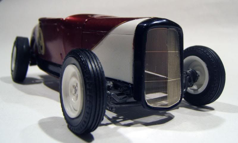

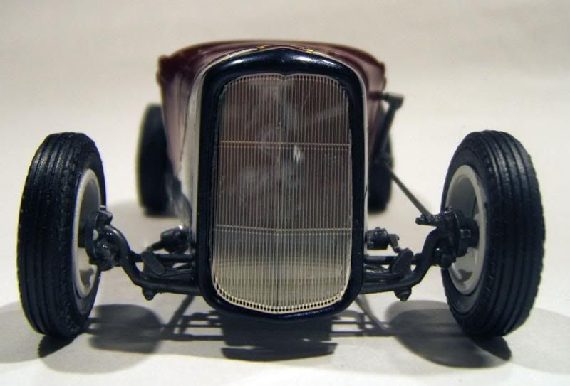

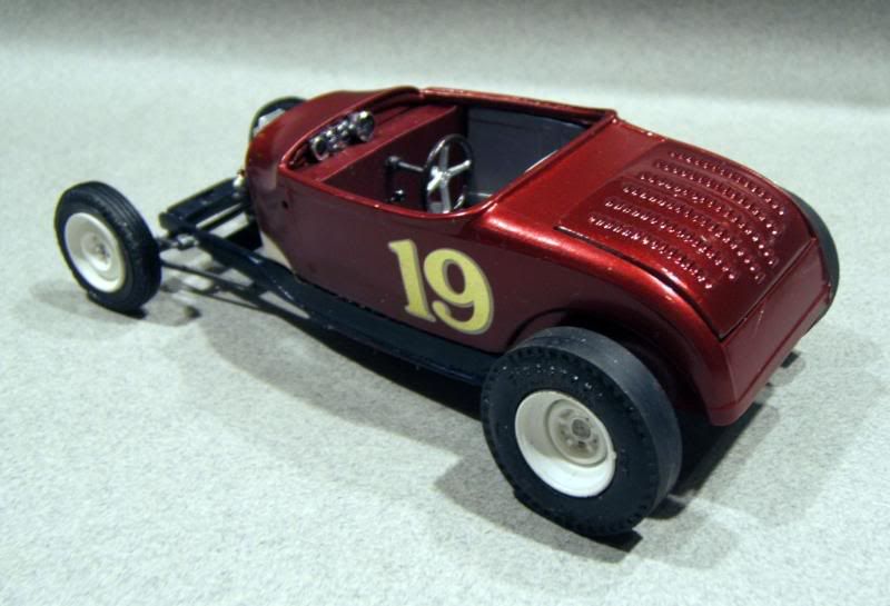

It’s done! This has been a 3 month build, a very long time for me; most of the time my builds take 6-8 weeks max. I decided to omit the tonneau cover. It just didn’t look right to me. I’ll probably keep on working on it. If I can get it looking OK I’ll post some additional pics (don’t count on it…).
Below are some detail pics of the steering and the grill, a p/e piece from Model Car Garage fit into a Revell shell that I hogged out.
