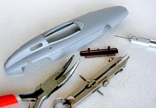

Ddms Posted September 24, 2009 Posted September 24, 2009 Terrific subject! My favorite era, scale and type of car. Only Ettore's mama could love the "styling" of his tanks, but they certainly had character. Hope you'll do a WIP. Do you have a source for those tall skinny wire wheels? Recently, I spent quite a bit of time searching for some early wires with no success. The only solution I could find was to cannibalize a diecast. The car looks like it has about 50 lbs. of rivets. I've just finished riveting up my Finescale 1/24 BRM P57, and learned a lot in the process. Here's everything I found out; hope you find it useful: I looked everywhere for rivets. There are some amazingly expensive metal ones out there. There are even decals that are supposed to look like rivets. Don't know how you would hide the film, though. I ended up using styrene Tichy Train Group rivets with .030" heads and .015" shafts. They come on a sprue and are intended for HO train applications. They are cheap - only $2.50 for 200 rivets. The Tichy rivets themselves are fine, but I'm not very happy about the size I chose. They scaled out too big. I think something like an .008" head would be correct. The smallest you can get from Tichy is .020". Scale Hardware has even smaller ones. They sell 100 brass .016" rivets for about $10. They're expensive and harder to handle, but they would look a lot more realistic, especially since there are so many on your Bug. For spacing the rivet holes and punching starters, a good pair of drafting dividers with pin-points on both legs is indispensable! Dividers would also be very useful for spacing those louvers. To look right, a straight line of rivets has to be very, very straight. The tricky part is not so much spacing the holes - that's easy with the dividers - but in drilling the holes in a straight line. I scratched a line in the primer, then, wearing an Opti-visor, I used the dividers to punch pilot holes along the line. Well, I thought I was punching them on the line. The pinholes even looked like they were lined up pretty straight. But then I drilled them (#74) and inserted rivets in the holes. Aaargh! As it turns out, any deviation from the line looks awful. If I were to do it again, I'd use a scribing tool to cut a fairly deep groove - not merely a scratch! - along the entire planned rivet line. (Dymo Tape works well as a cutting guide. Softer tape allows the scribing tool to wander.) Then it's just a matter of stepping the divider down the groove and making a pilot hole at each step. Once the holes are fully drilled, you can sand away the groove. Or fill it with putty. Or both. Obviously, the groove has to be totally "disappeared" before you insert the rivets! Inserting each rivet individually sounds tedious, but it's surprising how fast it goes once you get the hang of it. I use a wet finger to pick them up and needle-nose pliers to insert them. For some reason, the pliers worked better for me than tweezers; I was surprised that they were so gentle with the rivets. I was also surprised at how sturdy Tichy's styrene rivets are. I inserted more than 100 and ruined all of three. So there's no durability advantage to the more expensive metal ones. Instead of dipping each rivet post in glue, I inserted about ten rivets and then applied glue to the backside of the panel - Hurray, no glue on the surface of the car! I used CA, but just about any glue would work. After the glue dries, the rivet shafts inside the panel can be sanded off. Keep in mind that it's very hard to sand or polish an area after it's been louvered or riveted. That will make sequencing your build a bit of a challenge. Best of luck with that Bug! I'll be especially interested in how you end up doing the rivets. Ddms

Ddms Posted September 26, 2009 Posted September 26, 2009 Holy Cow!!! These are fantastic...I was gonna use a "ponce wheel" for the rivets now just gotta figure what size i'm gonna need thanx Dry transfer rivets may be easy, but it seems like there would be problems. Wouldn't the film border be visible as a raised surface on the car? On that Bugatti, you'd have film borders running all over the place. And if the rivet line is curved, how would you bend the film to follow the curve?

Ddms Posted September 26, 2009 Posted September 26, 2009 I just ordered a set of these, per the web page...they are a 3-D decal that applies just like regular wet decals. So moving around curves and the film edges should not be a problem. I hope the dry transfer method works out for you, because it's got to be easier than placing, drilling and inserting individual rivets. But with the dry transfers, you'll have to cut each row of rivets from the sheet. Since you can't trim right up to each rivet individually, each row of rivets will sit on a raised "platform" of film. I can't figure out how all that will not be a problem, especially on your car, which will have many, many rivet rows laid out on flat surfaces. Every row of rivets will be on a raised strip of film. You can see what this looks like on a submarine at http://www.travel-net.com/~gcauley/U673/. The boat was built by the guy who worked with Archer to develop their rivet system. The dark line of film is clearly visible between the rivets. I realize that the rivets on my car are too big, but, as I said in my post, smaller ones are available. Regardless of what aircraft modelers do, I still think the 1:1 method - one rivet at a time - is more realistic. And more faithful to 1:1 practice.
curt raitz Posted September 26, 2009 Author Posted September 26, 2009 I hope the dry transfer method works out for you, because it's got to be easier than placing, drilling and inserting individual rivets. But with the dry transfers, you'll have to cut each row of rivets from the sheet. Since you can't trim right up to each rivet individually, each row of rivets will sit on a raised "platform" of film. I can't figure out how all that will not be a problem, especially on your car, which will have many, many rivet rows laid out on flat surfaces. Every row of rivets will be on a raised strip of film. You can see what this looks like on a submarine at http://www.travel-net.com/~gcauley/U673/. The boat was built by the guy who worked with Archer to develop their rivet system. The dark line of film is clearly visible between the rivets. I realize that the rivets on my car are too big, but, as I said in my post, smaller ones are available. Regardless of what aircraft modelers do, I still think the 1:1 method - one rivet at a time - is more realistic. And more faithful to 1:1 practice. At this point I'm gonna give the rivet decals from Archer a chance, if they don't work out - I'll use my "ponce wheel", if that doesn't work...the model will be built without rivet detail...I will not be doin' individual rivets. I like detailing the models I build, but gotta draw the line somewhere...I'd go nuts doin' a kazillion rivets I'll have to see how much of an edge the strip produces, besides from all the photos I have of this car the body is really rough and nasty...not your typical Bugatti thanx
