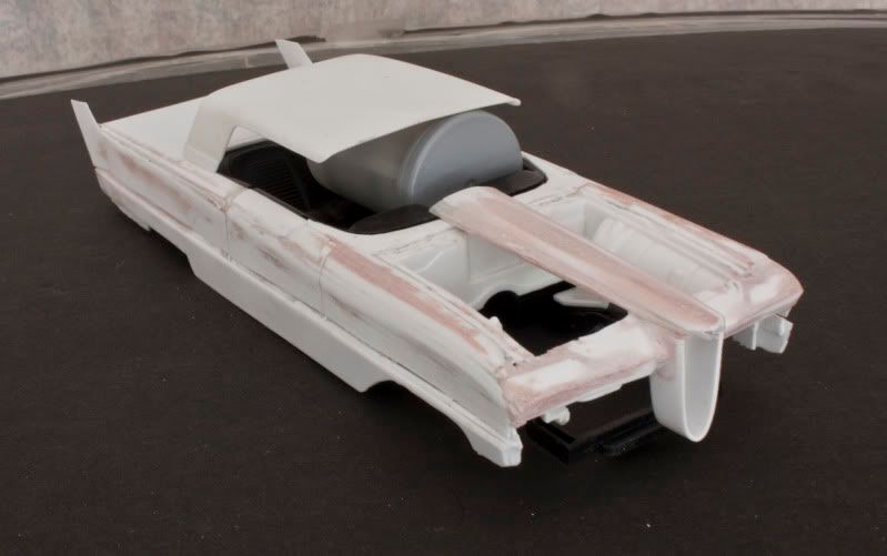

Harold Posted October 27, 2009 Author Posted October 27, 2009 Last night I got the beginings of the rear deck in place. Armed with a Dremel, a cutoff wheel and some .040 Evergreen, I went at it. The first order of business was to put a 90 degree bend in the plastic. After a bit of hot water and final shaping using a lighter, I got it bent without breaking. Then I grabbed the Dremel and removed the rear deck by cutting along the inside edges of the fins and 1/4 inch behind the interior opening to retain some structural integrity. After tacking it in place with gap filling CA and Zip- Kicker, iran a bead all around the seam on the underside of the car, and gave it another spritz of accelerant. As far as the windshield, I've found myself looking at blister packs, and I think the one from my Mach lll might do the trick- maybe. I'm toying with the idea of using a mid- 60's Corvette for the hood and the basic front of the car (they appear to be similar). Tonight I'll probably get the fins shaped and installed and start slinging some Bondo. Also, thanks to everyone for the words of encouragement.

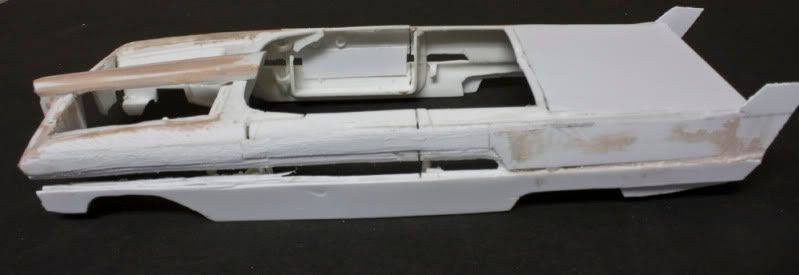

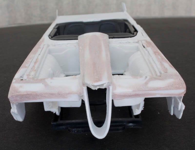

Harold Posted November 11, 2009 Author Posted November 11, 2009 (edited) Things are still moving slow here in Palmerica, but I've banged out a little more on my Packard. I removed the headlights and grille header, removed the eyebrows from same and glued it to the body. The lines indicate where I've made lengthwise cuts down the tops of the fenders to form the catwalk between the hood openin and the base of the fender crown, and the leading edge of the T-Bird hood was glued in place. The sprue from the body interior section served as the start of the undercut... and a section the width of the radiator opening was removed and the beginnings of the grille opening were made with an .040 piece of Evergreen. The dome on the hood was made from the cruiser skirts in the '64 Mercury kit (I knew I'd find a use for them .) The dome continues into the interior to become the center of the dashboard. The top of the cowl was reworked to mimic the Predictor, and as soon as everything is shaped properly, the hood section and dash sections will be removed. Edited November 11, 2009 by Harold

Harold Posted November 12, 2009 Author Posted November 12, 2009 BTW... has anyone ever told you that you look like the guitar player from Lynryd Skynryd? I don't know his name, but you know... the guy that looks like you! Thanks, although I've been influenced more by bands like Procol, Gov't Mule and Phish (Warren Haynes and Trey Anastasio have been my newer favorite guitarists for the last couple years). A friend of mine gave me a set of woodworking riffler files over the weekend, and today I got aggressive and started shaping the incuts on the bodysides. The files work very well- if I can have a day or two to really get at it, I might be giving it its first coats of primer soon.

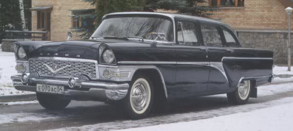

Harry P. Posted November 14, 2009 Posted November 14, 2009 This is a late '70s Russian Chaika. Yes, '70s!!! Look familiar?
Chuck Most Posted November 14, 2009 Posted November 14, 2009 This is a late '70s Russian Chaika. Yes, '70s!!! Look familiar? That's it!

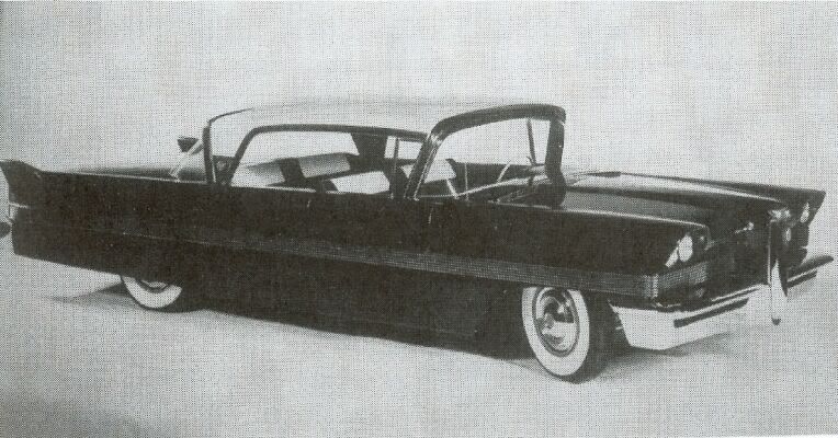

Harold Posted November 16, 2009 Author Posted November 16, 2009 (edited) Harold- did you know that the Predictor was supposed to have been the origin for the all-new '59 Packards that never were? They'd planned to buy the old '57 Lincoln tooling from Ford to use as the basis, and work some of the Predictor's cues into it, but that deal fell though. Oddly, though, the old Packard body tooling lived on in Russia for many years. I think it was called the Zil or Zaff or something all warm and Commie like that! 'Nudder fun fact: In some early literature, this car was identified as the "Projector". Now I'll just shut my trap and let you get back to work! Long Live Packard! (Metaphorically...) Actually, the Predictor was supposed to be a forecast of the '57's, but although investors were impressed with their plans, they looked at Packard's partner, Studebaker, as a giant, money losing millstone (not far off the mark). They built one prototype, Black Bess. Richard Teague said it looked "like it had been built with a ball- peen hammer and a cold soldering iron". this is a 1/10 scale styling model Black Bess Here's how the '57 would have looked on the Lincoln body (Bill Schmidt had left Lincoln to become head of Packard styling in '55). This was a last ditch effort to field a Packard for '57, but the deal fell through. After entering into a management contract with Curtiss- Wright in '56, the Packard facilities in Detroit and the engine plant in Utica, Michigan were sold off. Packard lived the next two years as barely disguised Studes. Edited November 16, 2009 by Harold
Chuck Most Posted November 16, 2009 Posted November 16, 2009 They built one prototype, Black Bess. Richard Teague said it looked "like it had been built with a ball- peen hammer and a cold soldering iron". So in other words, it looked like it had been built according to the build standards of the time? Thanks for the correction on my foul-up, and the pics! Shame they never actually got built!

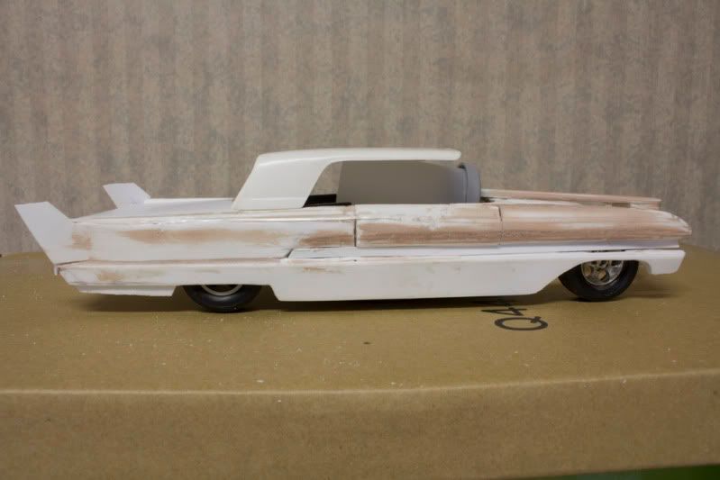

Harold Posted November 16, 2009 Author Posted November 16, 2009 Here's where the tricky stuff begins. I had to add the undercut that runs to just behind the doors, and then drops perpendicular to the ground. After much thought, I grabbed my razor saw and remeoved a strip from front to back, and then shaped everything with my 'raspy rifflers'. Then the fun began- slapping on some Bondo. I then cut a piece of .020 Evergreen to fit in the gap I'd removed. Really, I couldn't think of any other way to get that shape on the sides. Now, I need to flesh out the front of the fenders and make a hood. Then, on to the fins. Here's what I've got so far... Not a bad looking mockup. All traces of the '58 T- Bird are almost gone, and I might try to rework the 'Bird roof.

mr moto Posted November 16, 2009 Posted November 16, 2009 Oddly, though, the old Packard body tooling lived on in Russia for many years. I think it was called the Zil or Zaff or something all warm and Commie like that! The ZIL was even more Packard than the Chaika (The Chaika looks like the love child of a Packard and a Checker to me). The ZIL is what the commie bigshots used as a limo for many years. Here's a couple of pics:
