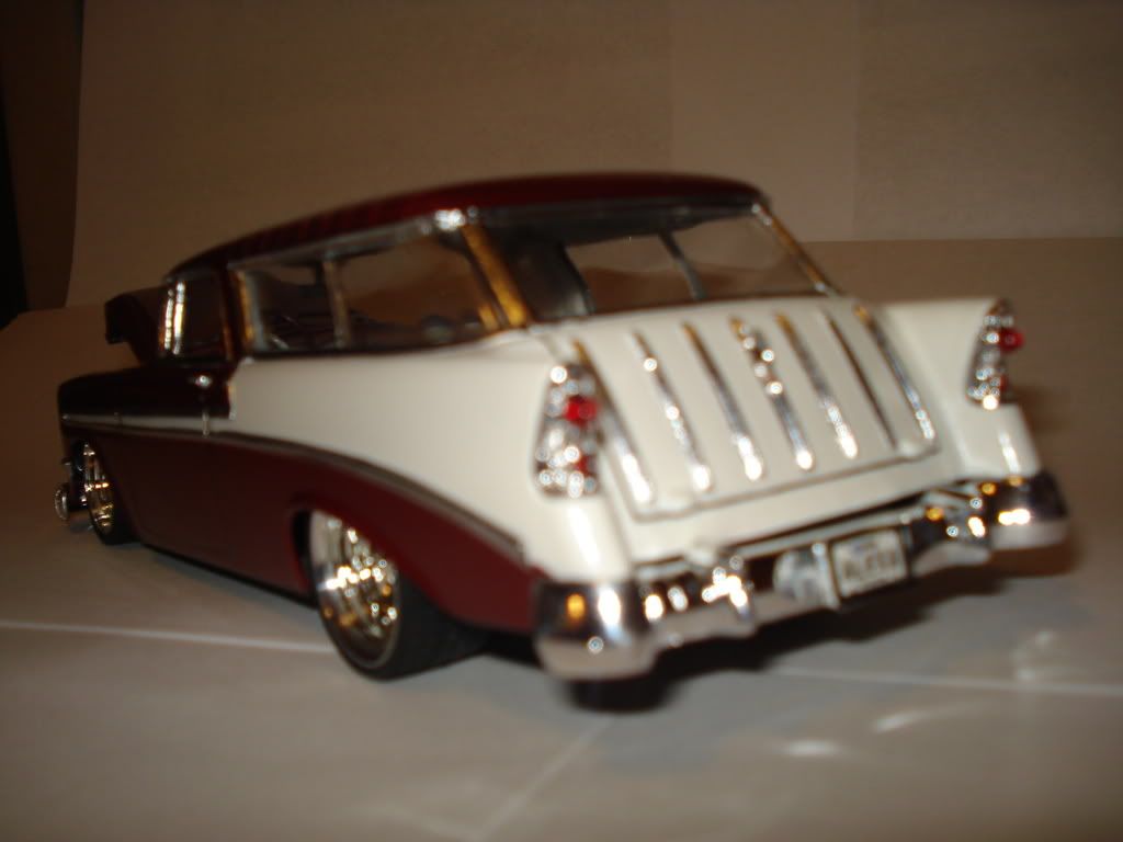

looking good Ryan, this one is going to look cool when done, here is mine i did last year i also swaped out motors, put in 67 chevy bb 427f.i. with good results added some big n little pegasus wheels. two tone and interior aslo. B)

Your's looks real good too! Love the red. Nice job on the BMF work. Thats probably what I'm most worried about, I haven't used it a whole lot and really don't want to mess this up! Any tips?
thanks Ryan, just take your time! the biggest issue i had was the side trim, dont press to hard use a cotton swab and toothpick, real sharp xacto-blade (new) i got real lucky around window pillars and tail gate in one shot. good luck buddy! :angry:
