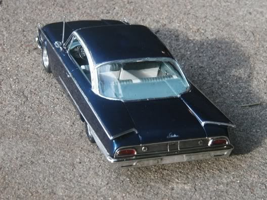

I would sand and polish off as much as you can and shoot some Future on it.
I had a clear part that was just scratched up and with Future on it you can't even tell. It is one of my best looking clear parts.

Edward, Cal wow those are great lookin windows by the way. I've heard of Future but am very unfamiliar with it. What is it and you just dip windows in it? Sorry it's more than likely a well covered topic but hey... lol. Again thanks all for advice. :rolleyes::unsure:

It is floor wax, I just spray it on with an airbrush.

yes, it's the floor stuff. Basically it is clear acrylic. You can dip parts, spray through an airbrush, sable brush it on, etc ...
Great medium with no fumes and water clean up.
