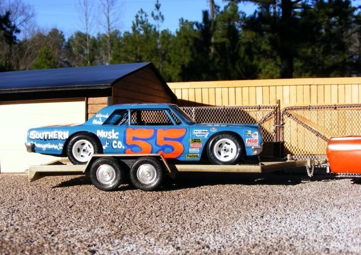

LUKE'57 Posted March 8, 2010 Posted March 8, 2010 I fought those things back in the seventies when they first came out when I built models for the local racers. I think they just cut the rear openings from where the funny car with the altered wheelbase was and that's why the rears are so large. I filled them in with plastic and putty back in the day but the prettiest one I did was for an asphalt racer friend of mine. I cut the openings out square and then grafted the square cutouts from a '71 Cyclone body in the holes. The side creases matched and when I cut off the concave lips I had some pretty nice fender flares to boot. Put the MPC Grand National chassis under it for a better cage and wheels and tires. If you want to build a Chevelle these days then the Revell '65 Chevelle body is a better choice. Just combine it with one of the easily (and cheaply) availible Monogram Nascar racer's chassis and roll cage and you're in business. Here's one I did for my son, who's a big Tiny Lund fan, for his birthday. A lot less hassle and closer to scale.
