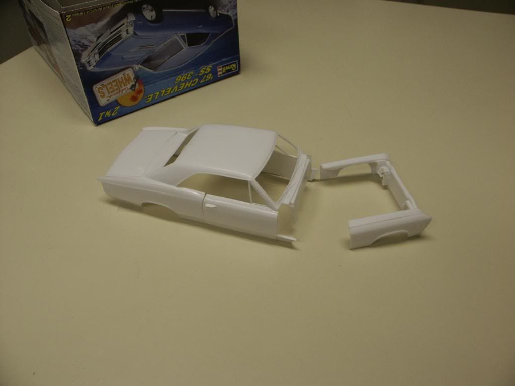

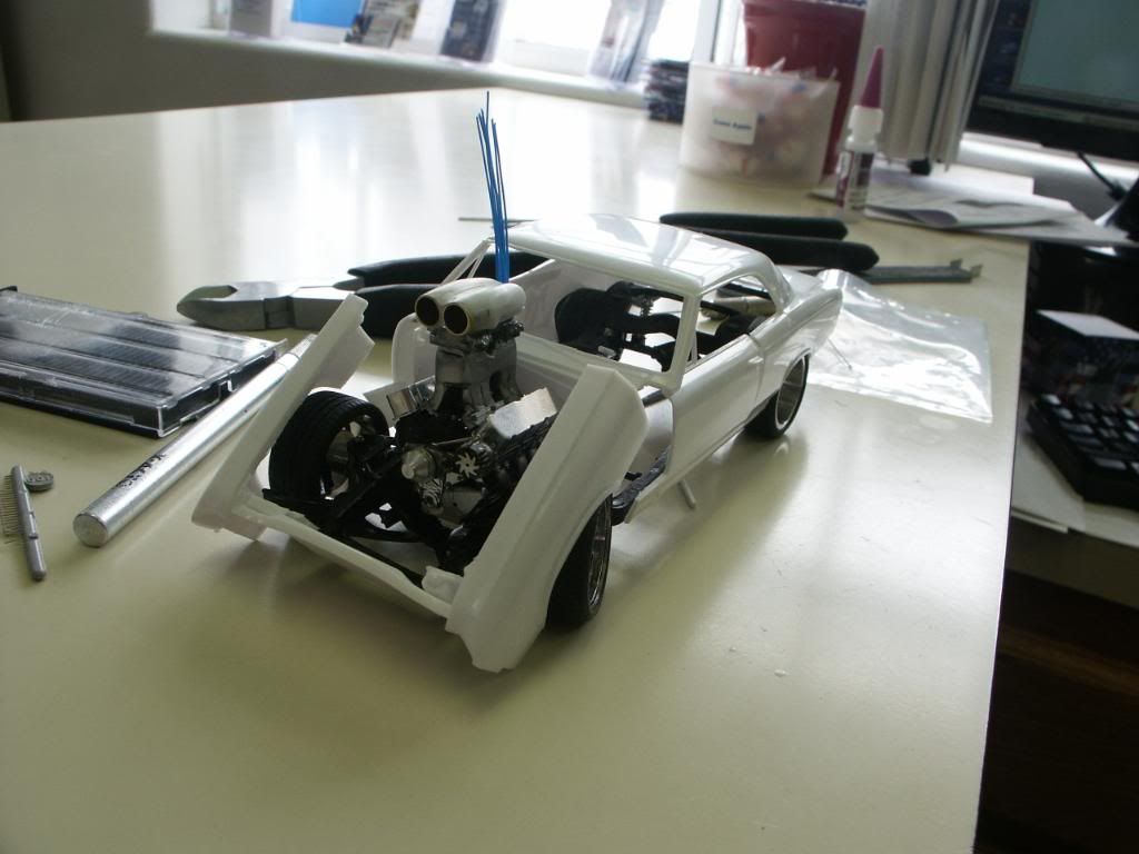

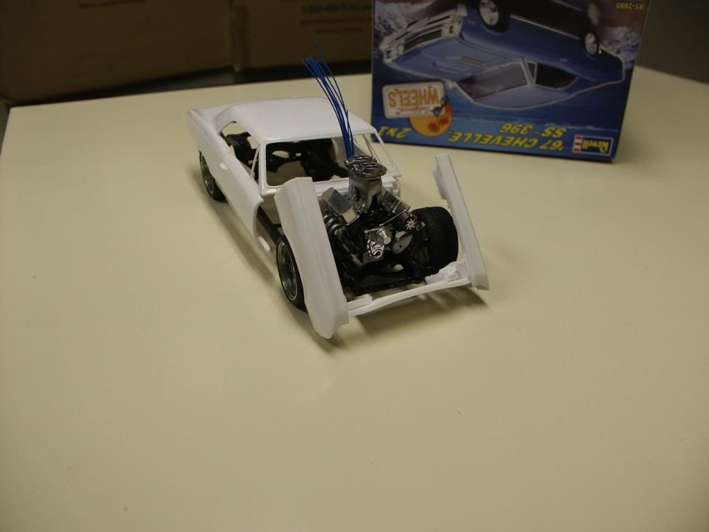

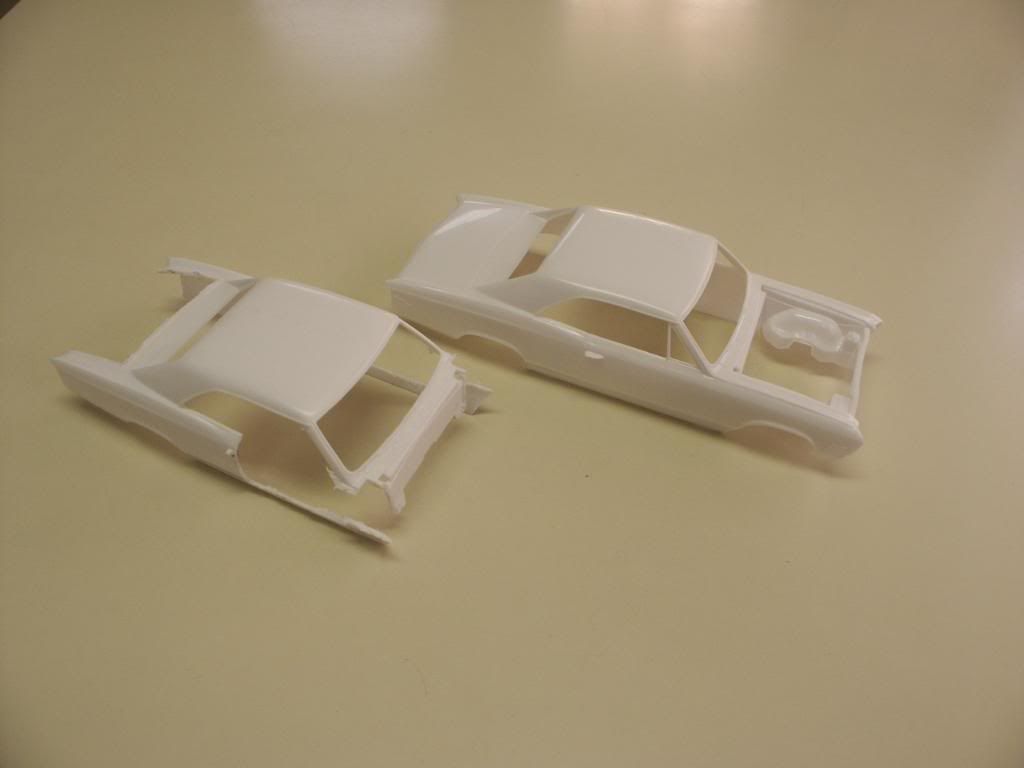

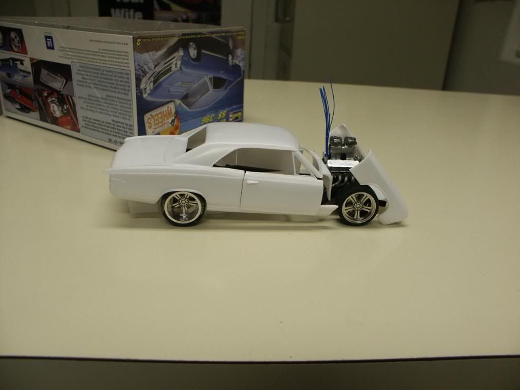

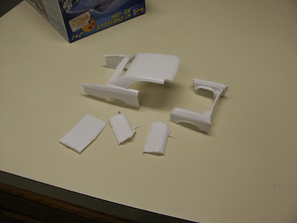

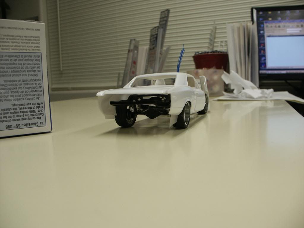

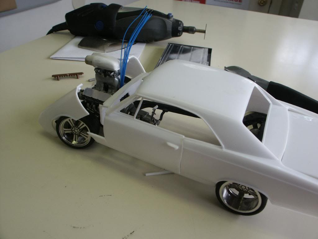

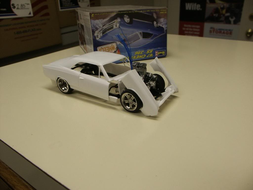

Thx go out to Mike And Marty for the kind words of incouragement, I havent posted in a few days because Ive been waiting on some photo ecthed parts to come in the mail...but i got bored waiting so i cut up the body and removed the doors and trunk. And since my 1:1 will have a tilt front end I cut it off too. So I have some progress pics for ya I hope you enjoy....
heres the body after cuttin it up..... LOL! J/K I have two bodys this one is what we call the donor body.
See you destroy one to get the doors and trunk or whatever you need, then you just cut out the same parts on the other body and file down to the lines.
See perfect fitting doors and trunk...
bodyparts006.jpgB)
Link to comment

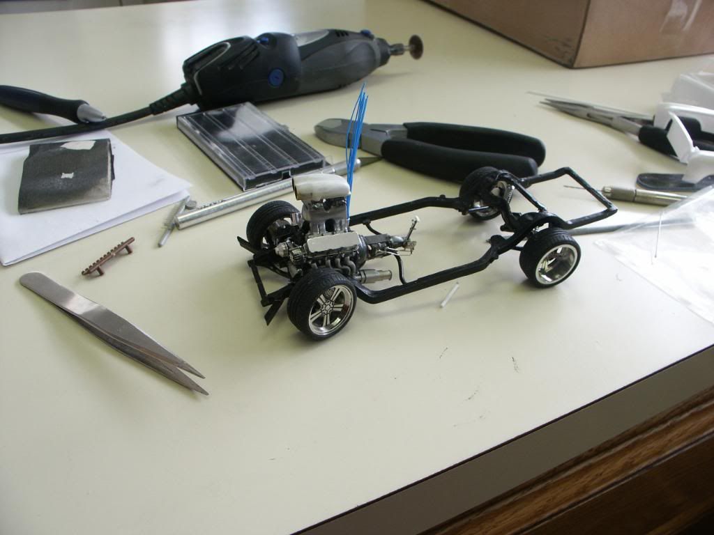

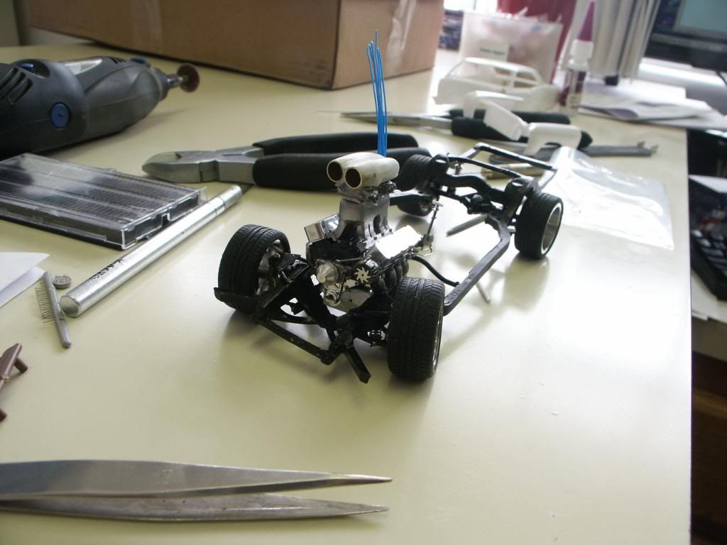

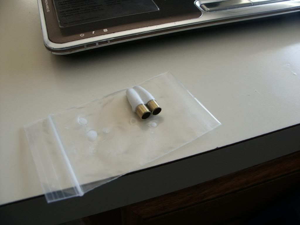

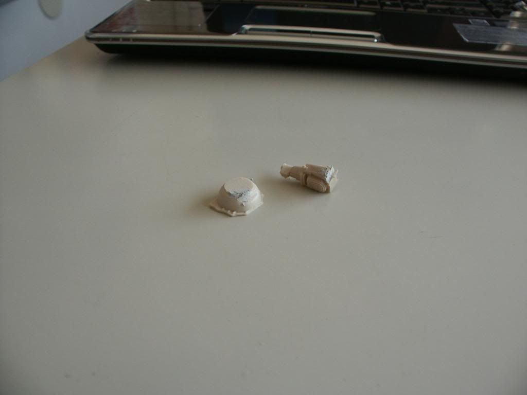

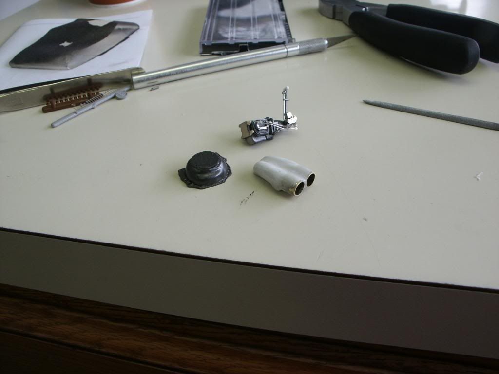

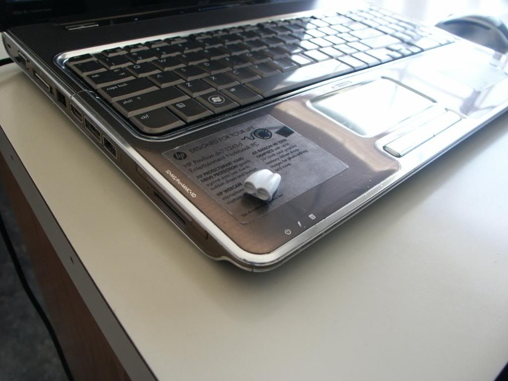

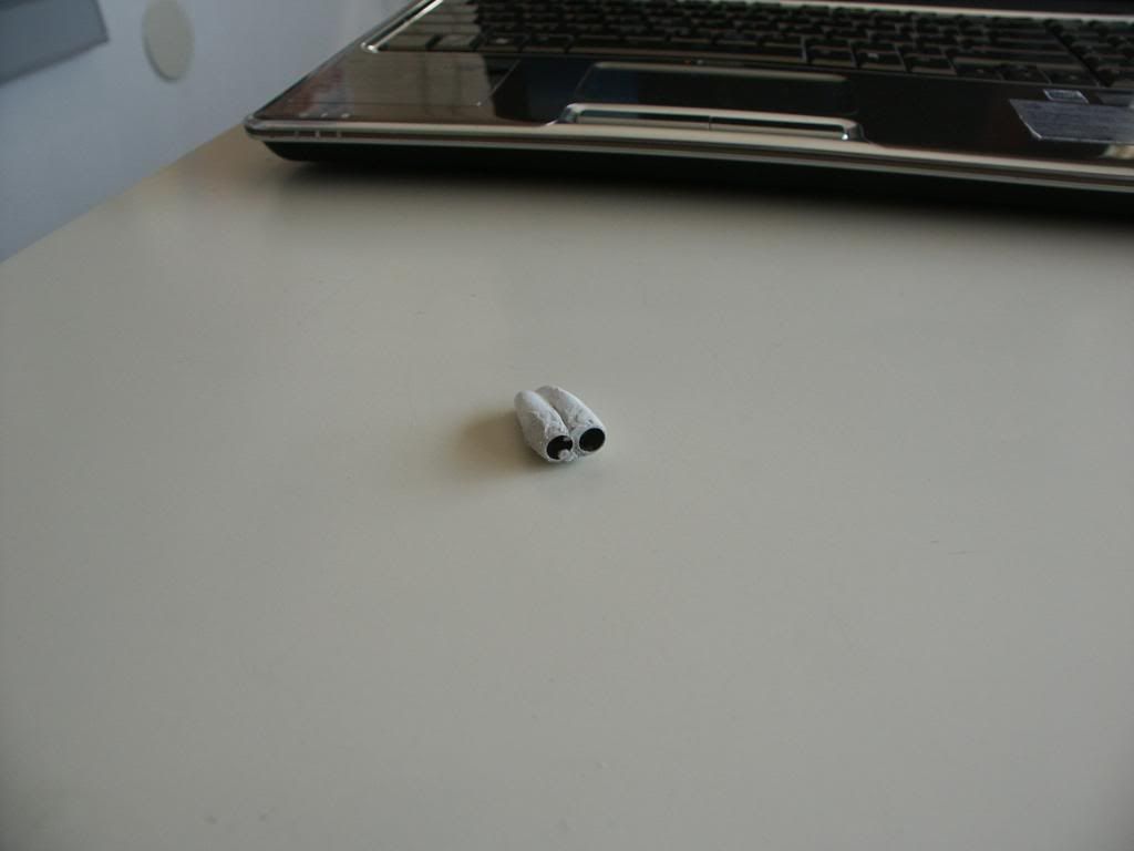

Hello fellas welcome back. I have a few progress pics for ya. I got my shotgun Bill scoop in the mail but it was too short so I had to add some brass tube to it and reform it. I hope you enjoy....
heres the hat with the extra tubing added
Here I added squadrens putty and CA glue the CA glue makes it almost like a plastic cover, I add the glue after i get the final shape then I resand.
chevelle061.jpg[i/]
Edited by Aftashox
Link to comment

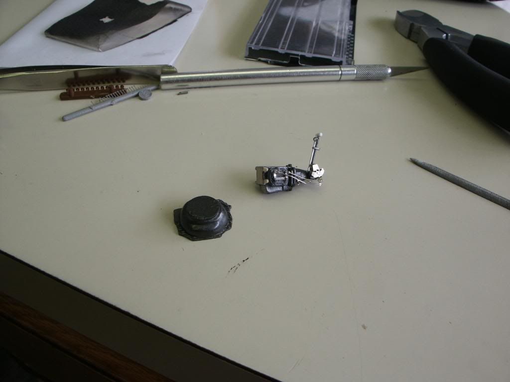

I wanted to simulate a BorgWarner 4 speed tranny with shift linkage and Hurst stright shifter. Heres what I started with...both pieces has a few hole in them that need repairing but a little white putty fixed that right up.
heres the tranny and Bell housing after paint and linkage detailing I still have to add bolts but its almost done
this is a pic with all three pieces simi done
chevelle067.jpgB)
Edited by Aftashox
Link to comment
