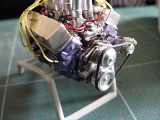

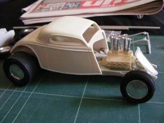

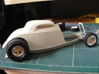

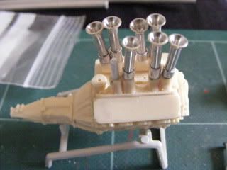

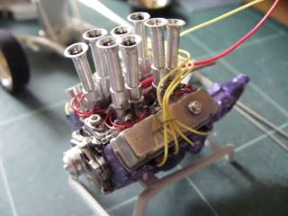

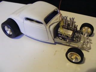

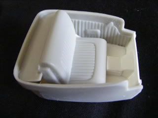

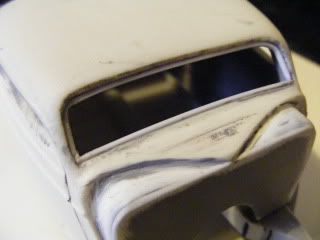

doomcrew Posted July 2, 2010 Posted July 2, 2010 ok, here goes another project. ithe body is a jimmy flintstone tracknose, which i chopped off, ouch!! the side and rear windows were opened up a little more because of the severity of the roof chop, and i wanted to make sure that the interior could be seen. it was either that, or attempt to open the doors or, cut a hole in the roof. i bought an AMT 34 5 window on evil bay, to use the extra parts, such as the interior tub and grill shell. the ross gibson motor went together well, and i used Mr Model injector stacks Model Car Garage Skiull detail set and Scale Repros Plus dress up kit. the only thing i need decide on, is the wheels. my own turned moon discs, or Detail Master Torque Thrusts. hmmm colour will be candy yellow over silver and maybe some graphics. steve
dwc43 Posted July 2, 2010 Posted July 2, 2010 Nice engine. I kinda like the moons. IT just seems to go with it. They just fit it.
my80malibu Posted July 2, 2010 Posted July 2, 2010 I agree, That is a Nice engine. All of what you have so far is very cool. thanks for showing us.

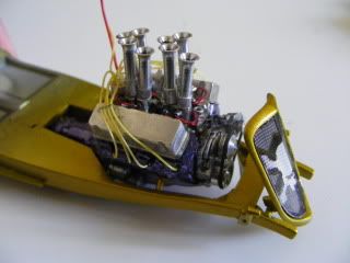

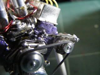

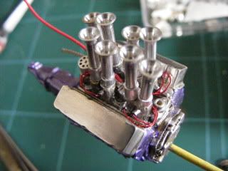

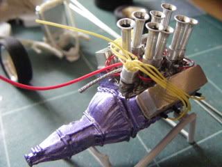

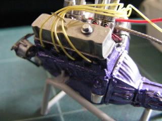

doomcrew Posted July 8, 2010 Author Posted July 8, 2010 here are some more progress pics. i got to work on my lathe and turned out an oil filter, and two pulleys to match the parts by parks pulley. the alternator is part of the resin engine kit, but used a n etched bracket and ally bolts. i have also done some mods on the body, namely the firewall and making sure that the channeled body sits nice on the chassis. steve
Harry P. Posted July 8, 2010 Posted July 8, 2010 ...the only thing i need decide on, is the wheels. my own turned moon discs, or Detail Master Torque Thrusts. hmmm... steve Not even close! The detail Master wheels look so much better in this case and give the car a meaner look.
shucky Posted July 8, 2010 Posted July 8, 2010 I'm wit' Harry on this one. Torque Thrusts look menacing on that thing.
Scalper Posted July 8, 2010 Posted July 8, 2010 Engine looks pretty cool. this will be a fast one. look out
crazyjim Posted July 8, 2010 Posted July 8, 2010 I'm likin' this build. Never cared much for Moon discs so I'd go with the Torque Thrusts.
vizio93 Posted July 9, 2010 Posted July 9, 2010 Really like that engine detail !!! And I too like the torque thrusts

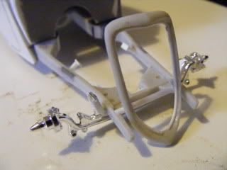

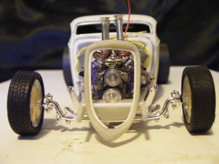

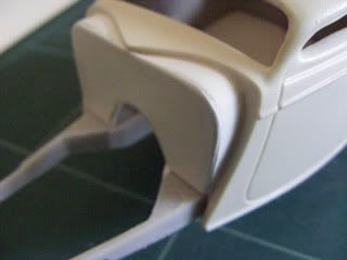

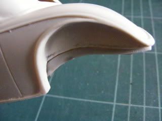

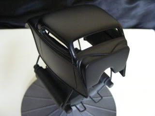

doomcrew Posted July 14, 2010 Author Posted July 14, 2010 well i have made some more progress and as you can see, i done the grill shell so it will take an etched skull grill insert (the tracknose that i cut off will go elsewhere). i have also scratchbuilt the front screen trim along with the engine mounts and gearbox x-member. thanks for looking. steve

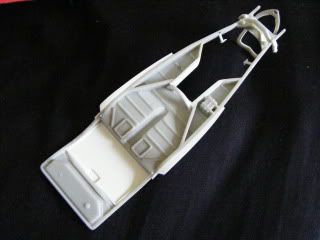

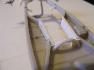

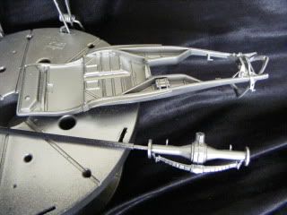

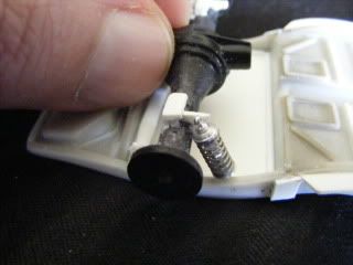

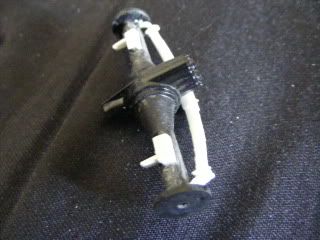

doomcrew Posted July 22, 2010 Author Posted July 22, 2010 i have some more progress on the chassis. i have modified the rear x-member and put in a new floor. i also used the rear end from a revell austin, and scratched new brackets for the R B MOTION shocks, the leaf spring is from the 32 orange crate. thanks for looking steve

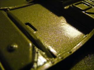

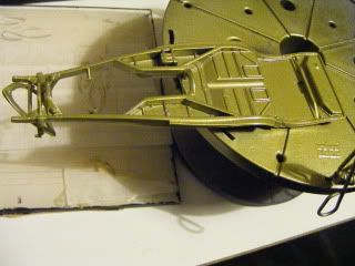

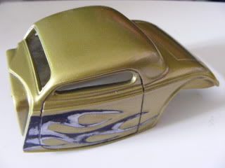

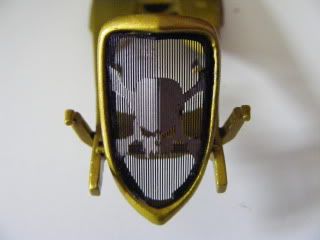

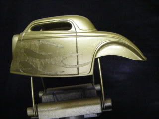

doomcrew Posted July 27, 2010 Author Posted July 27, 2010 (edited) got the chassis in to paint, which started off as matt black, then silver, then yellow pearl metallic. the next was a couple of passes of sparkle pearl purple, the colour used on the willys zombie gasser. the final stage will be candy yellow then clear coat. the body is going the same procedure, but will be masked for ghost flames, which will be in candy yellow over silver. steve Edited July 27, 2010 by doomcrew

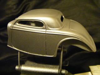

doomcrew Posted July 28, 2010 Author Posted July 28, 2010 a slight change of plan for the flames. i decided to "patina" the black accents in the flames which will change when the candy yellow is applied. this will give a hint of a rat look to it, aided by the skull grill. i did cover the grill shell with baremetal, but thought it looked far better in colour. steve
