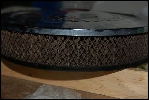

rdgracer71 Posted July 30, 2010 Posted July 30, 2010 has anyone ever scratched built a air filter for a 1/25 scale model.... this is what kind im talking about... im gonna try and make one...just wanted to know if anyone else has....

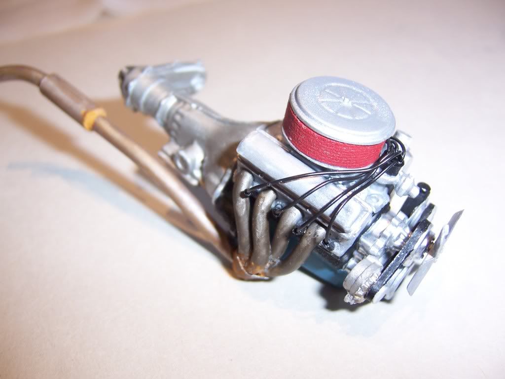

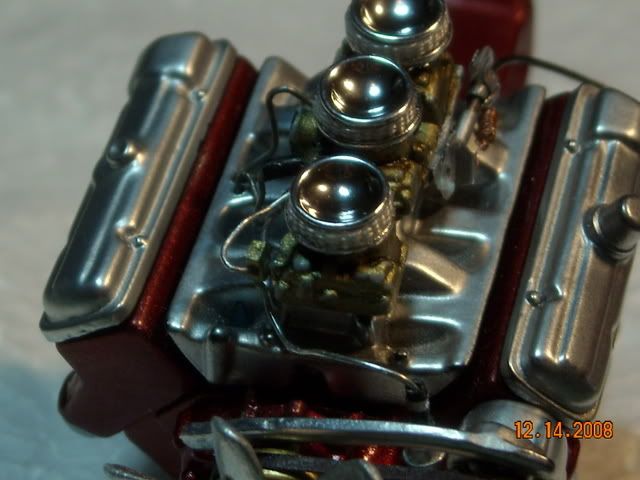

Jantrix Posted July 30, 2010 Posted July 30, 2010 I haven't ever build one like that as there are a lot of nice ones available in the aftermarket. I did do this one.

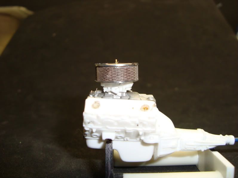

pharr7226 Posted July 30, 2010 Posted July 30, 2010 (edited) I used sheet styrene, medical tape and a doming block and punch set to make the filters on this '64 GTO. I heated the plastic and pressed the punch into the appropriate hole on the block, cut it out using a punch, primed it, painted it black and hit it with alclad chrome. Here is the doming block and punch set. Edited July 30, 2010 by pharr7226

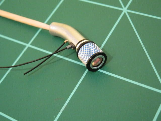

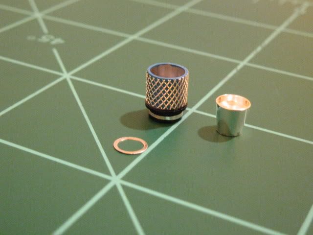

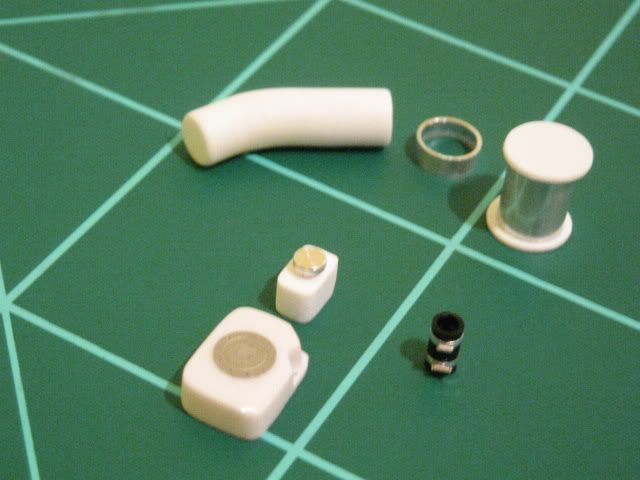

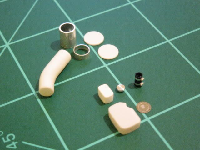

shucky Posted August 2, 2010 Posted August 2, 2010 Hi, I scratch built this open element unit for my GT500 but the concept is much the same regardless of it's size and shape. You have a top, mid section [filter area], and a base or bottom. Plus you have some material to make up the filter screen area. Here you can see much of what mine consisted of and the end result.

shucky Posted August 2, 2010 Posted August 2, 2010 Steve, I'm not sure if your referring to me regarding whether or not my unit is scratch built or not? My unit is made from styrene, aluminum tubing, and mesh. I'd call that 100% scratch built. No kit parts in my photos. The intake tube, MAF sensor, hose clamps are all scratch built in fact.
