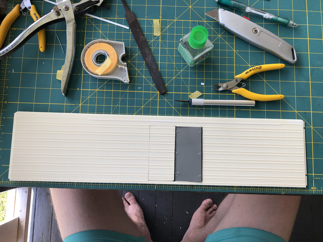

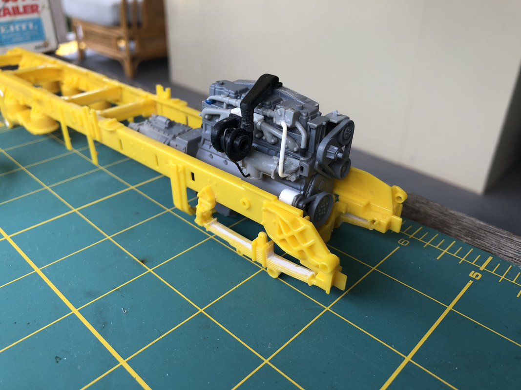

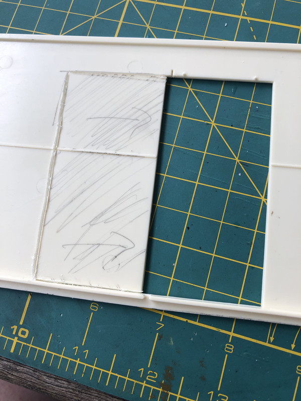

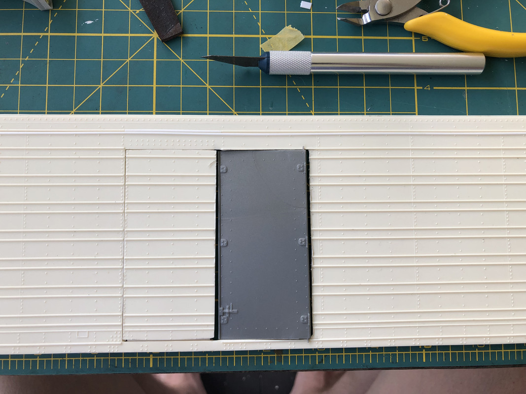

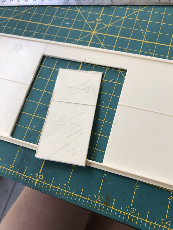

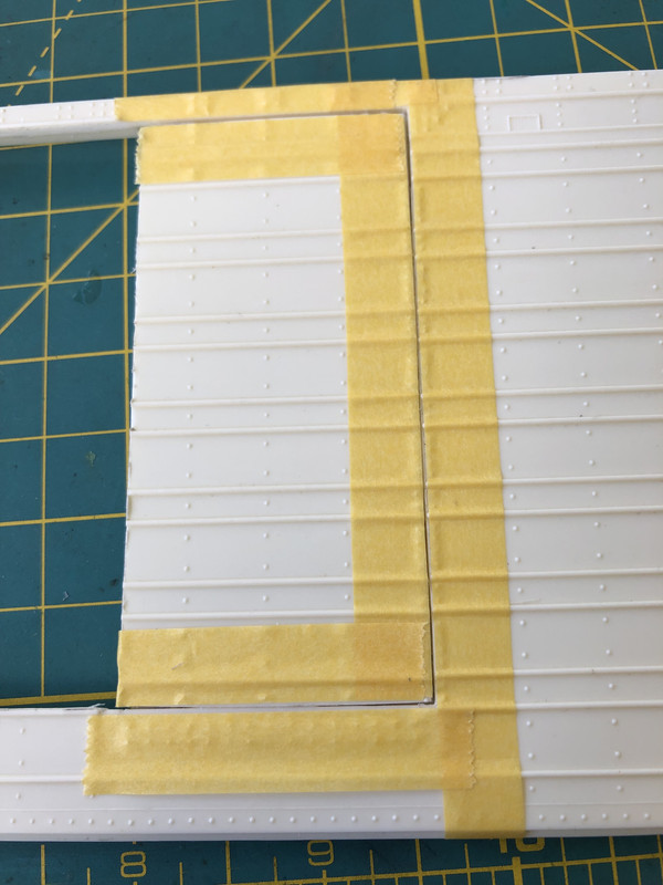

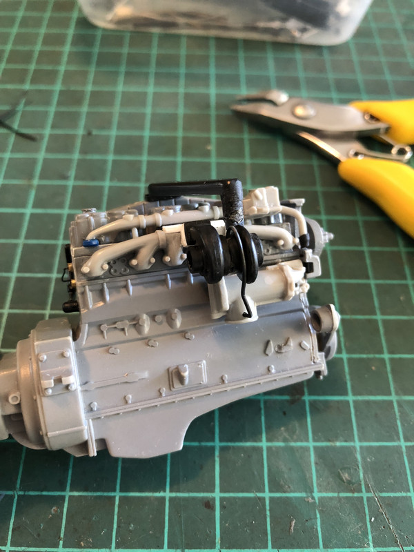

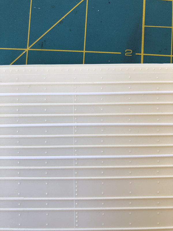

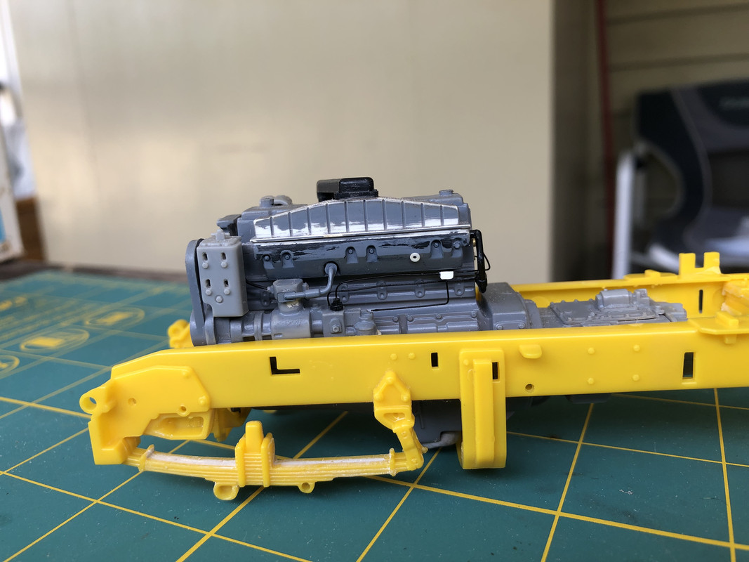

CharlieBravo Posted February 9, 2019 Author Posted February 9, 2019 (edited) ok lets revive this after 7 years! It's always something I've been tinkering with, collecting parts and ideas here and there, gaining more knowledge on the rigs themselves and the hobby itself.. After all this is one of my ultimate builds, as in this is probably the biggest goal i have in my modelling sights - The 'BJ and the Bear' Kenworth Aerodyne in 1/25 Cummins slowly coming along; I scratch built the cylinder head and the plumbing, but i am about to re-do the plumbing with stretched sprue to get cleaner lines I think..? The kit (Revell) comes withe twin turbo so i had to modify down to single turbo, I had engine/turbo parts that someone sent me long ago and not even sure what kit they are off but have used the turbo from that kit. I have also used from that kit the bottom part of the cylinder head also. Great Dane Reefer - needs plenty of mods to get it similar the Bj trailer which is a Brown 40ft Reefer; had to re-position side door; I thought the best way would be to basically cut another door out where the new one needed to be and then slide that part down into the original gap for the door. will need lots of putty and special attention but we got this will be using evergreen strips for the extra ribs needed, all just dryfitted for now; Rear of the trailer needed some serious mods; original; Great Dane trailer modding wasn't too bad as it's just cutting and filing away excess really; cheers for now Edited February 9, 2019 by CharlieBravo

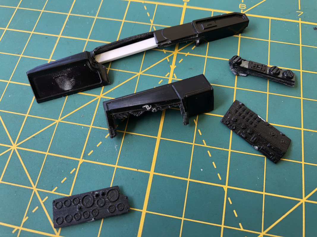

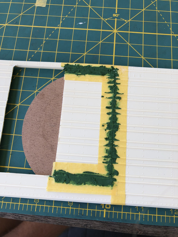

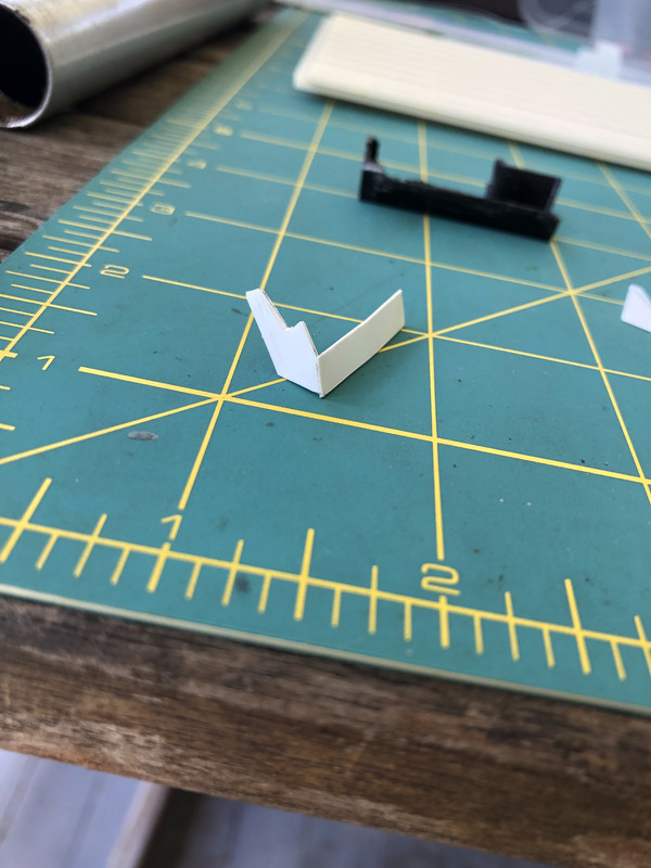

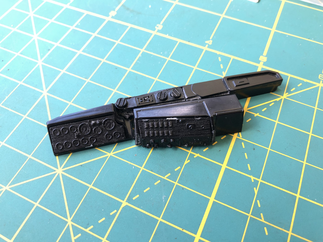

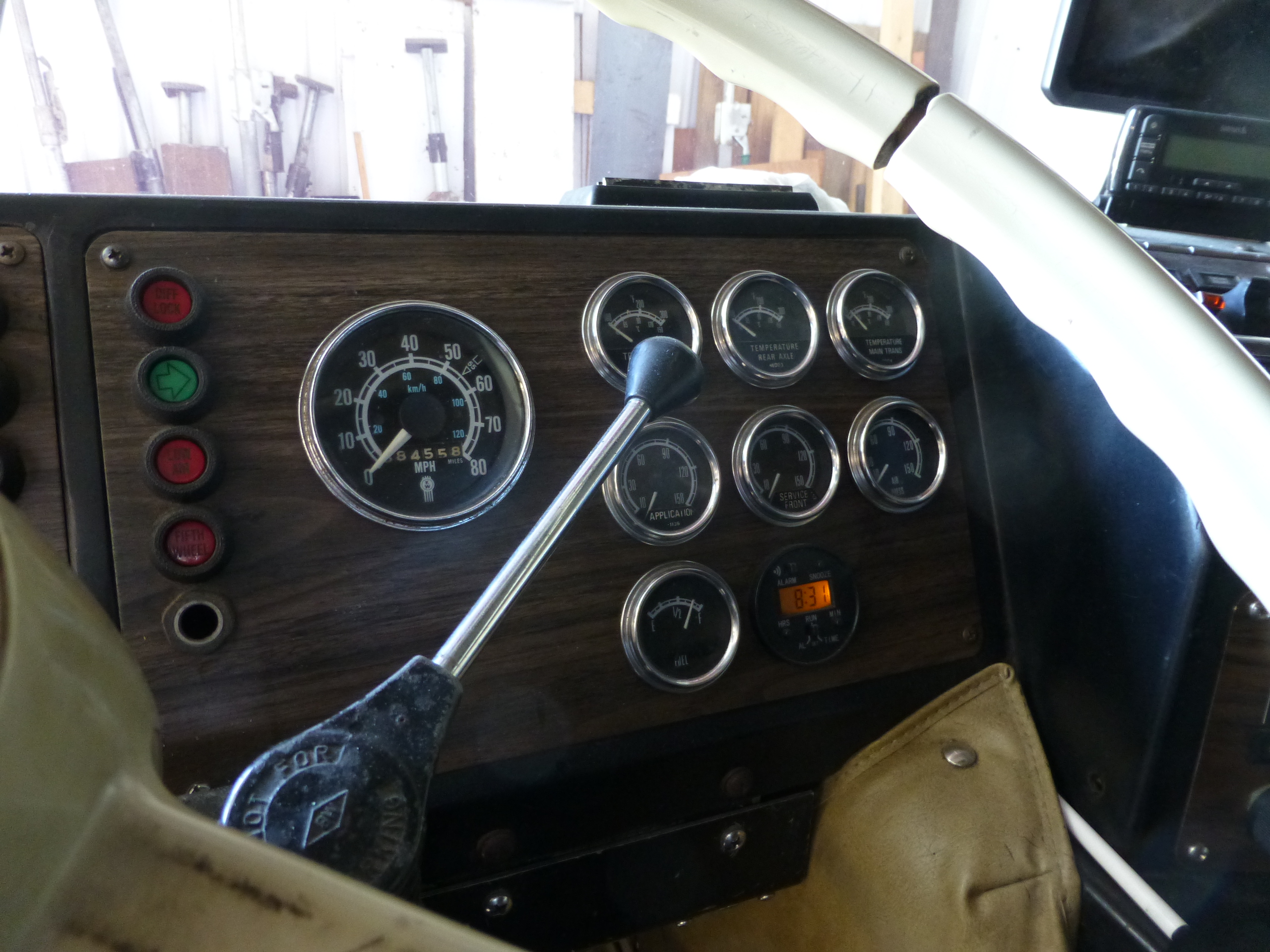

CharlieBravo Posted February 9, 2019 Author Posted February 9, 2019 Putty time. Man I hope this works out...might take some time and patience I think. One thing that is not correct in either the Revell or the AMT kit is the dash. It is not an Aerodyne Dash, I believe what is represented is an older Kenworth flat top dash? kit dash; Aerodyne Dash; So, dauntingly, I have no choice (and because I want to) but to attempt to build a new dash so stay tuned this could go real bad real quick;

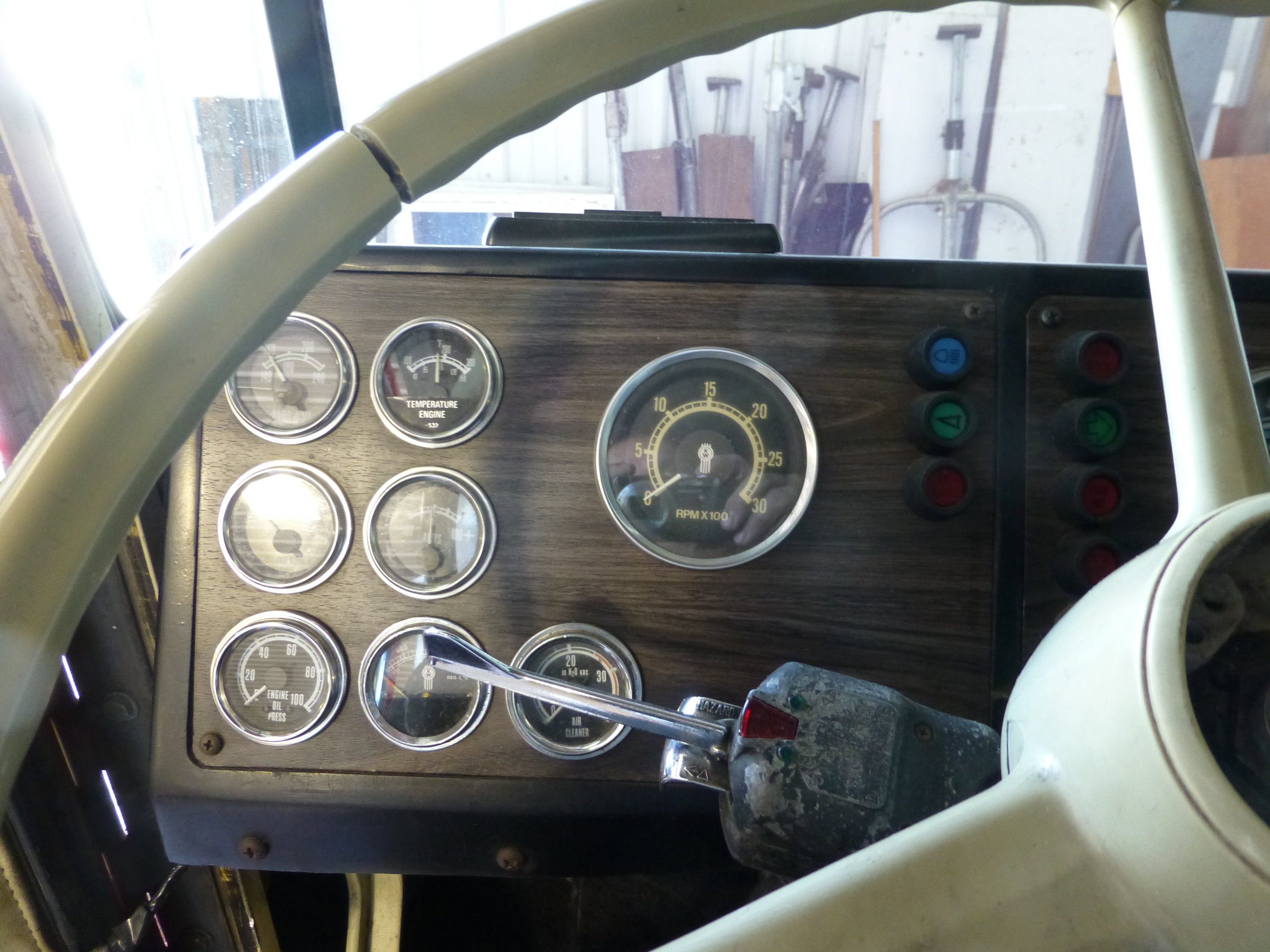

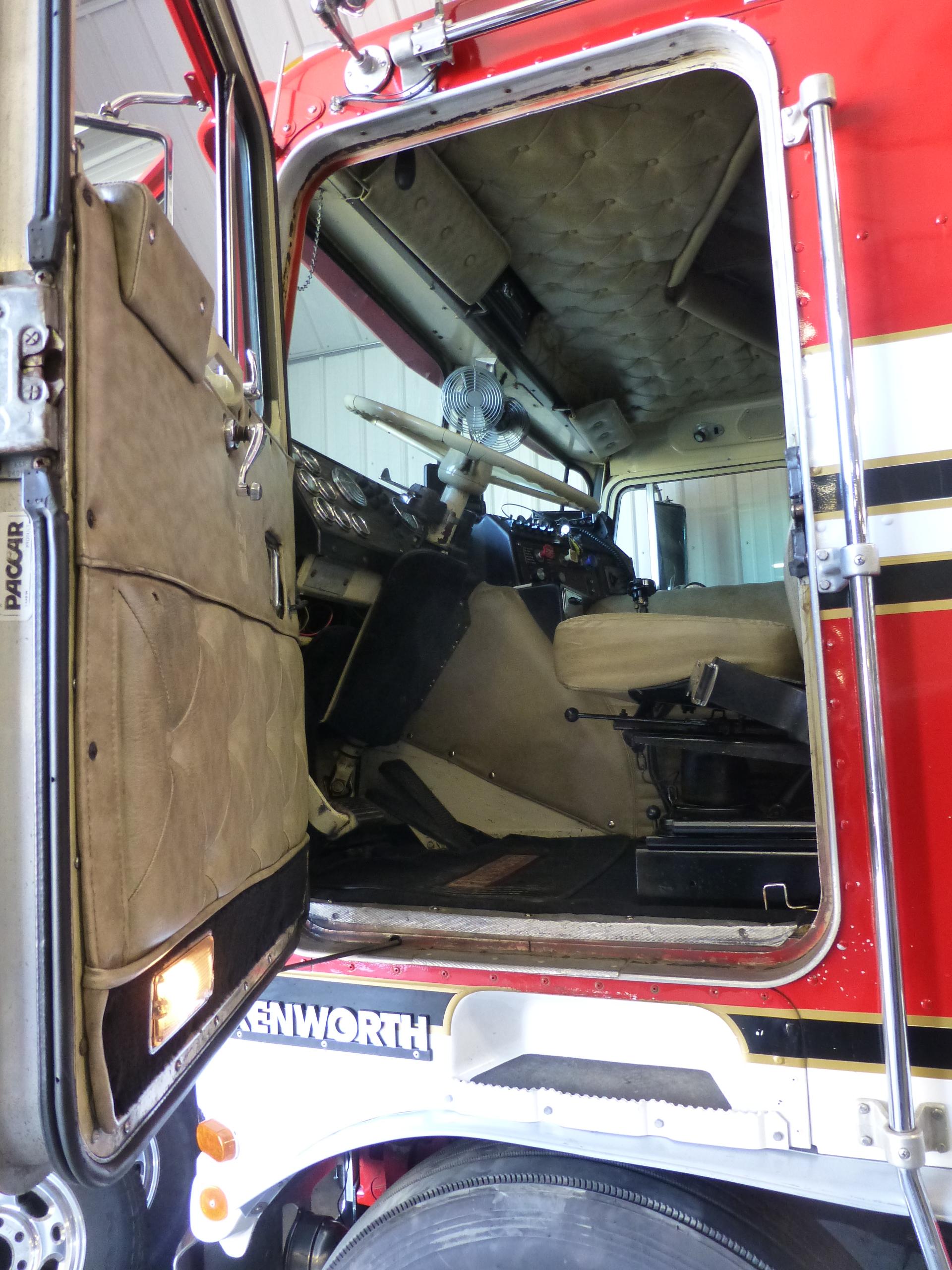

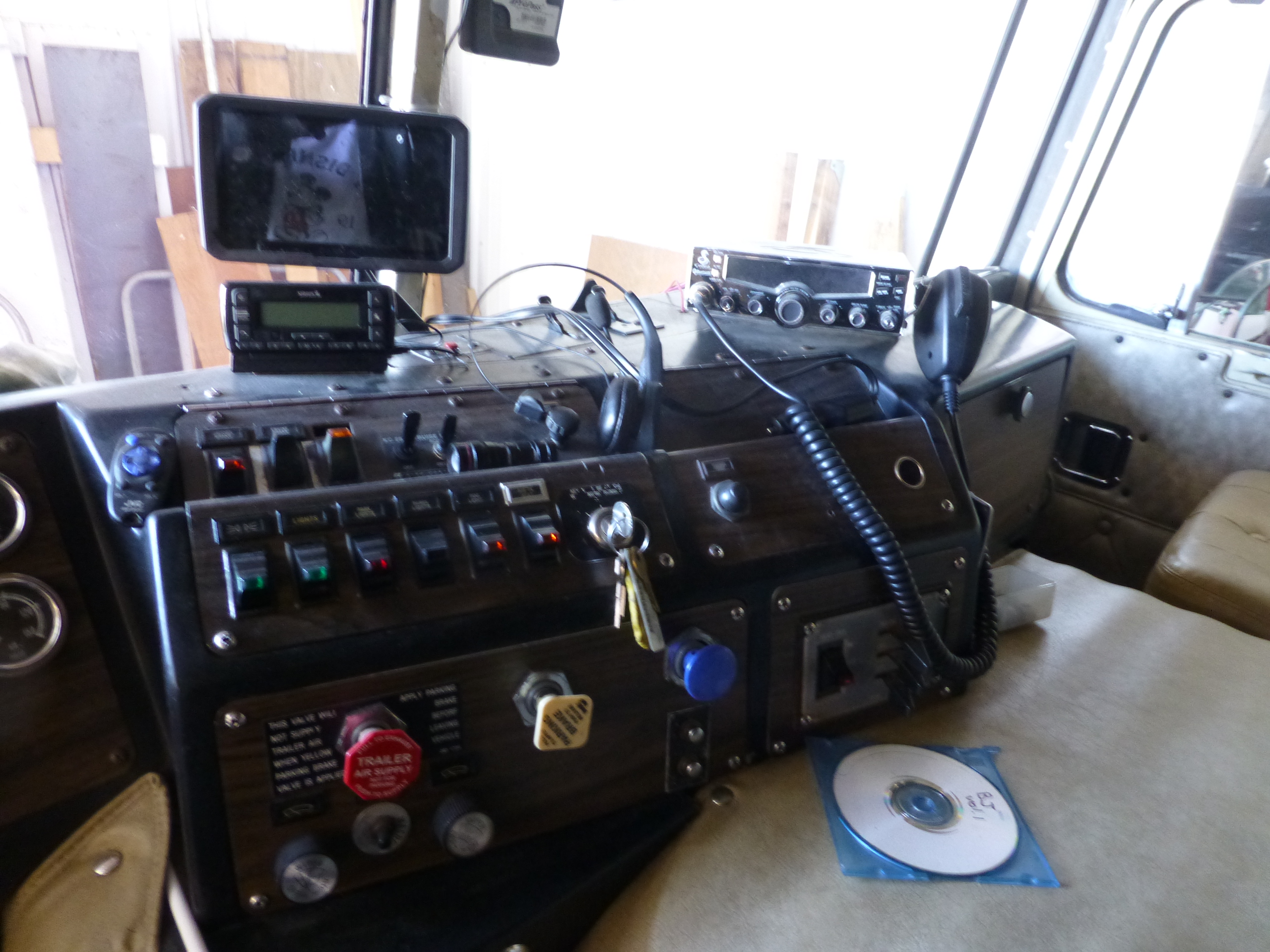

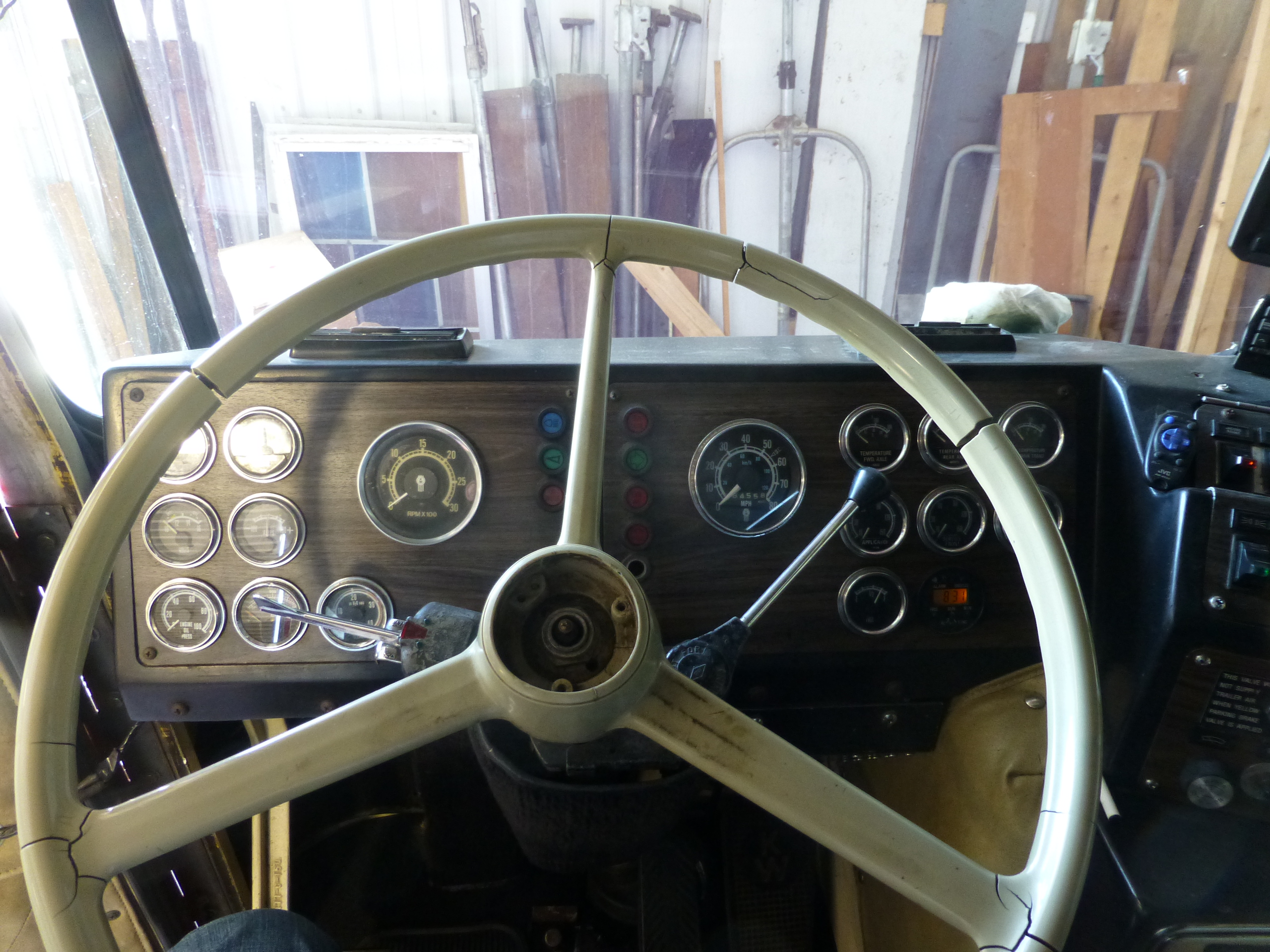

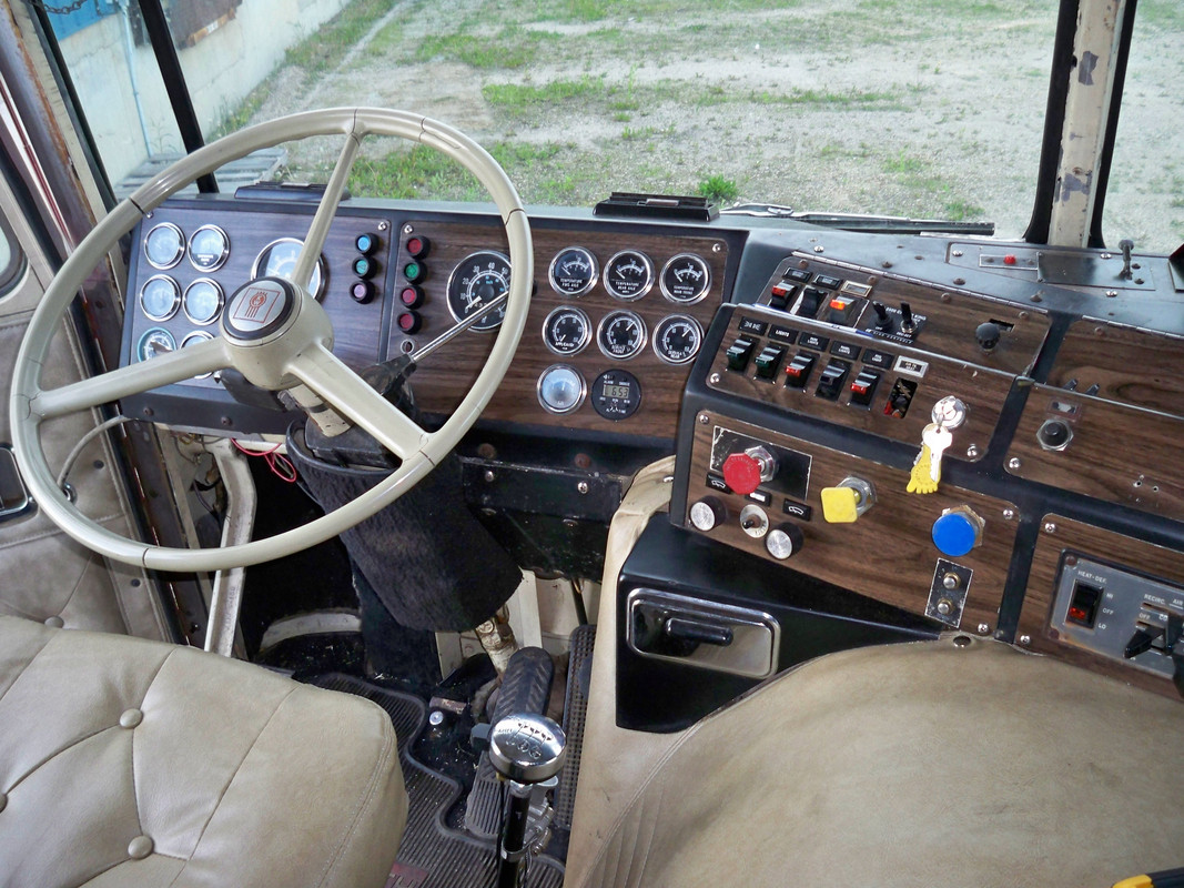

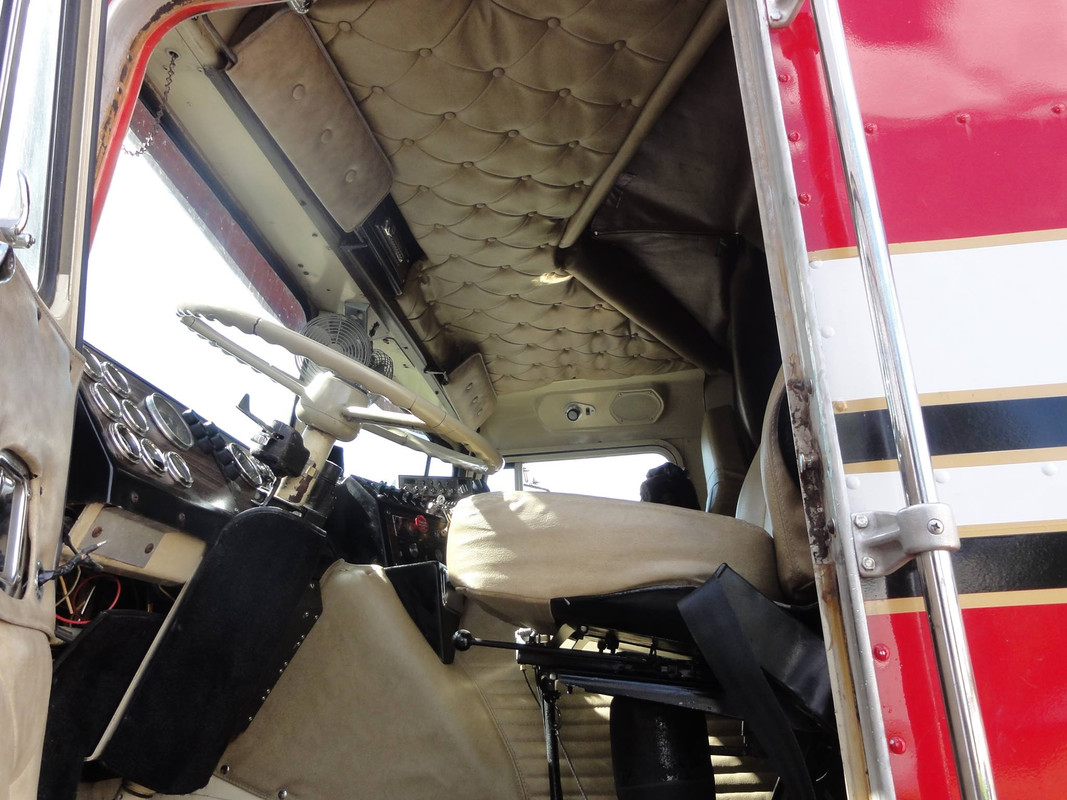

DrKerry Posted February 10, 2019 Posted February 10, 2019 (edited) 16 hours ago, CharlieBravo said: Aerodyne Dash; So, dauntingly, I have no choice (and because I want to) but to attempt to build a new dash so stay tuned this could go real bad real quick; That’s the part that is making me cringe on my build, changing the dash to the correct style!! I will be putting pics of my build up as well when I get started on it. Pics below are from Paul’s rebuild of the number 3 Bear rig.. Edited February 10, 2019 by DrKerry
CharlieBravo Posted February 11, 2019 Author Posted February 11, 2019 10 hours ago, DrKerry said: That’s the part that is making me cringe on my build, changing the dash to the correct style!! I will be putting pics of my build up as well when I get started on it. Pics below are from Paul’s rebuild of the number 3 Bear rig.. Great pics thanks! yes its going to be messy haha,
DrKerry Posted February 11, 2019 Posted February 11, 2019 I have a post in the real trucks section with all the pics of Paul’s truck. It may be messy but will be nice to be more correct to the real deal. I’ll have to watch as you do yours so I know what to do on mine!
Yahshu Posted February 11, 2019 Posted February 11, 2019 Looking good, the race is one to see who'll get their dash done 1st. Whoever wins has to cast it for everyone else.
Force Posted February 11, 2019 Posted February 11, 2019 I'm intrigued that no after market guy has done a correct Aerodyne dash yet, the AMT Kenworth K100 Aerodyne kit came 1979 and the Revell Germany kit 1982-ish, so they have been around 37-40 years...and both the AMT and Revell kits have the wrong dash and all issues have allways had the wrong dash. Of course the Revell Germany kit shared everything with the K100 flat top and the roof is the only thing different, but I think the Aerodyne kit came first, so it should have had the right dash as the Aerodyne got this dash when it first came out in 1976 with the Bicentennial Edition.
CharlieBravo Posted February 11, 2019 Author Posted February 11, 2019 2 hours ago, Force said: I'm intrigued that no after market guy has done a correct Aerodyne dash yet, the AMT Kenworth K100 Aerodyne kit came 1979 and the Revell Germany kit 1982-ish, so they have been around 37-40 years...and both the AMT and Revell kits have the wrong dash and all issues have allways had the wrong dash. Of course the Revell Germany kit shared everything with the K100 flat top and the roof is the only thing different, but I think the Aerodyne kit came first, so it should have had the right dash as the Aerodyne got this dash when it first came out in 1976 with the Bicentennial Edition. I agree, I have reached out to Jan at Czech model and he wasn't aware of the dash issue until I had told him. He has it on his list to do but sadly not a priority right now he told me as he has other projects on the go. So I have no choice. Have you noticed that the old 1/32 Monogram/Revell has the correct Aerodyne dash? I have a couple in my stash.
