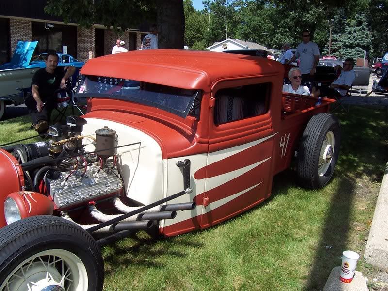

thanks for the kind words guys, MikeMc, at least I know my color choice will look good ;)
