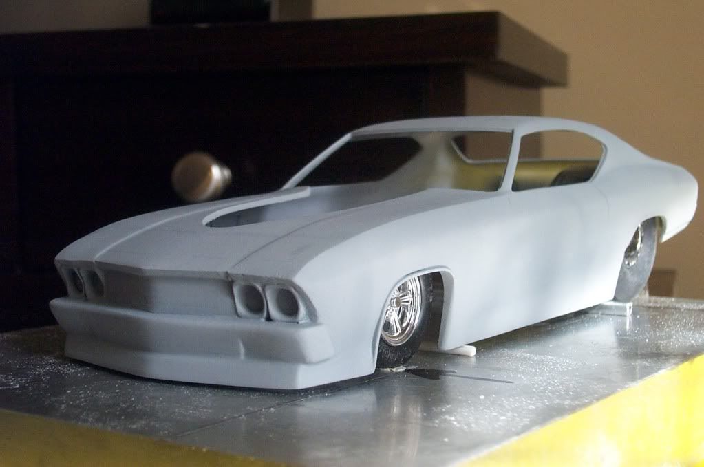

Dragracer Posted April 12, 2011 Posted April 12, 2011 It looks better every time I see it, & that's a really BIG hole in the hood(lol!)

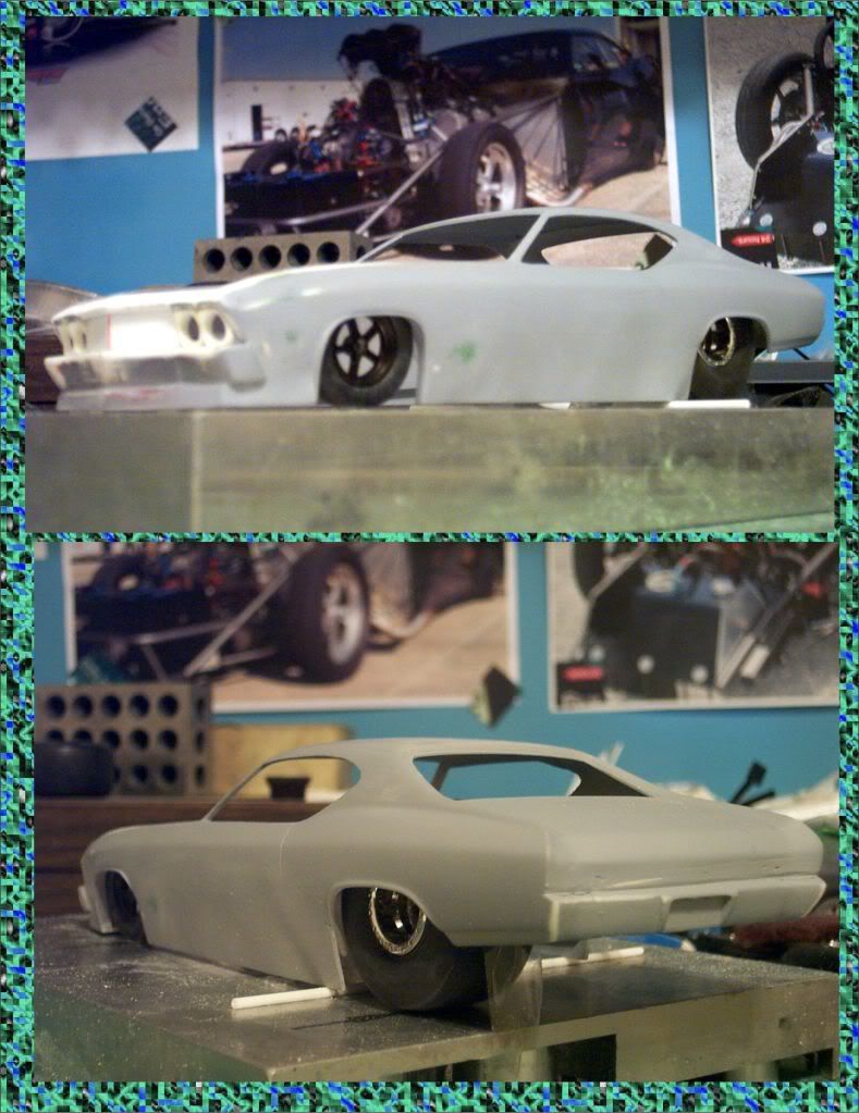

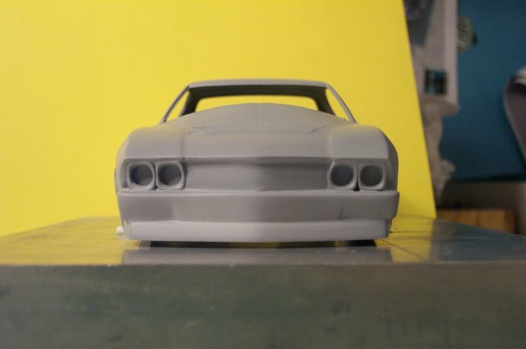

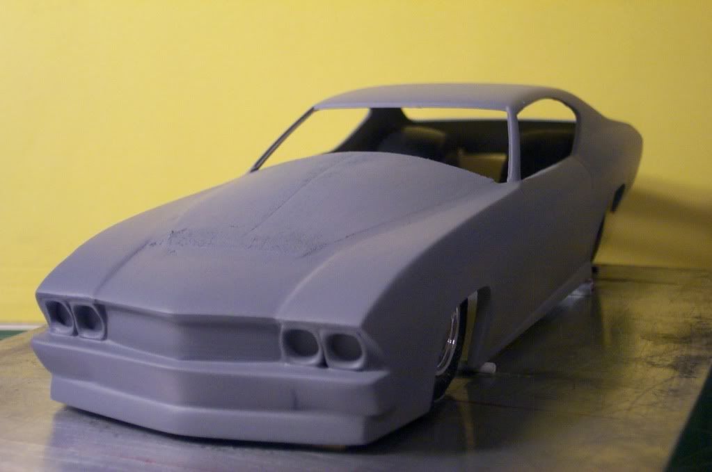

hOLMS Posted April 12, 2011 Author Posted April 12, 2011 Brett, Richard and Michael....For the bezels, I had an extra bumper/headlight section. I cut the h/lights out of the extra one, then ground from the back until they were about 1mm thk. I ground them just enough for the actual h/light to no longer be present and that's when they became 4 seperate bezels. I then marked which came from where (LL,LR,RR,RL) and ground flat spots where they meet individually. I glued them on a flat surface with a gage block across bottom to keep them straight (wish I would have scaled them down a bit, may still do that?). Lastly, I reworked the inside of the body where they fit nice and snug, lowered them to sit on the bumper and basically eyeballed the placement. I did all this because they were not following the lower lines I needed in the front. I could not use what was there because all that had to be ground away first, could not work that area with saw. Yes, that is a big cutout in the hood. A 2500 hp monster needs a nice, big home....right? LOL. No really, that cutout is a little mis-leading. That will actually be a raised taper area 1/16" tall at the highest point (where it will meet the lexan). Thanks for looking guys!
hOLMS Posted April 12, 2011 Author Posted April 12, 2011 I have to agree 100% with Brett, hate you now , also would not mind knowing how you did the headlight area, have 2 pro-mods I'm getting ready to put together, going to work on both back & forth, getting all the engine work done for project#1, then I'll start doing the engine for project#2, #2 is going to need bodywork pretty much like your Chevelle (narrowing the front, rounding down the front fenders & such), so I am planning on using some of your techniques on it, so I will be watching you! Hey Richard, i meant to ask....u gonna post these 2 builds? anxious to see their progress!! Good luck with your P/M bodywork!

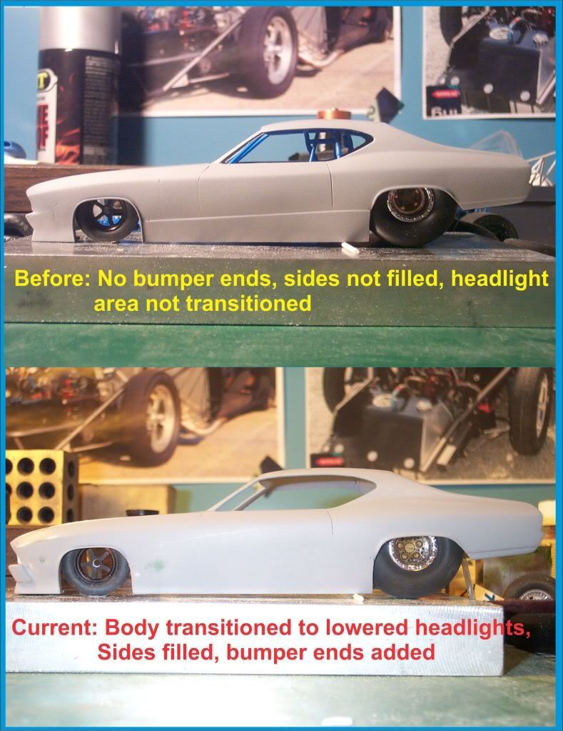

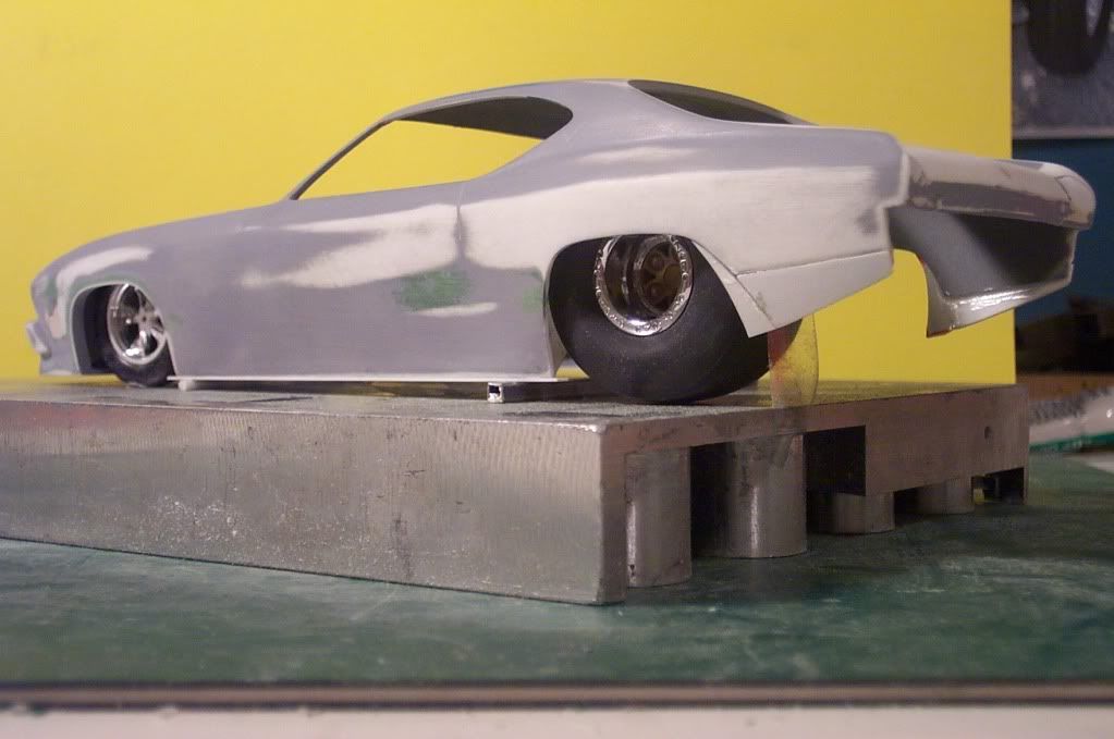

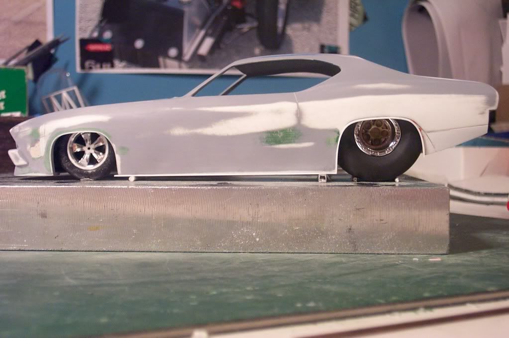

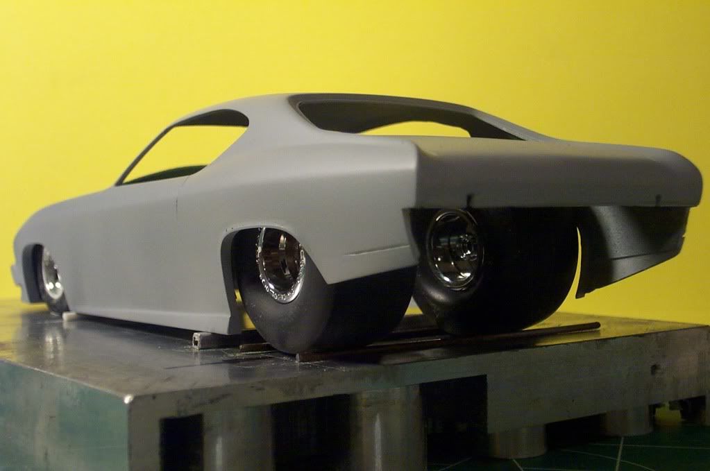

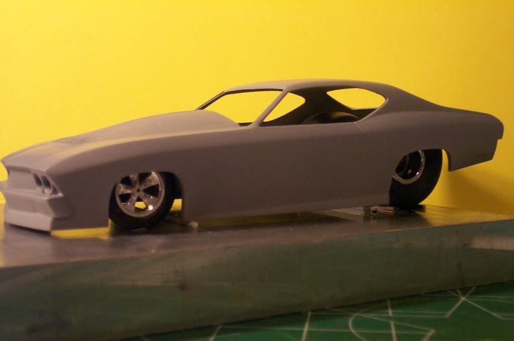

hOLMS Posted April 20, 2011 Author Posted April 20, 2011 Hi all, Been able to do couple more mods, couple new pix. I've got my tapered side skirting in place, filled the rear fender lips and trimmed a bit on the rear fender behind the rear wheel, still have this to do on the other side (any of you ever have a favorite side you prefer on your project? Left side for this one, Maybe it's just me...lol). I've also changed the hood scoop in favor of a rounded, raised bullet style. I still hope to make the rear bumper this week. Sooner than later, I would like to start modifying the firebird pro stock chassis, probably several more weeks though. Thanks for the comments and looking.

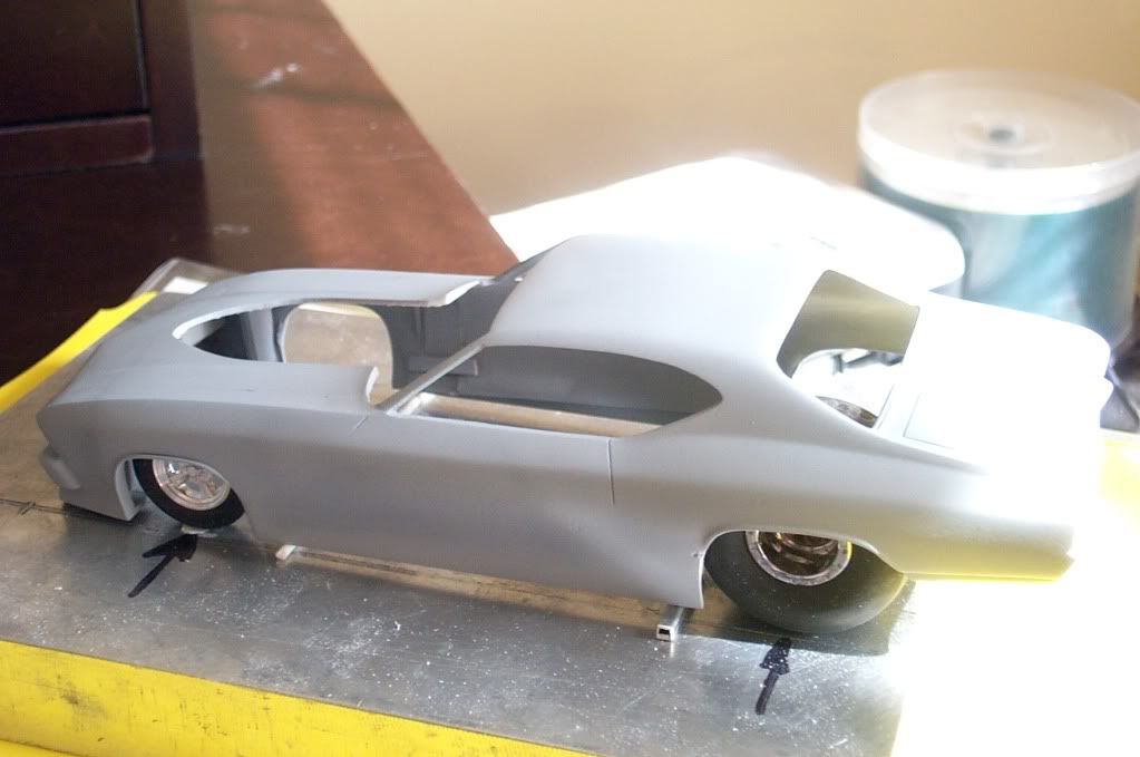

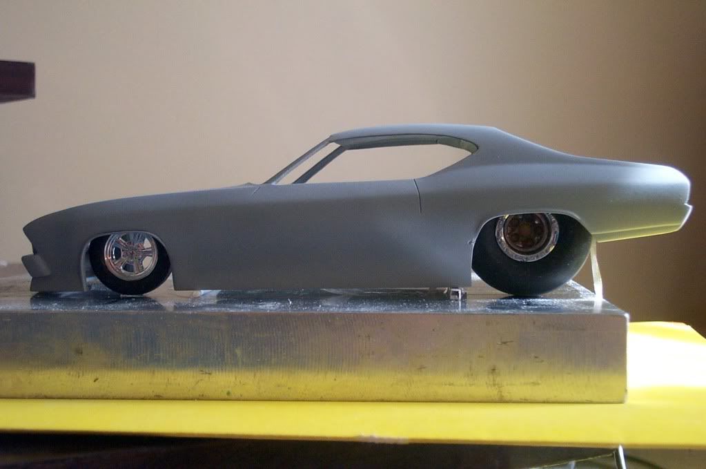

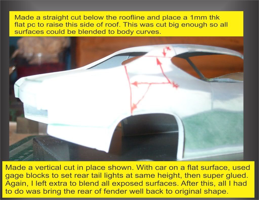

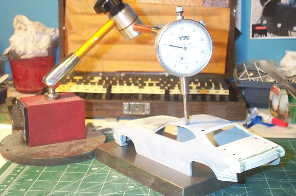

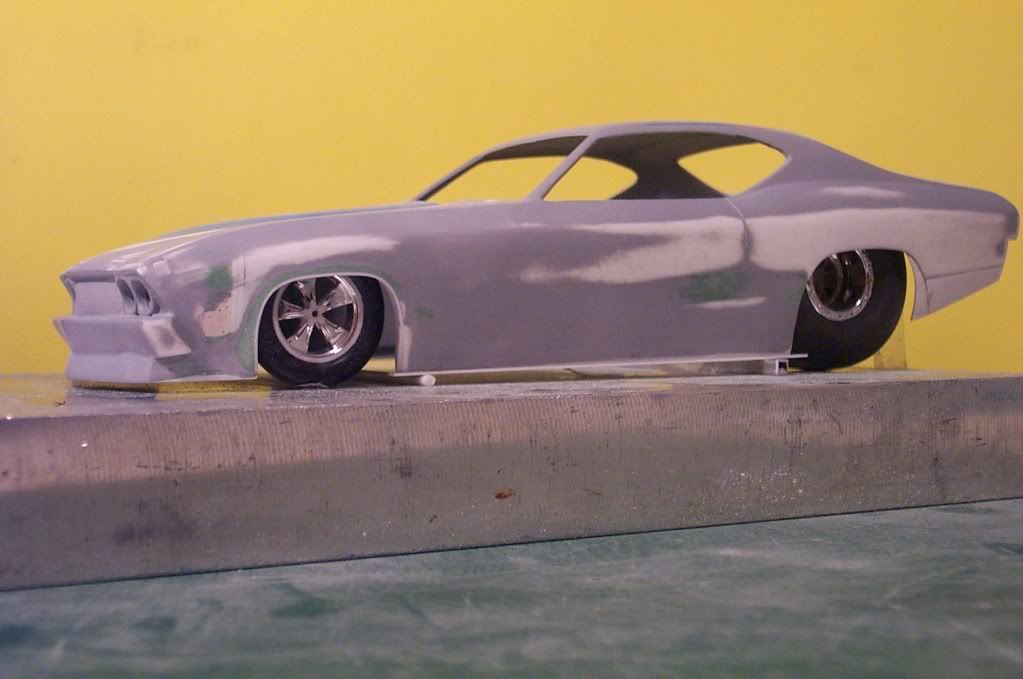

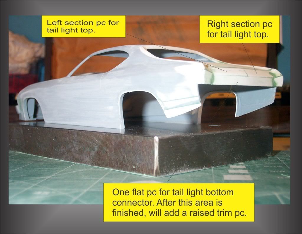

hOLMS Posted April 22, 2011 Author Posted April 22, 2011 Thanks for the comment guys....really can't say enough how much I appreciate you guys looking and the positive reaction from this body experiment!! Well, been a semi-productive week so far, been on the rear of the car quite a bit. I have not met my goal of a bumper yet and there is a major reason why. We've undergone some surgery this week, I'm pleased with the results so I thought I would share with you the problem and my remedies to fix. I sorta knew there was a slight height issue in the rear of the car for some time now. Hoping and wishing it would go away didn't fix it. So, into the surgery room under the scalpel we go. I've included pix with desc's of what I've done. I picked up the problem while measuring corresponding surfaces left to right with a drop gauge, body and gauge on flat surfaces. I marked points on both sides in same locations and started measuring, anything over .010 out was addressed. All was well in the front, but picked up a problem starting on the right rear of the roof which directly showed up also at the height of rear tail lights, only magnified. That section of the roof was low by 1mm and the right rear tail light was low by almost twice. I've never fixed a problem like this, that being said, my method is not concrete...just the way I went about solving. I've spent to much time trying to make this Chevelle great and I feel this was a no-brainer...had to be done and glad I did so. Anywho, maybe you guys have run across a problem like this before and had success with the fix, don't know? Anytime I've ever seen a problem like this, I always throw it into the wall and say, done with that....lol. I'm rambling...one other thing, I had to be careful and try to pick where my cuts needed to be as to not screw something else up that could have been un-fixable. Just try to think about what will need to be done in later steps and determine if that's feasible. Thanks for looking and this time I've learned some things!!
