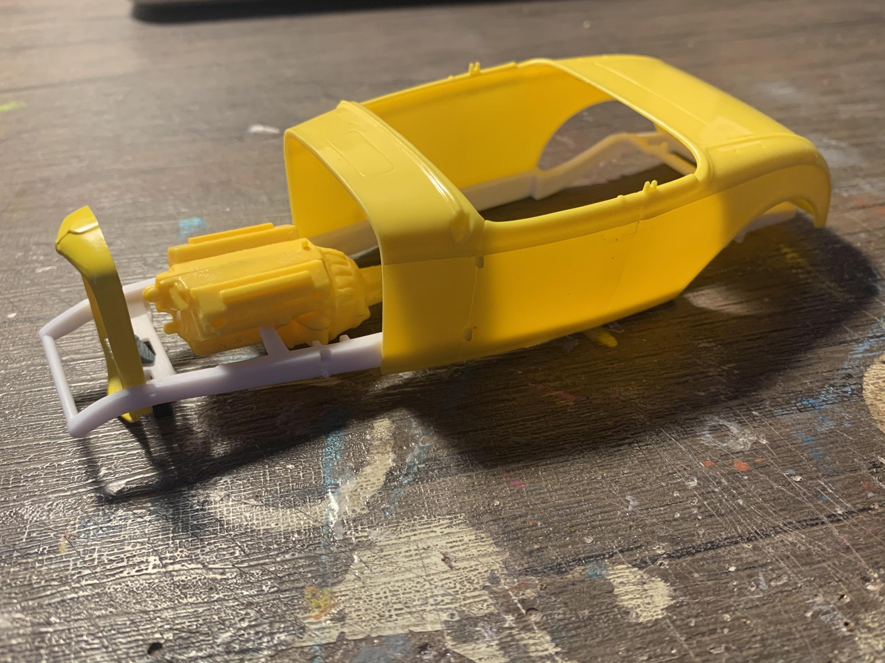

I just got a bunch of these bodies in a job lot of parts - not enough parts to complete the kit...but it sure does fit nice with the new Deuce frame that comes in the 29 Roadster kit:
I know, I know, it SHOULD fit perfect - they’re both 32s...I was just surprised that it did!
Is there any benefit to building a 32 roadster this way?  Probably not - unless you have a few sets of 29 kit parts and a bunch of these bodies like I do right now ?
Actually, it really shouldn't fit the 1/25 Revell frame all that well because it's nominally 1/24.
But numbers are apparently very hard for professionals who get paid to work with them.
The body really is quite nice, and is just a little larger in some dimensions than a correct 1/25 body would be.
The good news is that there actually are some aftermarket full-scale bodies out there that have been supersized to better deal with the expanding dimensions of the typical American, but still fit on a correct frame.
As with everything hot-rod or design related, proportion is important, so just be critical of how everything looks as you mock it up.
