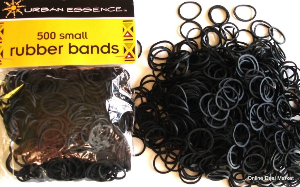

lowriderphil Posted February 25, 2011 Posted February 25, 2011 Not sure if this has been tried before or not but I for one have never liked the look of a kits fan belt molded into the pulleys, and I have never had any luck trying to layer up masking tape. I have not personally tried this yet but it looks like it could work, small rubber bands for doing up hair, 5/8" diameter and can stretch up to 2". If they work just think how many engines could be done on one pack alone.
ra7c7er Posted February 25, 2011 Posted February 25, 2011 They look a little big and thick for direct fitting but cutting and gluing to lenth shouldn't be hard but shaving them down to a more realistic thickness might be a bit tasking. When you get some mocked up post some pictures.
