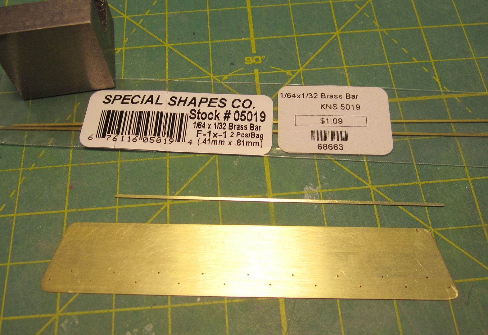

Mooneyzs Posted July 5, 2014 Author Posted July 5, 2014 Hello Fellas and Happy 4th of July to everyone. Hope everyone is having a wonderful and safe day with friends and family. Well I got a little more work done on the spoiler and now its ready for some primer. Here are a few pics to hold you guys over for a day or so...lol Here are the materials I will be using. I picked up some of this small brass stock when I was at my local hobby shop (Hobby Depot in Tempe, AZ). got the stock cut to length and ready to solder: I had set the parts up how I wanted to solder them together and used my different blocks to hold the parts in place. I think I need to invest in some kind of steel plate and magnets to hold things in place now: Here is my equipment that I will be using a Weller adjustable 40 watt soldering Iron and some tix flux: Here is the part after I soldering the lip on it:

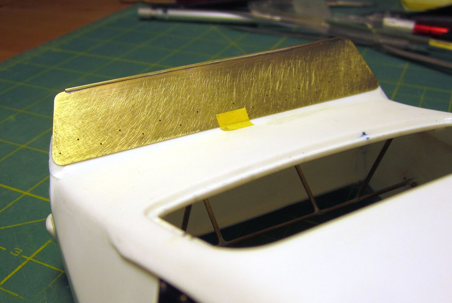

Mooneyzs Posted July 5, 2014 Author Posted July 5, 2014 Side profile, not the greatest pic: Here is a shot of it on the body and next I need to drill the mounting holes into the body by transfer drilling the holes from the spoiler: Another side view with the spoiler on the body:

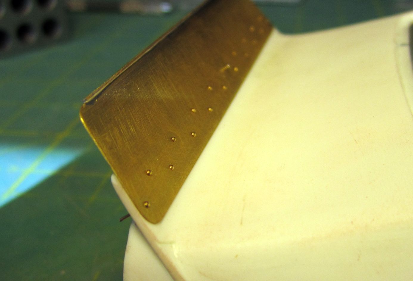

Mooneyzs Posted July 6, 2014 Author Posted July 6, 2014 Hello Fellas..... I got a little bit of bench time in today and finished getting the mounting holes in the body for the spoiler. Here are a few pics of the progress I made.... Thanks for looking. Here is the spoiler held in place with the rivets installed: Here is the backside of the spoiler. I chose to drill completely thru the body to make sure I could press the rivets all the way thru. I will go back and trim the rivets and fill in the holes: Another View:
