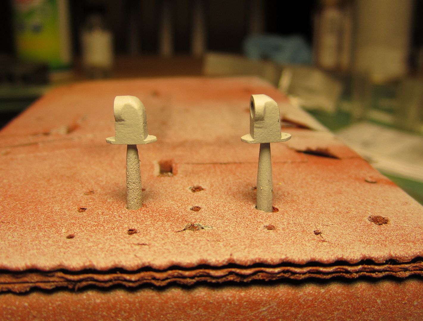

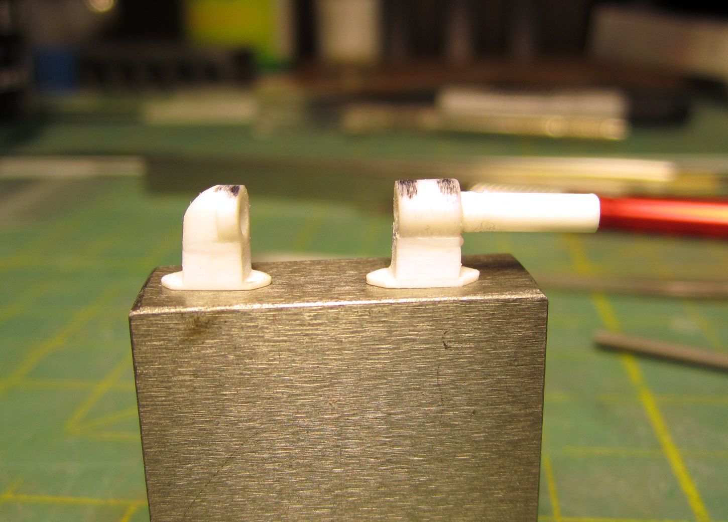

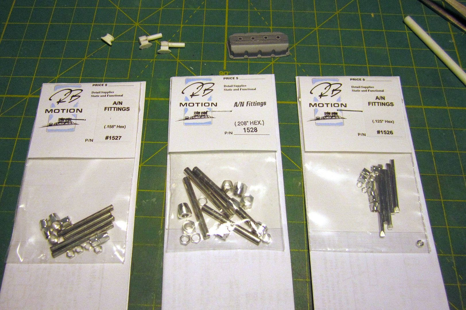

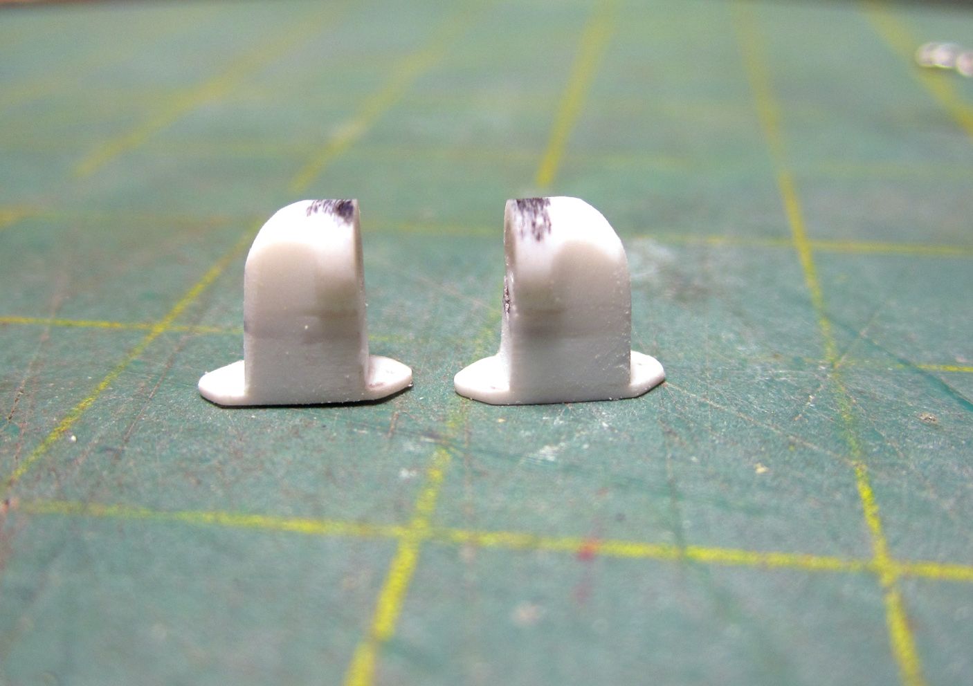

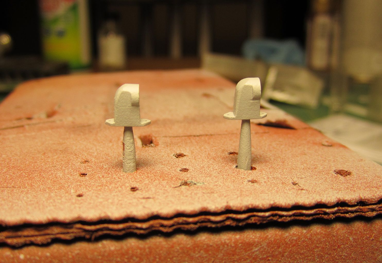

Mooneyzs Posted August 8, 2014 Author Share Posted August 8, 2014 Ok Fellas.... I have gotten a little bench time tonight and I am happy to say that I got a couple goodies from RB Motion so I can continue on with the breathers. I have gotten them shaped and added some primer to them to get an idea of what I need to add some bondo to. Here is the goodies that I ordered from RB Motion. I got 3 different sized because I didn't know which one was going to work for what I needed: Here I started shaping the first breather. So far not to bad: Both of them shaped: Here they are with some primer on them and they are looking pretty rough. They will need some TLC to make them look better: Here is the opposite side: Quote Link to comment Share on other sites More sharing options...

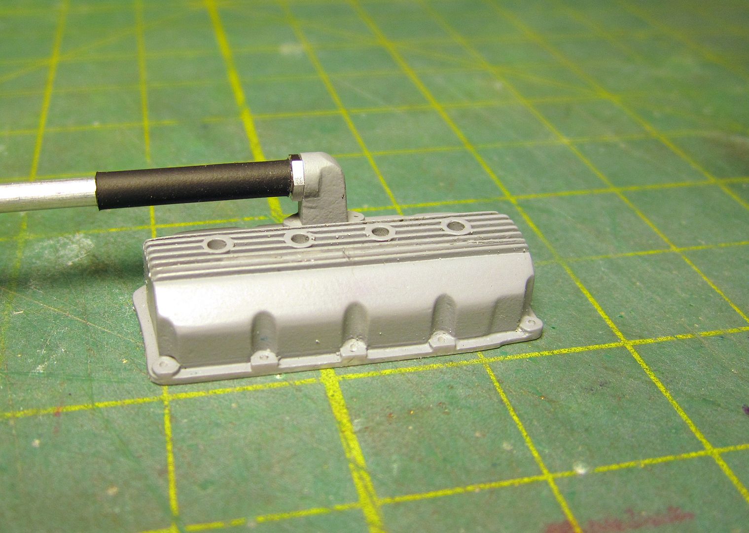

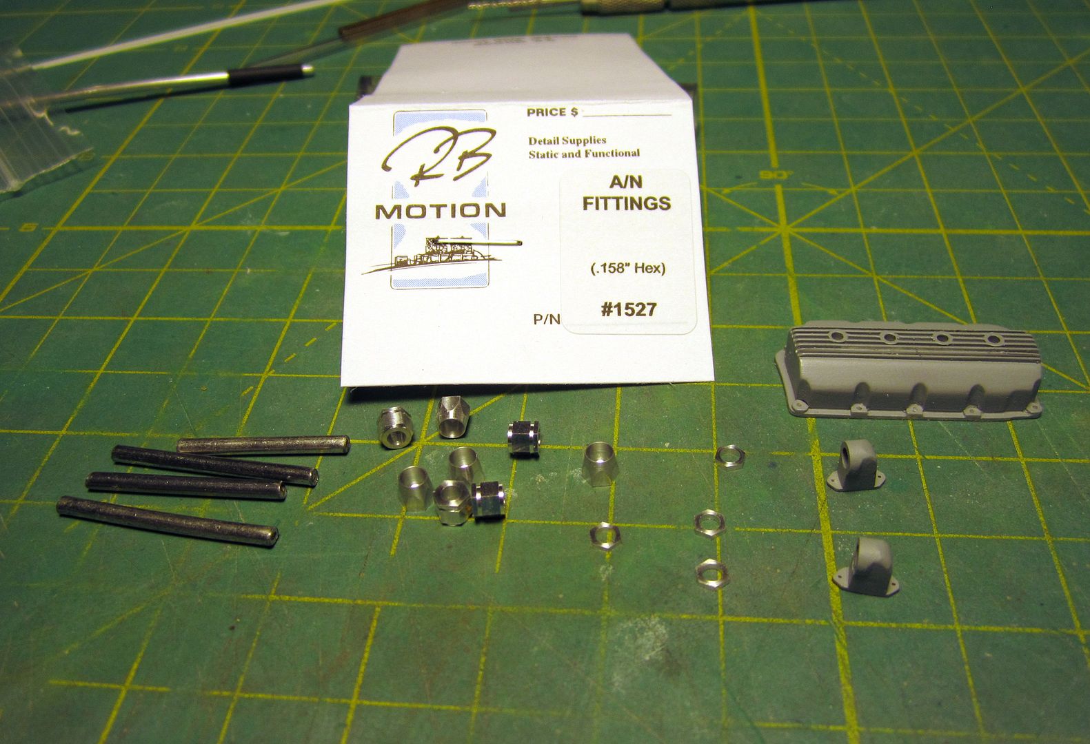

Mooneyzs Posted August 8, 2014 Author Share Posted August 8, 2014 I just wanted to show all of the pieces from the one kit from RB Motion in which I was using just the two small hex nuts for the breathers: As usual I had to mock it up to show you guys what the vision for it is, I think it doesn't look too bad but I think the breather needs some more work. I am still wondering if I should send the parts to shapeways and have them 3D printed because I think they would be a little more uniform. What do you guys think? Here is another shot of the real car so you can compare them: Quote Link to comment Share on other sites More sharing options...
futurattraction Posted August 8, 2014 Share Posted August 8, 2014 (edited) I'm all about uniformity, Chris, so I'd vote for having them 3D printed when you come up with a drawing. Your hand-crafted ones are dead-on, but I just think it's gonna be tough to make them match to your satisfaction - and after this much time and effort... My 2-cents'! Also, I agree with Paul, I believe the body of the breathers is a bit narrow, which accentuates, a little bit too much, the area where the fitting/hose attach to it. Edited August 8, 2014 by futurattraction Quote Link to comment Share on other sites More sharing options...
Magic Photos Posted August 8, 2014 Share Posted August 8, 2014 I think it look right, great work Chris. Quote Link to comment Share on other sites More sharing options...
DynoMight Posted August 8, 2014 Share Posted August 8, 2014 I think its not wide enough Chris which is what may be making it look funny. I agree, they do look a little skinny on the bottom... Great work, I vote for them to be 3D printed, they'll be exactly the same, although yours look exact anyways haha Quote Link to comment Share on other sites More sharing options...
Mooneyzs Posted August 8, 2014 Author Share Posted August 8, 2014 (edited) After looking back at the pic, you guys are right that it is not wide enough. You wouldnt happen to have dimensions for one of these would you? I still keep thinking that it may be best if I just have some of these 3D printed because I know they will turn out much better than what I make from scrarch building them. At least they will be symetric that way...lol Would anyone else happen to have dimensions for one of these oil breathers or the posibility to measure one for me by chance, since I dont have access to one. Thanks everyone for your inputs. I think I want to get them drawn at the correct size and have them printed they will look much better that way and I know I would be much happier with them in the long run. Although i am proud of the scrarch built ones but I can tell that both are not the same at all. It sometimes hard tonmake parts that small be exact to one another. Edited August 8, 2014 by Mooneyzs Quote Link to comment Share on other sites More sharing options...

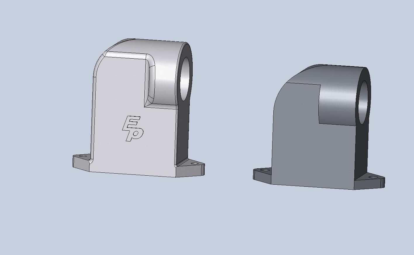

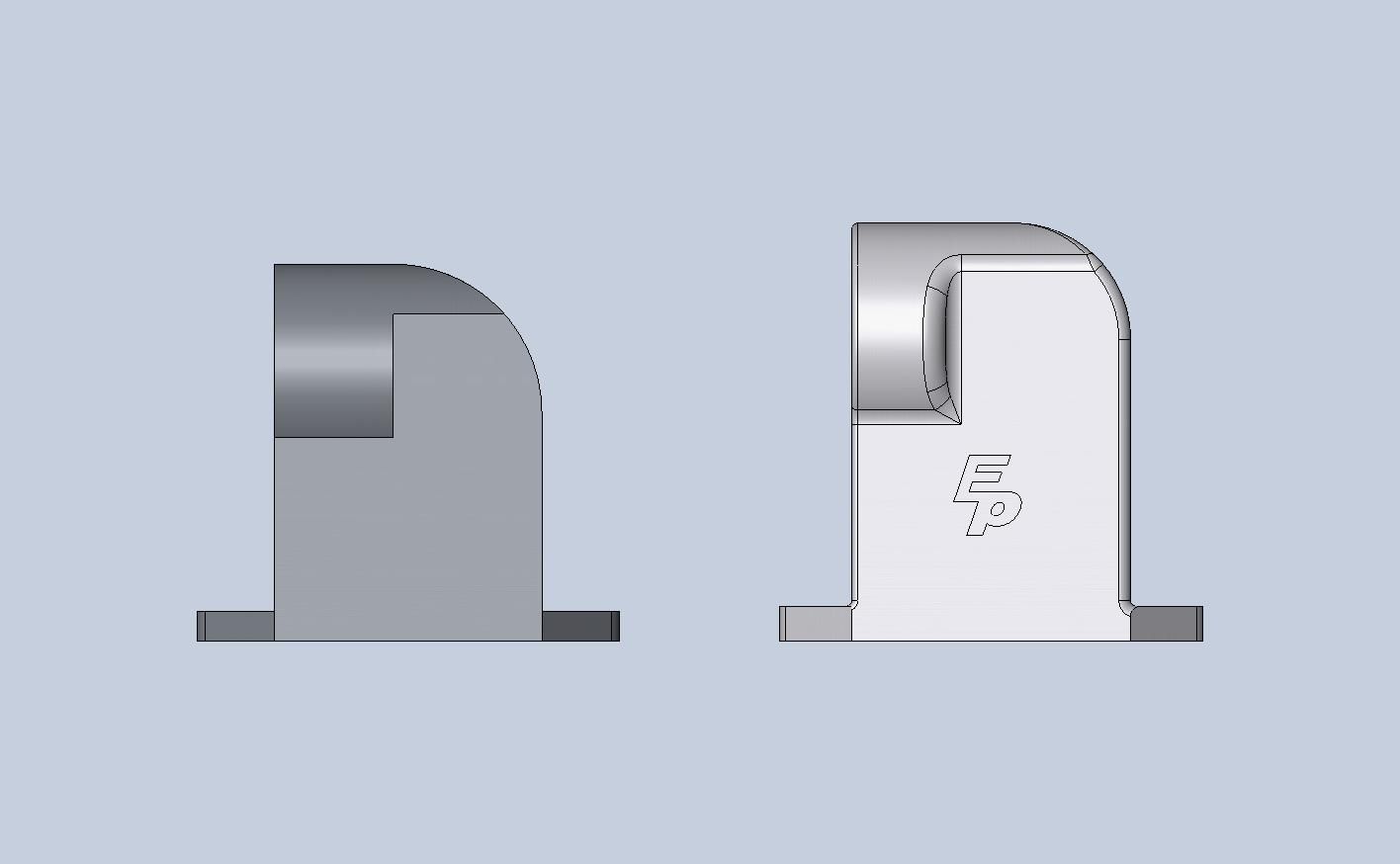

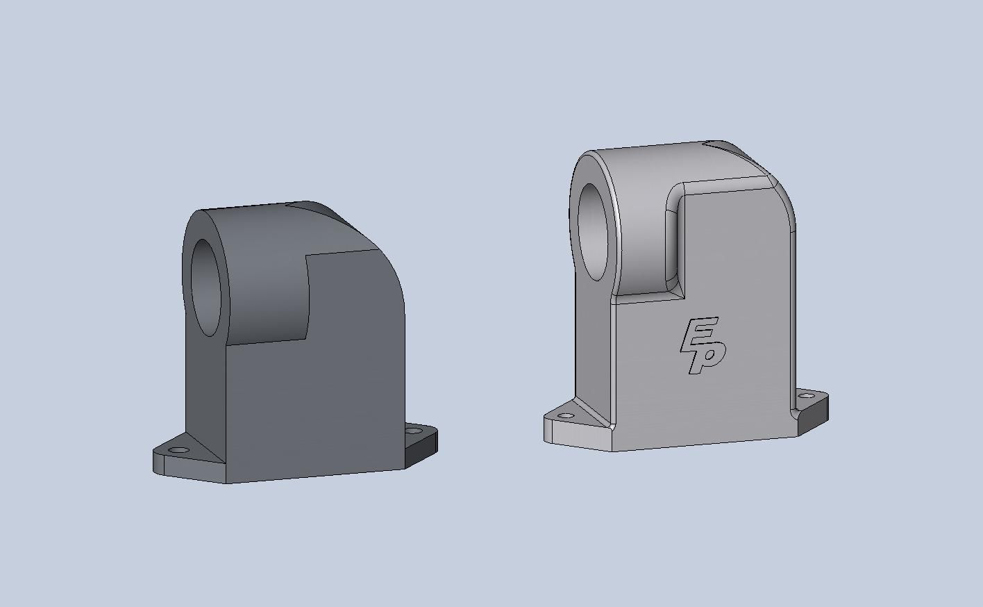

Mooneyzs Posted August 10, 2014 Author Share Posted August 10, 2014 (edited) Hey Cube.... thank you. I was able to find 1 image of the Burn Down Breather I was looking for. Ok Fellas.... So tonight I have sat at my computer for a few hours searching and redrawing the Burn down breathers and think I have got a much better model for the part that I will have 3D printed. So far by the looks of it I am much happier. I followed the trail that Scott gave me with the link he posted and based the size off the one he posted as well as another one I found on the page. I was also able to findGaskets that it had on their site which gave a few more dimensions for me to use. Here is what they look like as I saved them as Images from Solidworks.... Here is the new breather. the original one I drew up is on the left and the new one is on the right: Here is a side view of them: Another one: Here is comparing the 3d Model to the actual car again: Here is the only image I was able to find of an Ed Pink burn down breather I know its not a big pic but only thing I was able to go by, if you take a look at this pic right above this one and you will have to zoom in but I was able to see some sort of letters on the breather which lead me to believing it was an Ed Pink breather: Now I can't wait to get these printed and see how they turn out. I will start back on cleaning up the valve covers and blower tomorrow now that I have the breather thing all finished up. Edited August 10, 2014 by Mooneyzs Quote Link to comment Share on other sites More sharing options...
gasser59 Posted August 10, 2014 Share Posted August 10, 2014 Those SolidWorks pieces look spot on Chris. Nice job. You're right, those definately look like Ed Pink breathers. You have hit another home run brother. Quote Link to comment Share on other sites More sharing options...

Mooneyzs Posted August 10, 2014 Author Share Posted August 10, 2014 Brad... Thank you. I have to tell you it has been hard finding any info on it...lol just glad I was able to see that little detail in the pics I have. I really wished that the pics were a bigger and better quality pic thats for sure. I can't wait to get a few of these printed and as soon as I get them back I will be hitting them with a light coat of primer and showing you guys here. Jason... Thank you. Yea I do have to say that it is pretty cool with the 3D Technology. I would love to get a 3D desktop printer but I am hoping for the price to drop some more plus I would rather pick up my Sherline Lathe and End Mill that I have been eyeing for quite some time before a 3D printer. Quote Link to comment Share on other sites More sharing options...

futurattraction Posted August 10, 2014 Share Posted August 10, 2014 It's great you at least found a pic of them, even if it isn't very large or of high quality. Your SolidWorks drawings look super...! Quote Link to comment Share on other sites More sharing options...
Mooneyzs Posted August 10, 2014 Author Share Posted August 10, 2014 Scott... You are right I was just glad I was able to find this one pic because it helped for sure. Thank on the Soldworks 3D model. I love drawing things up with this program. Whe you make a change to the 3d model all of the 2D views update on the drawing. Quote Link to comment Share on other sites More sharing options...
