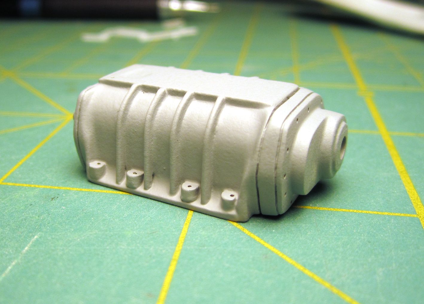

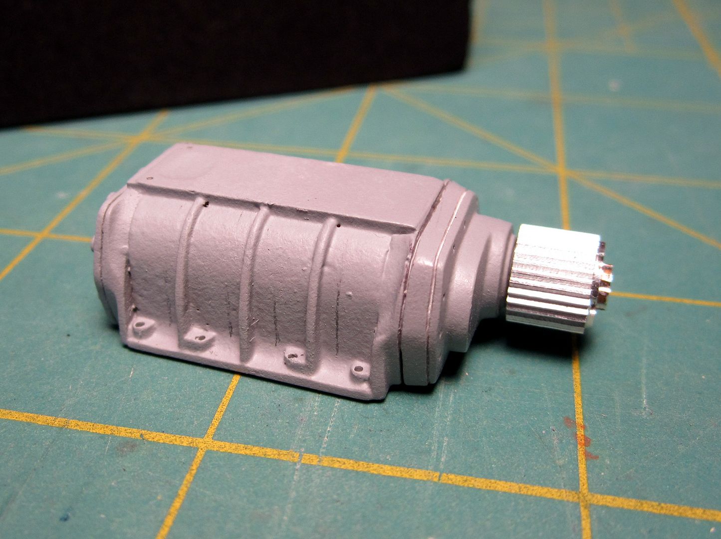

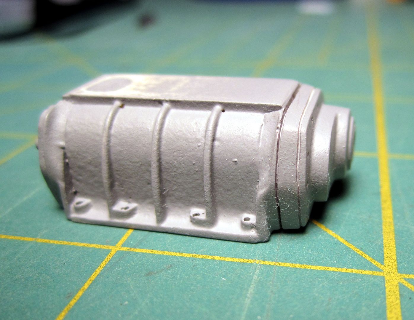

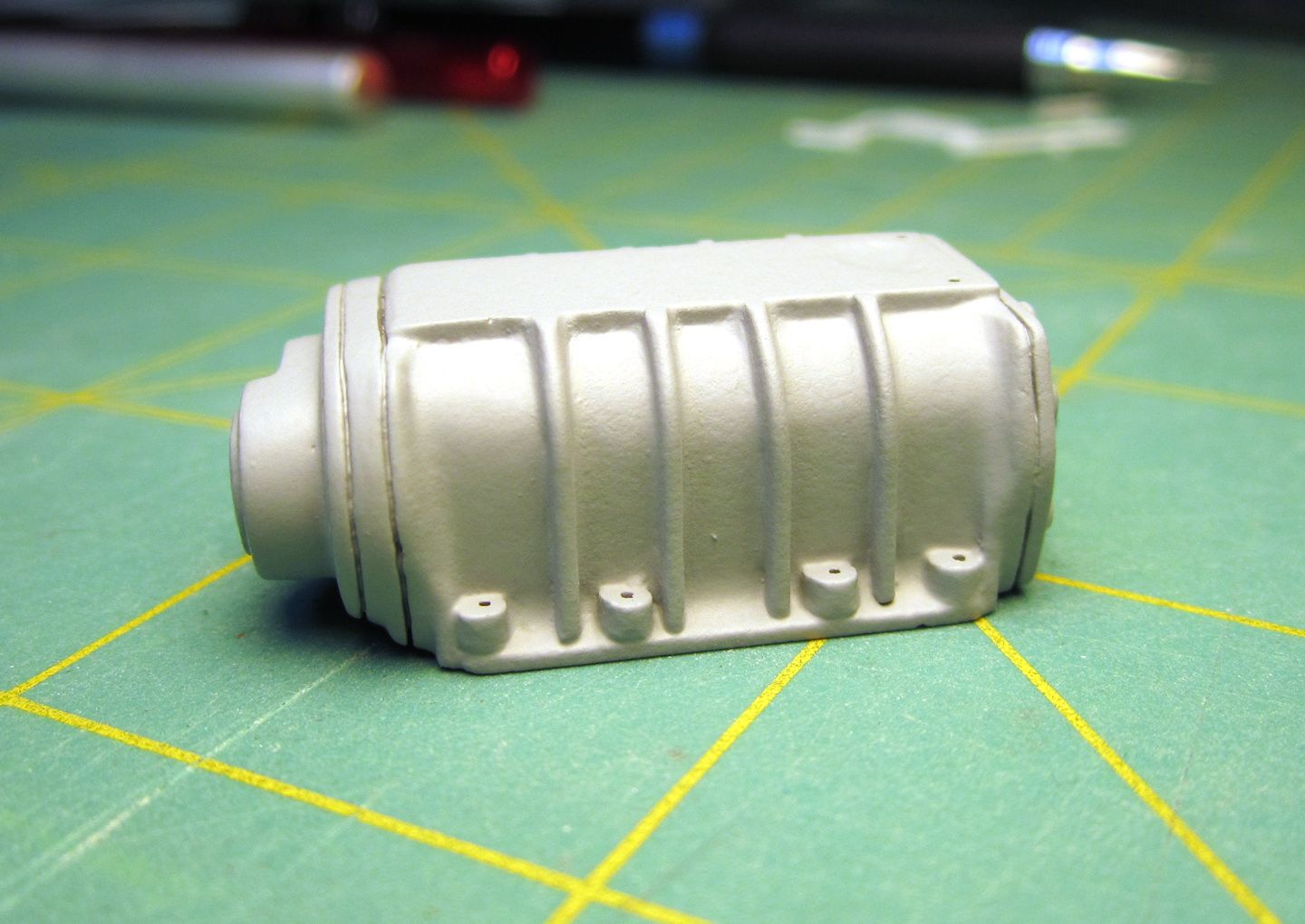

Ok Fellas... I have done a little work tonight and got all of the panel lines scribbed for the front and rear plates. So glad to have it done. I know its not perfect but hope it looks good once its final primered state and with paint. Here are a few shots:
Here is the front panel of the blower scribbed:
Here is a top view:
Here is the Rear panel:

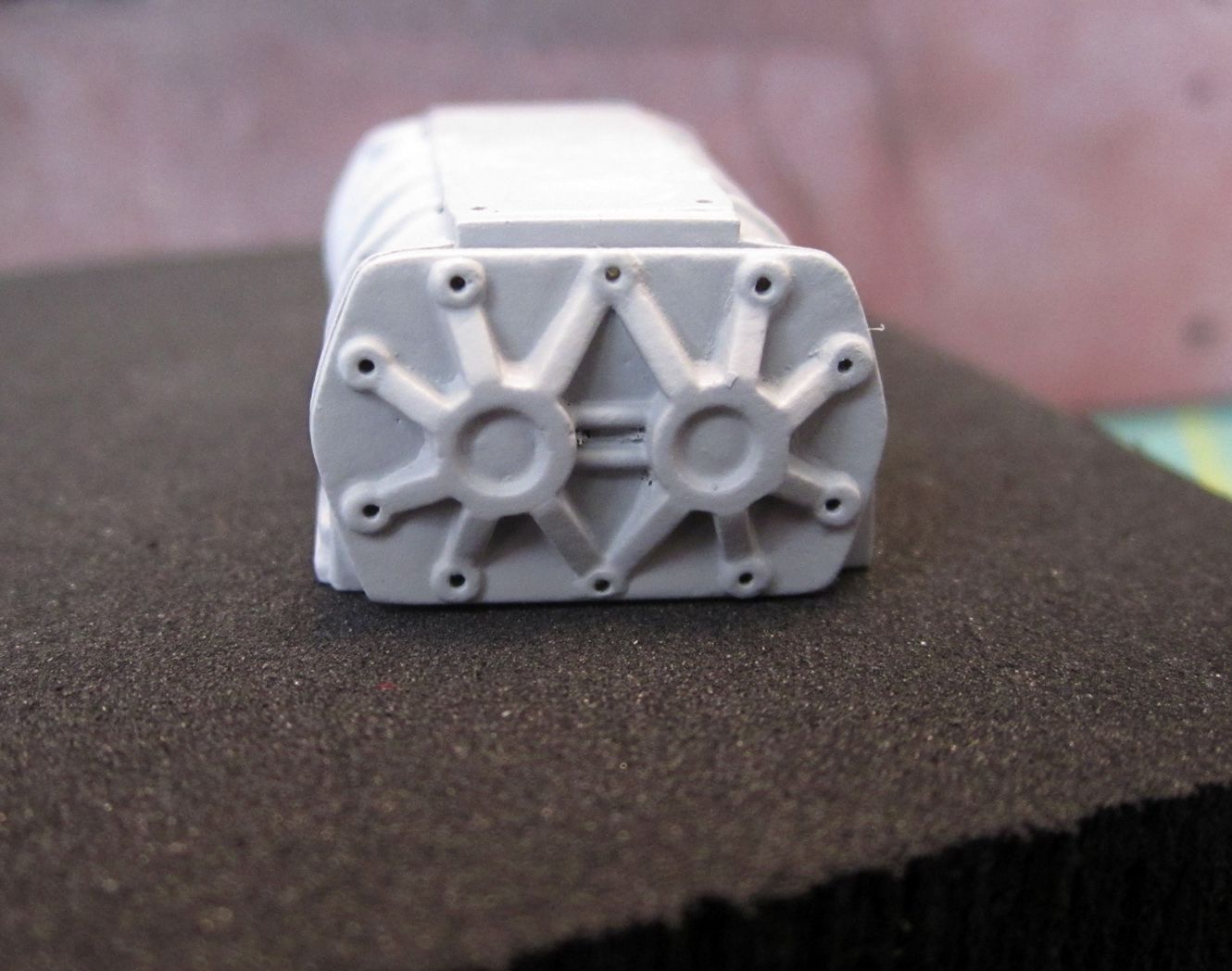

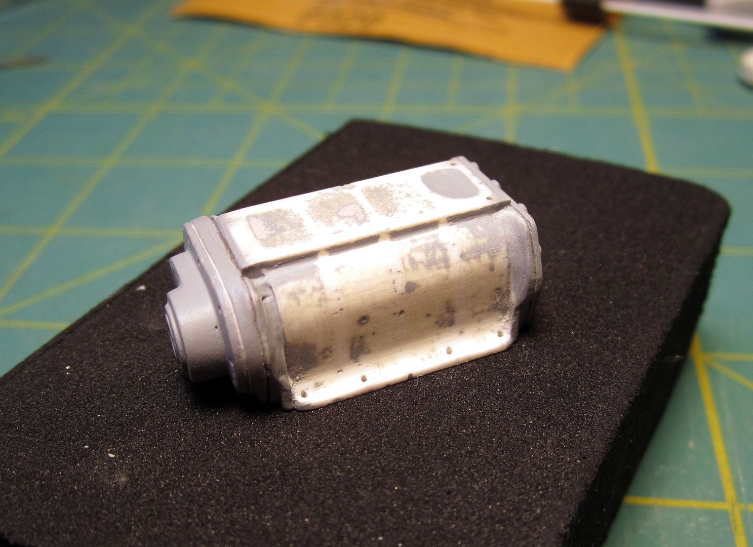

Good Morning and happy Saturday Fellas.... I am sure you have been waiting for some updates. I have had a little trick up my sleeve where I wanted to finish up a little something before posting any progress pics of it. Well I have some what got it done. Not sure if I am 100% happy with it at the moment because I still need to do some final body work but I will let you in on the little secret I have been doing. This is all work that is for the blower. I know that I am still trying to figure a way to add the M to the blower since this is a Mooneyham blower set up on this car and well while looking at the blower I noticed that the ribs on the side didn't match the the 1:1 so knowing me well I had to take a stab at making them correct. Right now I will warn you they are in a very rough state. I finished what you see here and I shot a light coat of primer on it to see what and how much body work I need to do to it now and well...... lets just say its a lot of body work.... and I mean a lot..... :lol:. I will be working on this today so I should easily have an update later today. But I will be honest I am toying with the idea of Modeling this up in SolidWorks and possibly having it printed thru shapeways. I may just do both and see which looks best in the end. Anyway I will stop rambling on and show you some progress pics.

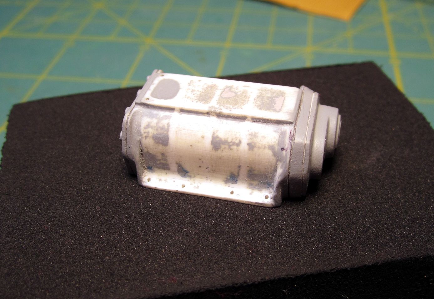

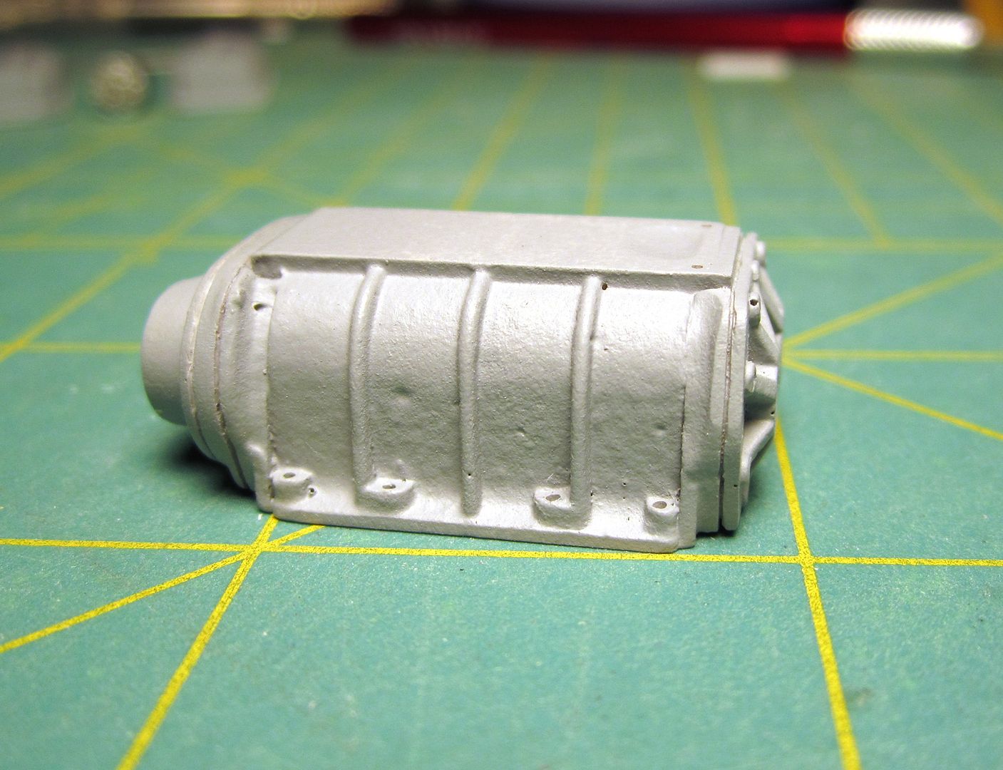

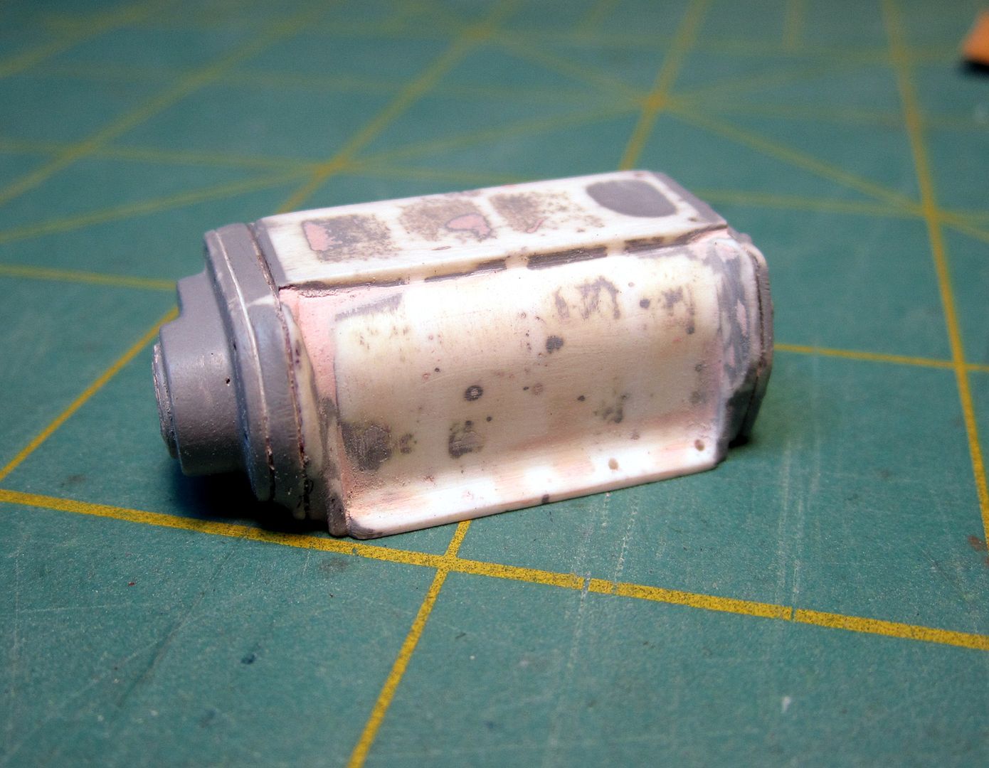

Well I started off by filling the pin holes on the back plate and I see that I have a few areas that still need some touch up. I need not make a new bridge piece between the two bearing bores to look like the 1:1...:
Here is a Before shot:

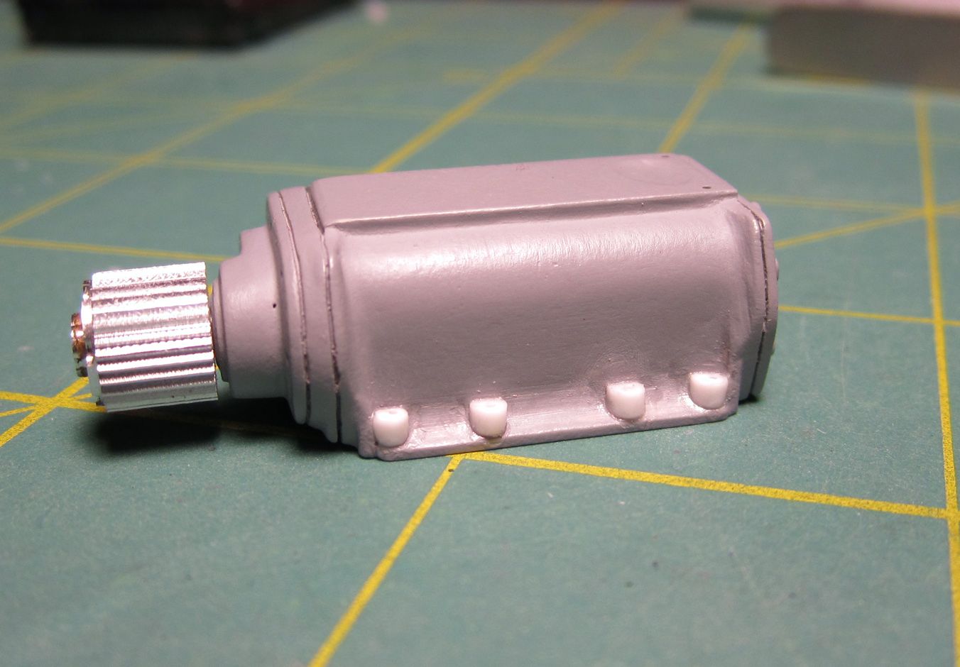

Here I made the first cuts and no turning back now....:
Here is both sides after removing the ribs and mounting boss's:
Link to comment

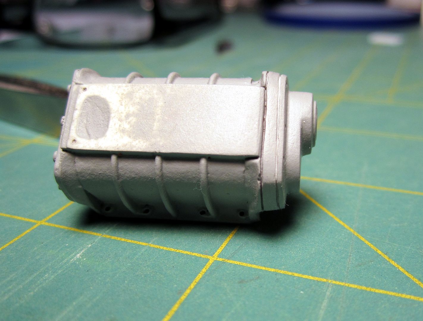

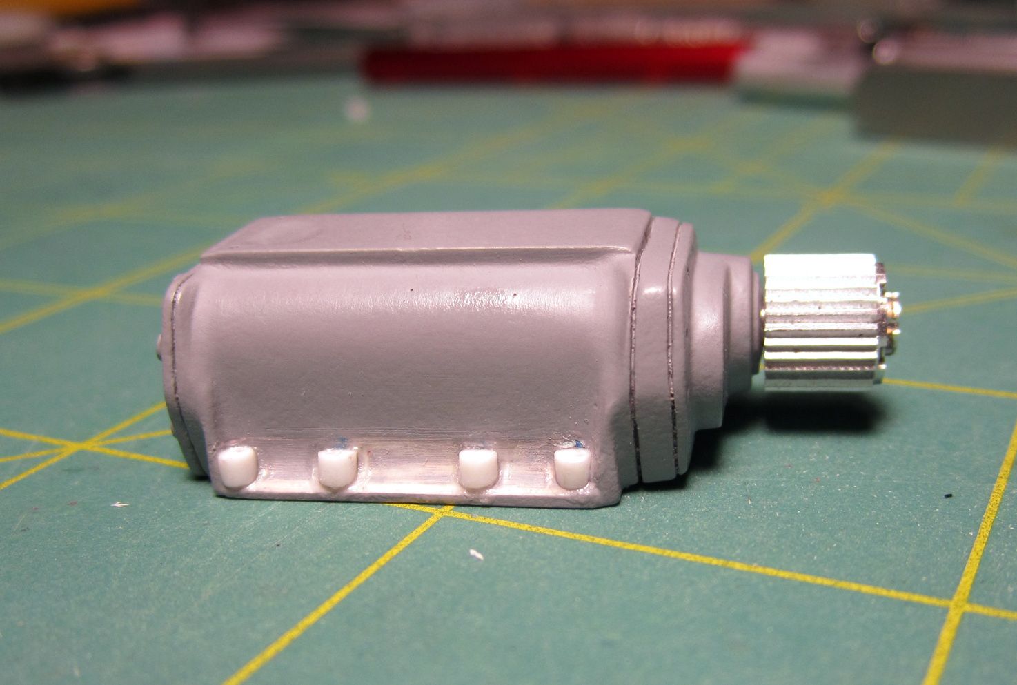

Here is the other side:

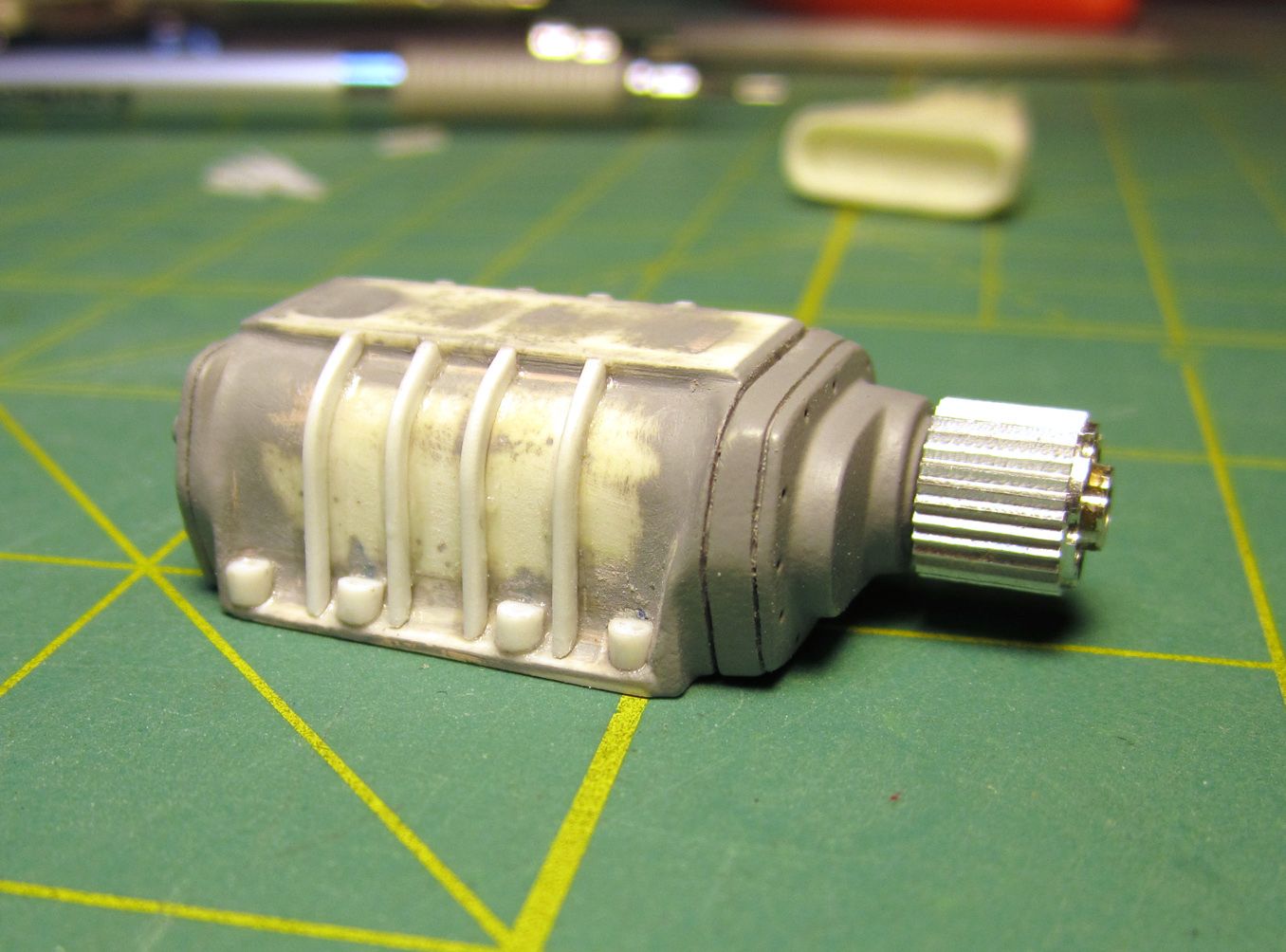

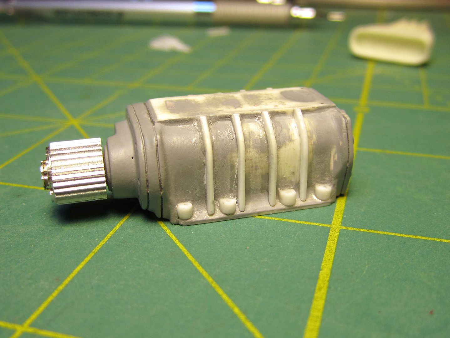

Here I have added some Evergreen styrene strips to the side for the ribs. I started out with some .030 x .040 strips. I rounded the outer edge so it didn't have hard corners. I swear I worked on this for probably arond 4 hours last night getting these all made and glued on with super glue which in the shots you will see with the primer that I am not so happy about:

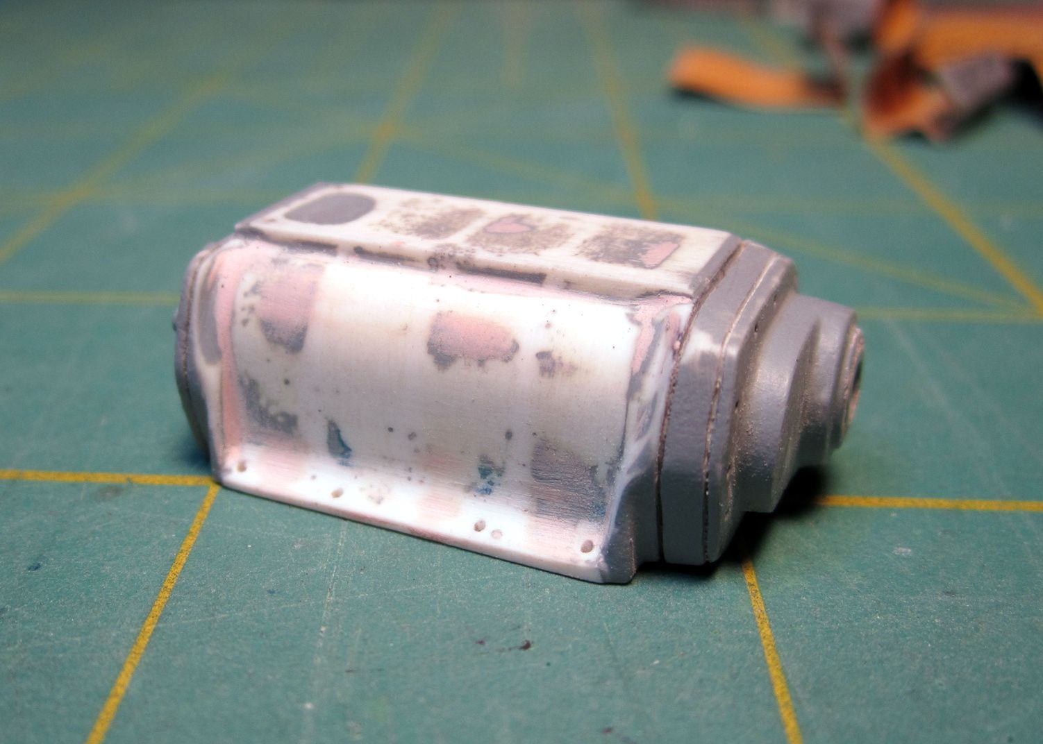

Here it is with a few light coats of primer and as you can see It needs a lot of TLC to make it look really good. As I mentioned right now I am not 100% liking this and I think I made it look like Junk. Hopefully with some sanding, bondo and elbow grease I will be happy with it:

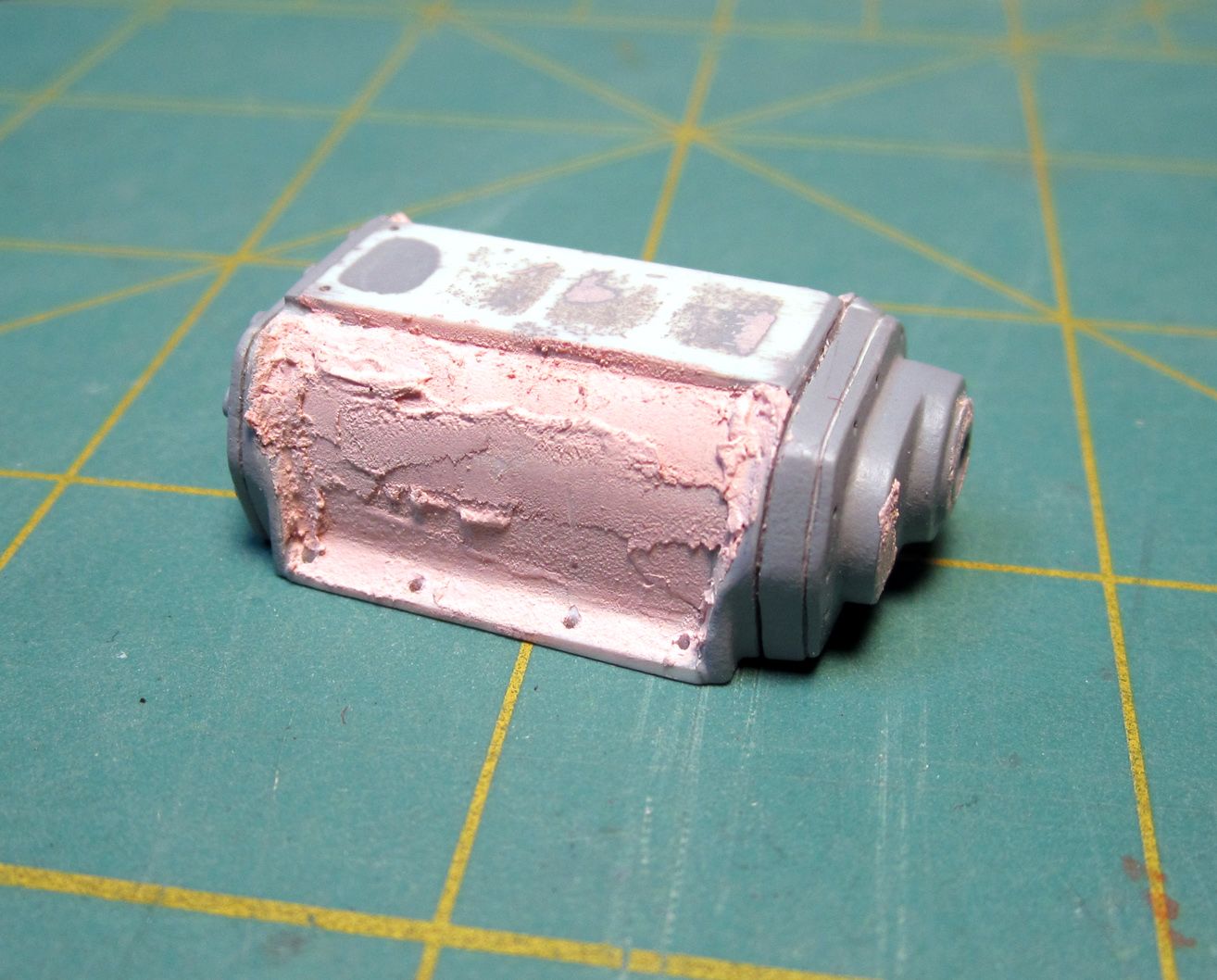

This side looks even worse:
I will now be back at the bench doing the body work on this. Stay tuned and I will have an update for you later B)

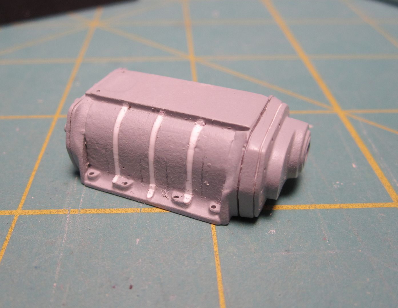

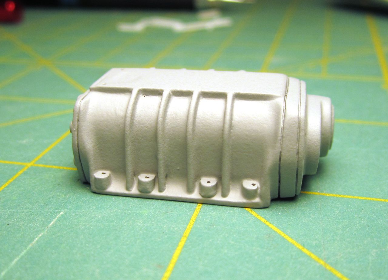

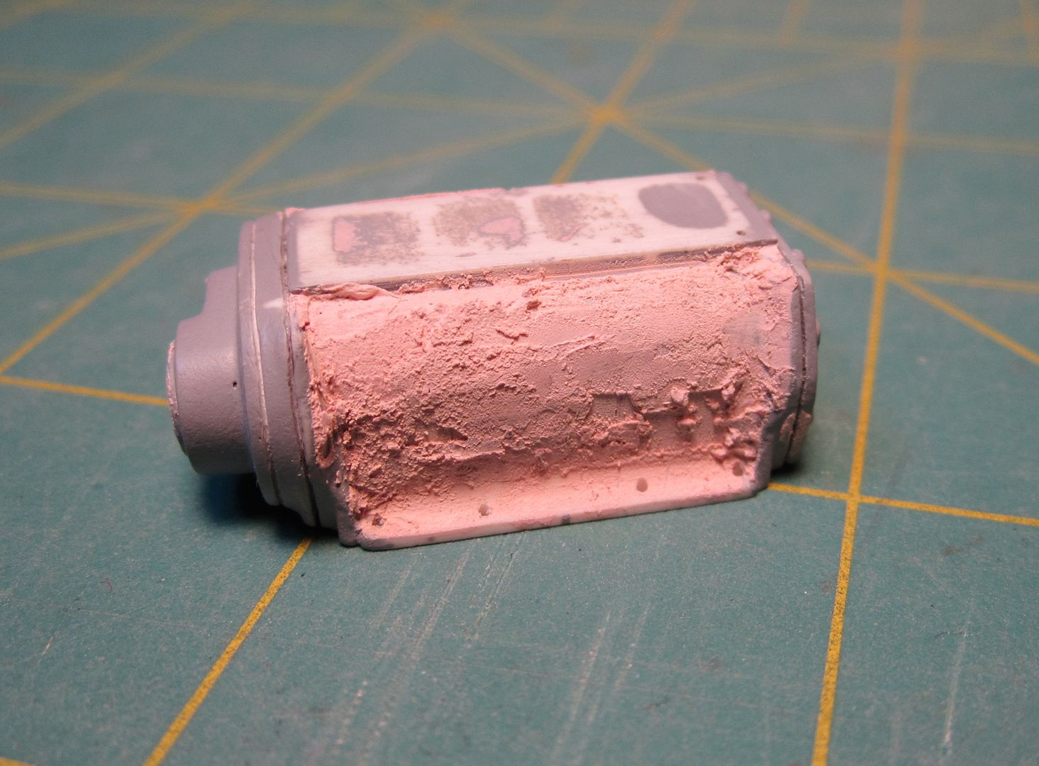

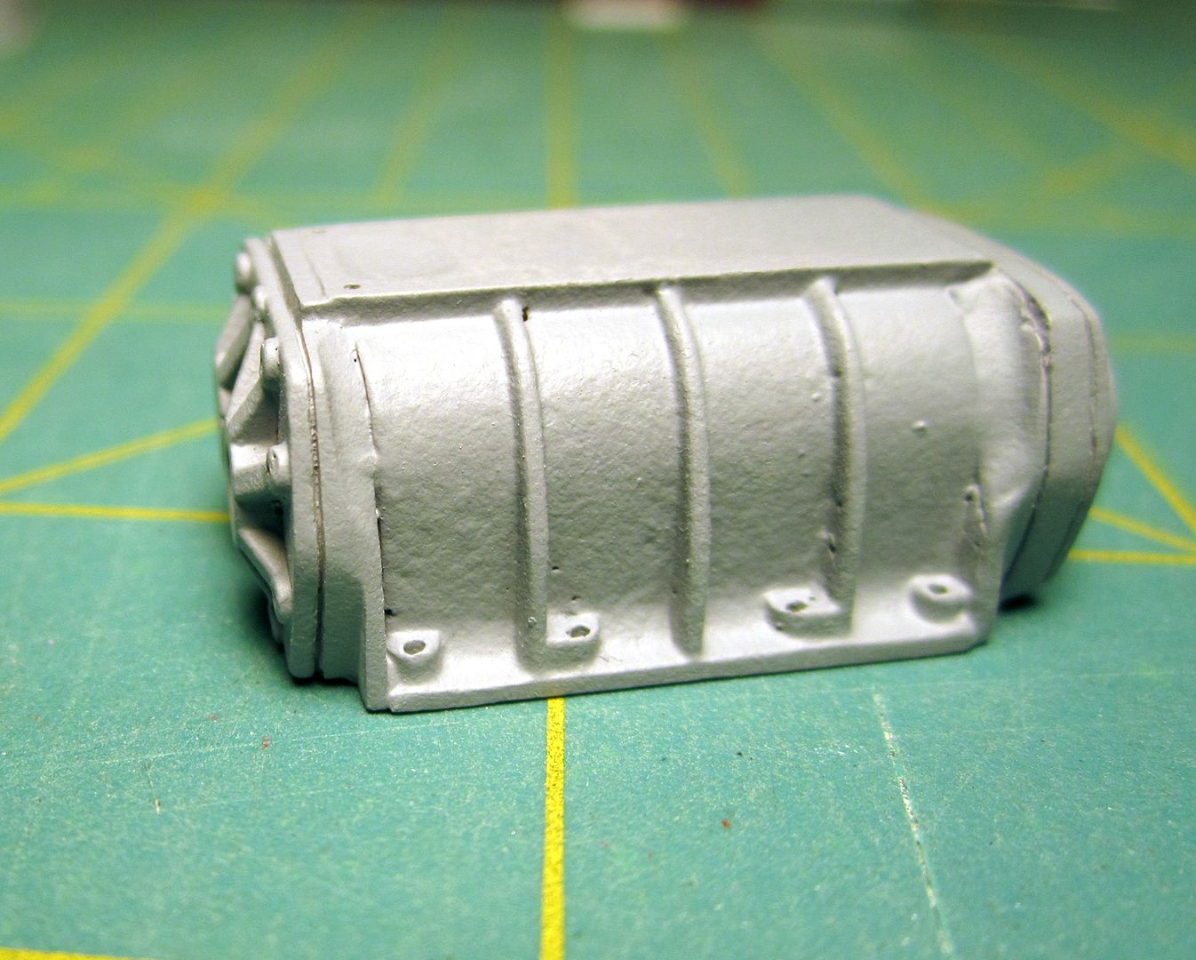

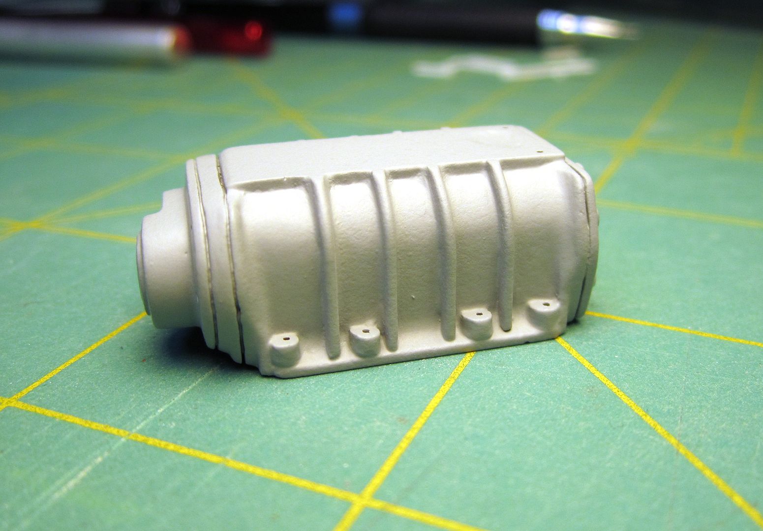

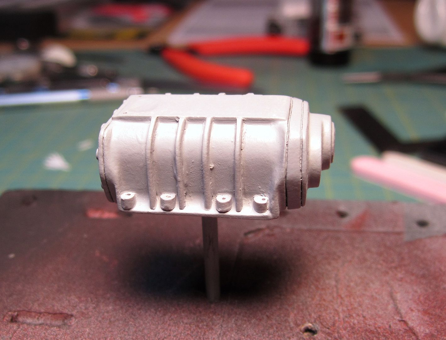

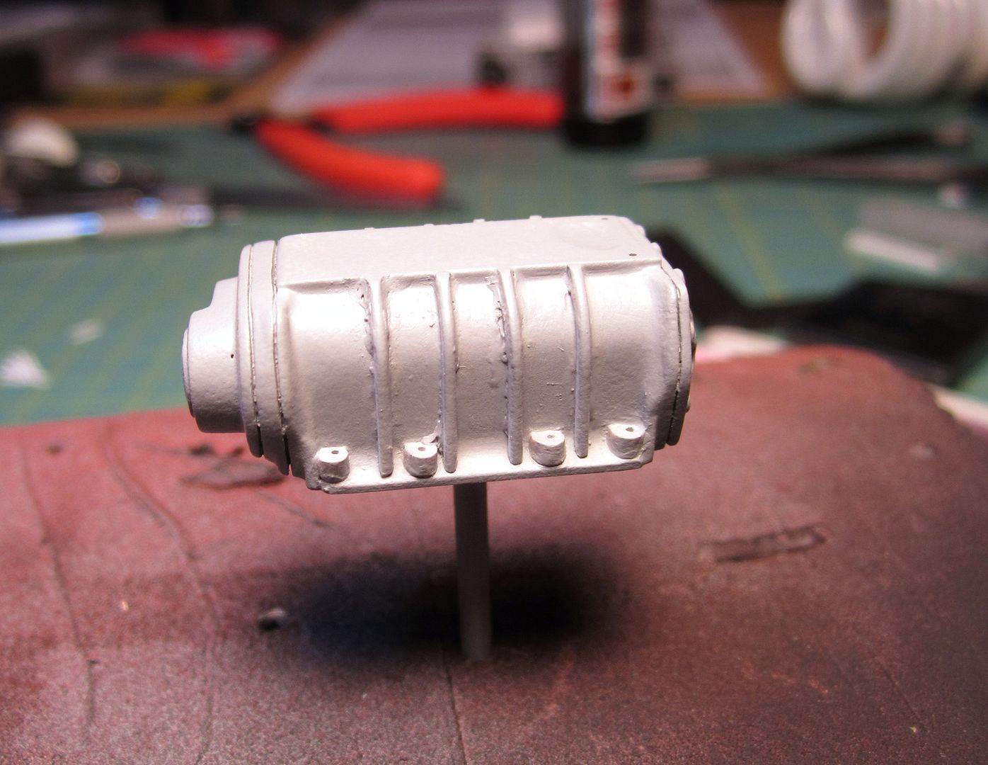

Ok Fellas.... So I sat down for the past 1-2 hours and have been sanding away at this blower. It sure is time consuming. This is the first pass after the pics I previously showed and all I have done here is sand and file areas of the blower and before I lay some bondo down on it I wanted to check it with a few coats of primer to see how its looking. I think it starting to look much better now. I have the blower under my little heat lamp (Desk Lamp with 100 watt bulb...lol) helping the paint dry so I can start adding some mud to it. You can see there are some areas that still need to be fixed. I will be back with some more later....

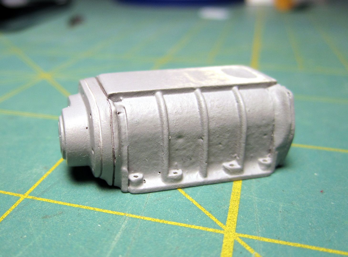

Here is the blower with some primer sprayed on it after sanding the super glued joints down:
Link to comment
Dare I say that I'm impressed? I was going to make a comment earlier today after you'd removed all the kit ribs and was going to say it was as smooth as a baby's butt. It's too late for that now. LOL I truly am impressed by how good it looks with the addition of your newly relocated ribs. As much as I totally understand where you're coming from with doing a 3D version of this, you're going to have just as much time in getting all the print marks filled and sanded to get it to basically this same point. It would be sort of sad to see you spend this much time and do this fine a job, only to "throw it away" and start over. Unless you totally foul something up on this one, I'd "vote" for keeping what you've got going... Did I mention I'm impressed??? ;)

Scott....thank you for the kind words. It means a lot from you. LOL the blower was smooth smooth as a baby's bottom.... I will have to post a pic of then mooneyham blower next to this. You are right about the time it's going to take to model, have printed and prep. That's my biggest thing right now. Althought I know I am trying to make this as accurate as possible is the resin driving me to have it 3D printed as well.i would hate to lose all of this hard work I have put into this one. I am guess you are impressed with it so far?? ;)... Hehe
