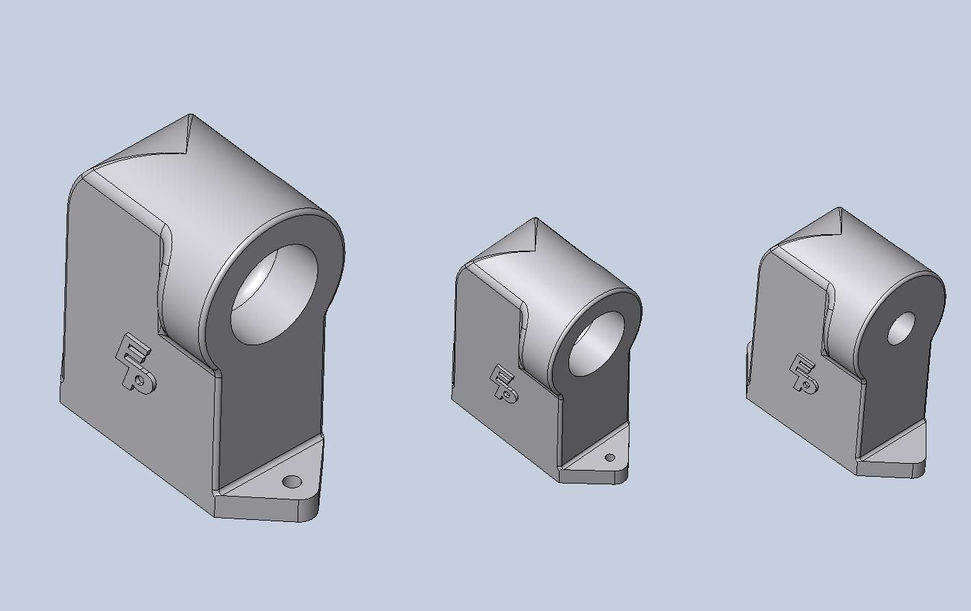

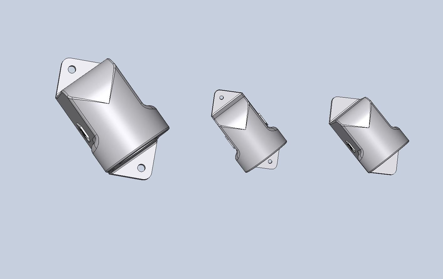

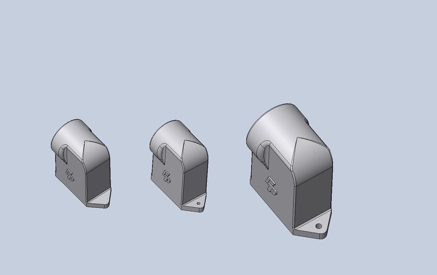

Mooneyzs Posted August 21, 2014 Author Posted August 21, 2014 Simon... I should have a price tonight after I get home from work in a little bit. I was planning on updating a few other parts and re-uploading them on shapeways. I had a few areas on a couple of parts that the thickness needed to be a little thicker. When You upload parts on shapeways it does a quick analyze to make sure the thickness and model is ok on things and will show any ares of concern. Stay tuned and I will have info for you.
Mooneyzs Posted August 21, 2014 Author Posted August 21, 2014 Simon... I got the breather scaled down to 1/24th and the prices are as follows what shapeways quoted: White, Strong & Flexiable - $1.55 ea Frosted Ultra Detail $5.09 ea the only issue I see is that with the White Strong and Flexible is that the size that it is there is some thin walls I got when I uploaded the parts around the mounting holes. So for giggle and grins I thought let me take the mounting holes out and change the main big inlet/outlet holes to get rid of the thin walls and see what the price came out. Since shapeways prices things by volume there wasn't much difference between the two ways I tried but I was curious. if you want to see and image of them I can save them out as a jpeg and post it, just let me know so you can see what I am talking about.
simonr Posted August 22, 2014 Posted August 22, 2014 No problem, Chris, take your time and make the corrections you're telling. I know you will do it correctly. Yes, if you can post in jpeg I can see it. Thanks a lot for you great help on my little proyect. Yours had help me a lot... Simón P. Rivera Torres Simon... I got the breather scaled down to 1/24th and the prices are as follows what shapeways quoted: White, Strong & Flexiable - $1.55 ea Frosted Ultra Detail $5.09 ea the only issue I see is that with the White Strong and Flexible is that the size that it is there is some thin walls I got when I uploaded the parts around the mounting holes. So for giggle and grins I thought let me take the mounting holes out and change the main big inlet/outlet holes to get rid of the thin walls and see what the price came out. Since shapeways prices things by volume there wasn't much difference between the two ways I tried but I was curious. if you want to see and image of them I can save them out as a jpeg and post it, just let me know so you can see what I am talking about. d
Mooneyzs Posted August 22, 2014 Author Posted August 22, 2014 No problem, Chris, take your time and make the corrections you're telling. I know you will do it correctly. Yes, if you can post in jpeg I can see it. Thanks a lot for you great help on my little proyect. Yours had help me a lot... Simón P. Rivera Torres d Simon... Here is a couple of pics of the parts modeled in Solidworks.... Front View - 1/16th on the left, 1/24th in the middle and right. As you can see the one on the right I removed the mounting holes as well as I made the hole where the hose attaches to smaller. I did that to see if it would get rid of the errors I was having in the White strong and flexible material. It did But my personal opinion is that its probably best to do it in the Frosted Ultra Detail because it will turn out better and capture a little more of the detail. Although the draw back is that they will cost a tad more but if one wanted to go with the White strong and flexible you could always drill your own mounting holes and open up the hole for the hose: Top View - Same Order 1/16th on the left and 1/24th both in middle and Right: Back View - 1/24th on left and middle, 1/16th on the Right:

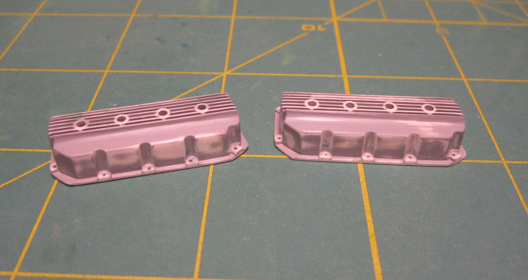

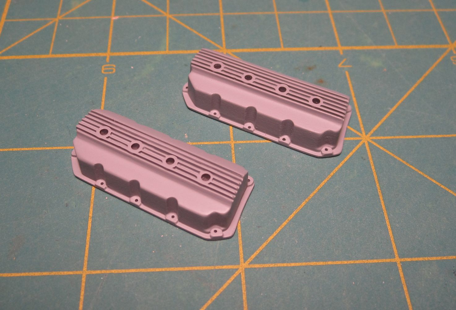

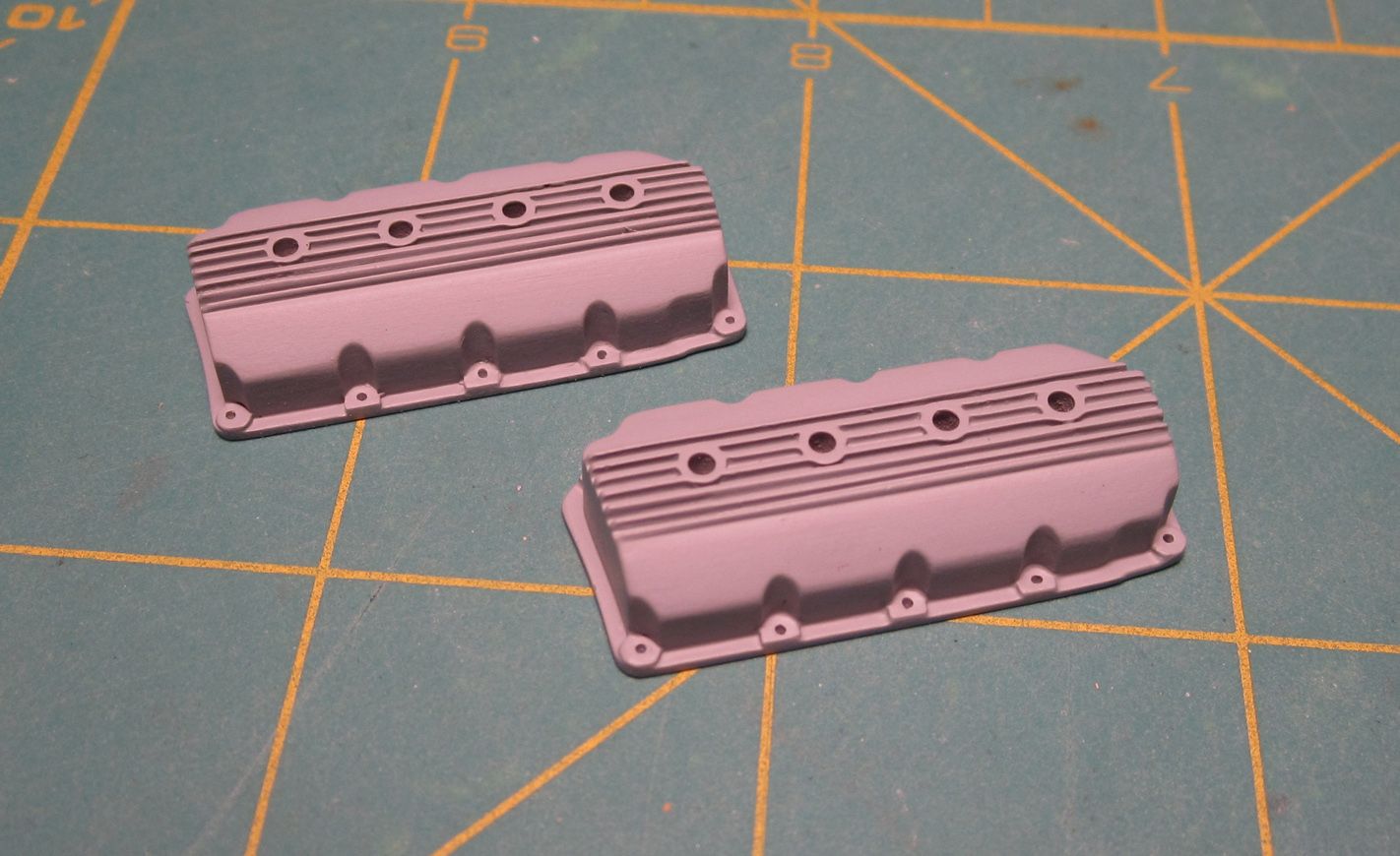

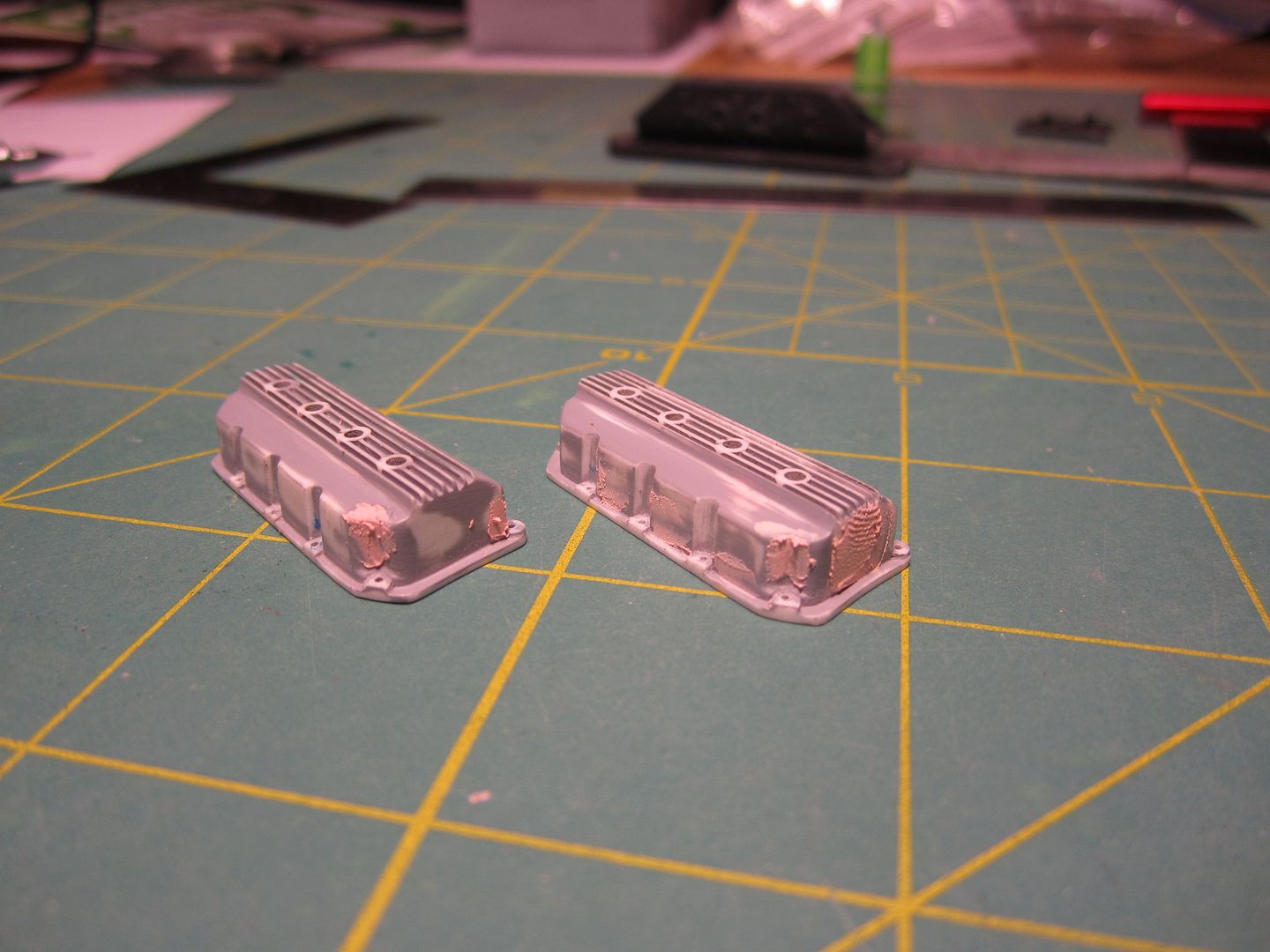

Mooneyzs Posted August 22, 2014 Author Posted August 22, 2014 Ok Fellas as promised here are a few pics of the valve covers. They are almost done and ready for paint. I noticed tonight after getting some primer on them that I have just a couple more spots that I need to touch up and then they will be ready for the final primer coat. then I can sand with some fine paper and finally get some Black base and Alclad on them. Here is a few pics... Here I was getting the valve covers sanded with some 500 grit paper: I added some Bondo in a few of the last areas I noticed that needed some filler: Here they are after shooting some primer on them. I noticed a few spots that I need to do a little sanding and fixing then they should be ready for their last primer coat: Another view in primer:
gasser59 Posted August 22, 2014 Posted August 22, 2014 (edited) Man oh man, those are looking nice lil' brother. Really looking forward to seeing them in Alclad. Bet you are too. LOL Edited August 22, 2014 by gasser59
ClayK Posted August 22, 2014 Posted August 22, 2014 I wish I had half your patience and dedication Chris. Great work.
Mooneyzs Posted August 22, 2014 Author Posted August 22, 2014 Brad... they are almost there but need a little more TLC.... to make them pass inspection...lol I am probably a harder critque on my own work because I want it to be perfect. I sure wish the humidity would go away so I could do some painting... i want to see thesw in Alclad really bad...lol Scott... thank you for the kind words. Clay... thank you. Your builds have given me that extra motivation to push my limits farther than they have ever been before. Thank you for being an inspiration to me.
simonr Posted August 22, 2014 Posted August 22, 2014 Wow Chris, this is an impressive work. Now, in order to get them, what I have to do? Simon P. Rivera Torres Simon... Here is a couple of pics of the parts modeled in Solidworks.... Front View - 1/16th on the left, 1/24th in the middle and right. As you can see the one on the right I removed the mounting holes as well as I made the hole where the hose attaches to smaller. I did that to see if it would get rid of the errors I was having in the White strong and flexible material. It did But my personal opinion is that its probably best to do it in the Frosted Ultra Detail because it will turn out better and capture a little more of the detail. Although the draw back is that they will cost a tad more but if one wanted to go with the White strong and flexible you could always drill your own mounting holes and open up the hole for the hose: Top View - Same Order 1/16th on the left and 1/24th both in middle and Right: Back View - 1/24th on left and middle, 1/16th on the Right:
