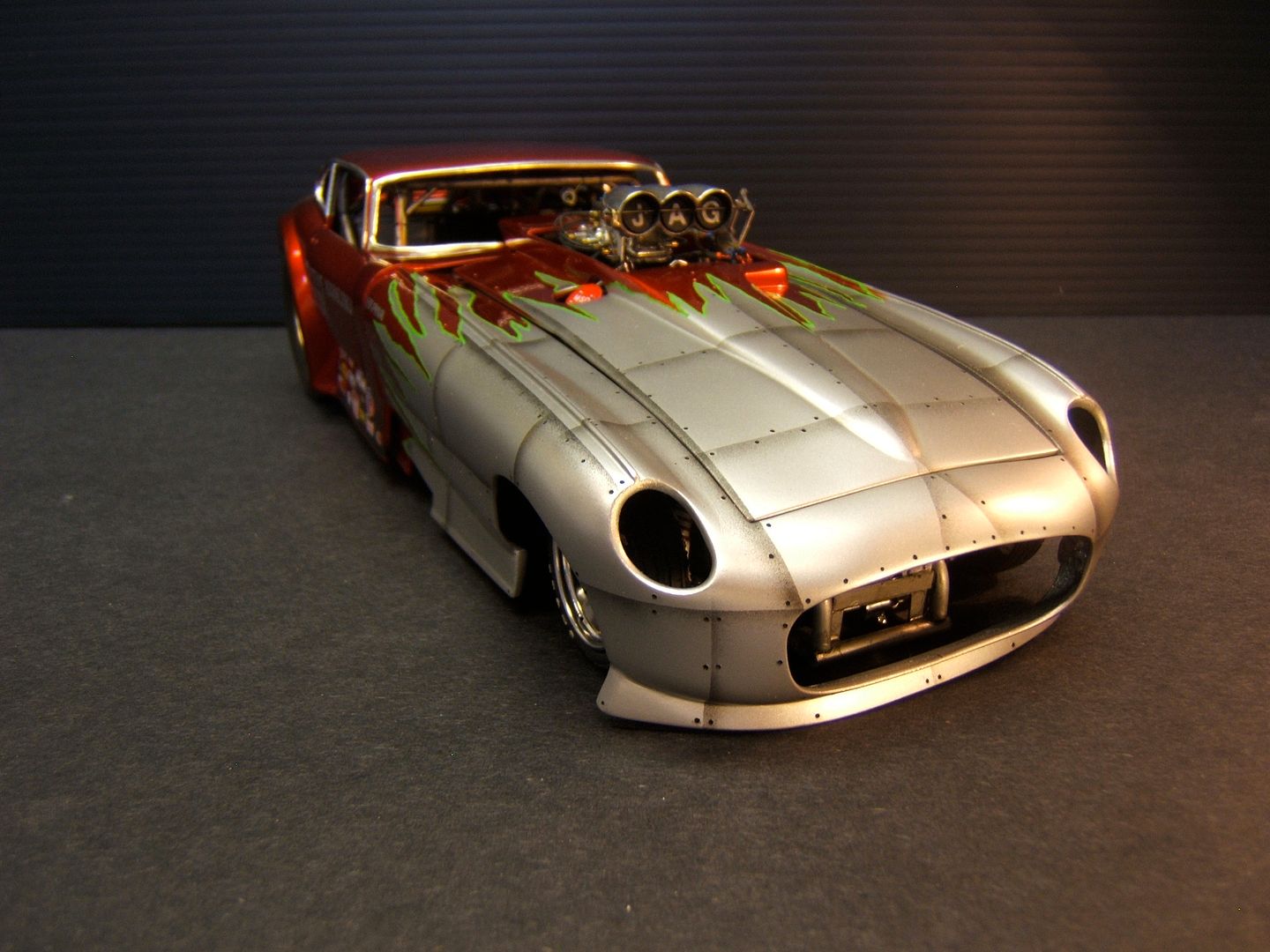

bigmikevee Posted May 28, 2011 Posted May 28, 2011 Hey John, Lookin' good sir, that is a cool airbrush holder, it is just amazing to me how all of your details just blend together just right, sometimes a lot of detail just doesn't quite "mesh" but yours just looks great. Can't wait to see it finished, thanks for sharing with us!! Oh, what did you use for the rivets on the paint, sharpie? Wow, you have got a steady hand, if I did that it would look like freckles everywhere!! Mike

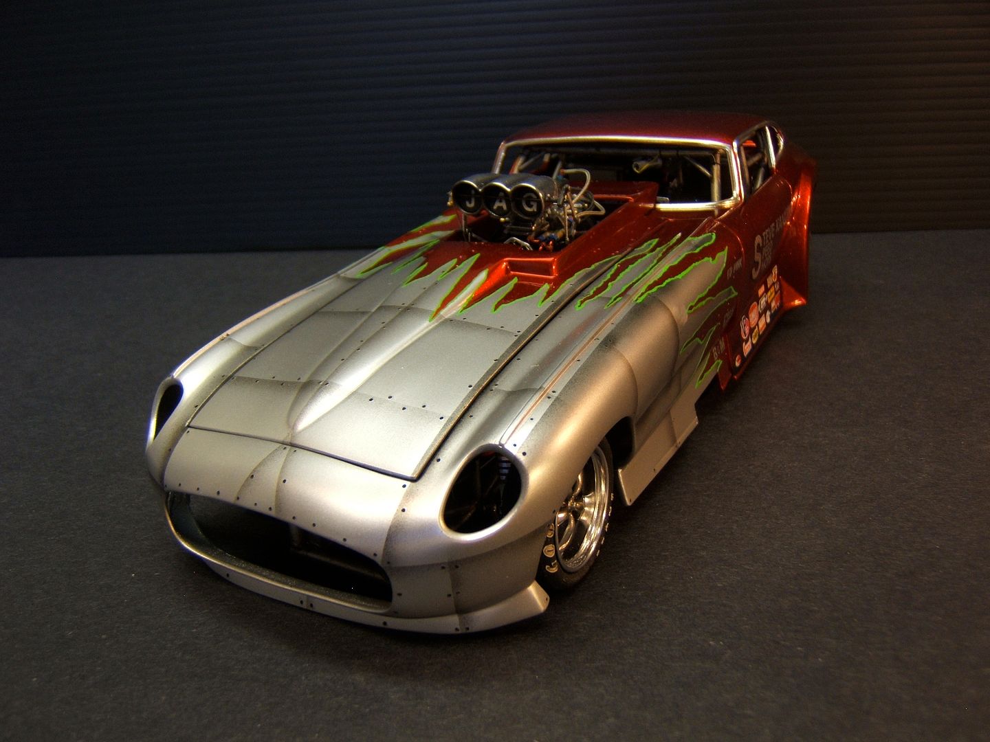

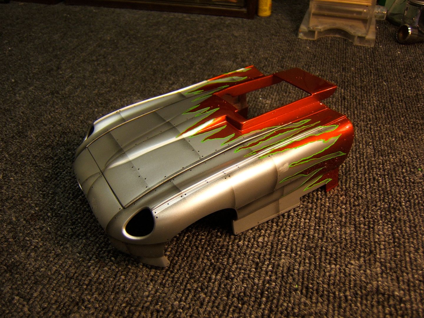

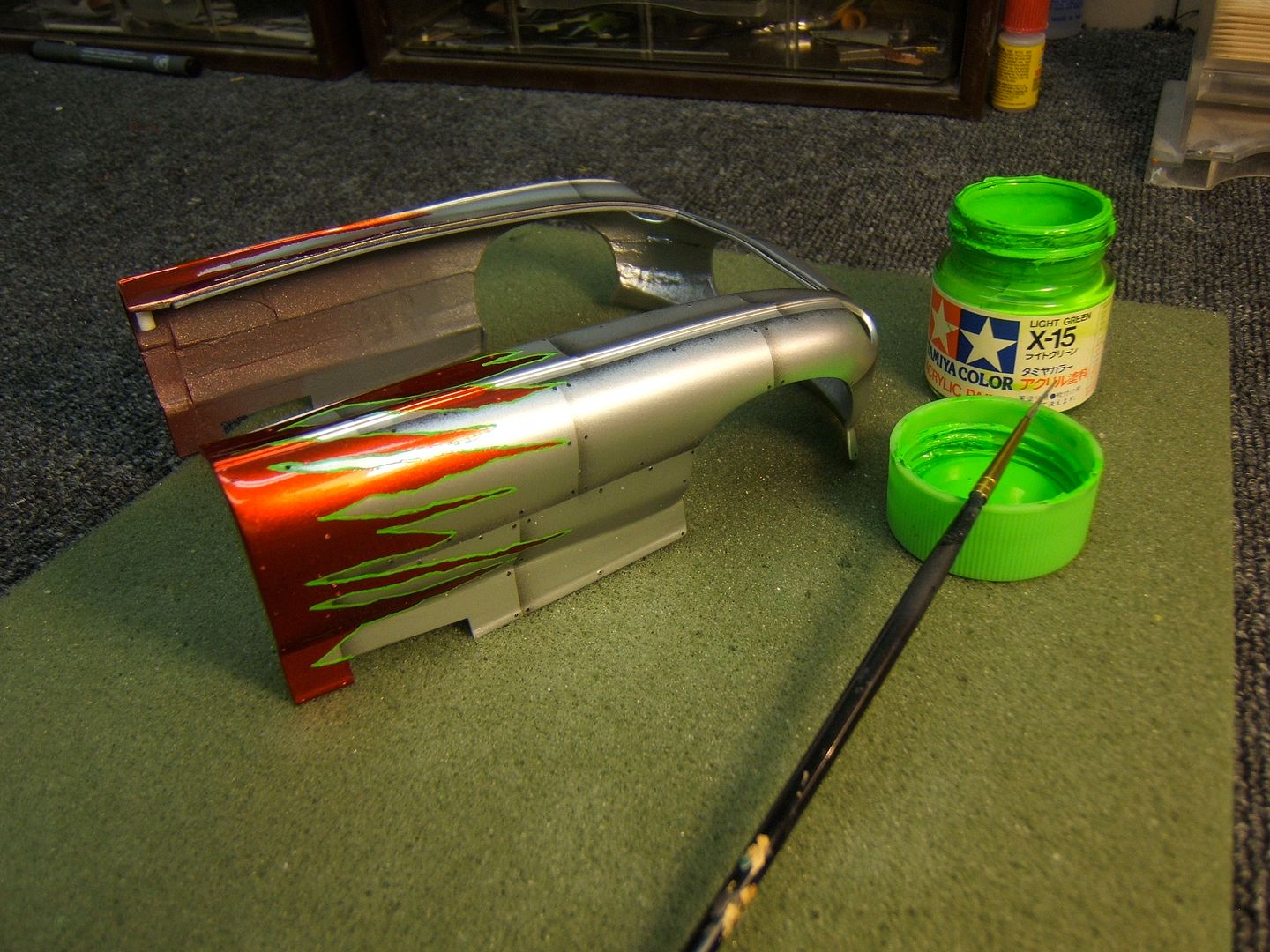

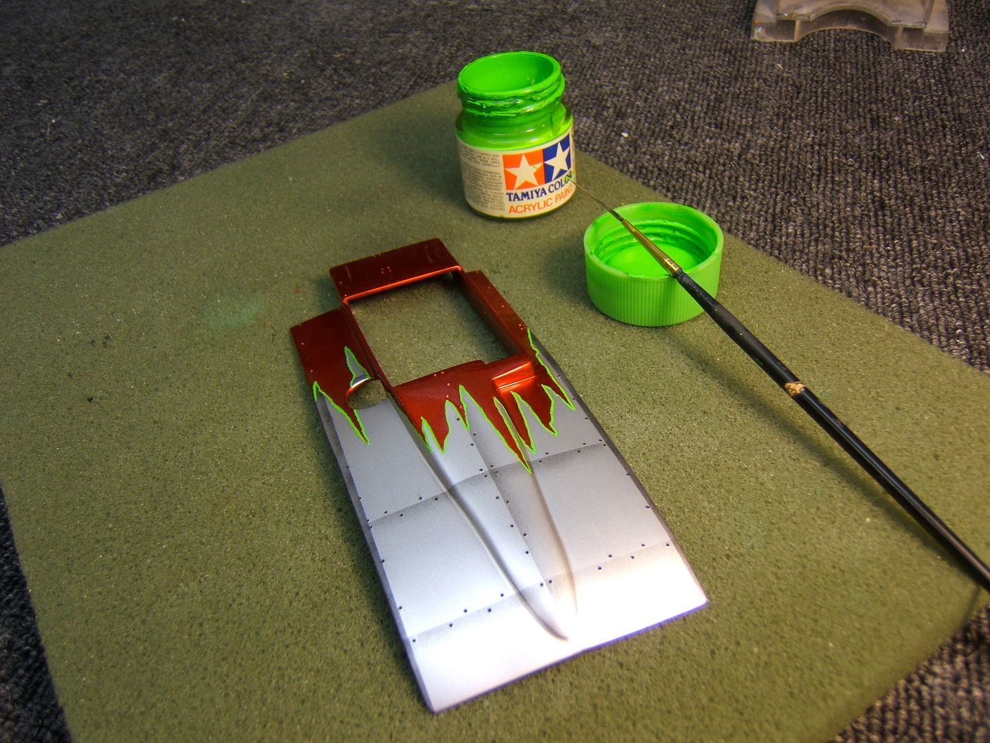

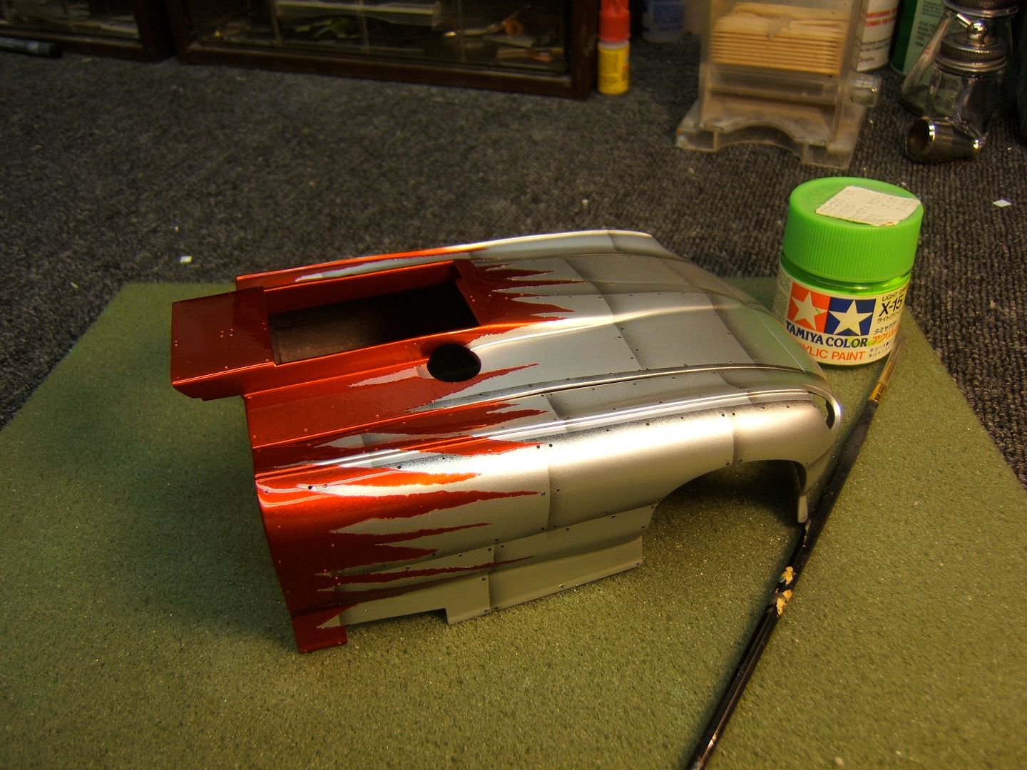

John Teresi Posted May 28, 2011 Author Posted May 28, 2011 Hello.......I got some color on the nose and the rear body......H.O.K. kandy red over Slixx mini flakes.......baremetal foil over window frames........hand painted pinstripe with Tamiya light green.......I will clear coat the body tomorrow......I need to paint the pipes and wing and instal the glass.......thank`s for looking.

Mooneyzs Posted May 28, 2011 Posted May 28, 2011 John....that paint looks fantastic. Love how you went with the torn look for the paint scheme and striping the green. She sure is a beauty. Beautiful work!!

Mooneyzs Posted May 29, 2011 Posted May 29, 2011 John, what number brush did you use for the pin striping. That is one minor detail that just adds so much to the car. I think I want to try that sometime myself. I love the choice of color and it just pops in my opinion.... well the whole car does... Still amazed at this build.
scbaker Posted May 29, 2011 Posted May 29, 2011 Best looking Jag I've ever seen ! Great paint and details... way cool for sure.
Dragracer Posted May 29, 2011 Posted May 29, 2011 1 word John, BEAUTIFUL!, the red (with the green striping) looks great on the silver, the rip paint job came out great!, Love It!

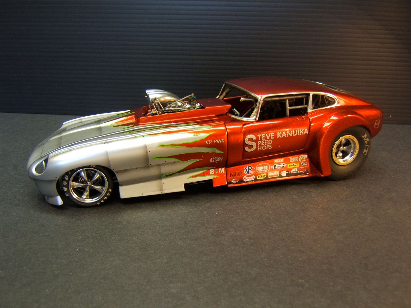

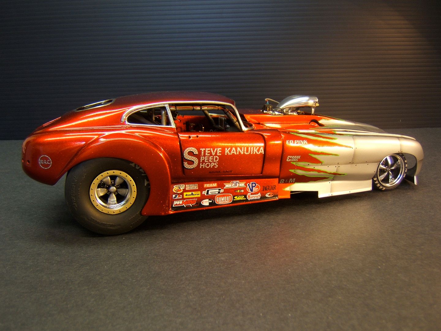

John Teresi Posted May 30, 2011 Author Posted May 30, 2011 Hello.......pipes are painted alclad and I airbrushed weathered blueing......using Tamiya clear blue ,red,orange,yellow and black ends......pipes are installed ..........wing is alclad and flat black and is installed.......wing is also removable for easy packing.......paint job is finished......I put the last clear coat on today......I will put the glass in the body in a couple of day`s after the paint cures........almost done........thank`s for looking.

John Teresi Posted June 1, 2011 Author Posted June 1, 2011 Hello......the glass is installed........door`s installed......nose grill installed.......battery access panel ,wheelie bar and wing are removable........I will attach the chutes and headlight`s tomorrow.......thank`s for looking.

John Teresi Posted June 3, 2011 Author Posted June 3, 2011 Hello......I installed the body pan........body exhaust heat shields.......headlight`s........parachutes......and a few other details........this build will be done tomorrow and I will post pictures in the "Underglass" section.........thank you " all " for your kind comment`s.......I would also like to thank Mr. Paul Rowe for his inspiration to build this Pro mod and for his donation of a resin engine and reference pictures.......also Mr. Clay Kemp for his inspiration and reference pictures as well........and last but not least Charlie with "Pro Tech" for his fine product`s..........thank`s again for following my first Pro Mod build.......it was fun.
