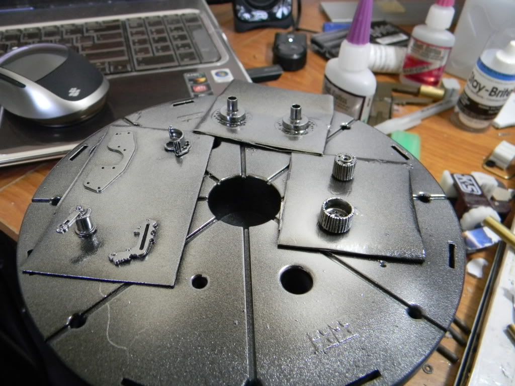

heres some motor parts I hit with a dose of Alclad

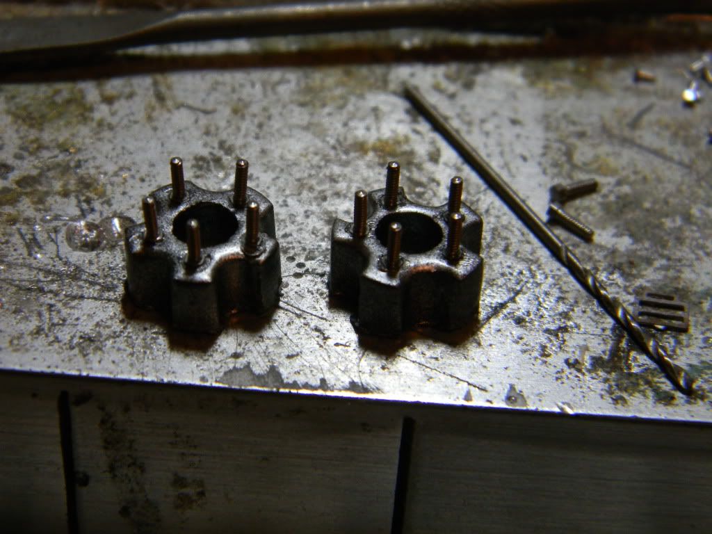

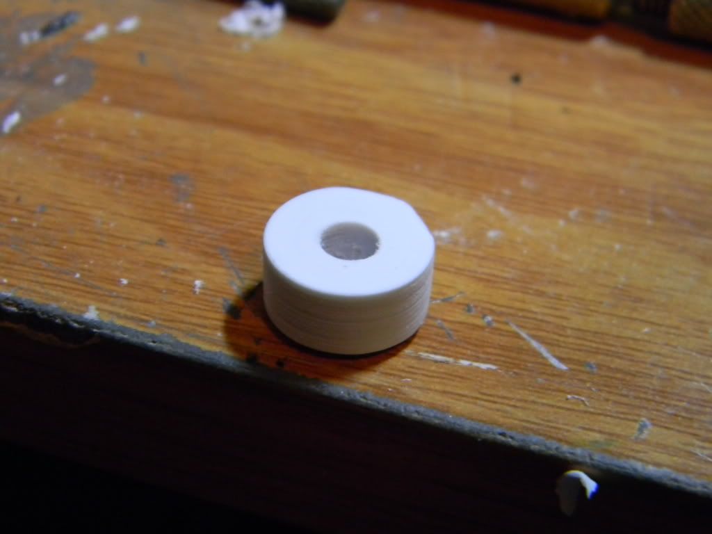

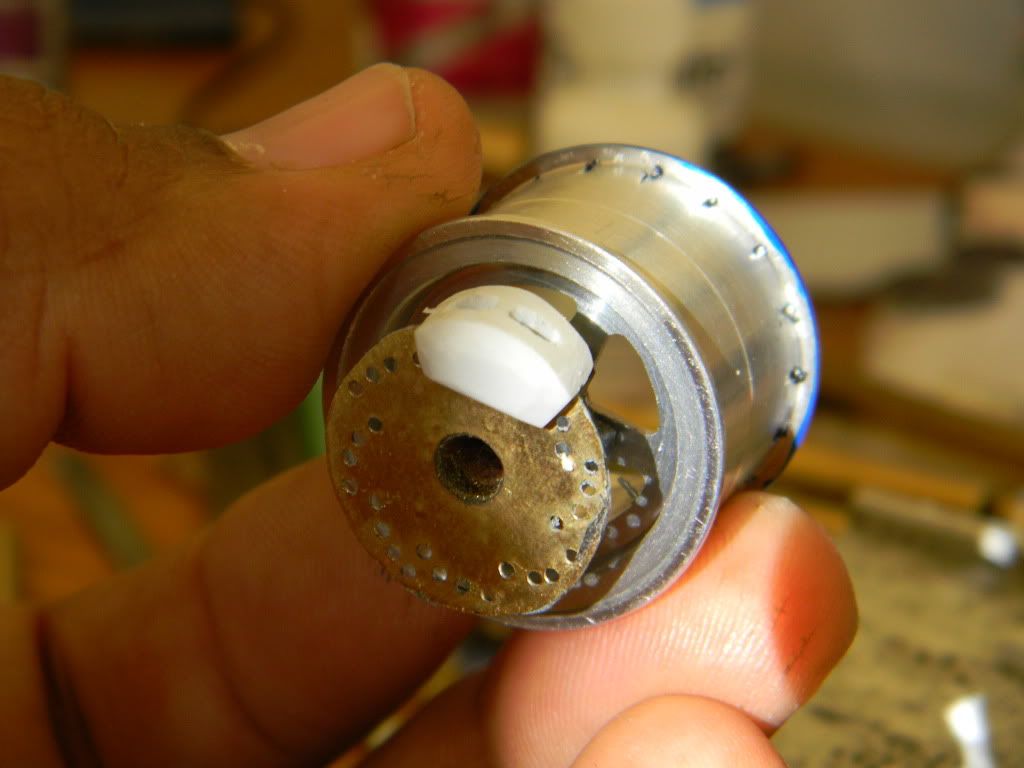

I need to make the rear wheel mounts, so I turned some on my ol trusty dremel , I started with a piece of the resin tranny that i cut up earlier in the build.
After cutting it in half , I chucked it up in the dremel and turned a disc like this....
Now i needed to make the center hole wider so I pulled out the jewelers files and got busy...

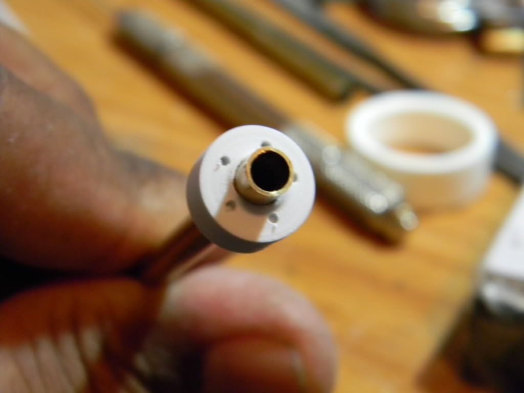

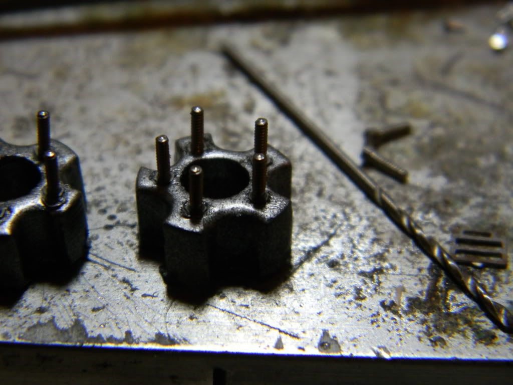

Now I made the hole big enough to fit a piece of tube the size of my axle in the middle and I needed to drill the lug stud holes so they match the holes in my rear rims......
Now to get the actual shape of the mount I used my dremel once again
all thats left to do now is to hit them with Alclad and install the lug studs (which will be done tomorrow).....

Well I finished these sooner than I thought so without further ado....
Painted with lug studs threaded even

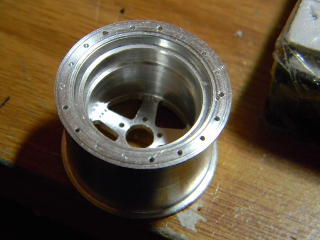

I forgot to add this I drilled the rims for the bead lock bolts enjoy

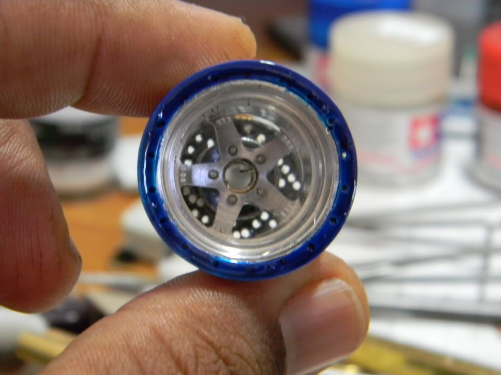

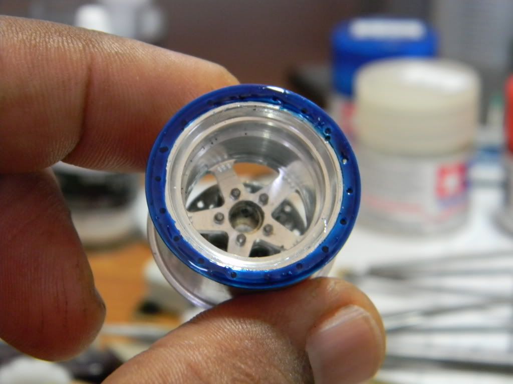

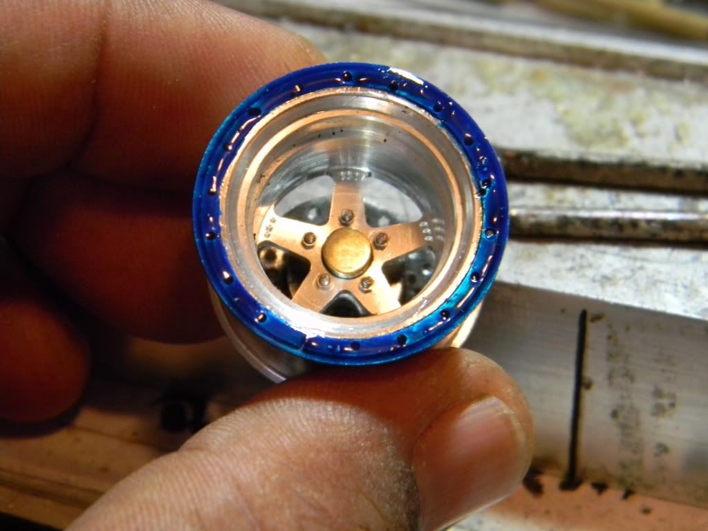

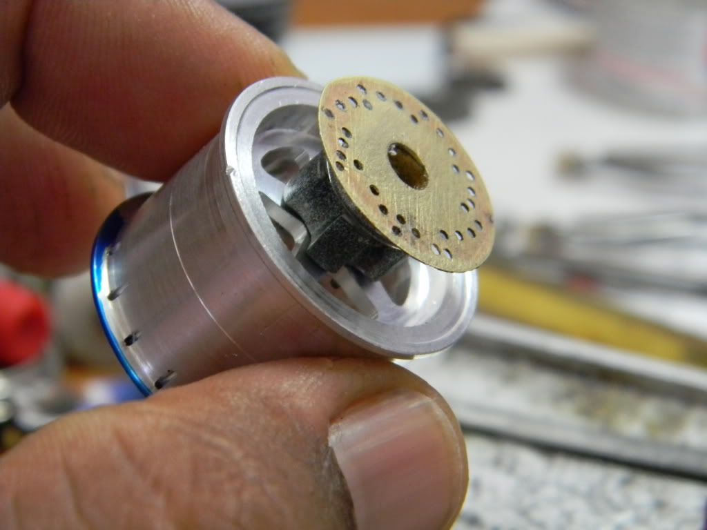

Here you can see I have the rear wheel assembly together just have to attach the brakes.

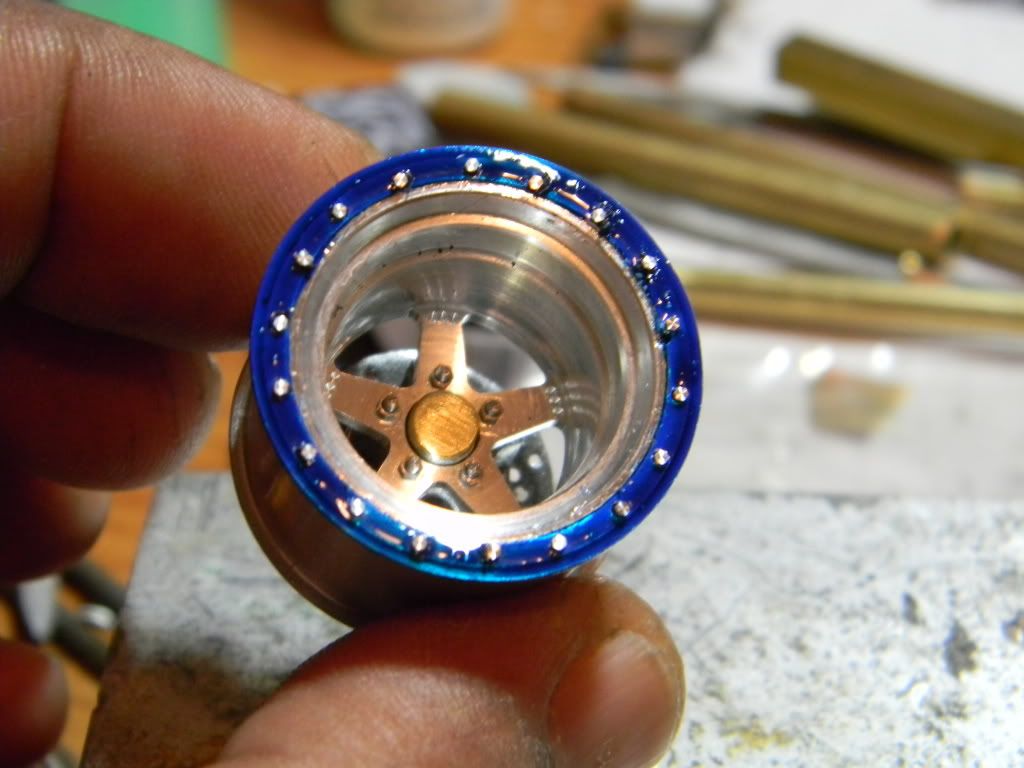

This will bolt on as one assembly its was easier to make it this way. I also did the beadlock rings in anodized blue. (Tamiya Clear Blue over Silver) Still have to clean it up a bit, I'll add the beadlock bolts next.

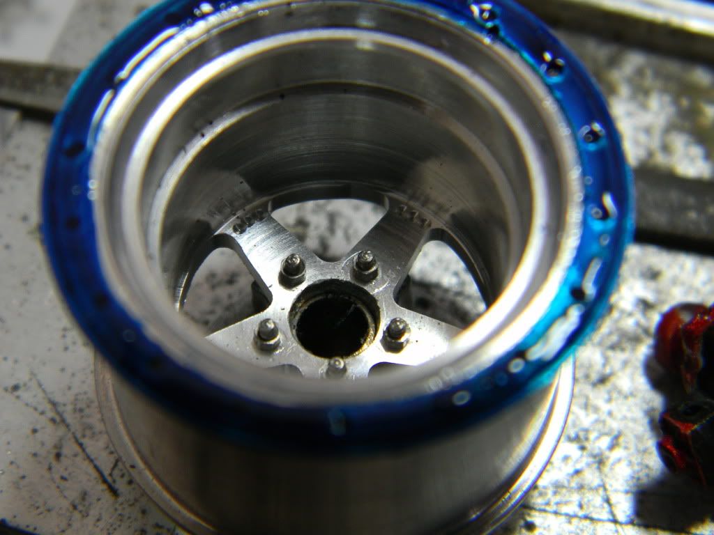

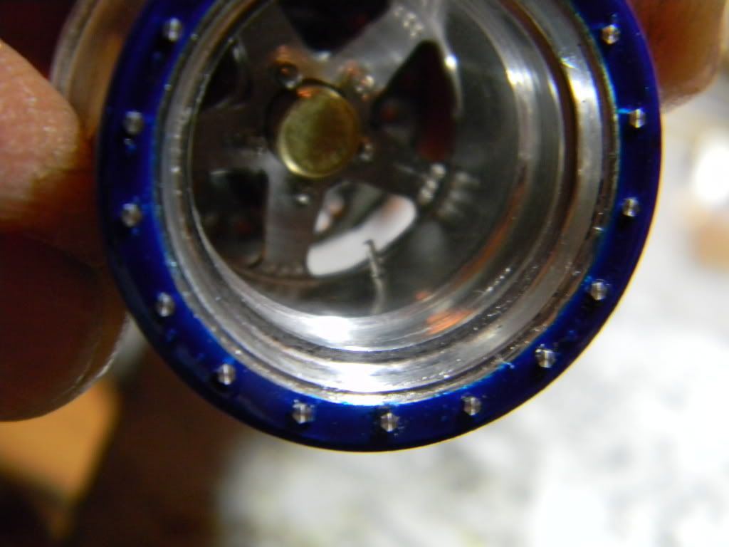

well dang whatya know a 3rd update today,... I had to finish up these rims and get em outta the way. So here's a run down of what i did since the last post. I added the beadlock bolts, axle caps and valve stems enjoy. B)

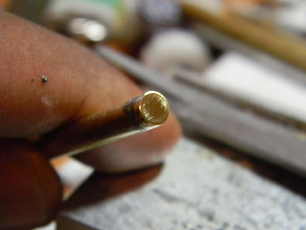

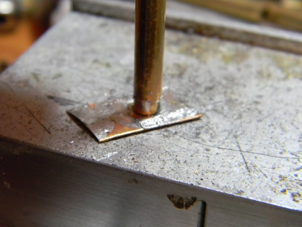

in order to make the axle cap I had to solder a piece of tube to a piece of brass sheet
heres what I have after I clean it up.....

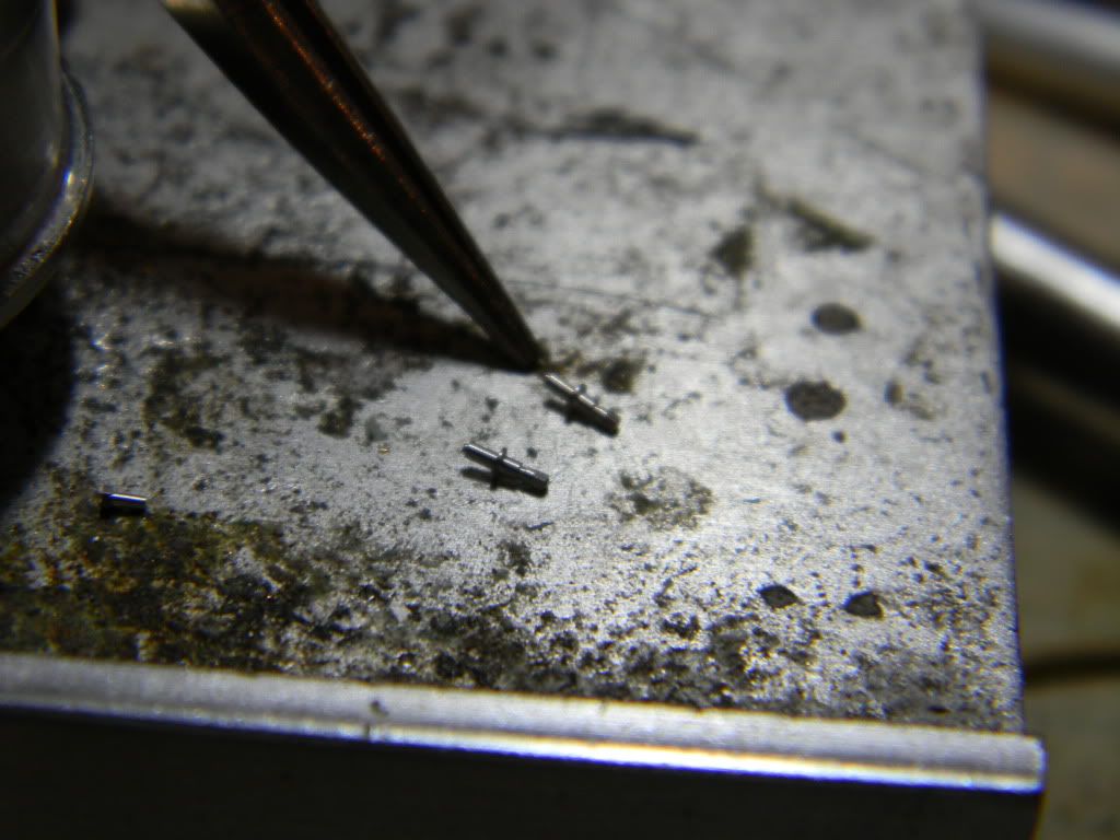

Now to cut it off, the black dot is where I'll be cutting it's 3mm from the top.....
Any last words you piece of tubing ? :blink:
ok cap completed and installed on the axle end
Next I added the beadlock bolts

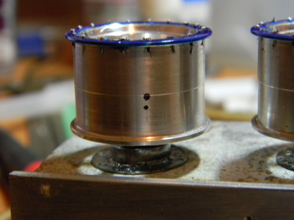

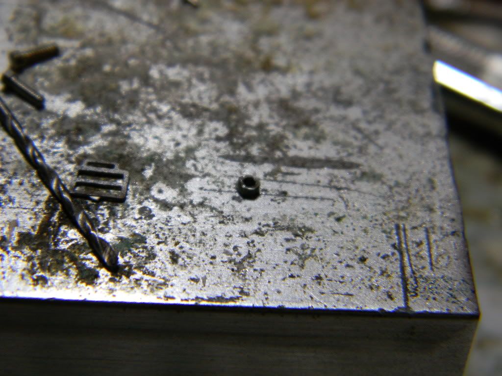

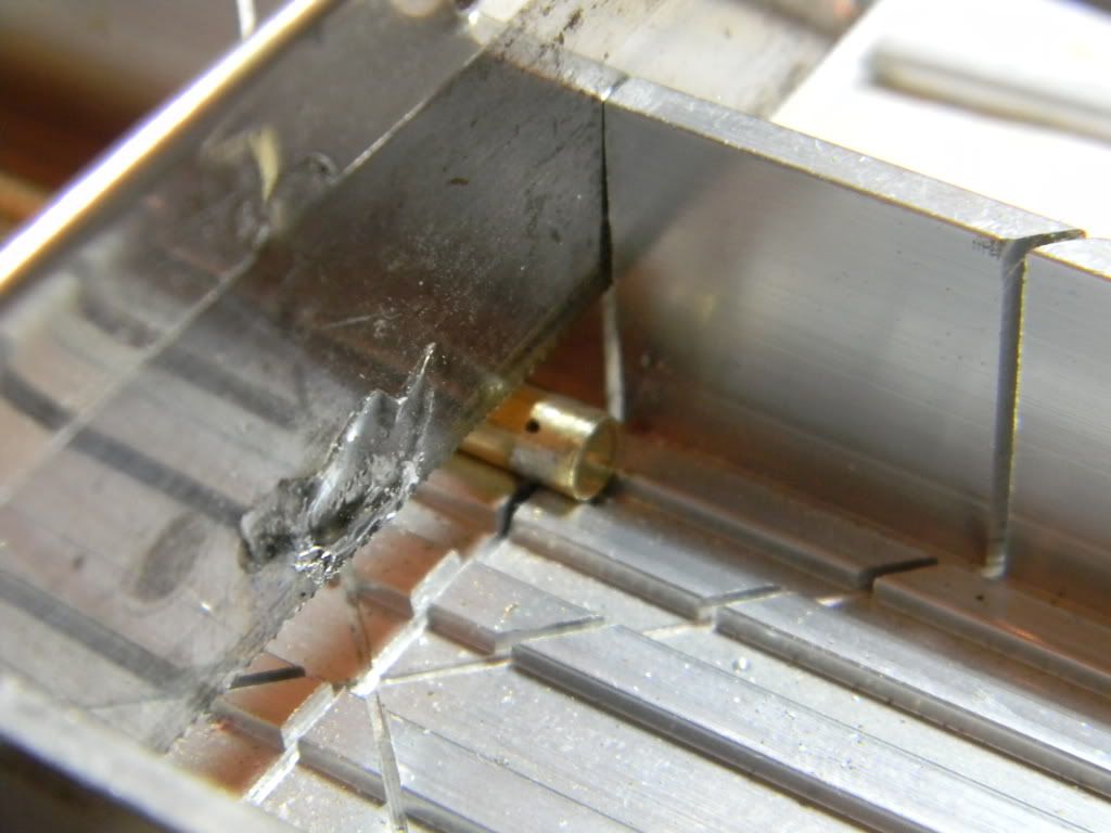

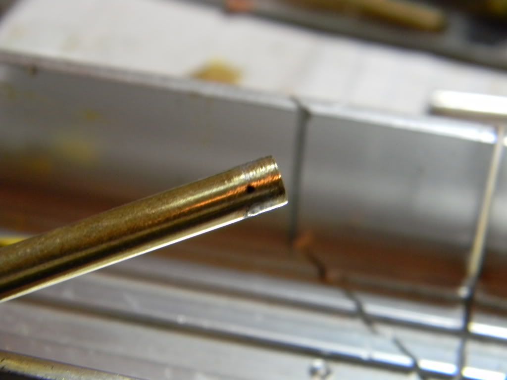

Yikes!! I forgot the valve stems so I drilled the rims and install the stems ,
the black dot is where I drilled
the final product....

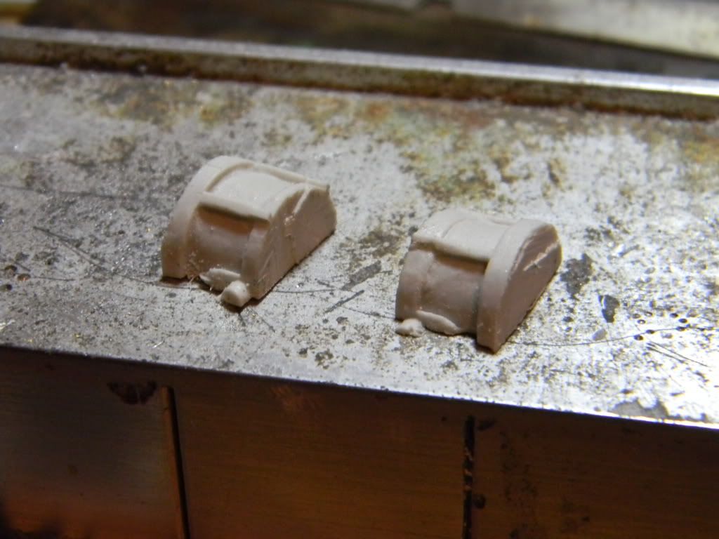

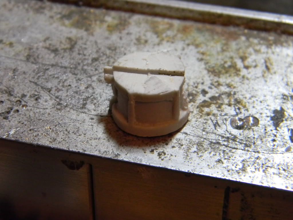

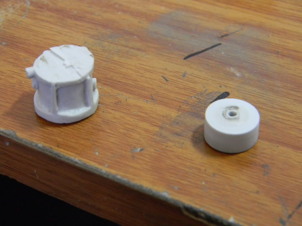

I needed to make the brake calipers and I had one more piece of the resin tranny I cut up so i carved the calipers out of that. Enjoy...
I started by cutting the resin piece in half
can you see where this is going?
after a about 10mins of sculpting with jewelers files , I had a brake caliper just need to paint it now.
