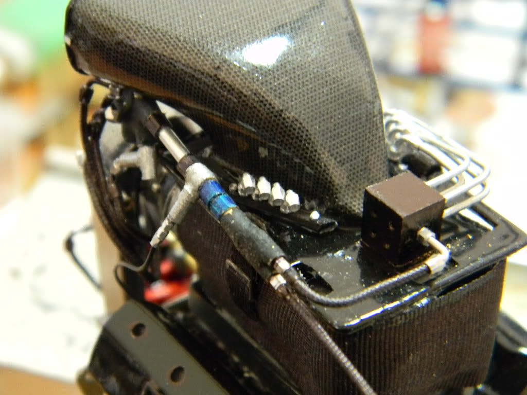

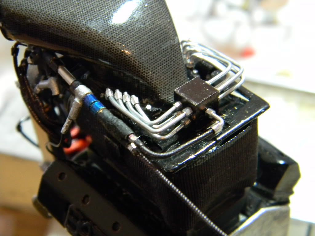

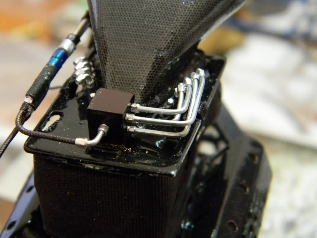

Romell that is FANTASTIC work you're doing! I wouldn't have thought of creating a fuel splitter like that!

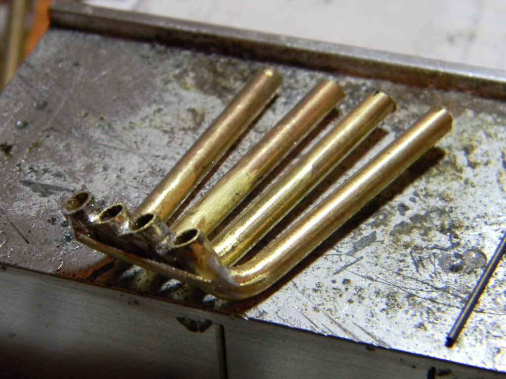

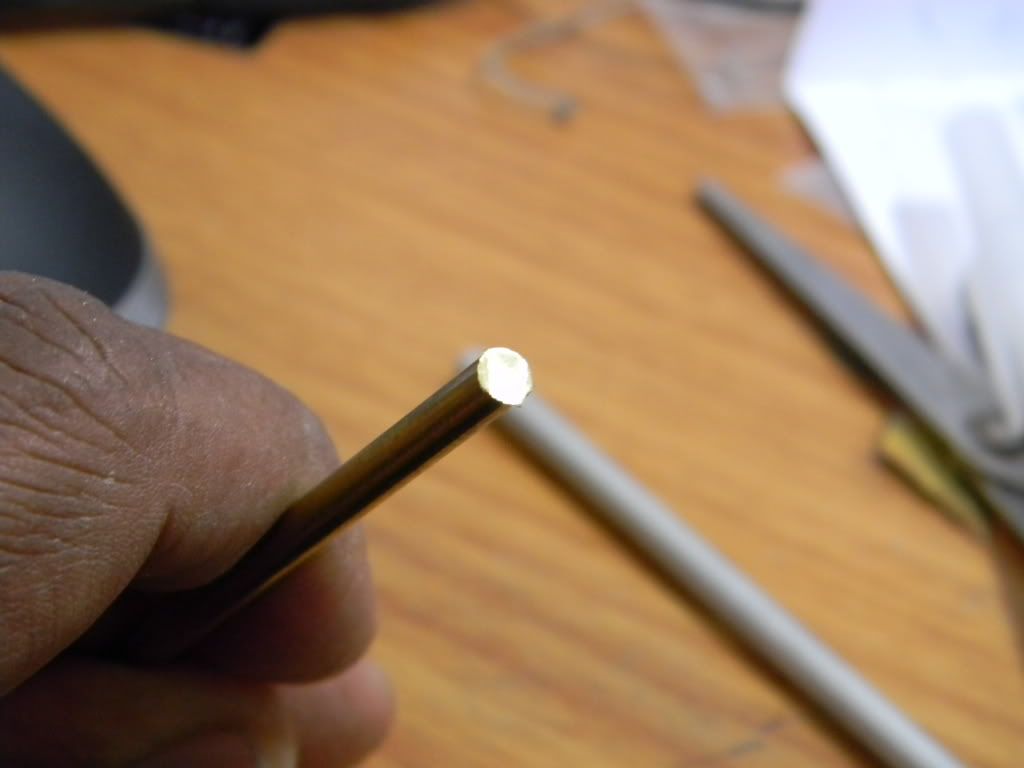

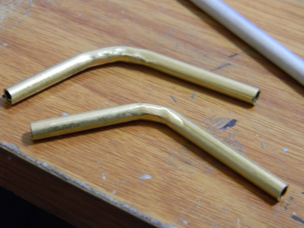

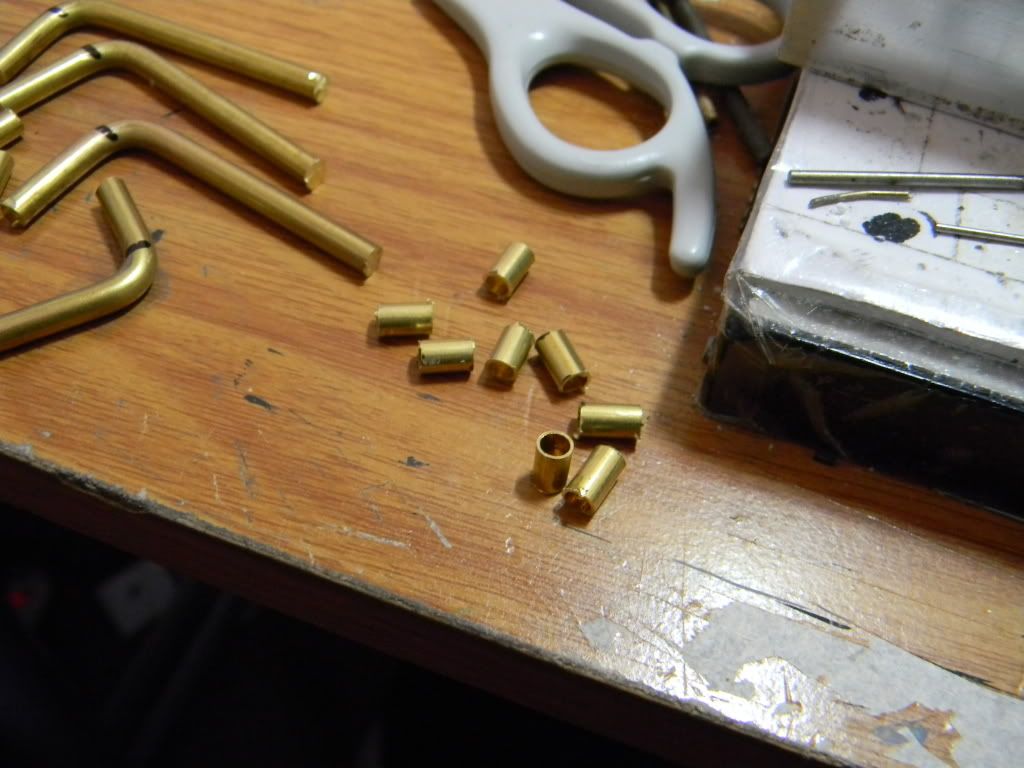

I worked on the headers today, but I had a brain fart and i had no idea how I was gonna get this done because the tube kept getting wrinkles in them, So I slept on it and it hit me , use brass rod instead of tube so heres the pics to show you how the problem was solved.
here you can see the tubing just didn't want to do it my way
here you see the solid brass rod this is .014 rod by the way

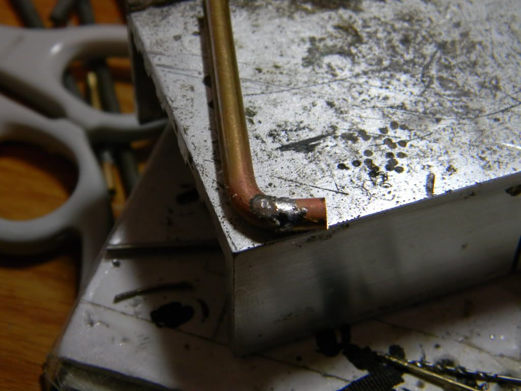

once i was able to get the bend i wanted the rest was a down hill run , here you see the bent rod and the cut tube tips im gonna solder on the ends, and the lines are for cut off.
The tips have been soldered on and im ready to move forward
the pipes are all cleaned up are ready for assembly which i will do in the next section cause I'm limited to 5 photos be right back :blink:

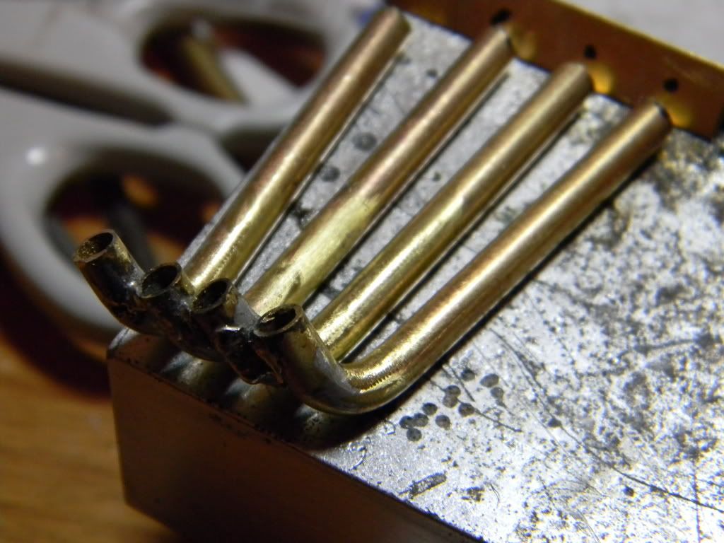

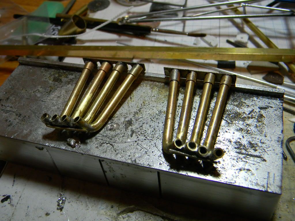

ok now to put em together.....
make sure the position is correct
once I have em in the position I want I solder the support brace to the bottom

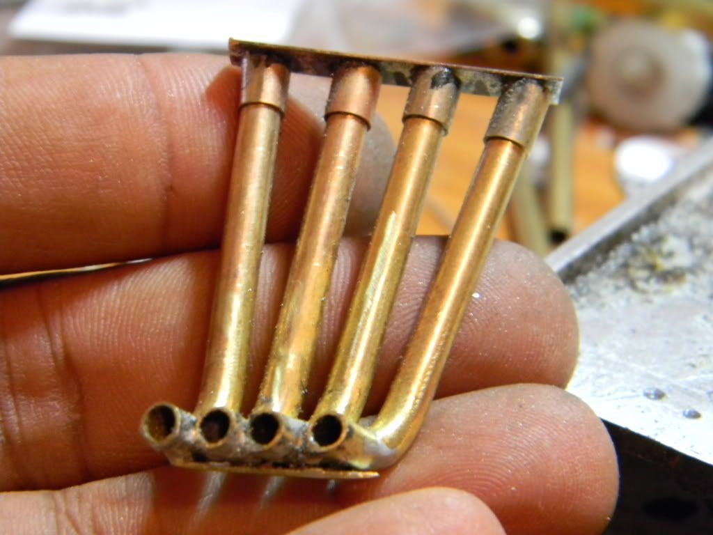

the almost finished product
a close up for ya

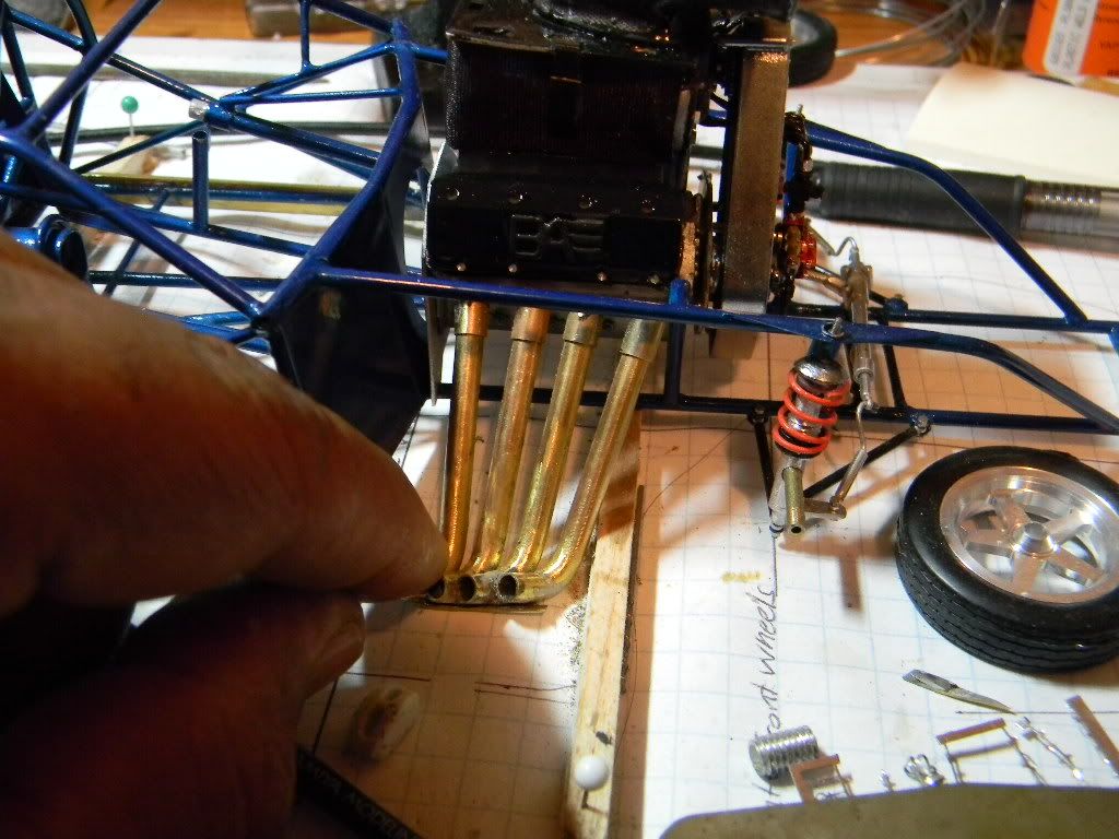

Had to do a mock up shot for ya
See ya soon Romell :lol:

Good solution to the header problem.

I've never got around to trying this yet, but for bending aluminum tubing, would it work to insert two peices of brass rod until they meet where you want the bend, then apply pressure until desired angle? Might help to use a jig. It works in my mind, which BTW, should scare everybody on the board. Think I'll give it a try this afternoon. If you see reports of a major explosion in Las Vegas, that's my experiment blowing up on me.
The only problem I see with that is, how do you get the inserted rod out of the tube once you have it bent? :)

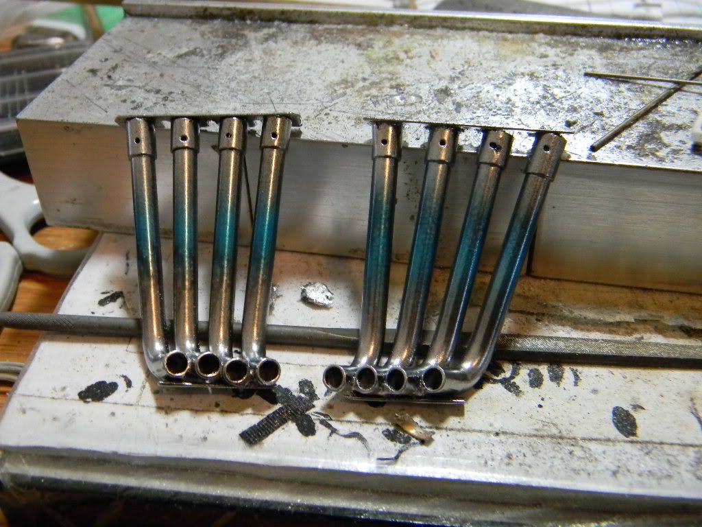

Hey Fellas I was able to finish up the headers with Alclad and a shot of Tamiya clear blue for the heat staining
thought I'd give ya a peek at the finished product
See ya soon Romell :D

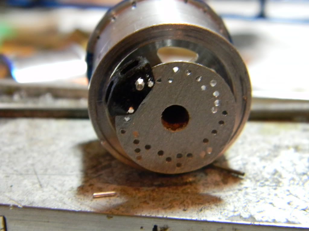

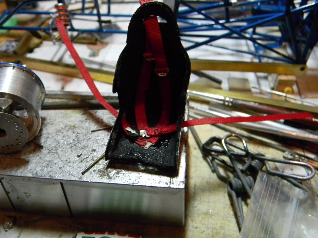

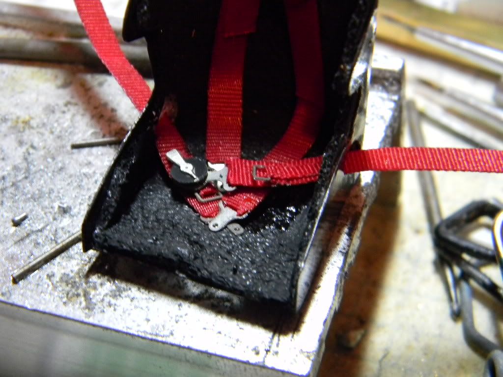

just have a couple small updates brake calipers are done and I got the racing harness started I hope you enjoy....
Sorry I don't have more its been a lazy day.

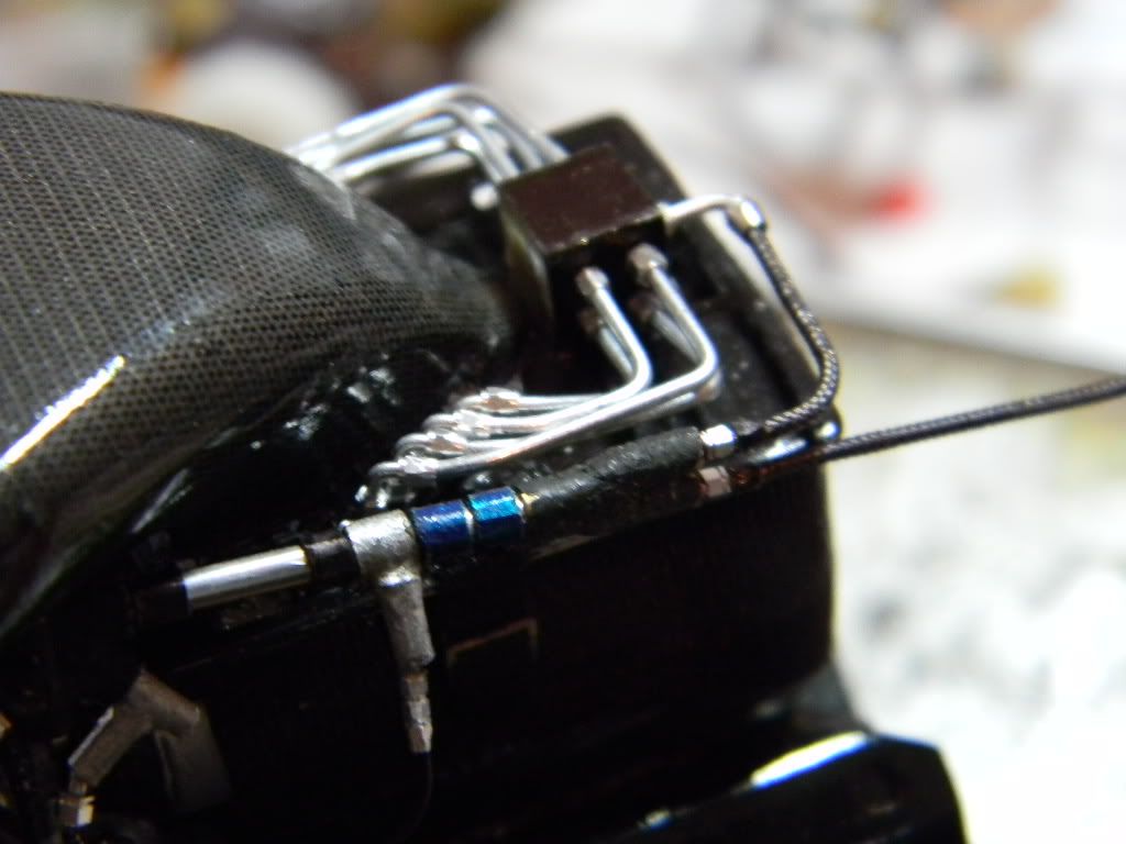

Romell... Nice work on the calipers and seat. Gotta ask you what size RB Motion A/N fittings are you using for your brake lines? I have been going back and forth on using either part no. 1520ST 0.020" dia line or part no. 1521ST 0.025" dia. line but am leaning towards the 0.025" line. Cant wait to see more progress on this.
