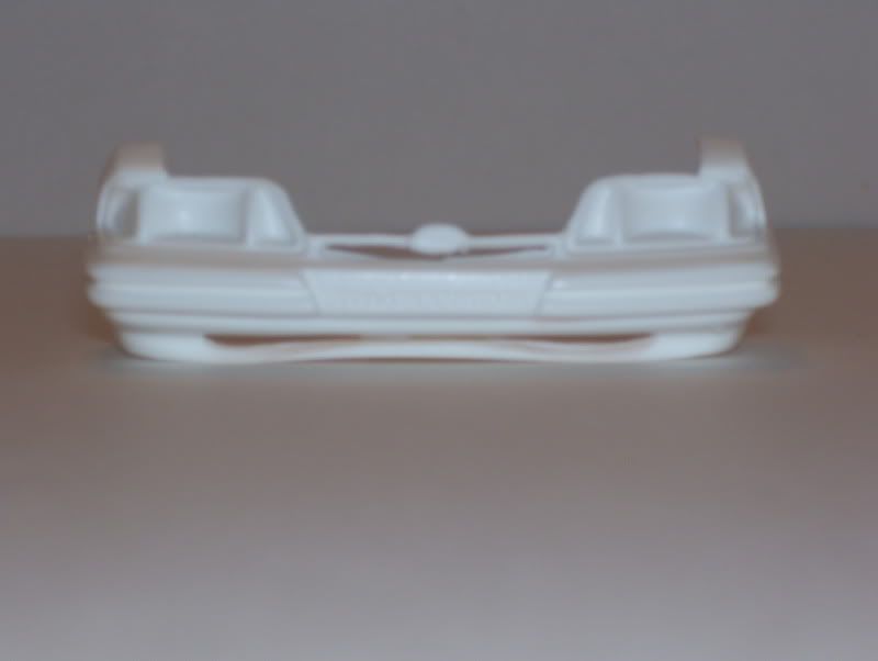

Abell82 Posted October 2, 2011 Author Posted October 2, 2011 Anyone have pics and measurements of the underside of an LX Mustang Bumper cover? I need some help with this area ...
whale392 Posted October 3, 2011 Posted October 3, 2011 Jason, it will be quite some time before I can get back to the salvage yard, but I know he as 7-10 LXs in various stages of death sitting in the yard. i'll have to see about getting there before the weather turns sour.

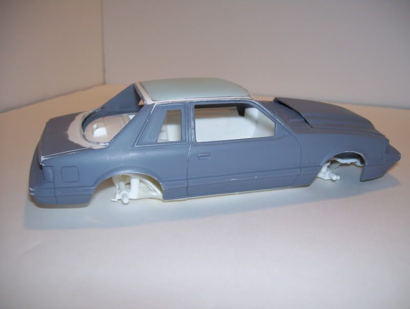

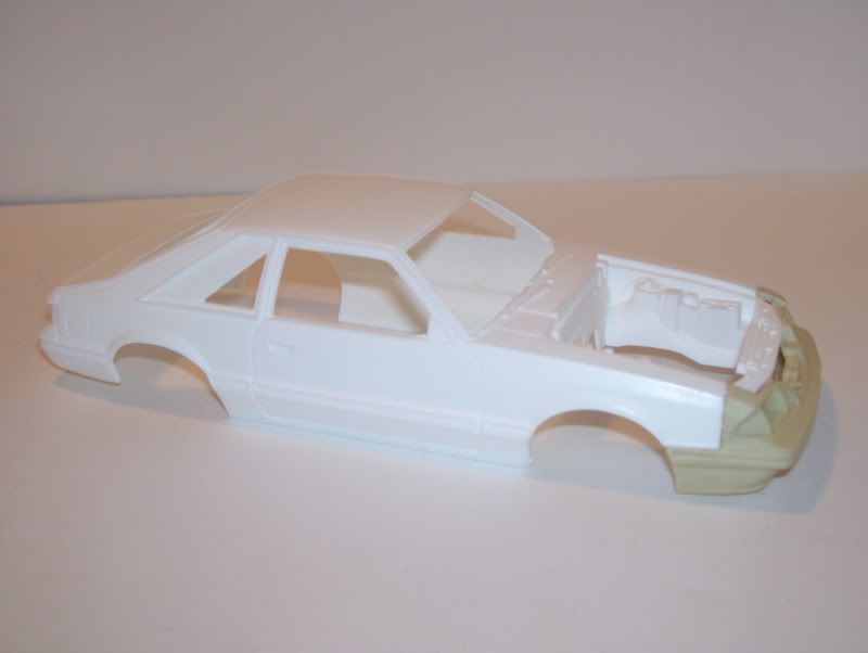

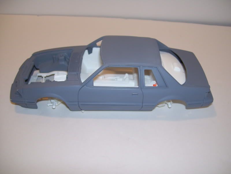

Abell82 Posted October 8, 2011 Author Posted October 8, 2011 (edited) I did a little more work to "Correct" the "Correct-ed" AAM/ AF/X body... corrected the misshapen trunk and tried to add some roundness to the flat roof.. Before: After: Still needs a coat of primer but I think it's coming along. So far I've redone the side trim, made new front and rear bumpers, added the newer engine compartment, added new door handles, and now I've tried to address the trunk, and roof issues. The door window trim is still a wreck, but I may just leave that alone. (for now.) (Can anyone guess what the roof was from originally?) Edited October 8, 2011 by Abell82
whale392 Posted October 9, 2011 Posted October 9, 2011 Looks a lot better than what you started with Jason. I am using a Hatchback roof reshaped for my T-Top Coupe conversion. Talked to Ed yesterday at the Toledo NNL; the kit of the 1991-93 Coupe is AT LEAST 1 year away. It is based on a True Street/Hot Street/10.5 tire car and will have at least the cowl hood, Nitrous and aftermarket intake set-up, and a complete tubular front suspension in addition to the factory stock stuff. Ed also wanted me to understand that while it is in development and test shots are coming, it will not be debuted at IHobby and that it will be able to be believed it is coming when it hits the shelves. He did not want to promise it, as even he said sometimes uncontrollable forces get kits cancelled. He does, however, feel that this one WILL make it to the shelves, as people (namely me) have been buried so far up his tail-end for this that he references the enthusiasm back to the Revell higher-ups.

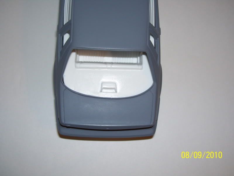

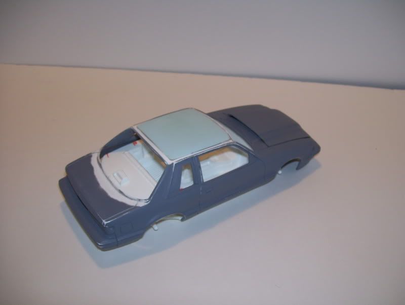

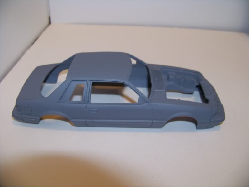

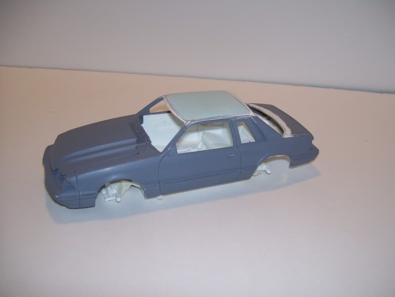

Abell82 Posted October 16, 2011 Author Posted October 16, 2011 (edited) I shot some primer on the "corrected" AAM AF/X body todayhere are some comparison shots... Before: After: It's not a drastic change, and unfortunately the pics down play how much better it really does look. I was limited by the shape of the original roof, and afraid if I went to drastic, I would snap the roof in half. I suppose any improvement is a good improvement... Edited October 16, 2011 by Abell82
Abell82 Posted October 16, 2011 Author Posted October 16, 2011 (edited) Side note: For those watching or reading the thread that prefer the Hatchback body style AF/X resin cast an LX, it had the AAM/AF/X nose grafted to it. Basically it was a 1993 Cobra body with the Side skirts sanded down, and the rear bumper re-shaped. The rear bumper lacked all detail, and the side panels were not trimmed (read shortened). The body did not come with a set of mirrors, interior, or an LX rear spoiler (though it was supposed to include an LX style spoiler, the 2 that this writer bought both included a Saleen style spoiler.) The bodies while not a bad idea or casting, (both of the bodies purchased had COMPLETE engine bays) are not really useful if trying to attempt a stock LX, as the parts not included made the purchase of a 1993 Cobra kit mandatory, and with minor sanding the kit's body could be made to look exactly the same. They therefore provide NO real benefit, unless making a drag car with no mirrors? These bodys looked so bad, with the shorter AAM/AF/X front bumper, that I do not think I took a picture of a stock one. But here is one with a Reliable Resin front bumper cover on it.. The front bumper that they come with: Edited October 17, 2011 by Abell82

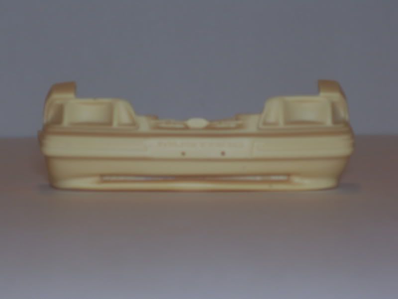

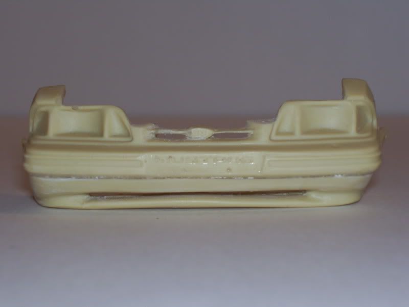

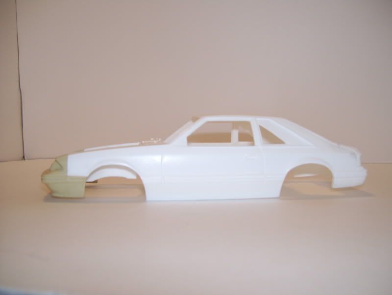

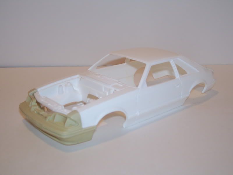

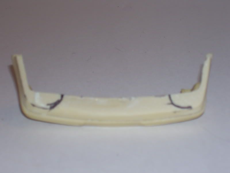

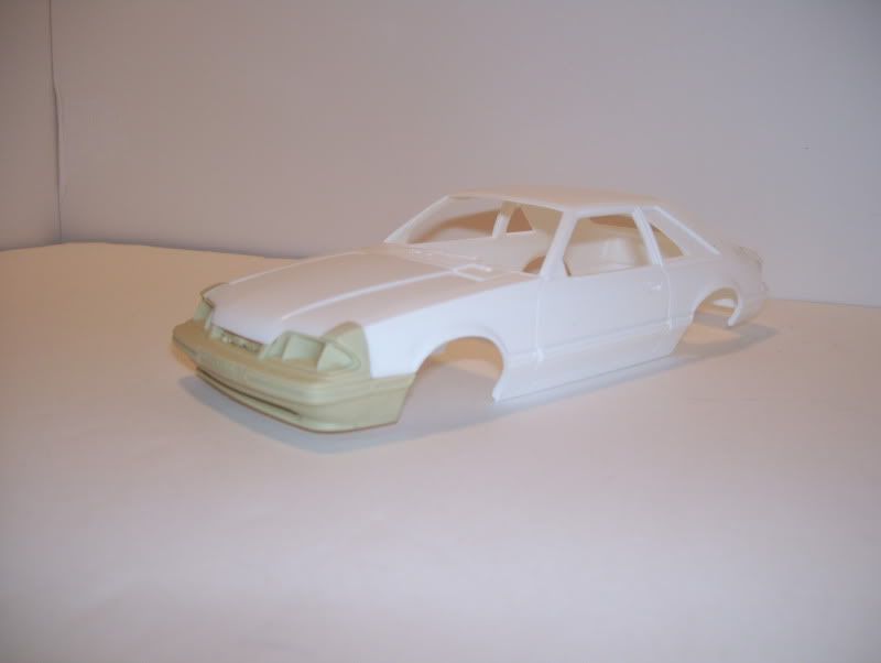

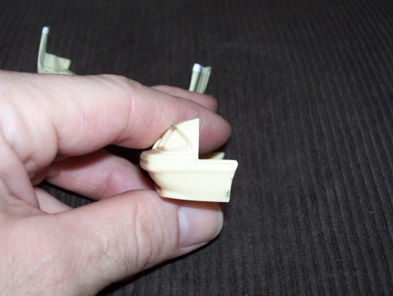

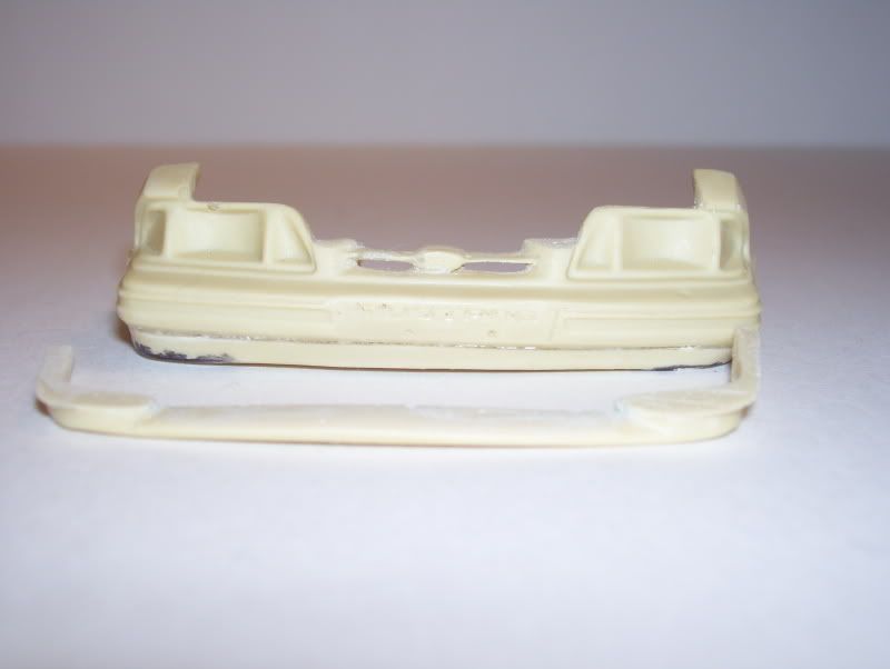

Abell82 Posted November 2, 2011 Author Posted November 2, 2011 With the AAM /AF/X body pretty near corrected I have turned my attention to the Reliable body.... Here is the front bumper once again, notice the overhang, of the belt trim versus bottom of bumper... To correct this, I cut the entire lower portion of the bumper off, I then moved it forward and reattached it... This left quite a gap on the sides that will need filled... More later ...
whale392 Posted November 2, 2011 Posted November 2, 2011 Looks like what I was doing with the GT/SVO hybrid I started, Jason. Then I realized, I suck and don't have the skill to finish it (ok, in all seriousness I am working on a 1987-93 Saleen bumper instead of finishing this venture). I have also modified the SVO bumper to better fit the kit/be more in-scale width-wise. You do good work and subject material for the FOX, Jason. Keep at it! You more than make up for my slack.

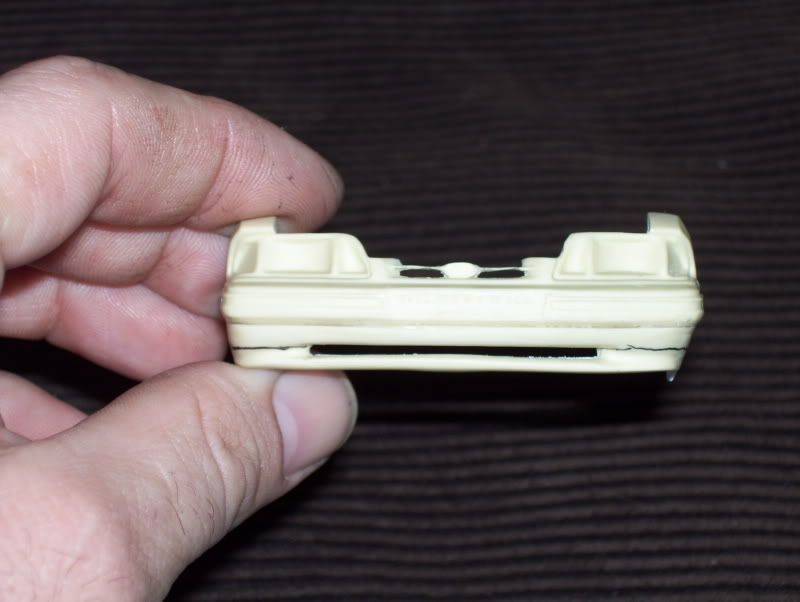

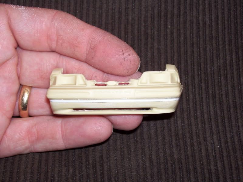

Abell82 Posted November 24, 2011 Author Posted November 24, 2011 So ah,um.... Anyone want to know how to more "Correctly" fix a Reliable Resin front bumper? O.k. so if you've read this far you know that there is something a little off with the RR front bumper, I've shown you a quick fix, to get you into the ball park, but what if that's not good enough? If you're happy with what you have then there is no need to continue... (It's going to get messy!) If there is still something not quite right, and it's bothering you, continue reading ... So we know by now that Reliable Resins front bumper is not "Correct" but how "Incorrect" is it? Let's find out! (I bet by the time we're done, you'll smack your head and say "NOW I see it!") So... O.k. So you have your Reliable Resin Front bumper, maybe you've moved the lower portion forward, maybe you have not ... Well the first step is still to cut the entire lower portion off and move it forward... (here I used the back of a #11 Xacto blade, this left me with a 3mm "band" for the front bumper I did not add styrene to this, even though it shortened the bumper about 1 mm..) here is a pic of the bumper ca glued back together... *(interesting to note that it also appears to be biting it's lower lip? Though maybe it's just pouting...) Pretty standard so far right? Well, here is where things get messy... I hinted to this earlier by posting a pic, I was sure would get at least one question, but no one noticed, (or maybe no one cared?!) In any event... The black line is where the second cut will need to be made.... This is NOT for the squeemish, or those that are not comfortable with thier modeling abilities. If you are not comfortable, just do the first procedure, and leave it at that. If you are sure of your abilities please continue.... (When cutting this second cut please leave a little material so that you can tell where things go back to...) Are you still with me? O.K. then the second cut('s) are made you should have something like this... Again be sure that you leave a little material so that you can tell where things go back together... Here you can see I outlined there ares in question with black permanent marker. This IS IMPORTANT!! You need to do this now as well... (continued...)
