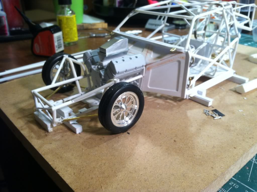

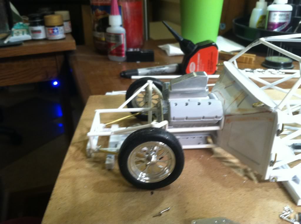

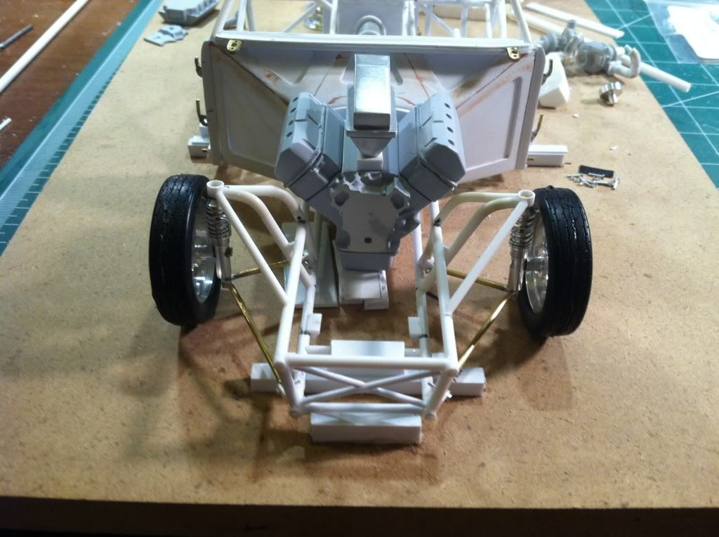

Prostreet Posted May 16, 2012 Author Share Posted May 16, 2012 Finished the front strut mount tonight and set the upper part of the intake on the engine for a visual, It may have to sit a little lower so i don't have to cut the hood. Plan on doing the motor plate tomorrow after work. Quote Link to comment Share on other sites More sharing options...

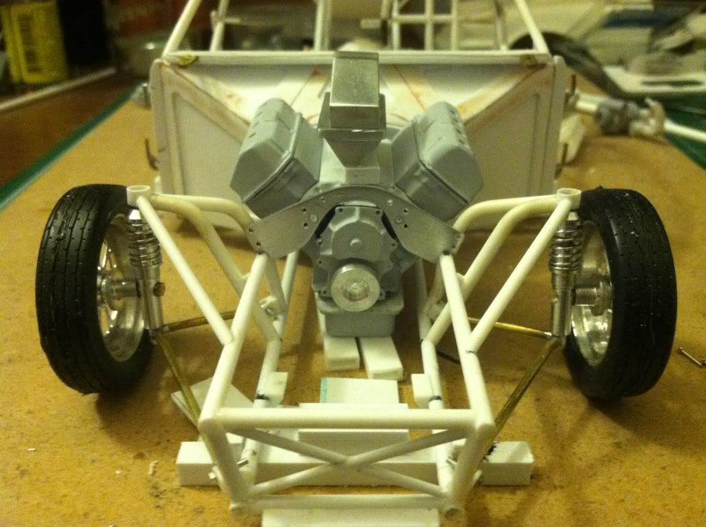

Prostreet Posted May 19, 2012 Author Share Posted May 19, 2012 Thx. Guys, staying with the turbos no worries. After a couple failed attempts i have the motor plate done, The white you see between the center bolt holes is styrene rod i used to hold the plate to the block and make it strong. I will touch them up with some aluminum paint unless i paint the whole plate, All the other holes will get RB motion hardware. This evening i will get the bench cleaned up and start on new headers and with any luck will have some updates. Need some opinions on the upper intake, Does it look to small for the engine? looking for some opinions. Quote Link to comment Share on other sites More sharing options...
Romell R Posted May 19, 2012 Share Posted May 19, 2012 I think it looks just right if ya ask me..... Quote Link to comment Share on other sites More sharing options...
blackbeard Posted May 19, 2012 Share Posted May 19, 2012 I agree with rom it look just right with me 2 Quote Link to comment Share on other sites More sharing options...
ClayK Posted May 19, 2012 Share Posted May 19, 2012 Engine plate looks great Joe. Glad to see you still banging away on this one. The reworked front end looks really good too. Keep after it! Clay Quote Link to comment Share on other sites More sharing options...
vintagedragfan Posted May 19, 2012 Share Posted May 19, 2012 I think it looks right to me, maybe appears small because there are no huge inlets on it yet, that will change the whole appearance for sure, might mock somthin up real quick before you go to the trouble of makin a diffrent one Joe, oh yea the moter plate looks fantastic! Quote Link to comment Share on other sites More sharing options...
comp1839 Posted May 19, 2012 Share Posted May 19, 2012 hey joe, this project always looks good to me. the motor plate is lookin' good. the intake plenum and the upper intake both look narrow to me. the runners are probably only 4-5 inches long. you should also be deciding on 1 or 2 injectors and if you use 2 injectors whether they (the injectors) will be mounted parallel or perpendicular to the runner center line. so scale your runner length and lower plenum accordingly. the upper looks narrow too. if your using 2 throttle bodies horizontally mounted (which i thought was your original plan). you might want to consider those into the total width before making your top. Quote Link to comment Share on other sites More sharing options...
Prostreet Posted May 19, 2012 Author Share Posted May 19, 2012 Thx. for the feedback guys, I planned on 1 throttle body and 1 set of injectors. Gonna get back on the headers and get that sorted out first then make a bit larger top. Quote Link to comment Share on other sites More sharing options...

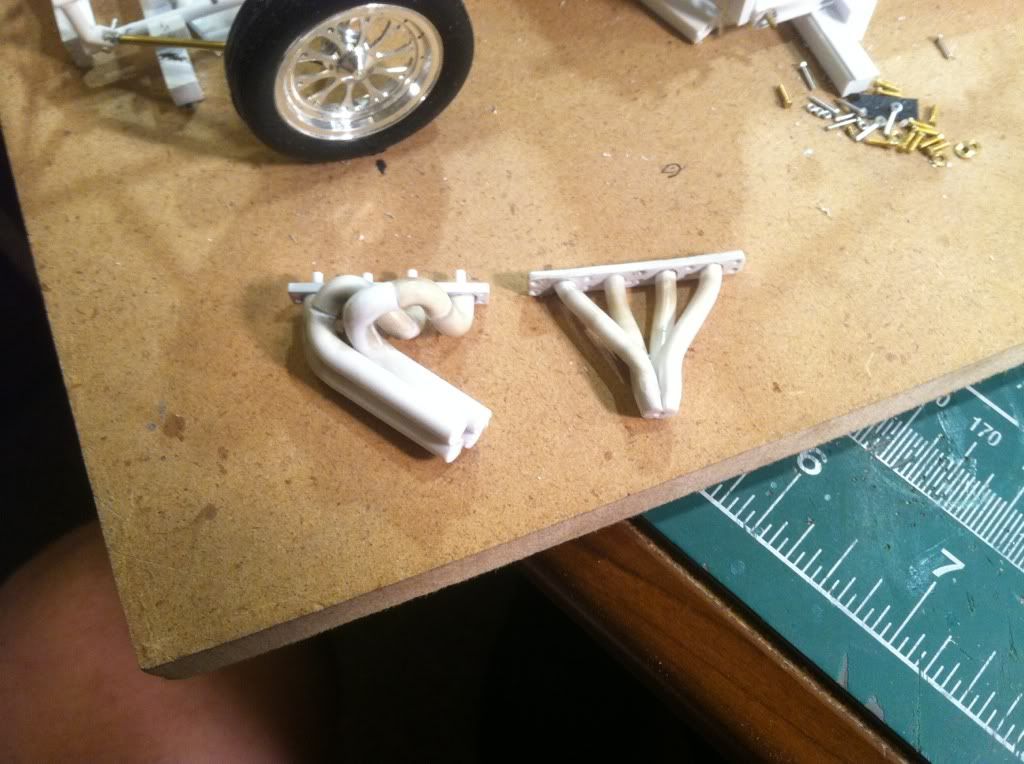

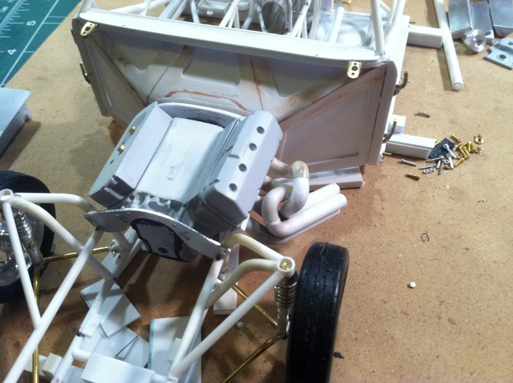

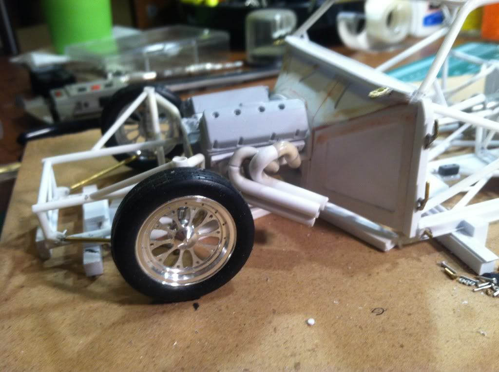

Prostreet Posted May 23, 2012 Author Share Posted May 23, 2012 Thx. Bart, I have 1 header complete to the point of doing the collector. Once i get my order from plastruct i can start on the collector, I have a couple ideas how to do them, will see how that turns out. Going to start on the other header tommarrow, Let me know what you think so far. The 2 front cylinders are 1 piece, the back two are 4 pieces each. I made some 90 deg. bends and tried to build them like you would real headers, I wanna try to add some weld to them also with either putty or some photoetched weld strips. The joints still need some finishing and the collector are will be cut back some. I built them out of 5/32" rod, The last picture you can see the comparison to my plain looking 1/8" headers i originally made. Quote Link to comment Share on other sites More sharing options...
comp1839 Posted May 23, 2012 Share Posted May 23, 2012 they're right!.......size is everything! looks great joe. your efforts are paying off bg time! Quote Link to comment Share on other sites More sharing options...
ClayK Posted May 23, 2012 Share Posted May 23, 2012 Those look really good Joe. You're on the right track for sure.... Quote Link to comment Share on other sites More sharing options...
