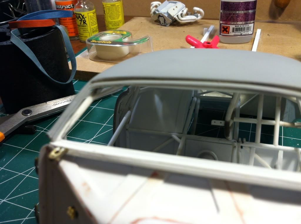

Prostreet Posted May 31, 2012 Author Share Posted May 31, 2012 Thx. Guys, Couple of pictures of the exhaust outlet. When finished it will have a carbon trim ring around the outlet, I'm getting very close to being able to paint the chassis. So before i do that i wanna do all the door gaps next and get it out of the way then i can paint the chassis and get started on the intake. Quote Link to comment Share on other sites More sharing options...

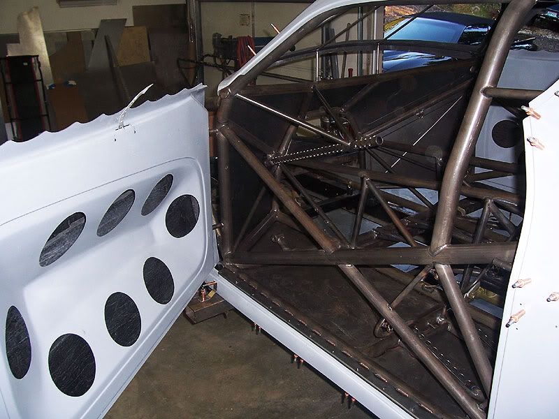

Prostreet Posted June 9, 2012 Author Share Posted June 9, 2012 Hey guys, I'm looking for some pictures of door panels preferably on a 57 chevy promod but any will do, Been searching all over with no luck. Not sure why i can't find any. Trying to figure out how to do my door panels. Quote Link to comment Share on other sites More sharing options...
1320wayne Posted June 9, 2012 Share Posted June 9, 2012 Not neccessarily 57 Chevy but they should help. Quote Link to comment Share on other sites More sharing options...
eviltwincustoms Posted June 9, 2012 Share Posted June 9, 2012 (edited) Here you go Joe.... serving up one 57 Chevy Drivers side door panel! Of course this one is far from finished, so not sure if this door will do much for you. Edited June 9, 2012 by eviltwincustoms Quote Link to comment Share on other sites More sharing options...

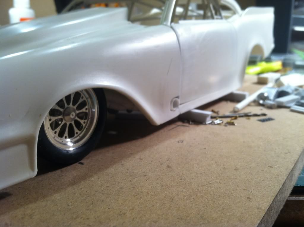

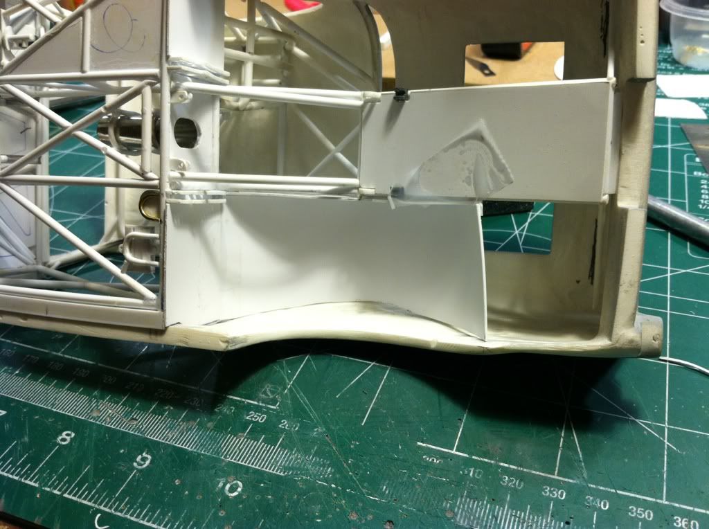

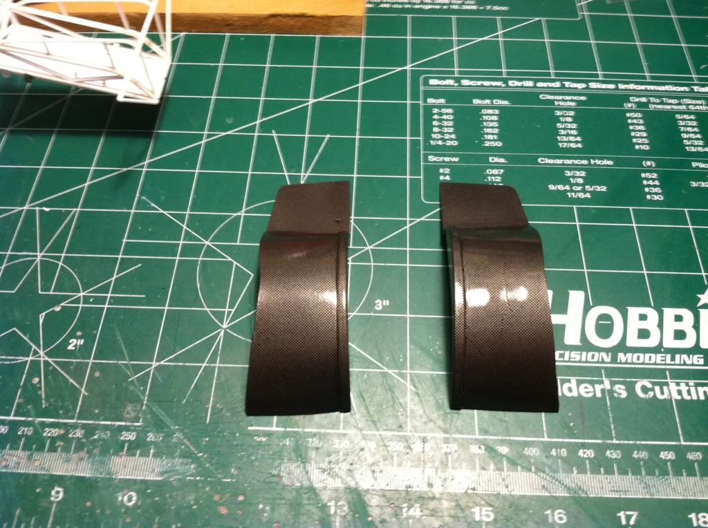

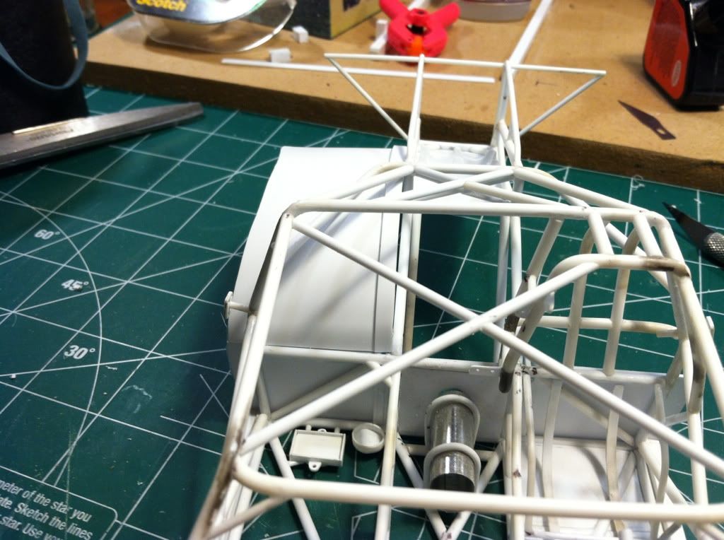

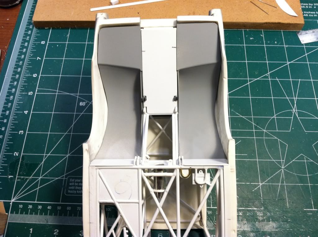

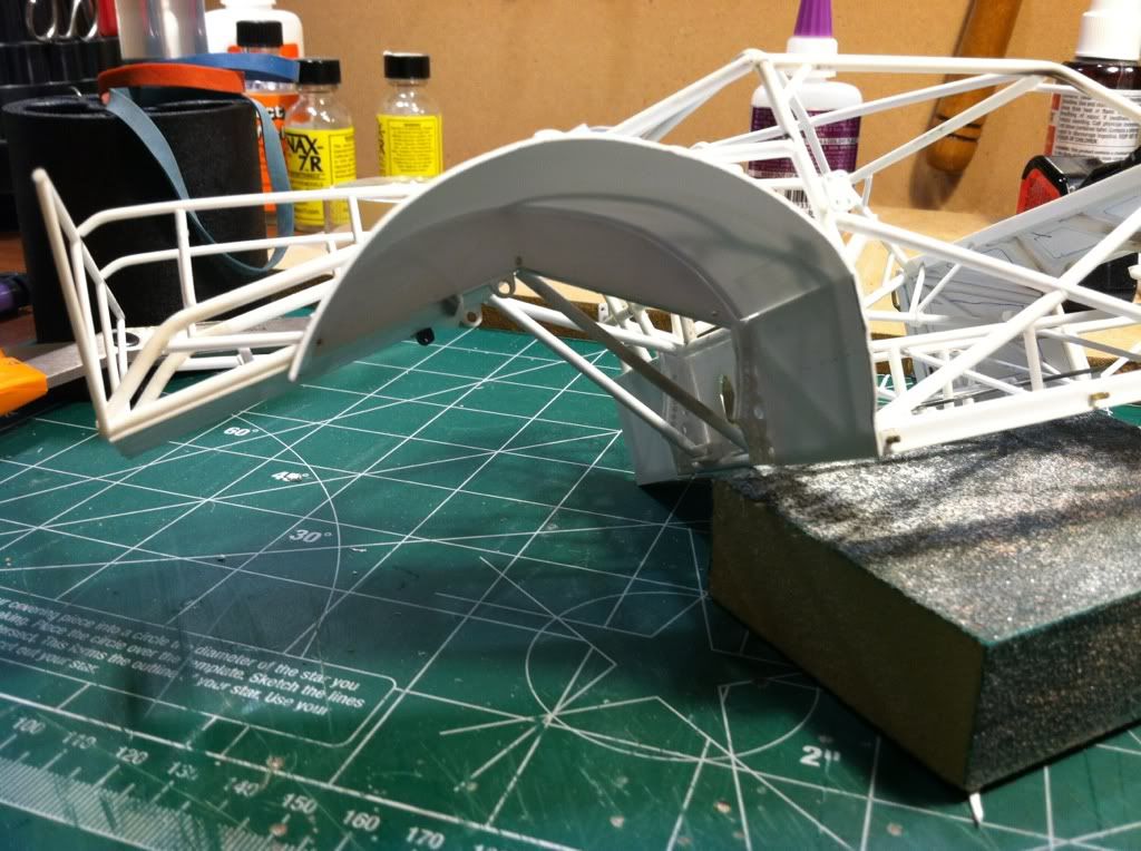

Prostreet Posted July 23, 2012 Author Share Posted July 23, 2012 I have been working on this here and there when i have some free time, Been mostly doing body work and getting the door and front end lines good. Nothing worth really posting, I had some free time tonight and started on the wheel tubs, I wanted to get these done before i prime and paint the chassis. i have one roughed in and still need to add the back filler panel, I wanna make that part of the tub. They will be painted matte black and the tops will be done in carbon. I added pins to the chassis in 3 spots to make it easier to locate the tubs to the chassis for fitting and final assembly. Quote Link to comment Share on other sites More sharing options...

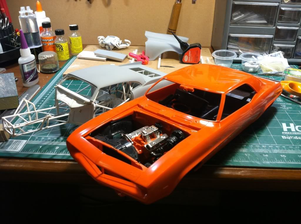

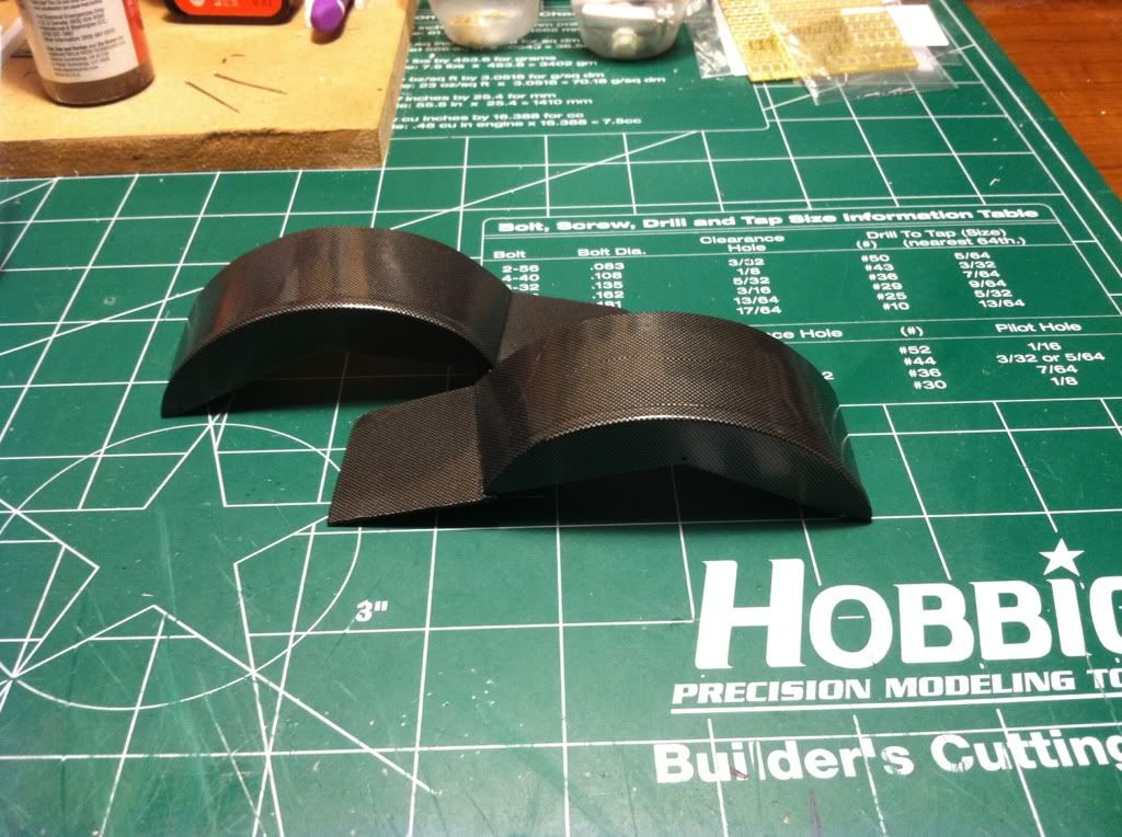

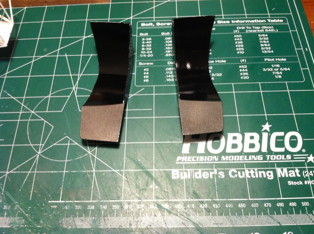

Prostreet Posted July 30, 2012 Author Share Posted July 30, 2012 Thx. Guys, I have the tubs complete, after there installed permanently i will add a little filler piece in the back center near the bumper. After work tommarow i hope to paint them flat black and add the carbon decals then get some clear on them. Also added a picture of my next project that i'm excited about, 1/12th Drag radial camaro, will be a big block with either a single turbo or gear driven procharger. I was talking to Ted (Ted's modeling ) and he contacted Tim a TDR and Tim drew up some really great looking M/T Drag radials, Just waiting for them to be ready so i can purchase some. Quote Link to comment Share on other sites More sharing options...
Prostreet Posted August 3, 2012 Author Share Posted August 3, 2012 Wheel tubs are done, They were quite an adventure to get decals on and didn't turn out perfect, But for my first time doing carbon decals i think they turned out decent. There are couple small wrinkles in the one on the right and the black spot on the back of the one on the left somehow got scratched and didn't notice it till i started clearing them. I used scale motorsports decals and Model masters clear lacquer. Once the body is installed you can barely see much of the tubs, once they cure for a couple days they will get a light polish and the under side where the tire sits will get a dull coat. Hope to have some more updates tonight possibly. Quote Link to comment Share on other sites More sharing options...
