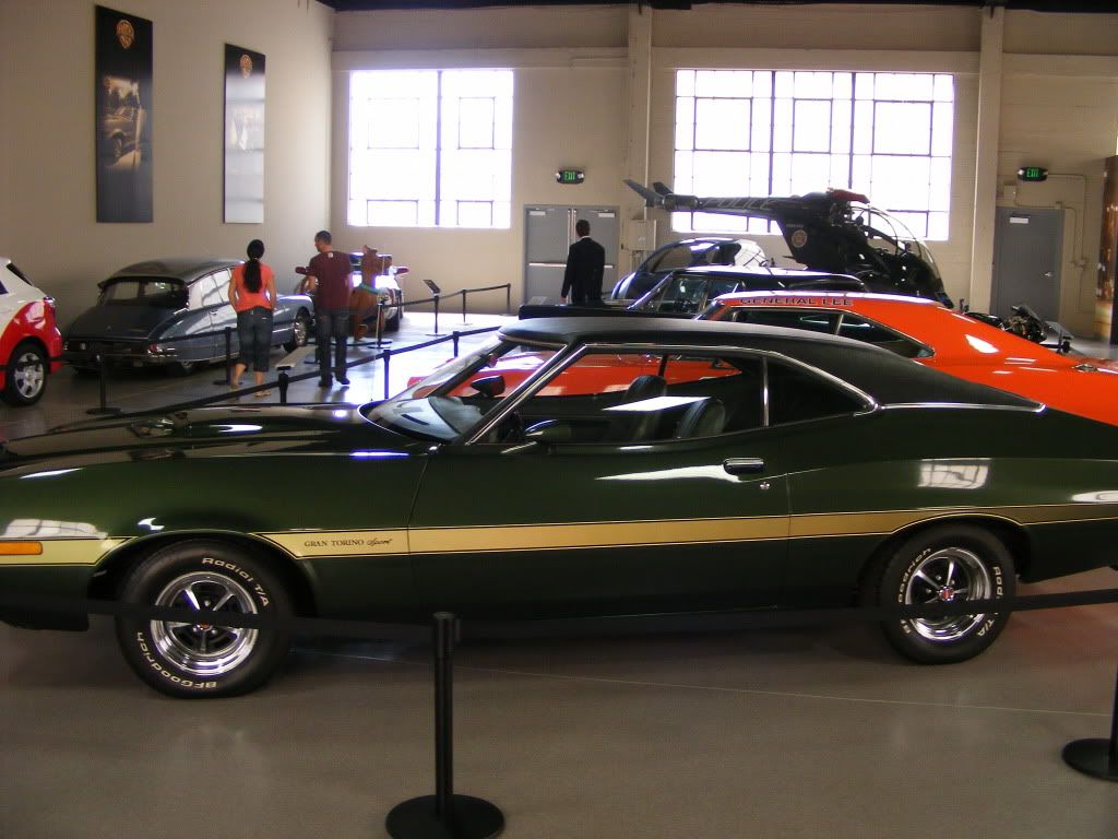

highway Posted October 16, 2011 Posted October 16, 2011 Here's a couple pics that might help on interior color, they're the best I could find to try to help.

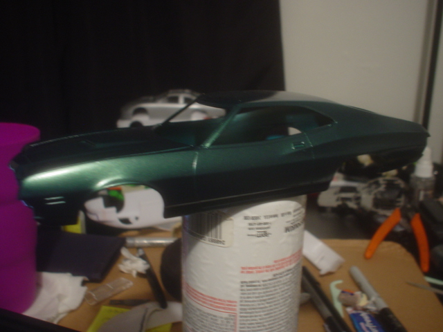

bigryan18 Posted May 24, 2012 Posted May 24, 2012 I'm currently building the same car and a good match for the paint is Dupli-Color Amazon green metalic and the wheels you can find on ebay,they are resin cast...

MAGNUM4342 Posted May 24, 2012 Posted May 24, 2012 (edited) I'm currently building the same car and a good match for the paint is Dupli-Color Amazon green metalic and the wheels you can find on ebay,they are resin cast... Pardon me, but those wheels look nothing like what's on the car. Edited May 24, 2012 by MAGNUM4342

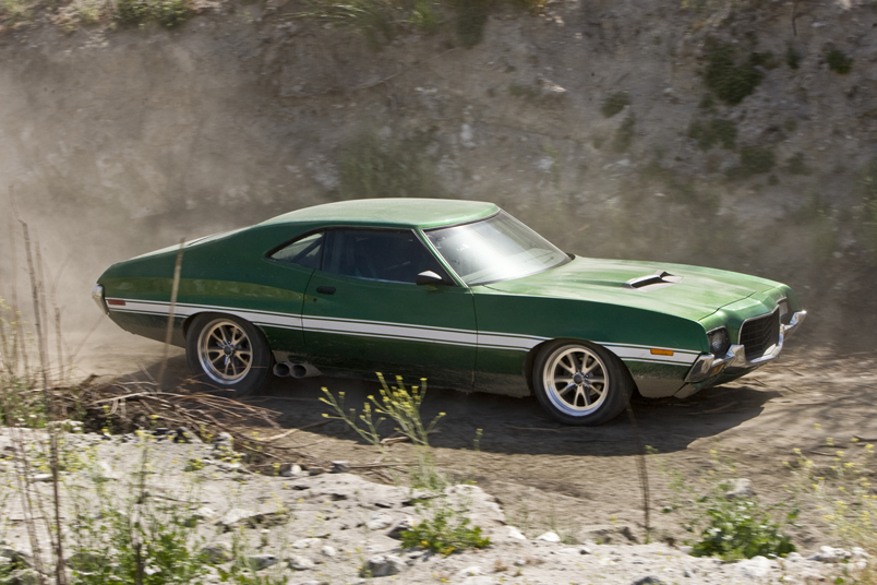

Jordan White Posted May 24, 2012 Posted May 24, 2012 Pardon me, but those wheels look nothing like what's on the car. I think he's actually building the car from Fast & Furious.
The70judgeman Posted May 24, 2012 Posted May 24, 2012 (edited) I think he's actually building the car from Fast & Furious. Actually I think its the one from the movie Grand Torino. They mentioned the Magnum 500 rims. Movie screen shot. Edited May 24, 2012 by The70judgeman
bigryan18 Posted May 25, 2012 Posted May 25, 2012 My bad,I thought the original poster was building the Torino from the Fast & Furious movie which is what I'm building...
The70judgeman Posted May 25, 2012 Posted May 25, 2012 Built either way...what about the Laser Stripes? Haven't seen decals for them. They might be kind of hard to find. I suppose they could be masked and airbrushed and cleared with a reflective clear to get somewhat of the effect of the real stripes.Fast & Furious screen shot.
