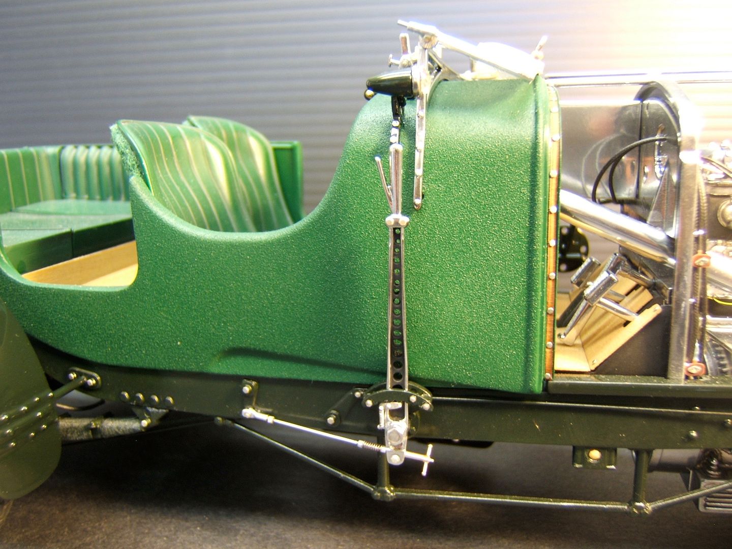

Reeves Racing Posted December 29, 2011 Posted December 29, 2011 The main body of the car is covered in canvas, hence the textured finish... Ah ha! I did miss that tid bit. What was the reasoning behind that? By the way... John, this belongs in a museum. Thanks so much for sharing your talent with us.
sjordan2 Posted December 29, 2011 Posted December 29, 2011 Ah ha! I did miss that tid bit. What was the reasoning behind that? By the way... John, this belongs in a museum. Thanks so much for sharing your talent with us. Many cars of the time had fabric-covered bodies, applied to wooden framing, that were so heavily painted that you'd never suspect they weren't metal. Here's why: "The fabric-covered body concept patented by Charles T. Weymann revolves around the idea that bodies based on aircraft design procedures in which the body panels are layered with a thick padding followed by a top layer of lacquered fabric are lighter, quieter and safer than a conventional metal-based bodies. Weymann promoted the notions that his sedan bodies weighed about half as much as conventional sedan bodies. Passengers experienced less noise due to the manner in which the thin ash framework is built; the wood pieces are joined together by metal bracketry with gaps between them. They never touch and never squeak. Plus, the thick buildup of materials insulated the passenger compartment from road noise. Roads, at the time, were far from smooth. Also pitched was the idea that a fabric-covered body being lighter than a similar metal-bodied one has a lower center of gravity and, thus, is less likely to roll over in an accident."
Reeves Racing Posted December 29, 2011 Posted December 29, 2011 Okay... so it was like the fiberglass racecar of it's day...

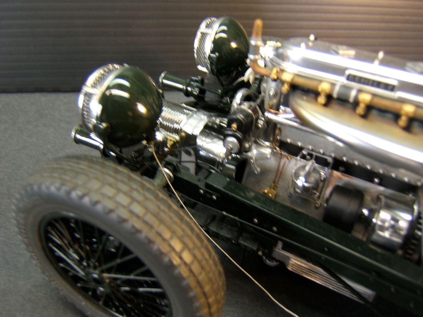

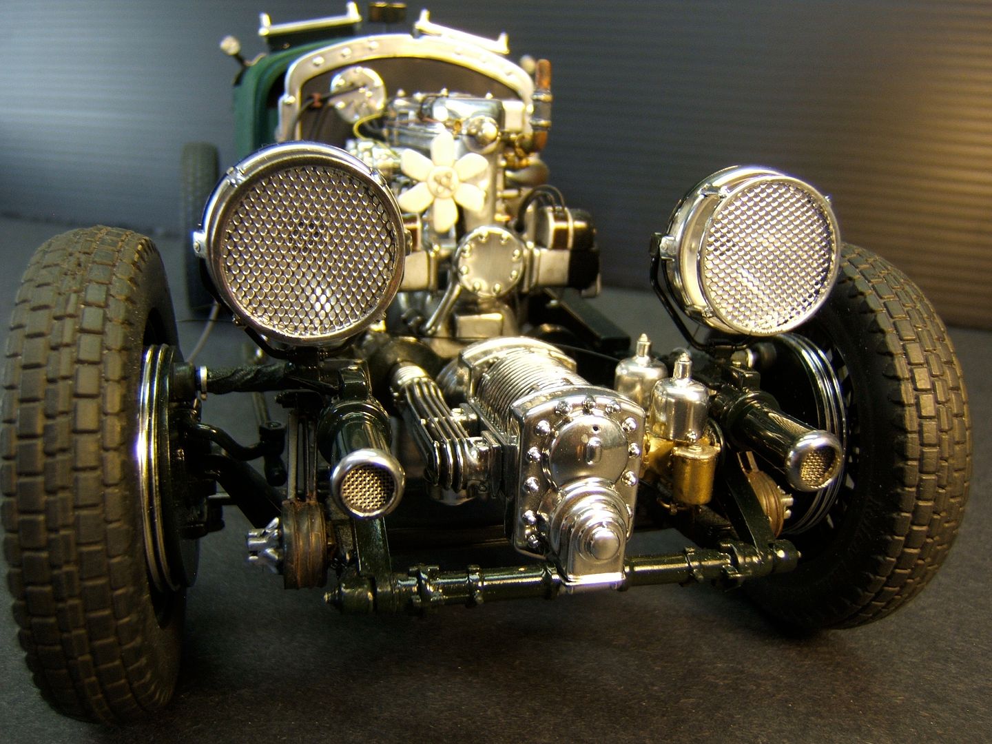

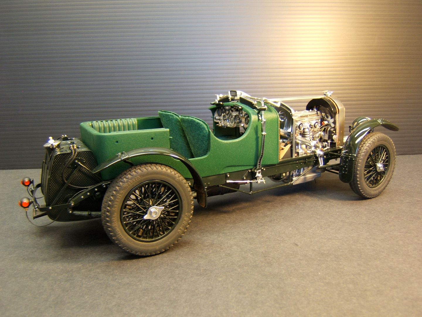

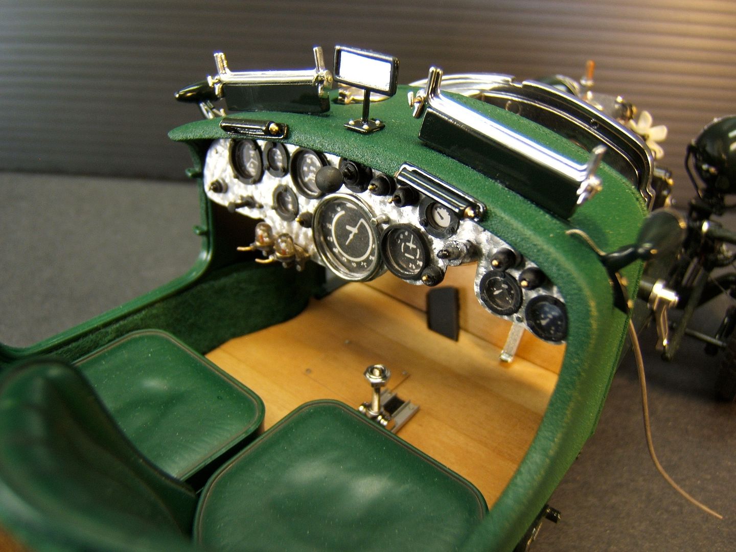

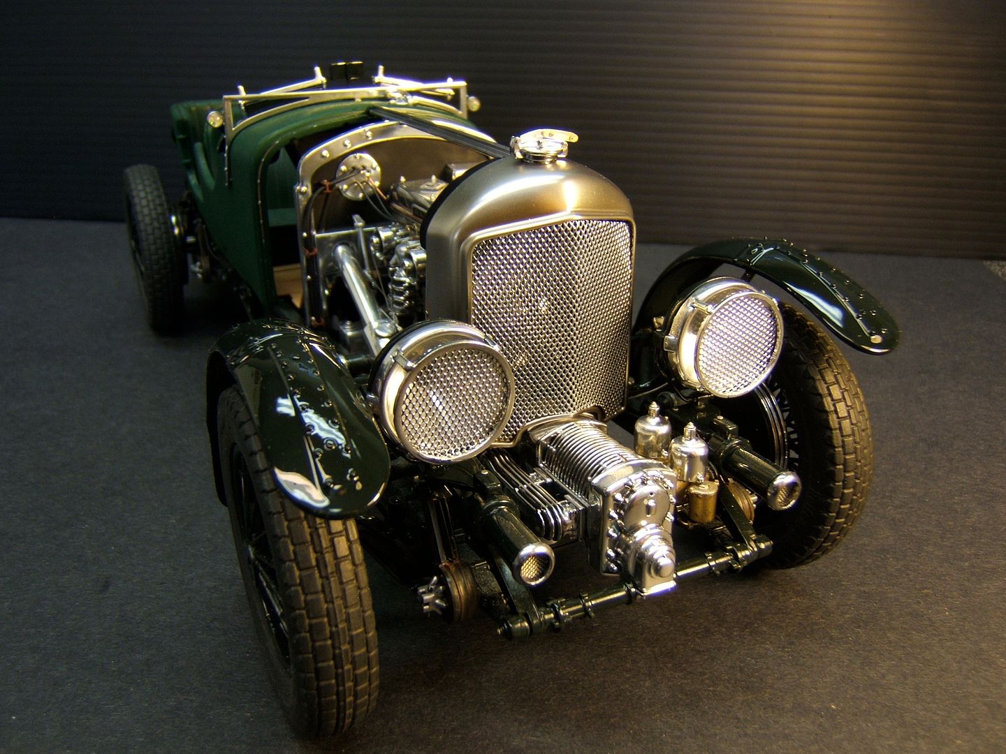

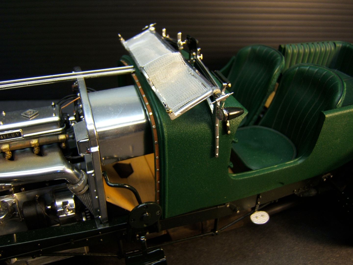

John Teresi Posted December 29, 2011 Author Posted December 29, 2011 Hello......thank you all for the kind comments.......I assembled the horns and headlights.......headlights have bulbs inside them.......I attached the scratch built mirror and map lights.......modified windshields and attached the running lights.....body and fenders are painted and clear coated......I will attach them and the radiator tomorrow........thanks for looking. few more progress photos.......thanks. 1

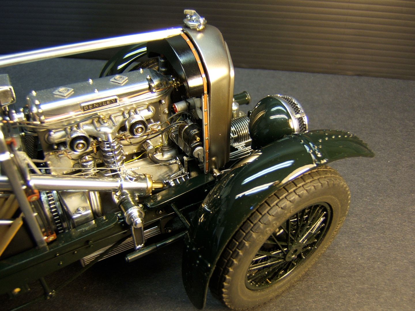

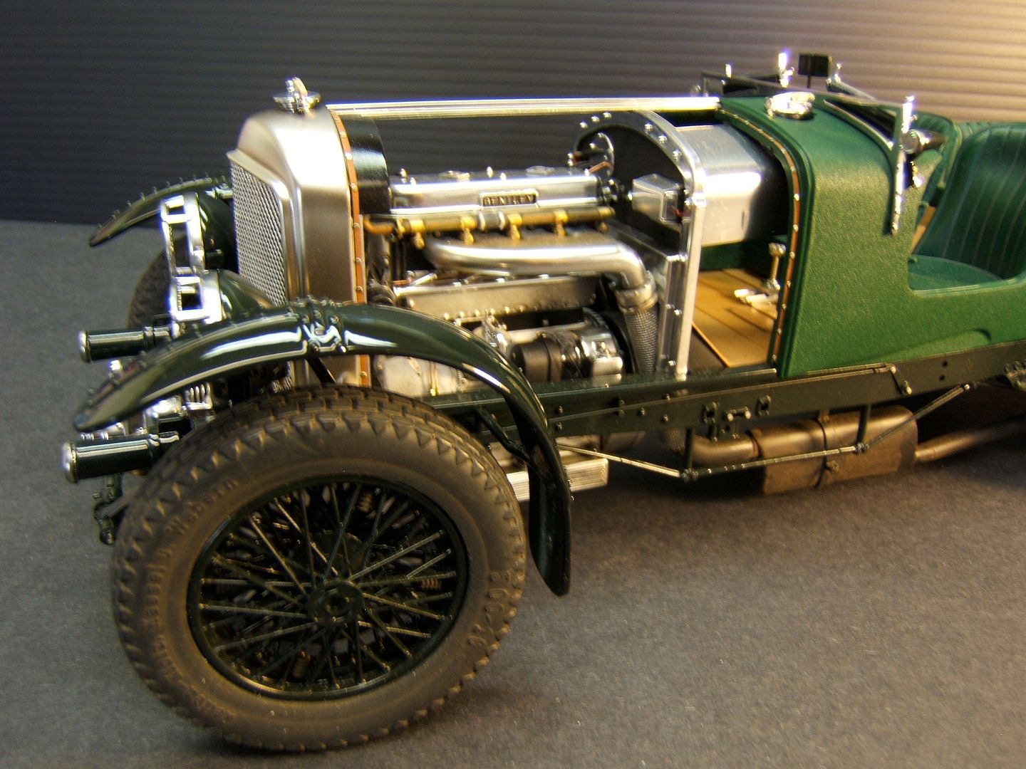

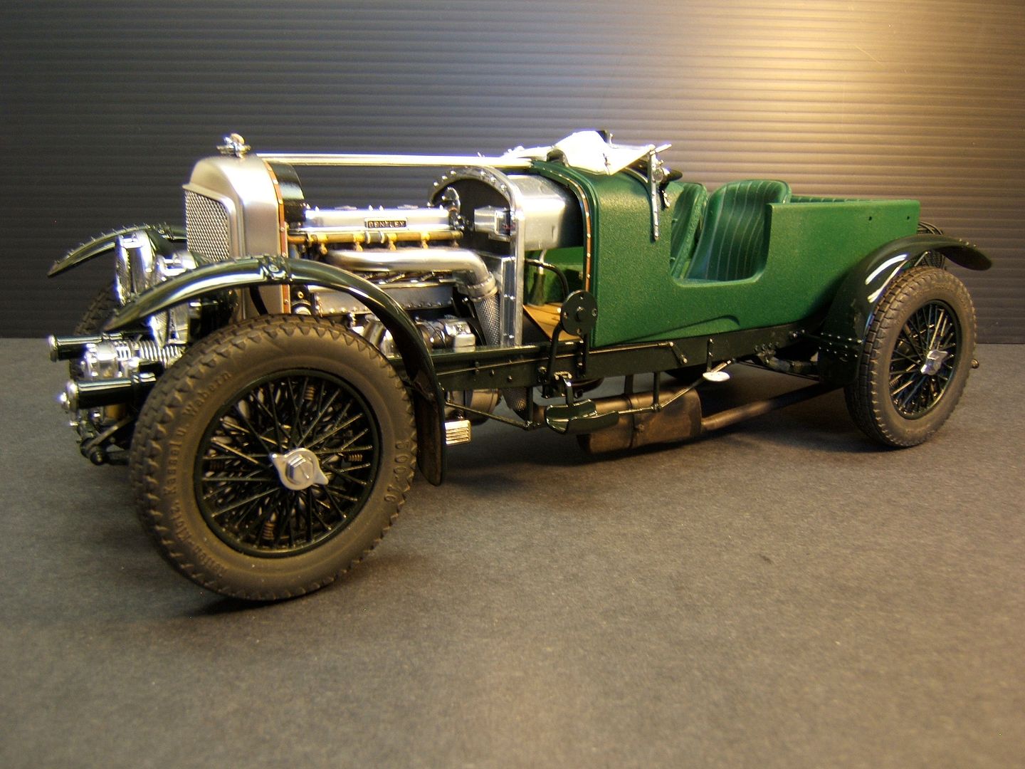

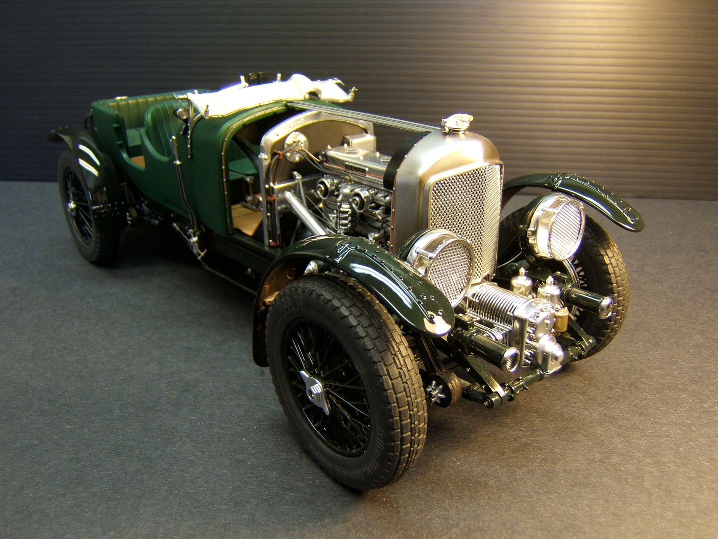

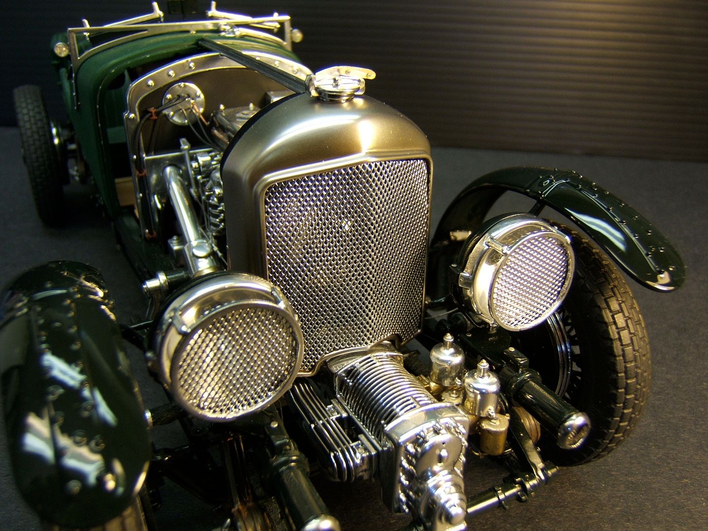

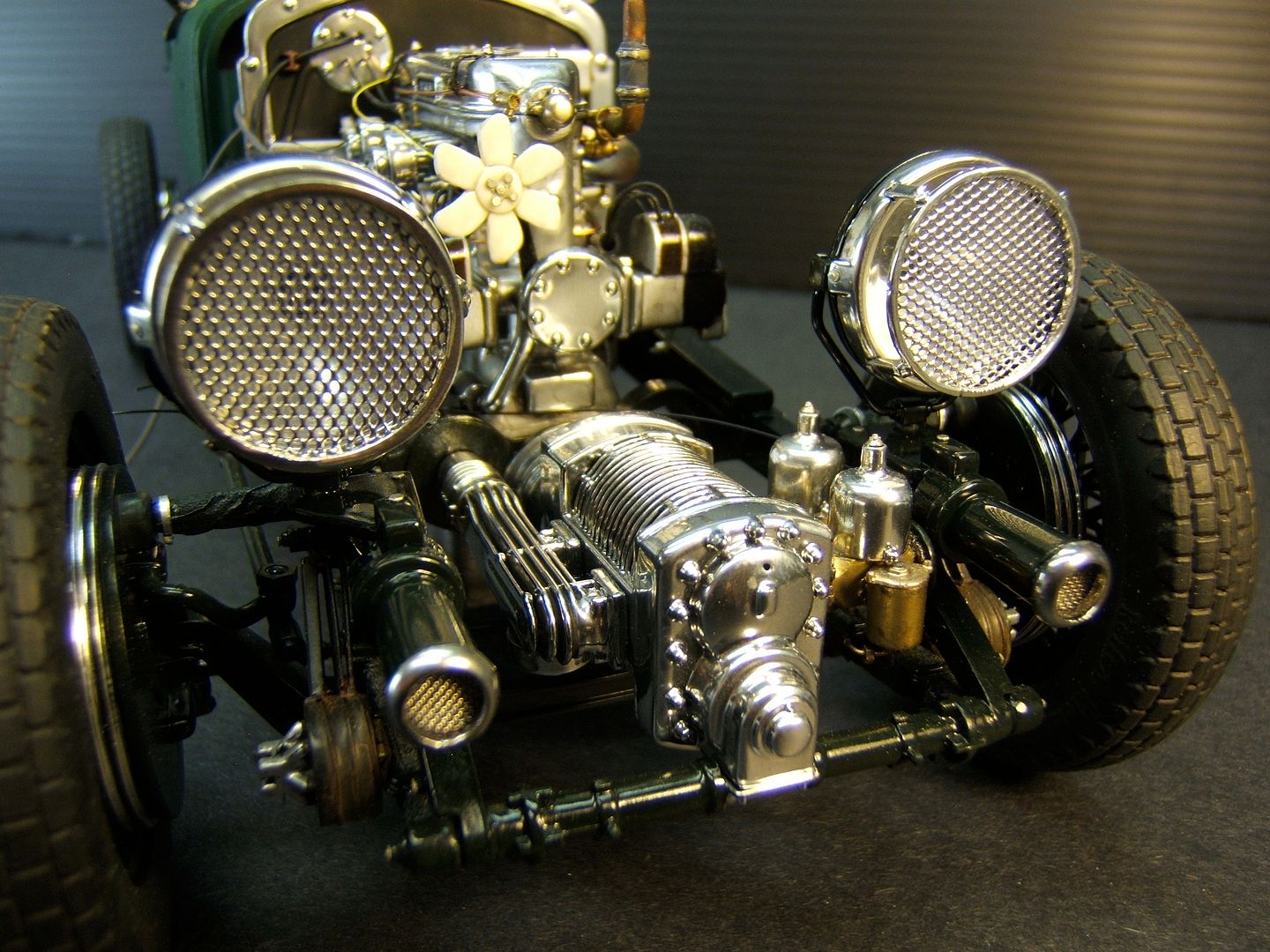

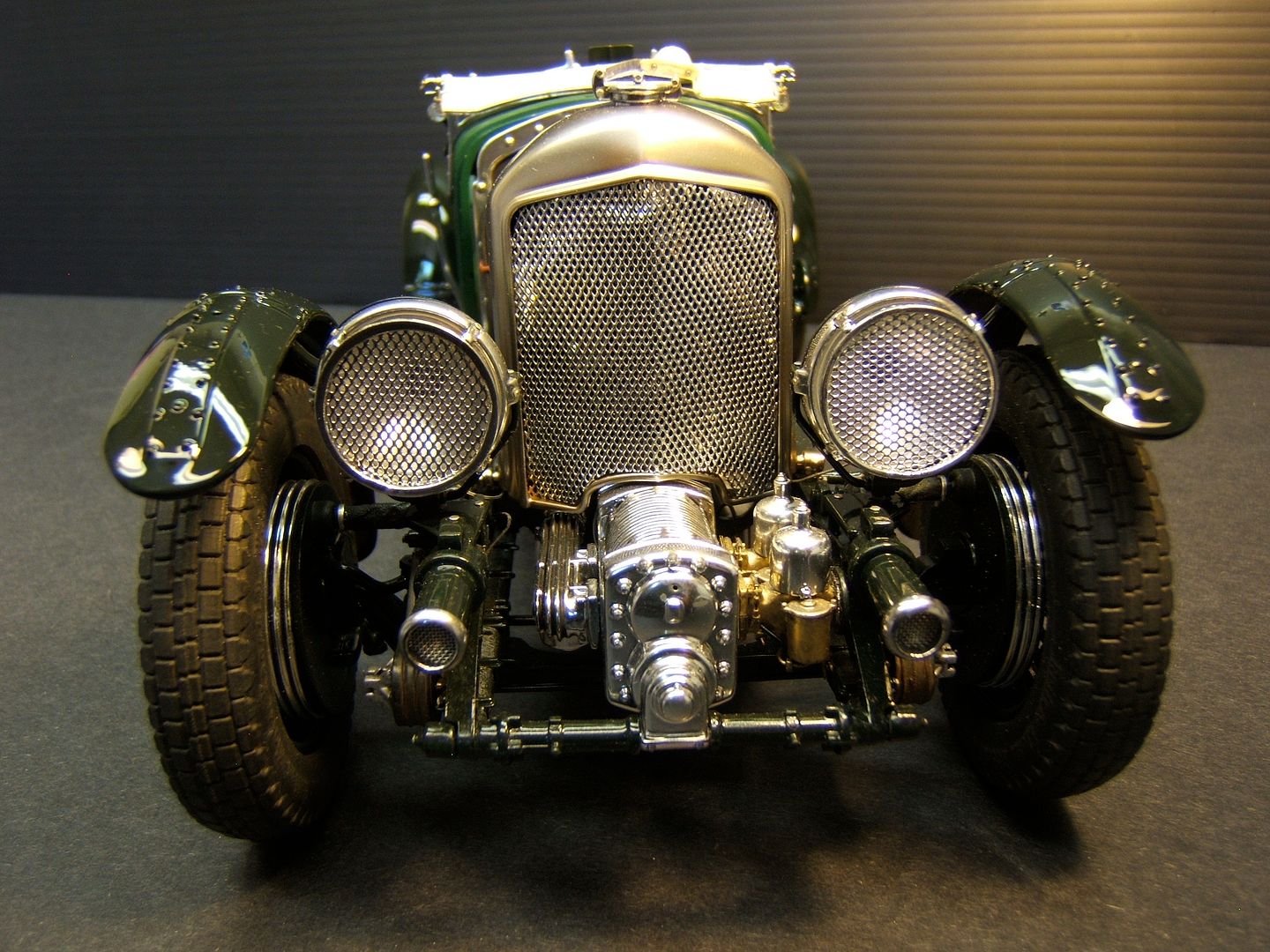

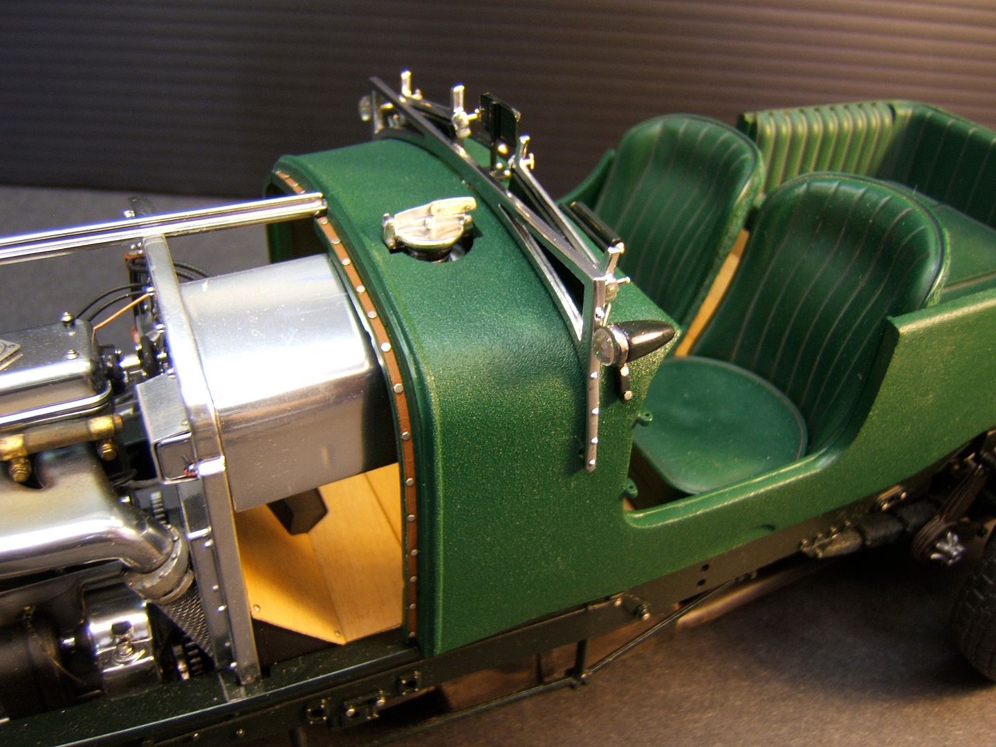

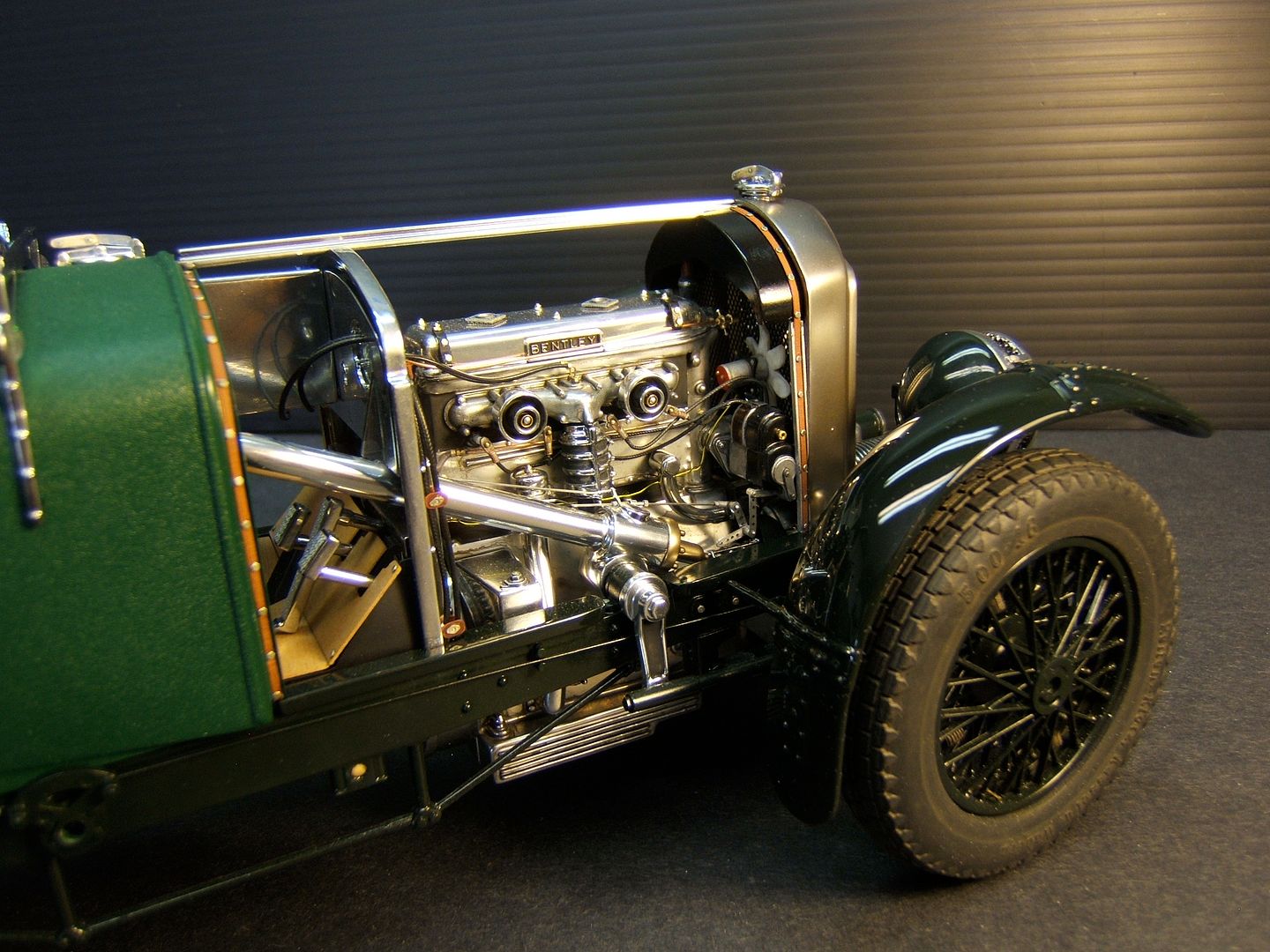

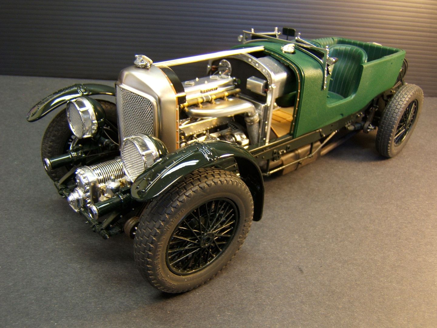

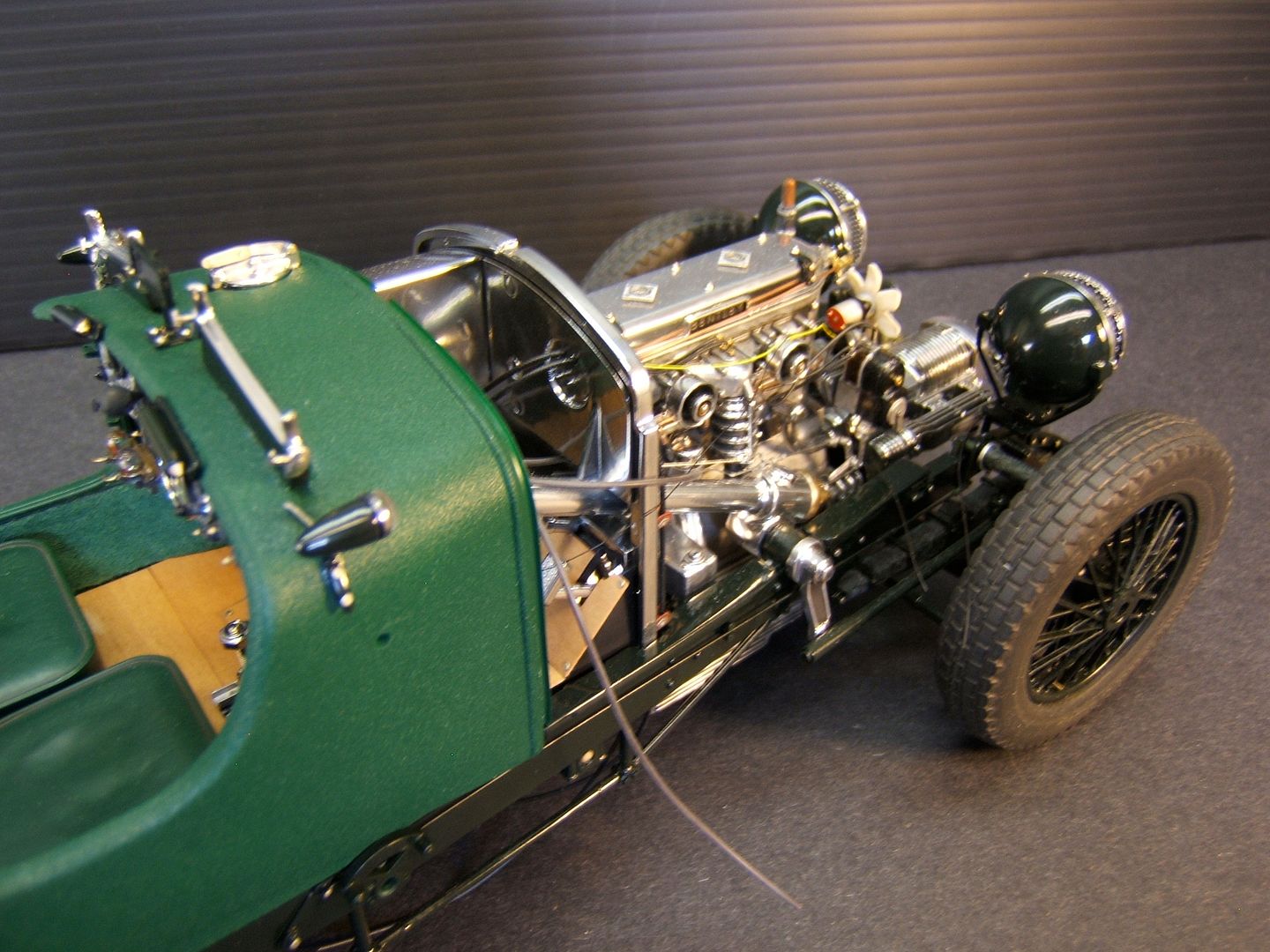

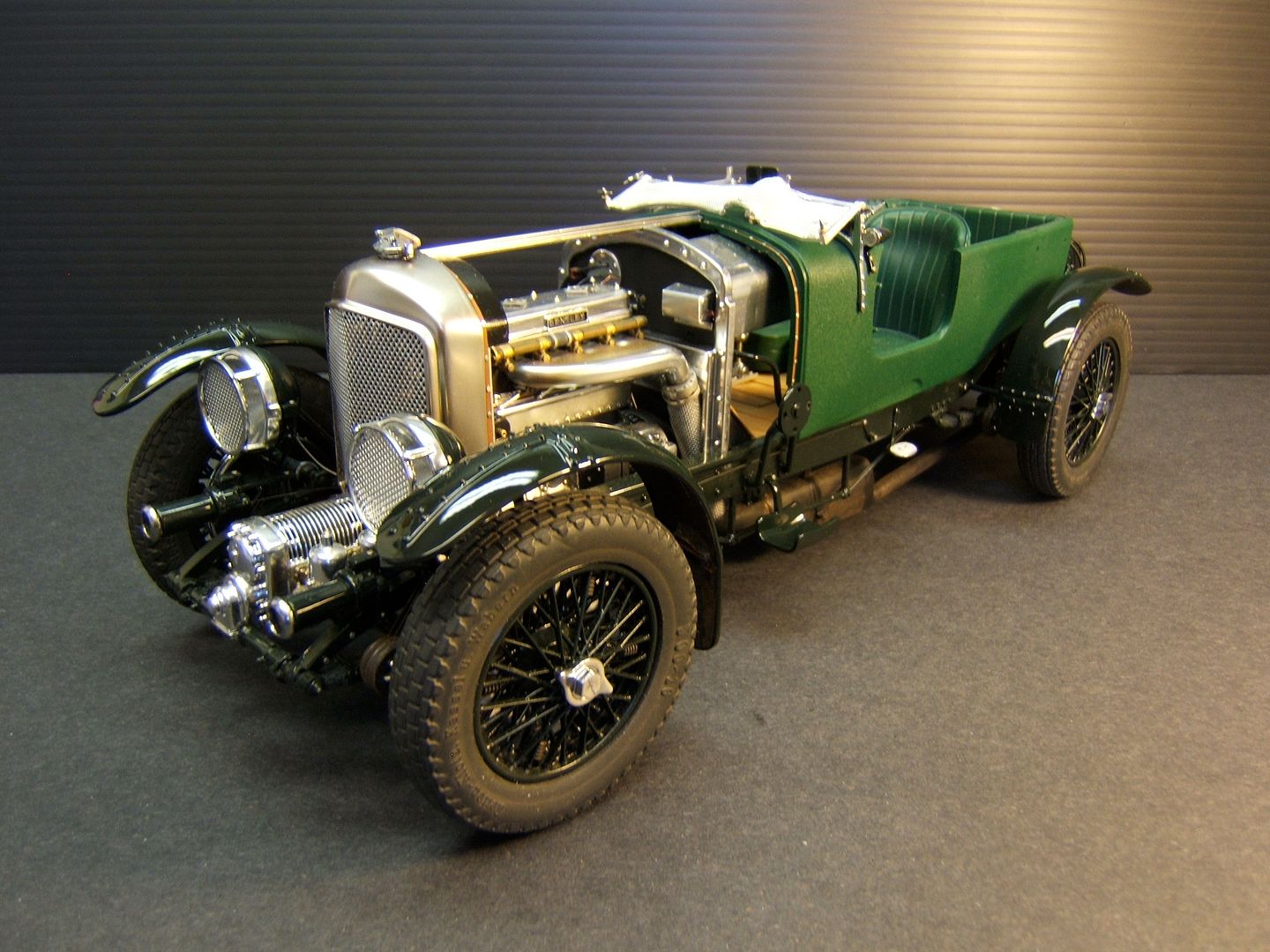

John Teresi Posted December 30, 2011 Author Posted December 30, 2011 Hello......thank you all for your kind comments........I attached the radiator grill and some leather padding around the engine bay.......front fenders are on I added rivets and bolts to all 4 fenders.......gas and water caps are on.......thanks for looking.
John Teresi Posted December 30, 2011 Author Posted December 30, 2011 few more progress photos.......thanks.

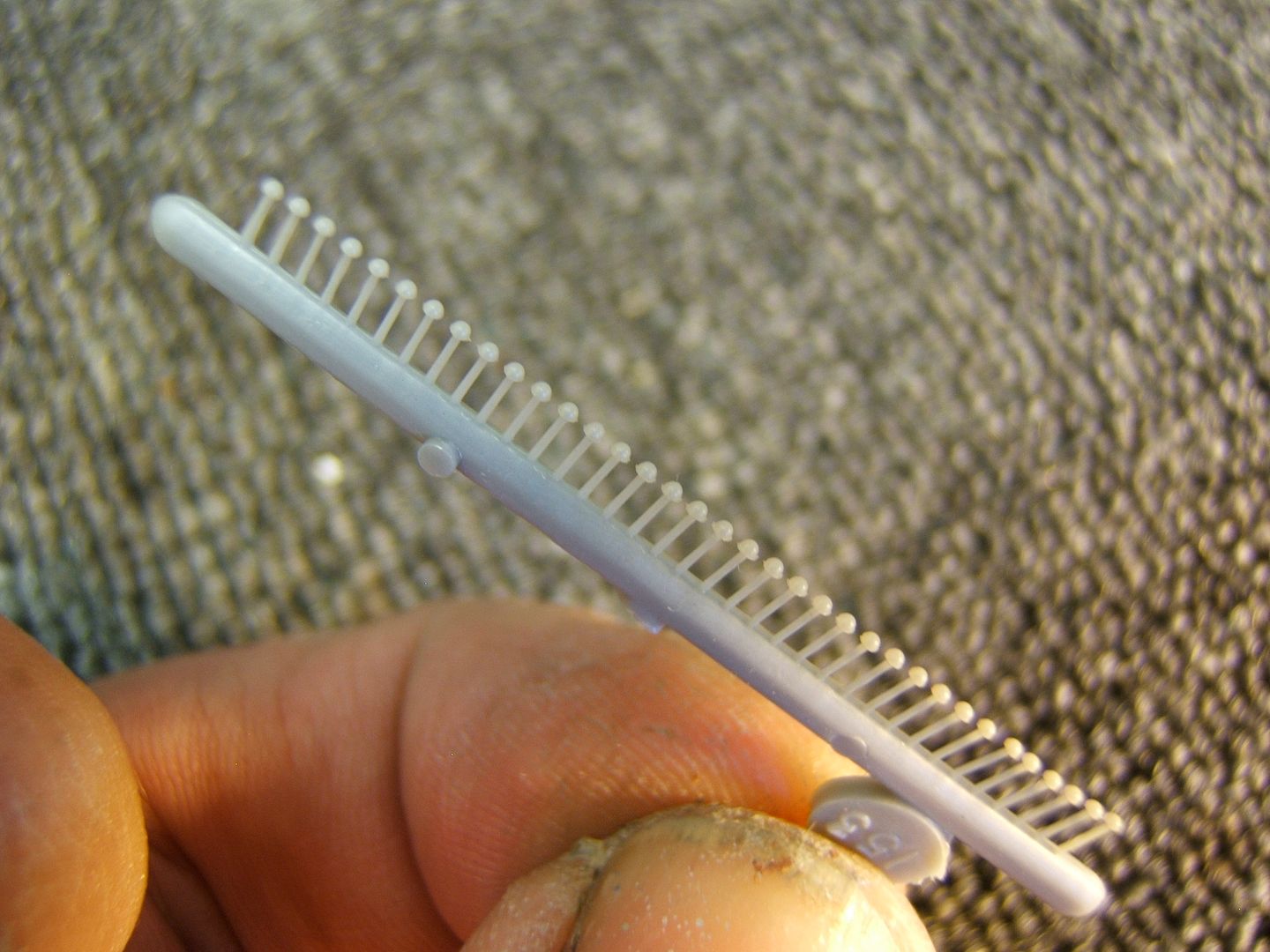

Harry P. Posted December 30, 2011 Posted December 30, 2011 How did you make the rivets on the fenders?
sjordan2 Posted December 30, 2011 Posted December 30, 2011 (edited) The mesh work is astounding, and this may be the only vintage car plastic kit where the modeler actually put the hood padding strips along the radiator and the cowling. I hate to bring this up, but the icing on the cake would be scratchbuilt wire wheels, though that's not necessary to make this anything other than a truly spectacular piece of art and craftsmanship. John has even added the wiring from the headlights to inside the bonnet. There are so many things here that only someone who has researched this car in detail would be able to see. The only thing I would suggest is that the main body shell should be closer to the perfect green of the cycle wings, then hit with either semigloss or flat. http://www.freewebs....lconversion.htm This build of this old kit is definitely worth an article in the magazine, if not a cover story. Edited December 30, 2011 by sjordan2
bobthehobbyguy Posted December 30, 2011 Posted December 30, 2011 John This is one great model. I would swear I was looking a the real car when I saw that engine shot. bobthehobbyguy

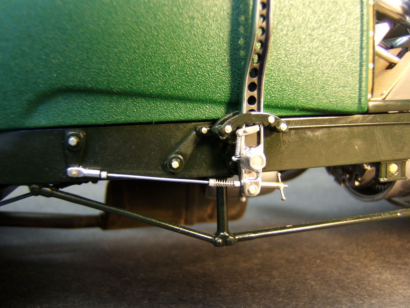

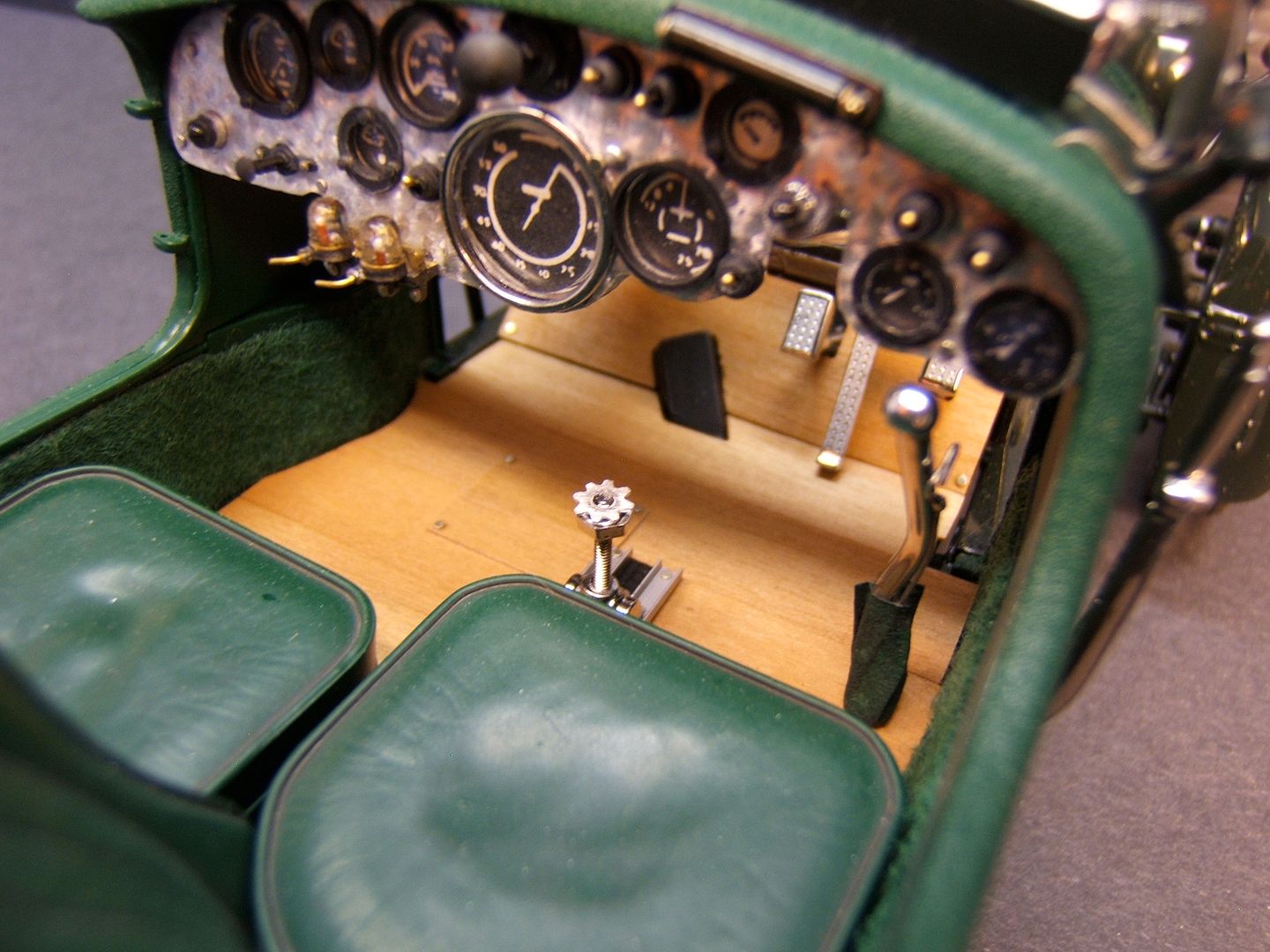

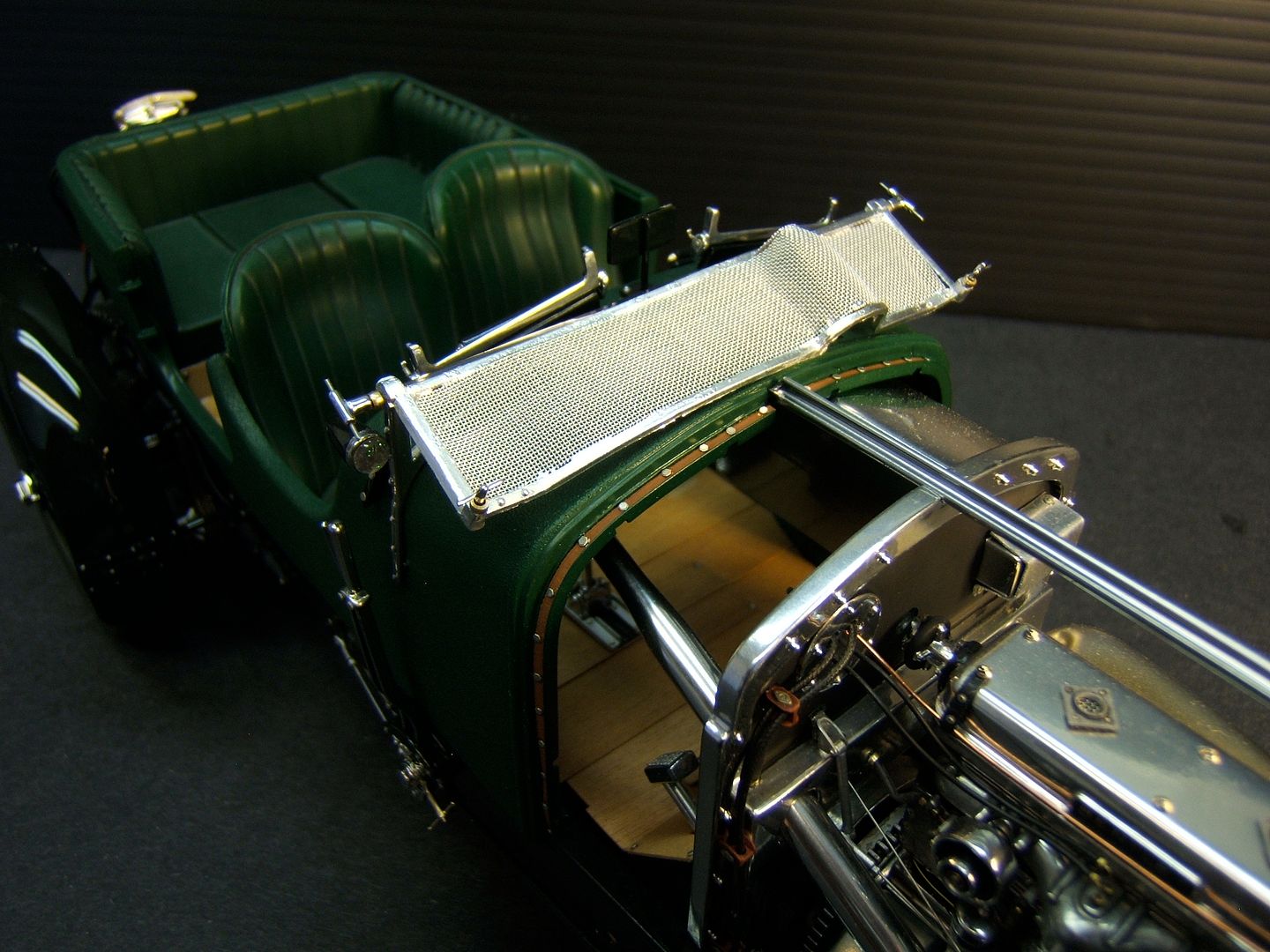

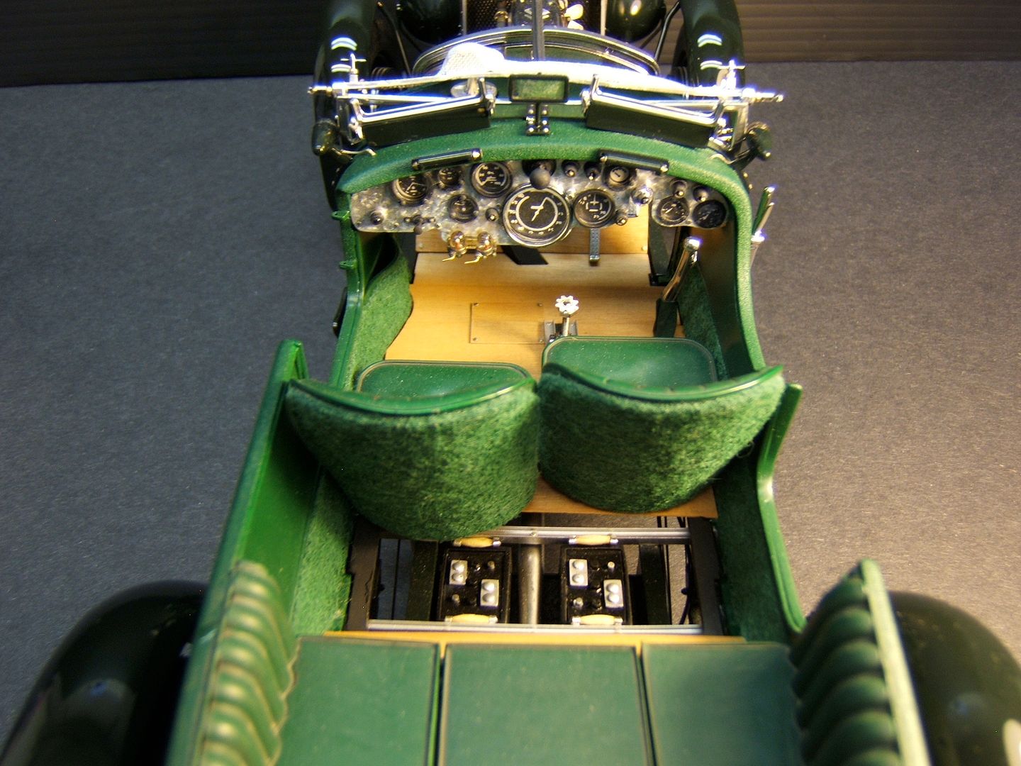

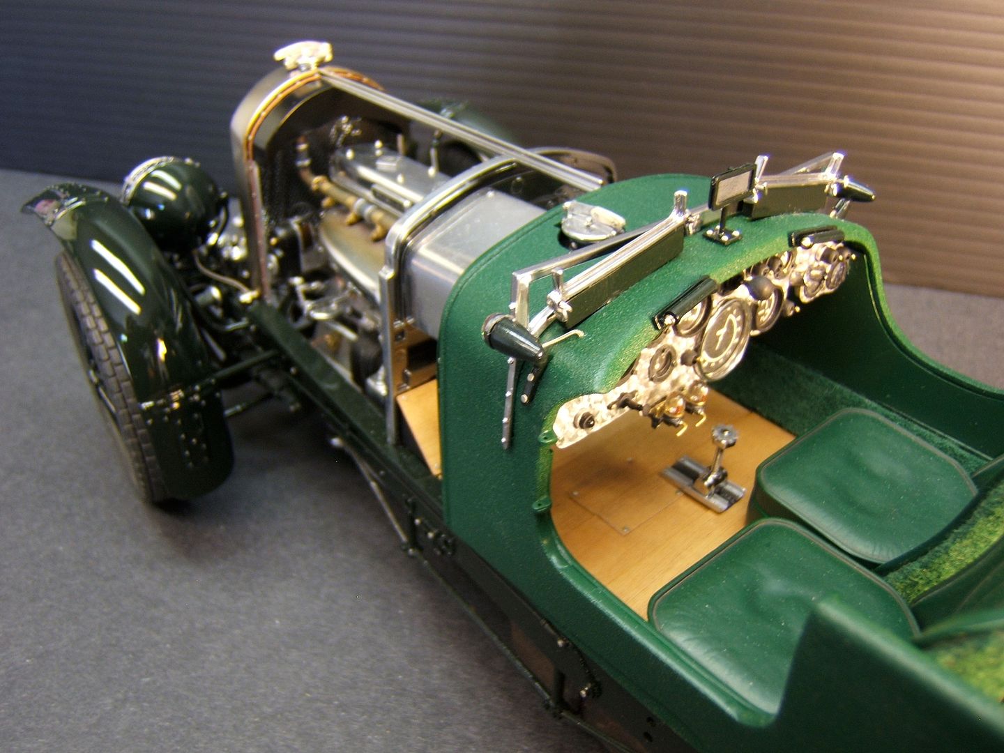

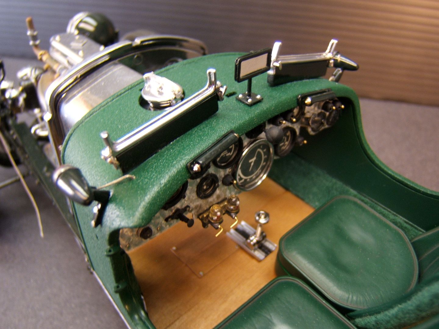

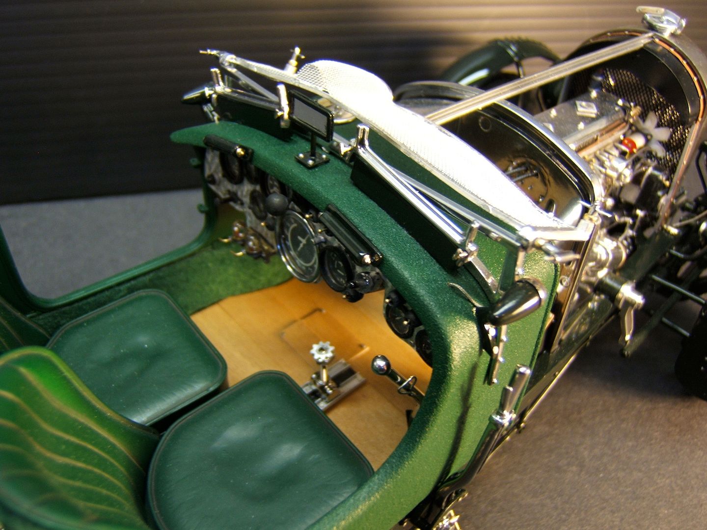

John Teresi Posted December 31, 2011 Author Posted December 31, 2011 Hello......thank you all for your kind comments.....I really do appreciate them..........the fenders are on.......gear shift and brake shift assembled........windshield guard with scratch wing nuts assembled........I will put the engine cover and glass on tonight.......thanks for looking.
John Teresi Posted December 31, 2011 Author Posted December 31, 2011 and a few more......the spru with the bolt ends is what i used for the rivets on the fenders......I bought them at the local toy train store........thanks
