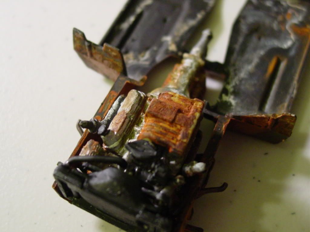

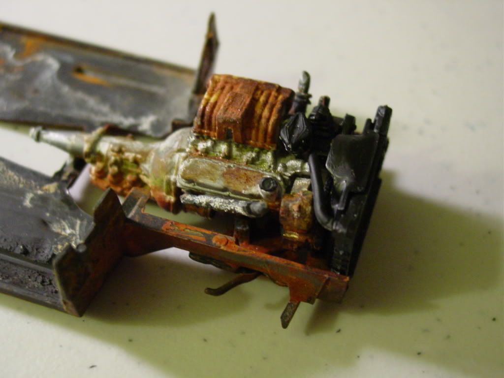

I will get pics soon but I got the engine attached to the chassis. I am going to do oil washes and more rust n stuff.
I also did some interior work that will be explained at time of pics.

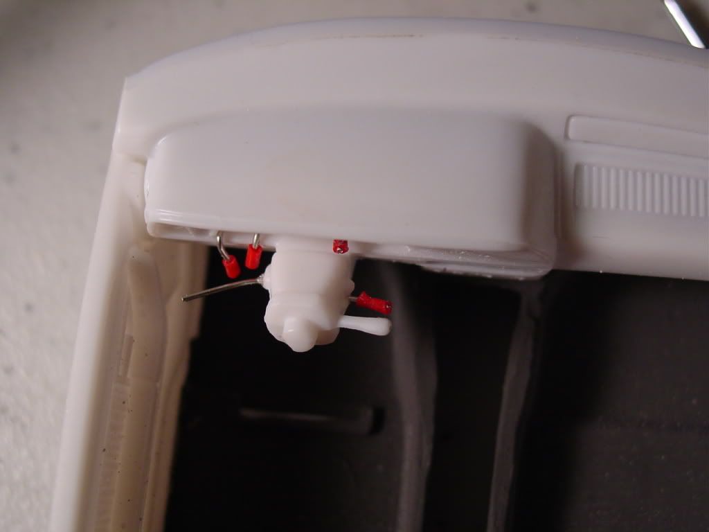

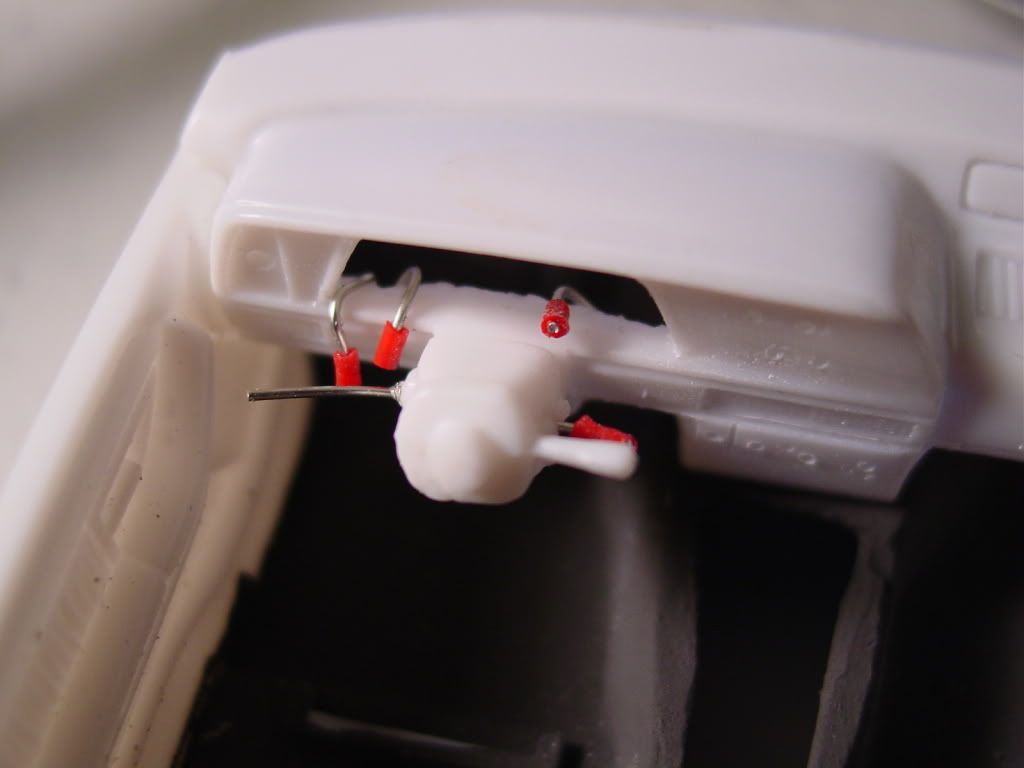

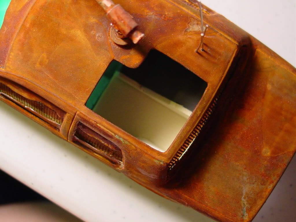

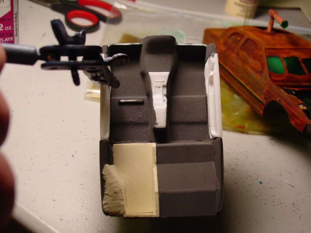

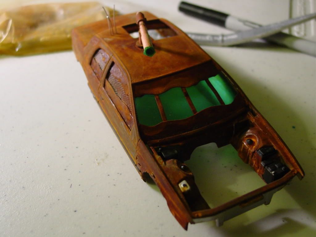

for the interior i had removed the back seat and made an armor panel that will have some stuff put in it. i padded the area where the people go in and out of the car, and for the person in charge of the scope.
for the dash i removed the gauge cluster and replaced it with a couple wires with plugs on the end to mimic a wiring harness. i also drilled out and put a "screwdriver" in the ignition and did a new wire for the turn signal switch.
I have drilled out some holes that will have some toggle switches in them, and will be making a CB radio as well.
since the pics i have removed the entire center console, so when it's done you will be able to see the drive shaft from the inside of the car. i wlil be figuring out how to attach the shift lever to the transmission.

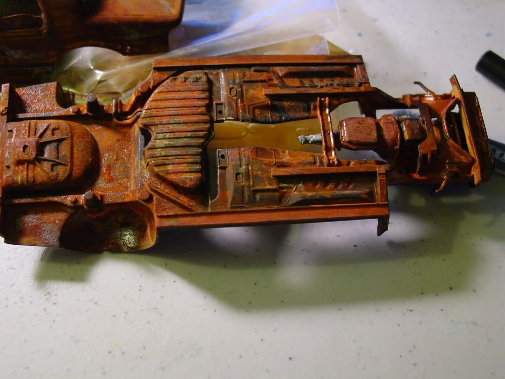

other stuff going on: i have a decent amount of stuff sitting in the rust baggy, and i coated the interior with the iron stuff to prep it for the rust solution. i plan on pitting the interior floor pan and putting in little holes as if it's rusting through a little bit. knowing the real car had plastic bumpers i will be "denting" them and painting them a flat black and might do some other weathering and damage things, maybe figure out oxidation techniques or something.

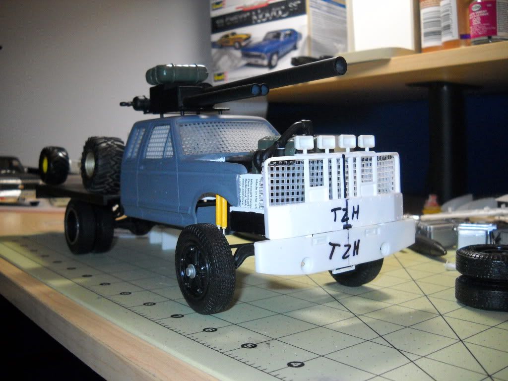

well I got a bit more done to The Rig
plus I've started a second project as you can seek that's peeking out from behind the cab. (codename: Blitzkreig)
could anybody tell me how to make a decent exhaust for this because I'd like to run the stacks from the 359 peterbilt kit up the sides of the cab.

Buy some K&S aluminum tubing. Heat it with a candle or cigarette lighter where you need to bend it. You can then bend it to the shape you want.
1) You don't need to bend it while it is hot. The heating anneals it, leaving it soft enough to bend. Reheat for further bends.
2) try heating the end bit first as a test. There is no visual clue as to how hot the aluminum gets. It will MELT before it glows.
3) K&S used to sell a brass 1/8" "Fuel Line" too, from the same stand. That is already annealed.
4) Warning: heated metal is hot!

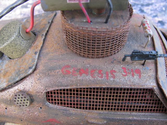

The Widow Maker is an AMT USA-1 Monster Truck that I gutted the running gear from, and decided to turn into what it is today, oddley enough, I finished the truck right after TZH fever had begun, good timing if I say so myself
...notice the biblical scrip on the roof over the doors...
Genesis 3:19
New International Version (NIV)
19 By the sweat of your brow
you will eat your food
until you return to the ground,
since from it you were taken;
for dust you are
and to dust you will return.”
