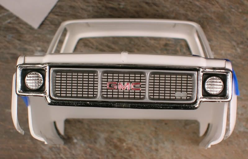

I'm going to get to this project eventually, as I have at least 3 in progress now. Since the whole GMC project succeeds of fails with the grille, I thought I'd get it done now.
That grill looks great! How much of it did you modify from the kit?

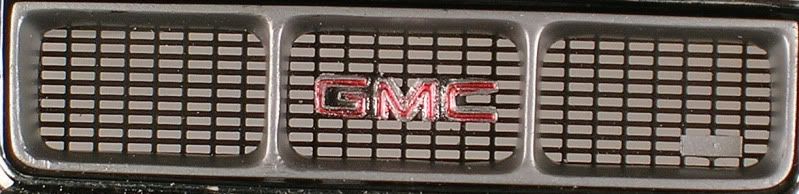

This is the modified portion:
The rest is the same as the original Chevy grille. When I cut out the center of the Chevy grille, the surround broke. You can see a piece of Bare Metal Foil at the center bottom of the surround.

Please, please, please drill out the molded in headlights. Nothing looks more toy-like than chrome headlights on a model.
It looks good so far, but I would also suggest you re-do the gridwork so it matches the 1:1 8x5 pattern, with each of the three openings having 40 holes:
I realize I'm being picky, but I'd like to see it made as accurately as possible since I'm sure quite a few people would like to have one to use with a 1/25 MPC cab.
Did you use the GMC nameplate/emblem from the Syclone kit's grille?
