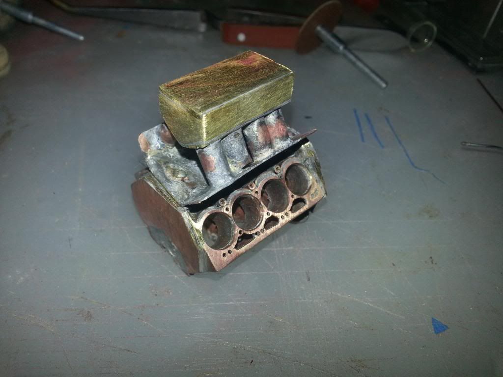

Romell R Posted May 23, 2012 Author Posted May 23, 2012 (edited) Hey thanks fellas for all the positive support .....I was able to get a lil work done on the motor today, I made a valve cover and it only took me 4 hours LOL! anyway I hope you enjoy. mounted on the head Thats all folks! Cya again real soon...... Edited May 23, 2012 by Romell R
W-409 Posted May 23, 2012 Posted May 23, 2012 It looks very good, I like the engine. It may look bit rough now for someone's eye, but I know that since I've been working with same methods and I've built one Tube Frame and rear frame from brass. Once primered, everything looks so smooth and much nicer. I can't wait to see for more.

Danno Posted May 23, 2012 Posted May 23, 2012 Great looking valve cover, Rom! This whole project is very impressive!

Mooneyzs Posted May 24, 2012 Posted May 24, 2012 Rom... awesome work on the Valve covers man... You just keep trucking along with this project.... Looking sweet man. looking forward to more pics!

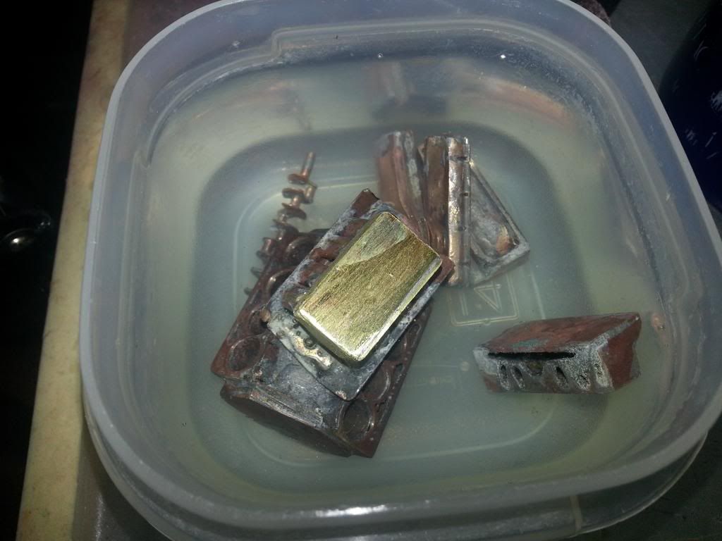

Romell R Posted December 5, 2013 Author Posted December 5, 2013 Hey fellas im back on this one and should have pics by tomarrow. Had lots of oxidation that needed to be cleaned up because I didn't prime the parts but a quick soak in white vinegar fixed that. see ya tomarrow.
Romell R Posted December 6, 2013 Author Posted December 6, 2013 Here's a few pics of the cleaned parts as you can see theres plenty of corrosion in the bath but the parts cleaned up fairly well after a scrub with a toothbrush
Dragracer Posted December 6, 2013 Posted December 6, 2013 Looks great Rom, boy, I bet that suckers gonna be heavy!
