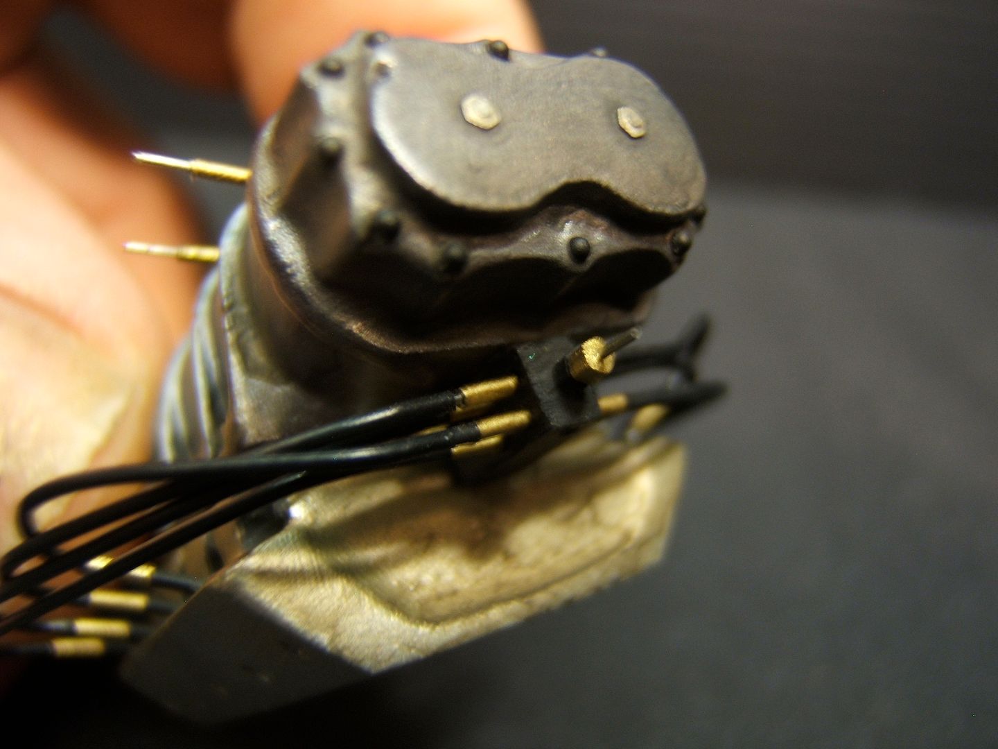

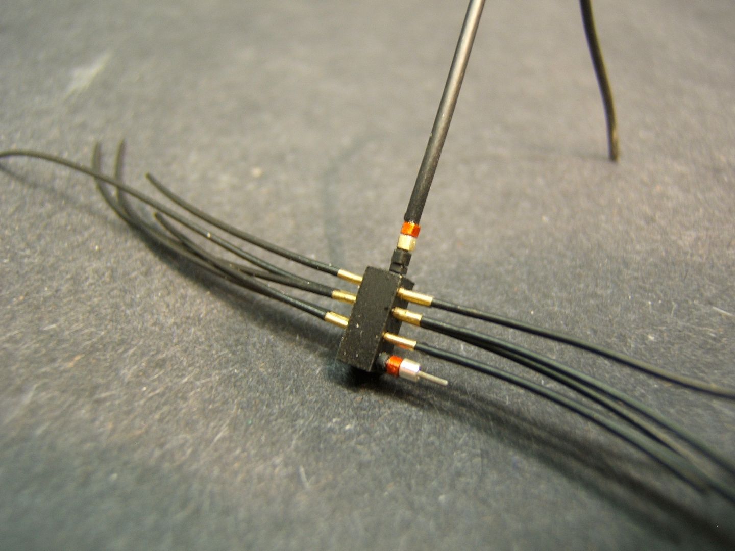

Cesar Bossolani Posted August 28, 2012 Posted August 28, 2012 Awesome job as always Jonh!! Where did you got those tinny wires? Thanks
John Teresi Posted August 28, 2012 Author Posted August 28, 2012 Awesome job as always Jonh!! Where did you got those tinny wires? Thanks Cesar.......from "Pro Tech"- detailing wire..........thanks.

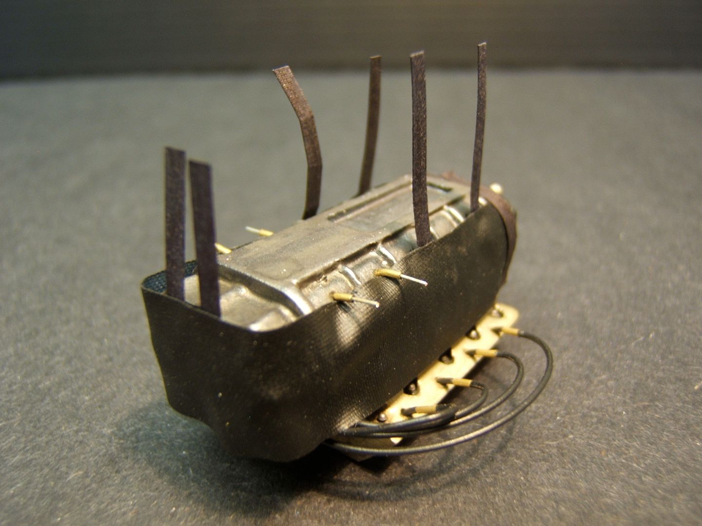

doomcrew Posted August 28, 2012 Posted August 28, 2012 awesome stuff john. i'm building a 1/16th scale camaro pro mod, and i see that you have photo etched belts on your transmission blanket. where did you get them from? i love the digital panel and rev limit light, how did you make them? steve

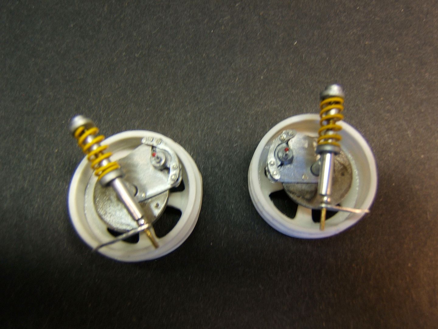

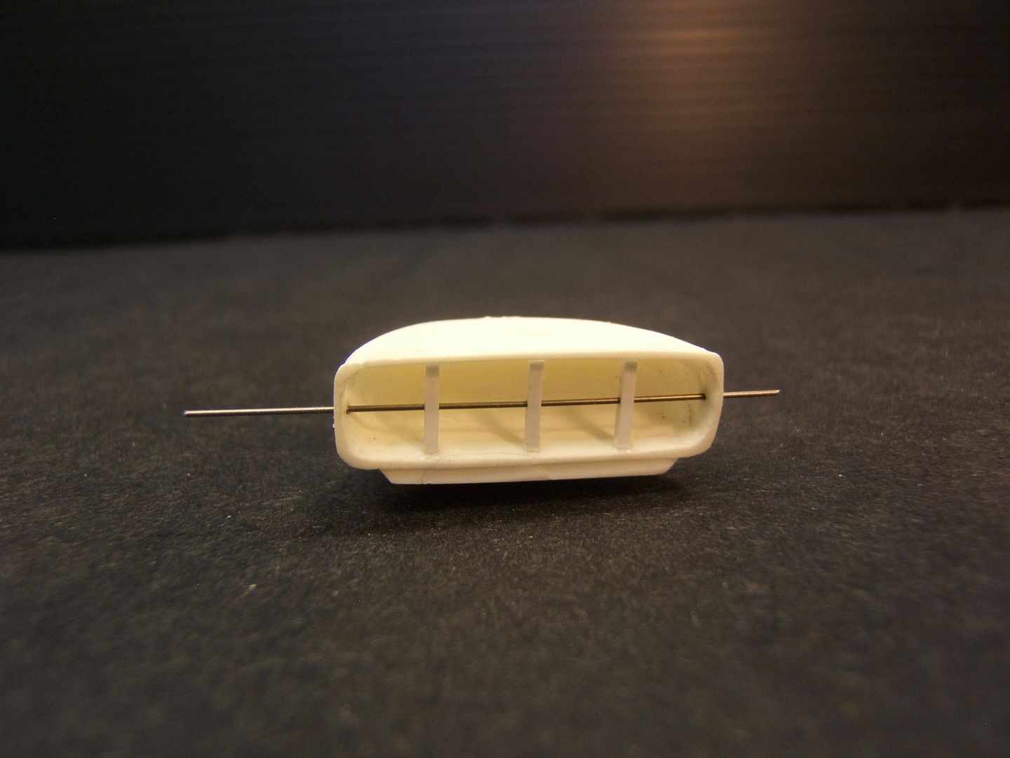

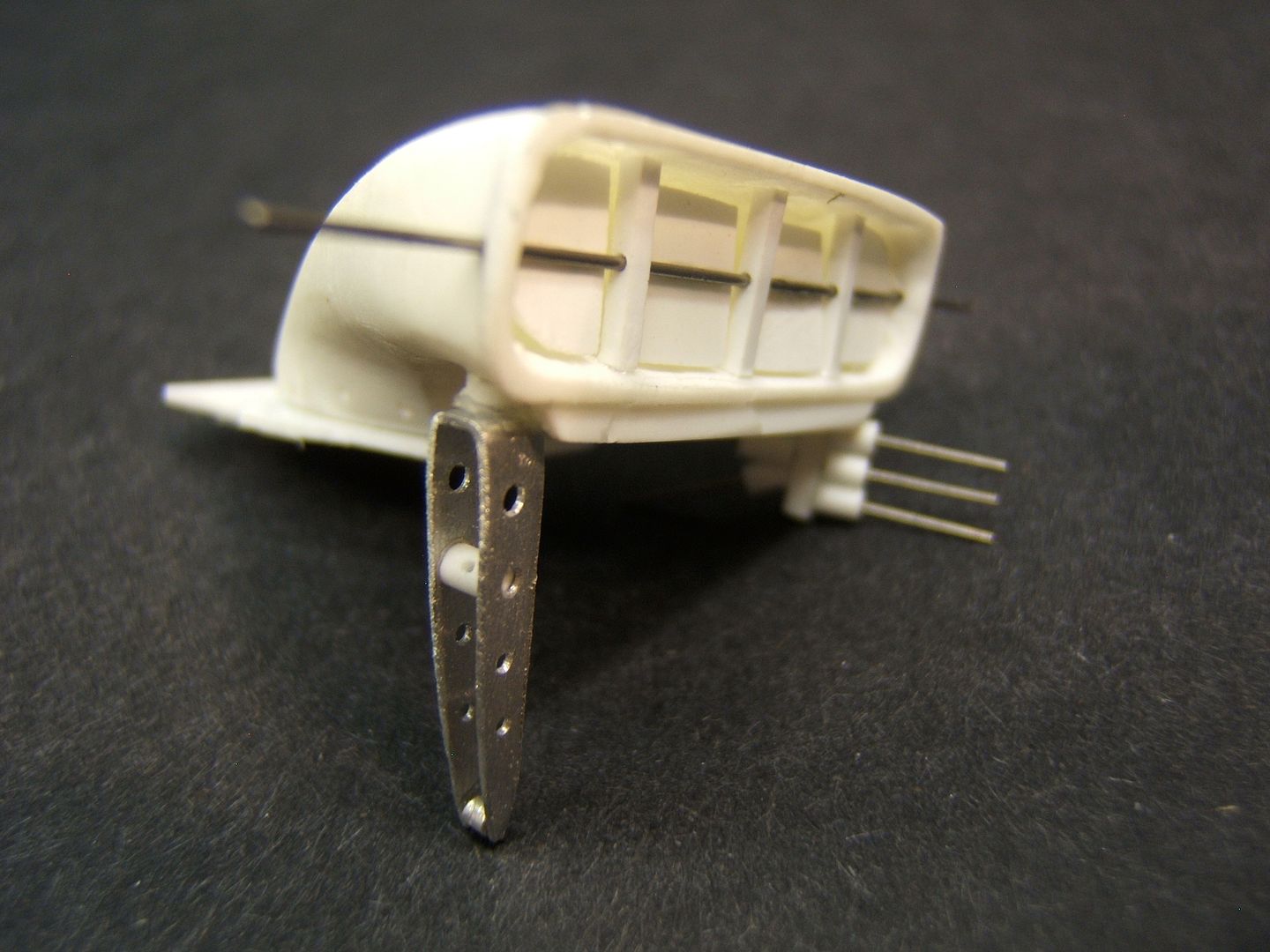

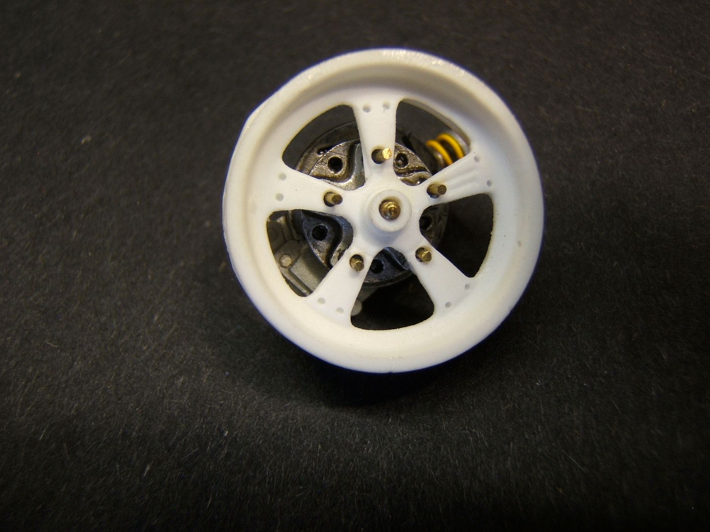

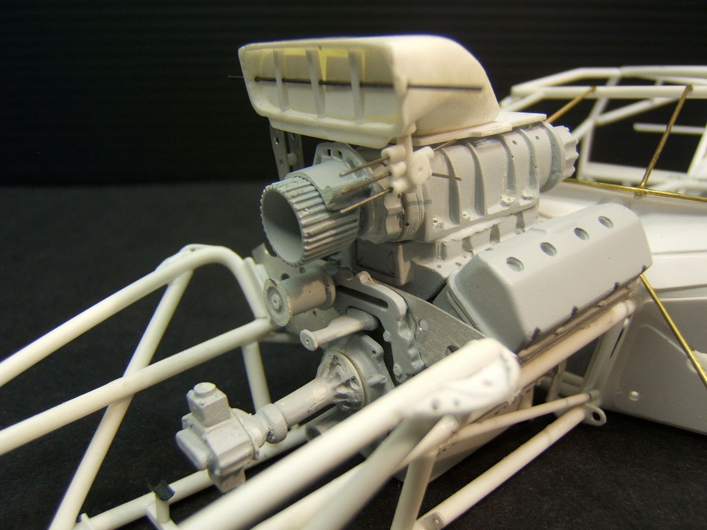

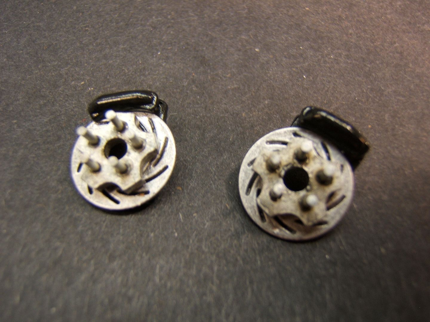

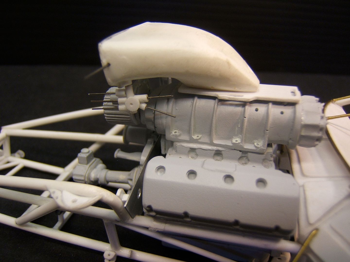

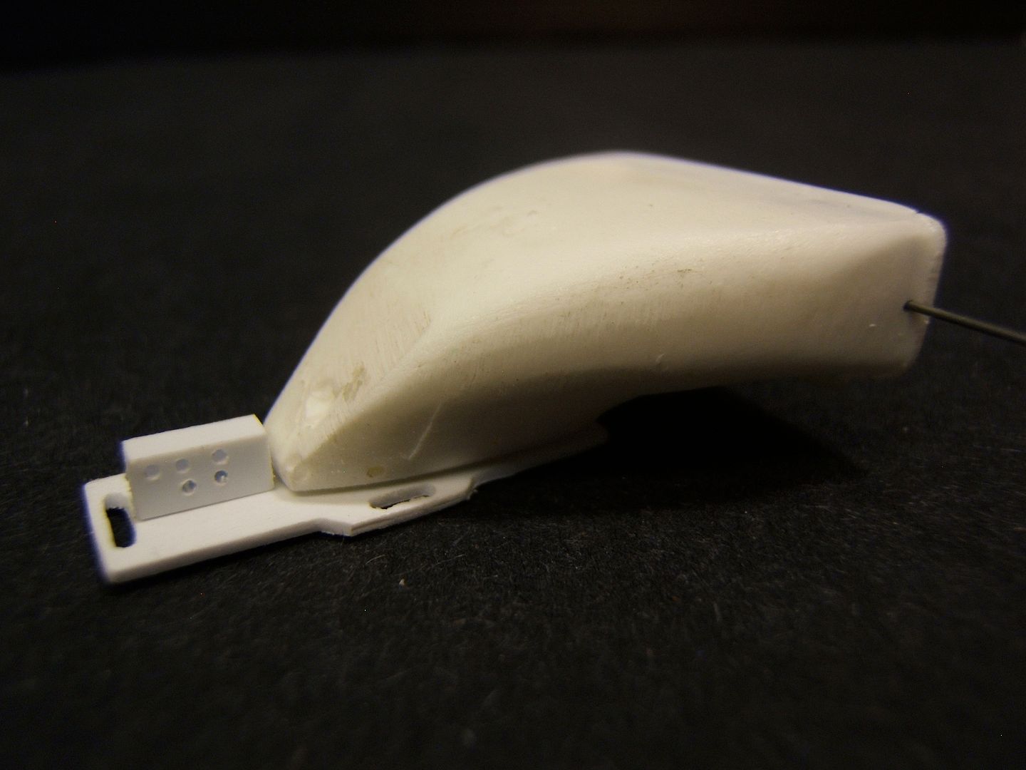

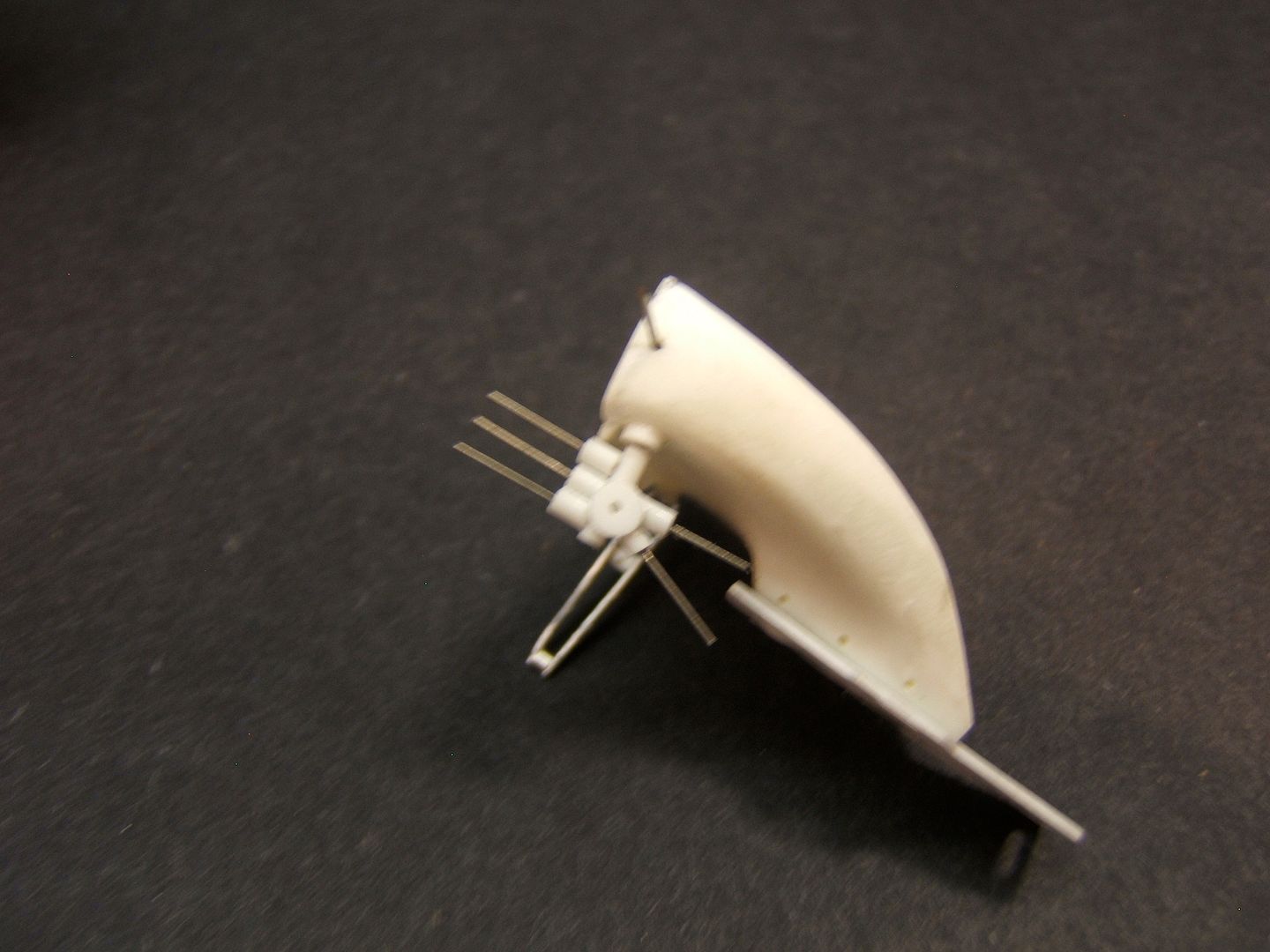

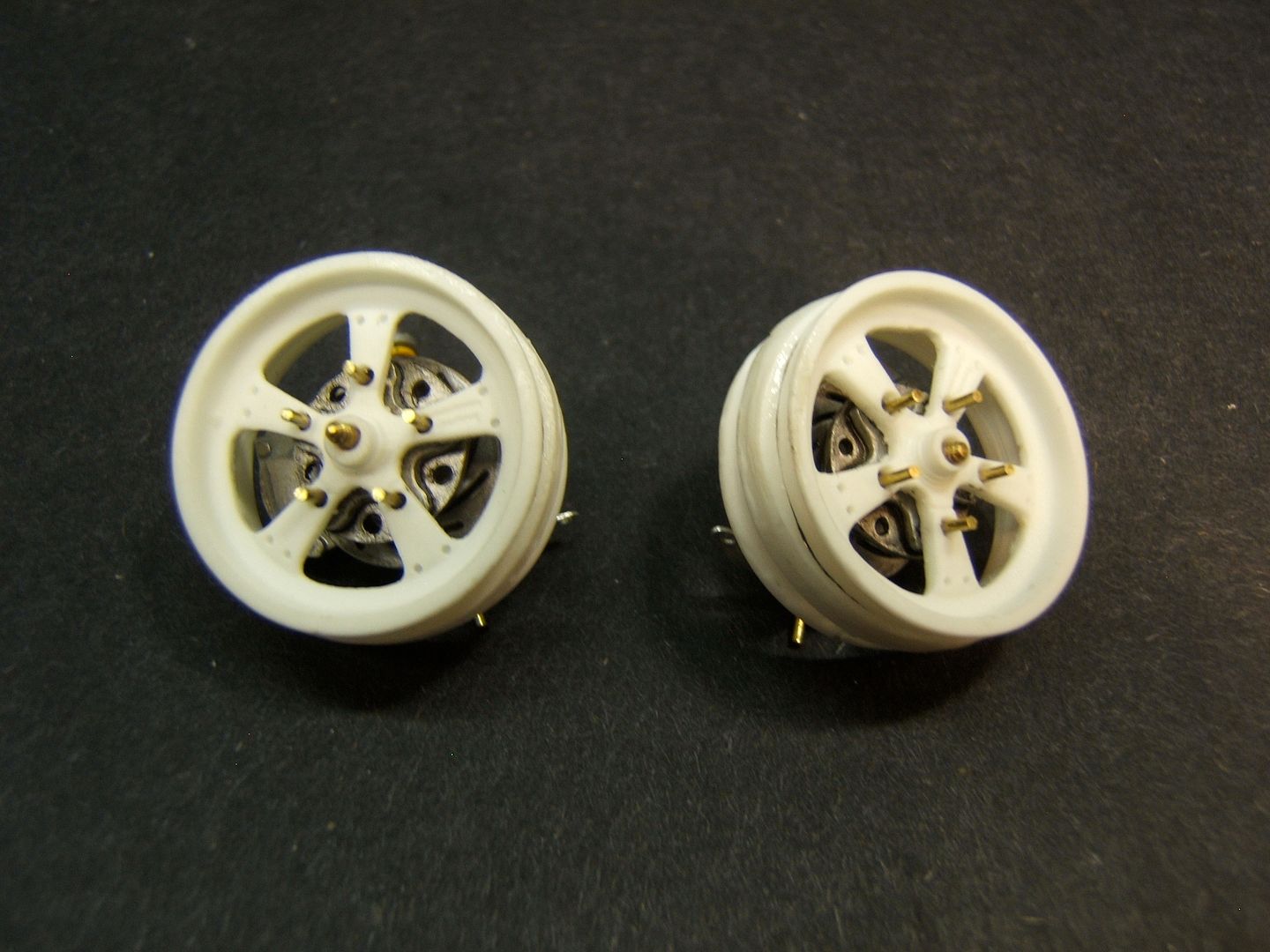

John Teresi Posted August 29, 2012 Author Posted August 29, 2012 (edited) Hello.......thanks guys for the kind comments....... all the wheels will be re-movable........I got the front brakes and rotors with brackets studs and shock assembly finished,all scratch built except for Mr. paul Rowe`s rotors.......I modified Mr. Paul Rowe`s rear brakes and rotor assembly with scratch built stud assembly........I also started to modify the Flashpoint Resins scoop.........I made a scoop plate, junction box and hollowed out the scoop and started on the butterflies........thanks for looking. Edited August 29, 2012 by John Teresi

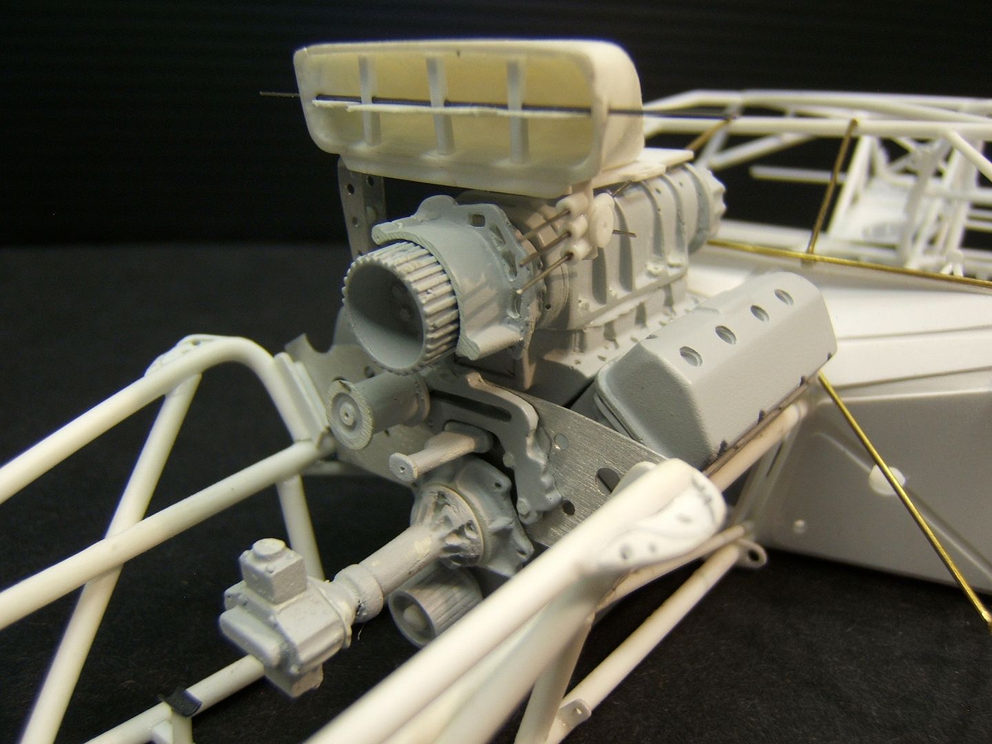

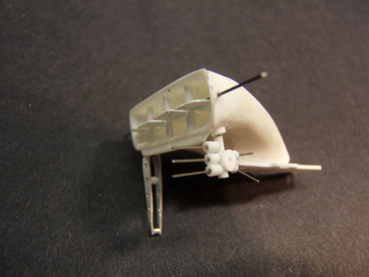

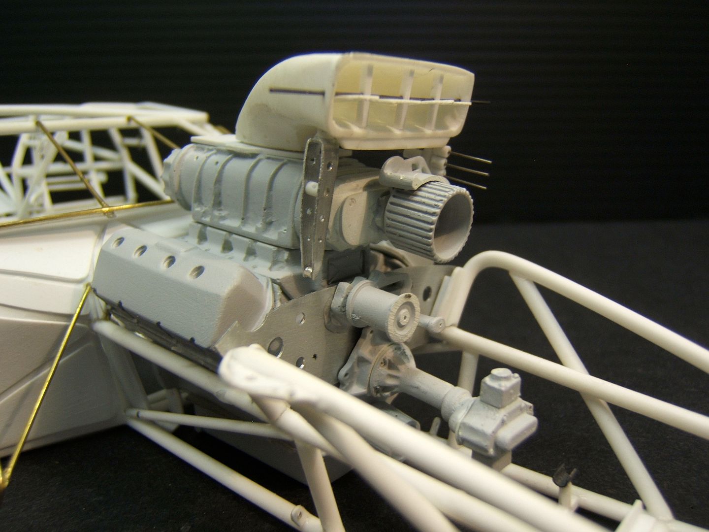

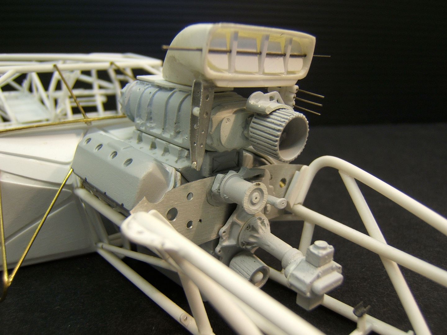

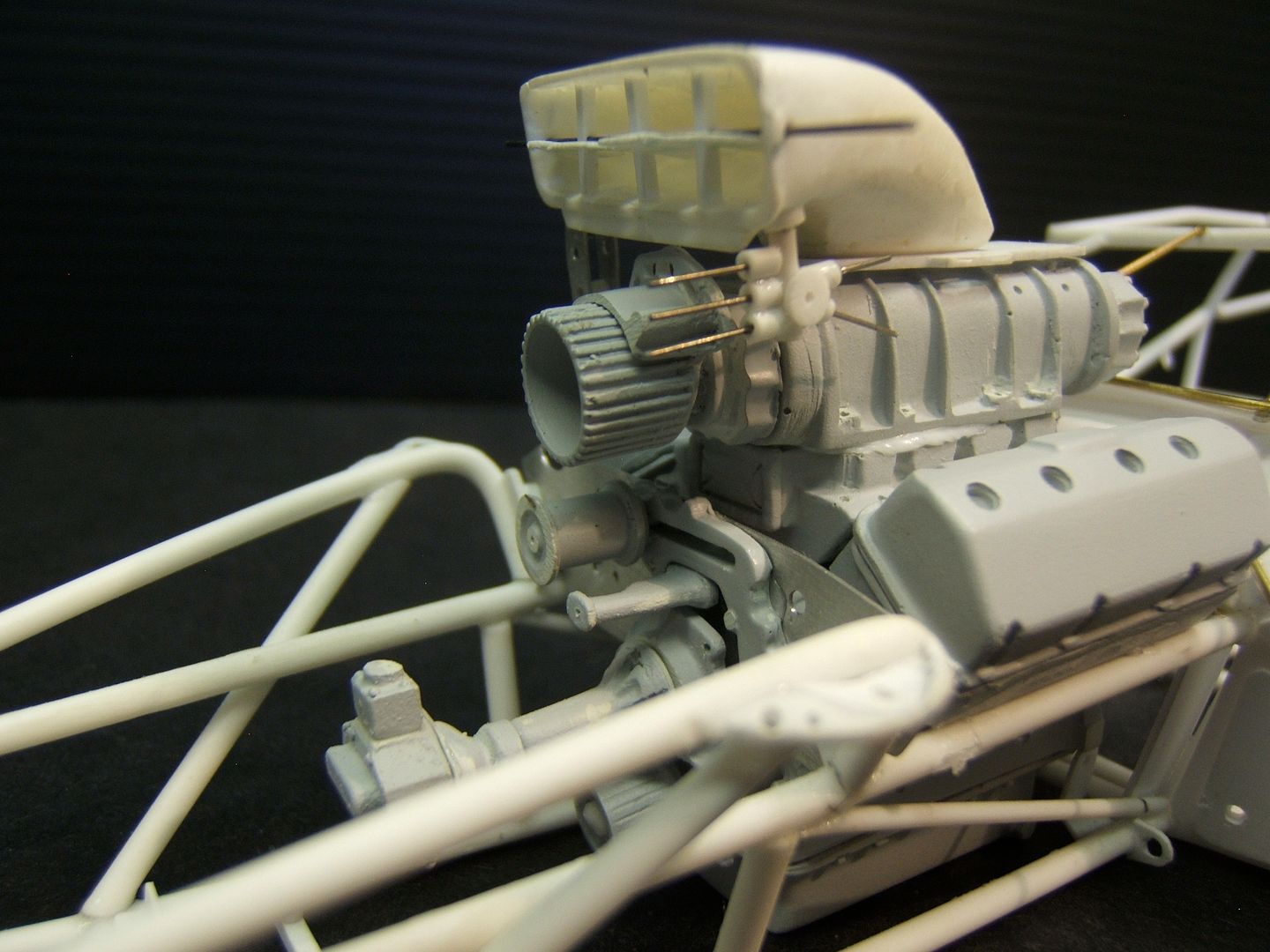

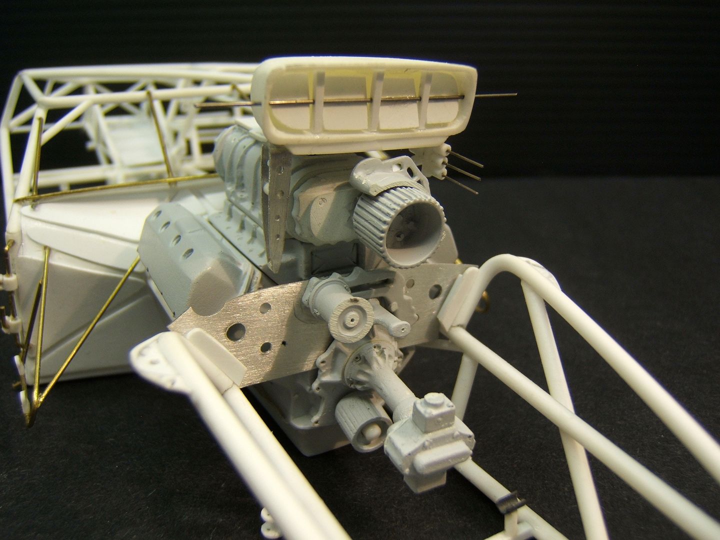

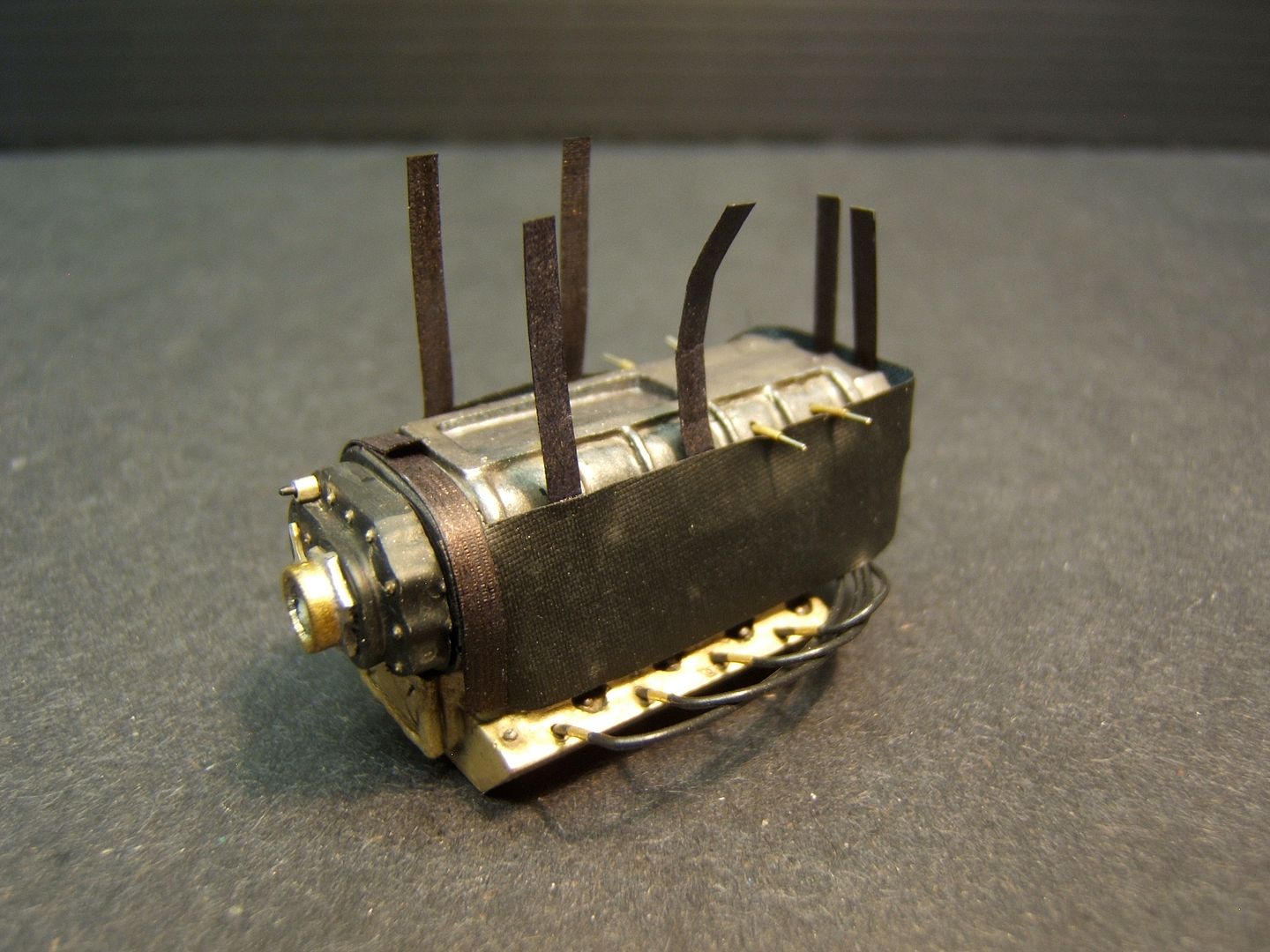

John Teresi Posted August 30, 2012 Author Posted August 30, 2012 Hello.......Dr. Cranky ,thank you very much for your kind comment.........I got the engine mocked-up.....I made working butterflies , throttle bracket and a fuel barrel for the scoop ........I also made a belt guard and modified one of the pulleys......thanks for looking.
Dr. Cranky Posted August 30, 2012 Posted August 30, 2012 The fact that you know where all of these things go and run to is impressive enough for me but also that when you are done it looks like a version of the real thing but in scale. I think you are a magician, John. Pure and simple.
comp1839 Posted August 30, 2012 Posted August 30, 2012 john, you may want to swap those blower pulleys around. the big one goes on the crankshaft. your setup would be under driving the blower. very nice build.
John Teresi Posted August 30, 2012 Author Posted August 30, 2012 (edited) john, you may want to swap those blower pulleys around. the big one goes on the crankshaft. your setup would be under driving the blower. very nice build. Dave.......thank you .......I corrected that........I did the same thing on my Jag ........I have to slow down a little . Edited August 30, 2012 by John Teresi

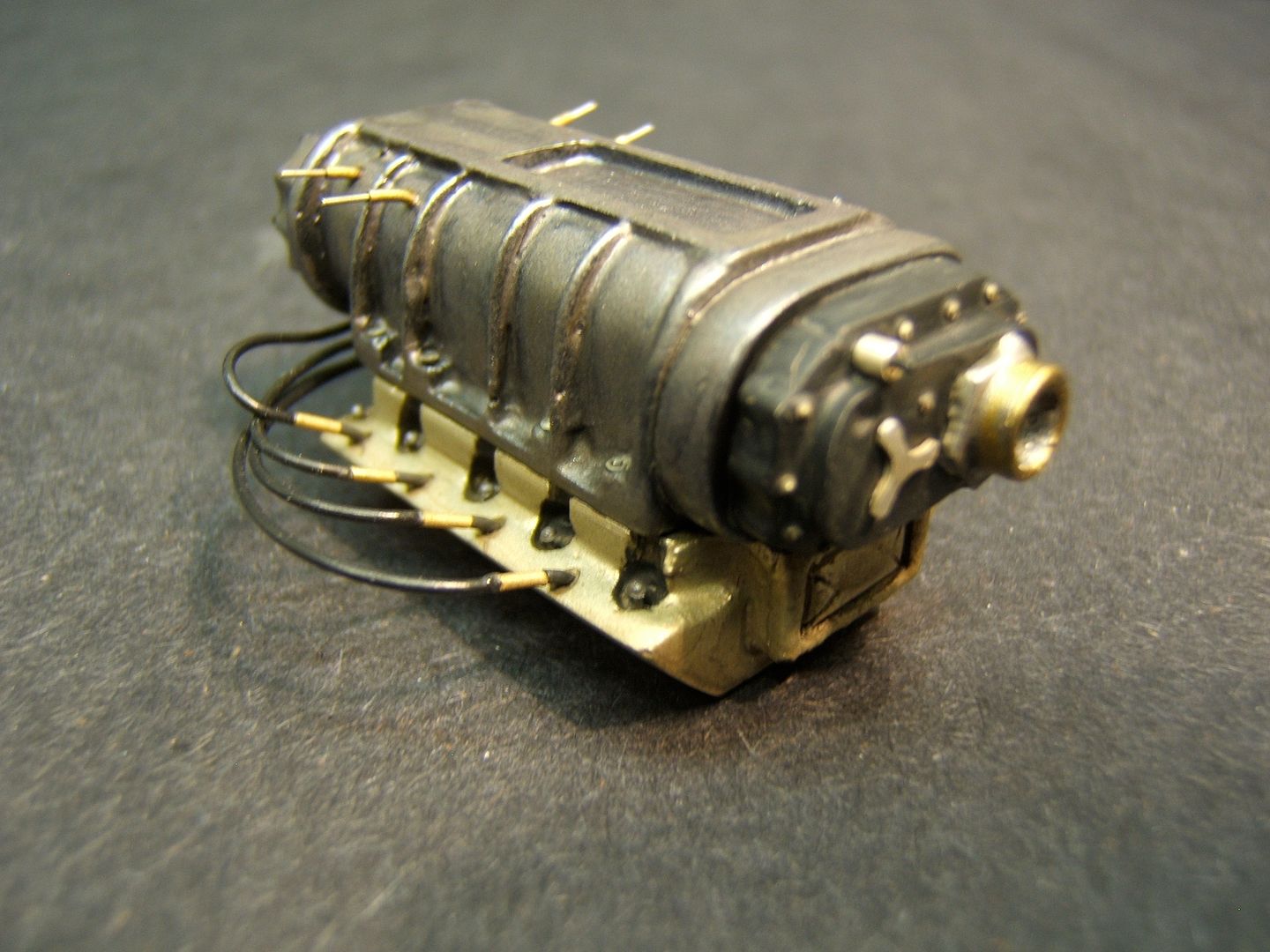

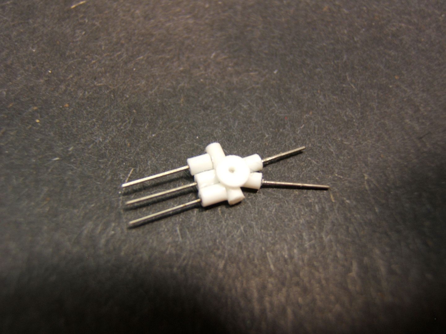

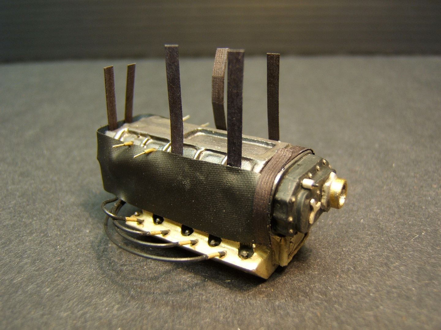

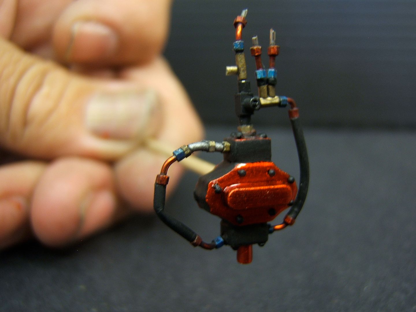

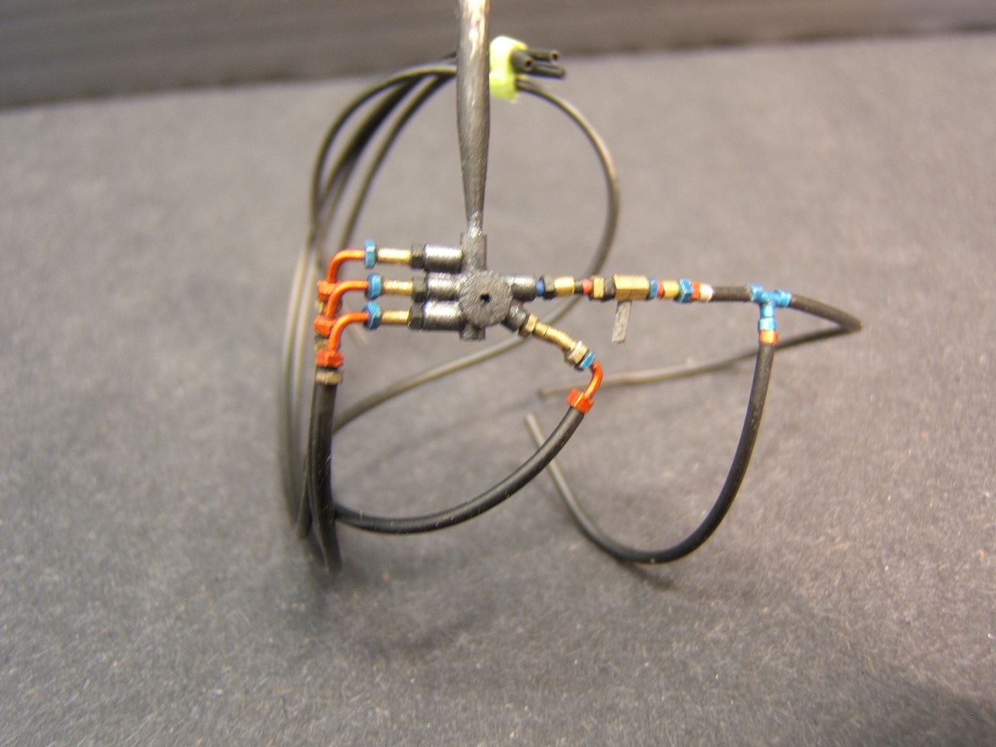

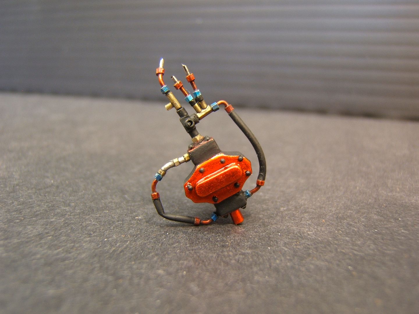

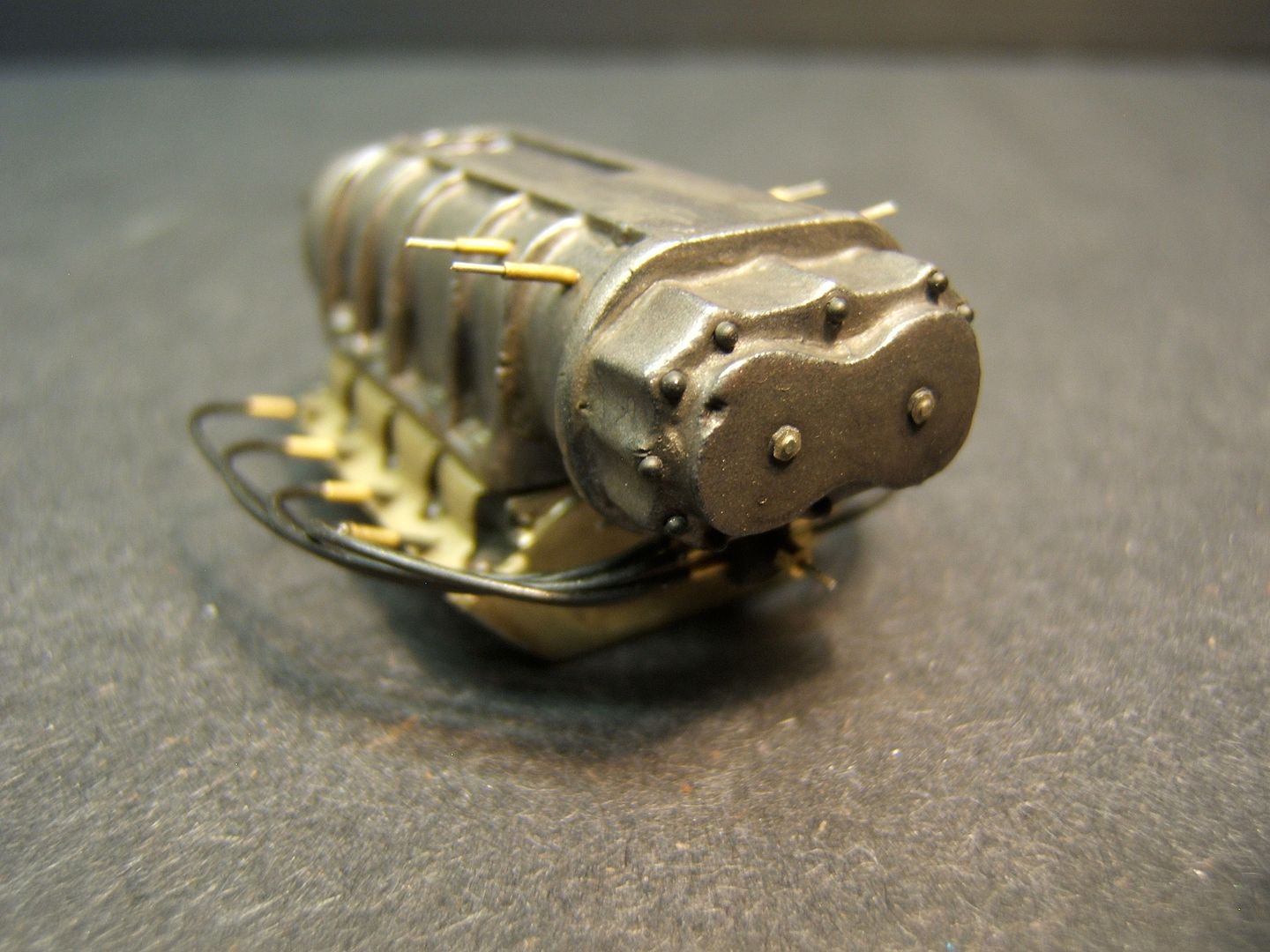

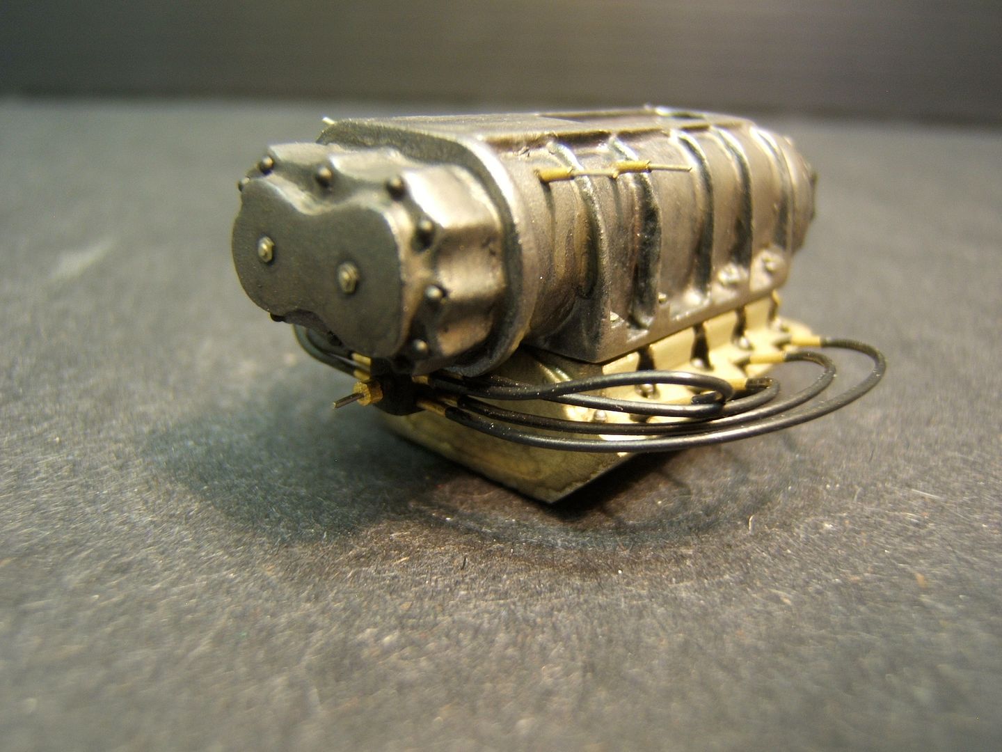

John Teresi Posted September 1, 2012 Author Posted September 1, 2012 Hello......thank you all for the kind comments........I started work on the plumbing........all hex fittings, I used hex rod drilled out and cut to size.......the smaller fuel line is from "Pro Tech" and I cut small pieces of the fuel line for fittings......I made a couple of junction boxes.......and the fuel barrel is painted and plumed.......I used "Pro Tech" nut and bolt ends.......also made a blanket wrap for the blower....... I also started work on the fuel pump .......thanks for looking.

eviltwincustoms Posted September 2, 2012 Posted September 2, 2012 John I have been lurking in on your build and have to say you my man... have a daunting task if you plan on wrapping this project up in your usual Build time frames. Question, what is that on your Roots blower toward the back on each side? Is that the injection ports for the NOS?
