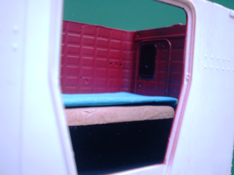

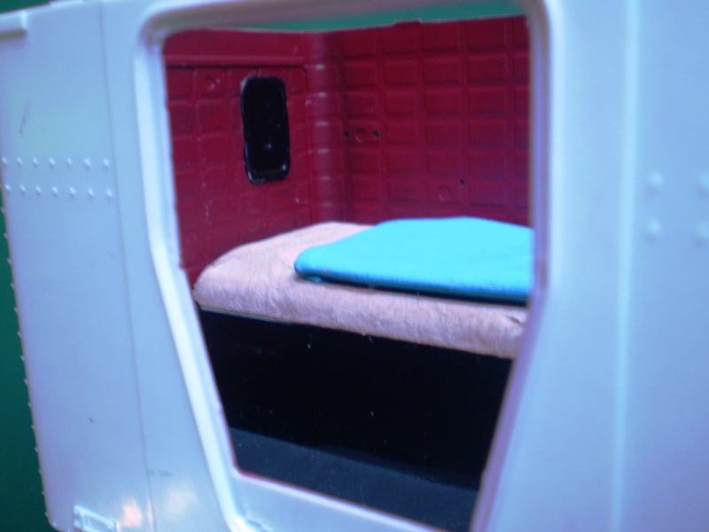

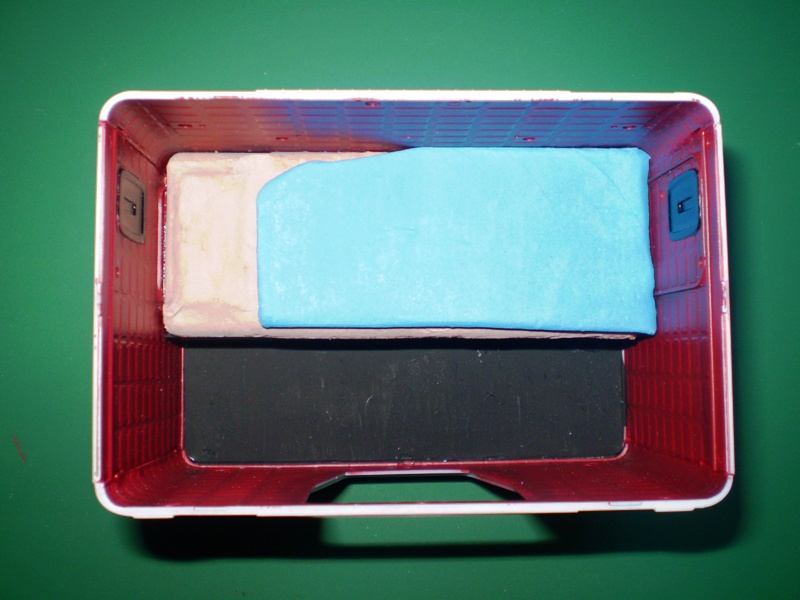

I did not take too much care of the sleeper interior as I won´t open it. But I did not like the molded mattress, so I covered it with a sheet and blanket.
post-8448-0-13900600-1368910808_thumb.jp post-8448-0-67314900-1368910833_thumb.jp post-8448-0-90199200-1368910846_thumb.jp

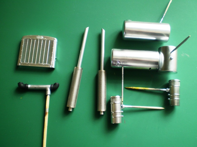

I have finished the rear fenders. I did not take pictures of making them. I used two spray can covers cut in the middle and shaped them with a help of plastic sheets and putty. I painted them with Alclad II chrome. This is how they turned out at the end.
post-8448-0-68387600-1375456647_thumb.jp post-8448-0-27250000-1375456656_thumb.jp post-8448-0-78764100-1375456664_thumb.jp post-8448-0-18163800-1375456673_thumb.jp
It looks more like a polished aluminium than chrome but that´s alright with me.

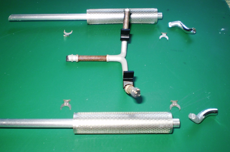

The exhaust piping will be quite a challenge. With the lowered cab it is necessary to modify the position of the pipes and mounting points. I hope everything fits well at the end of the day.
post-8448-0-70945900-1375736462_thumb.jp
