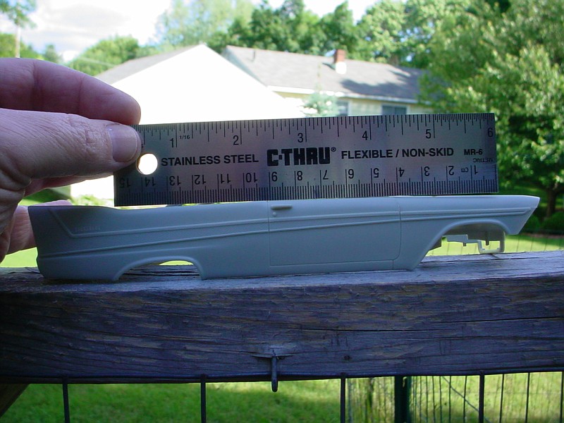

No clearer demonstration has been presented than this image compiled by Harry P. in a reply to a thread on the importance of kit accuracy. In addition to the bizarrely curved side molding, note also the seriously flawed side window opening. Just terrible, and virtually unfixable.
John (and Harry) are absolutely right on this one. It's not just a matter of the kinked-up side trim, but also that the top of the body sides echo the same mistakes - the top edge of the door should run gently upwards into the rear quarters, instead of downward as it does on the model. That, and like the Ala-Kart issued about the same time, the curvature of the sheet metal from the side surfaces to the top ones was too sharp in its radius. "Virtually unfixable" is a dead-on assessment. A pretty serious letdown after that very nice '57 300C.

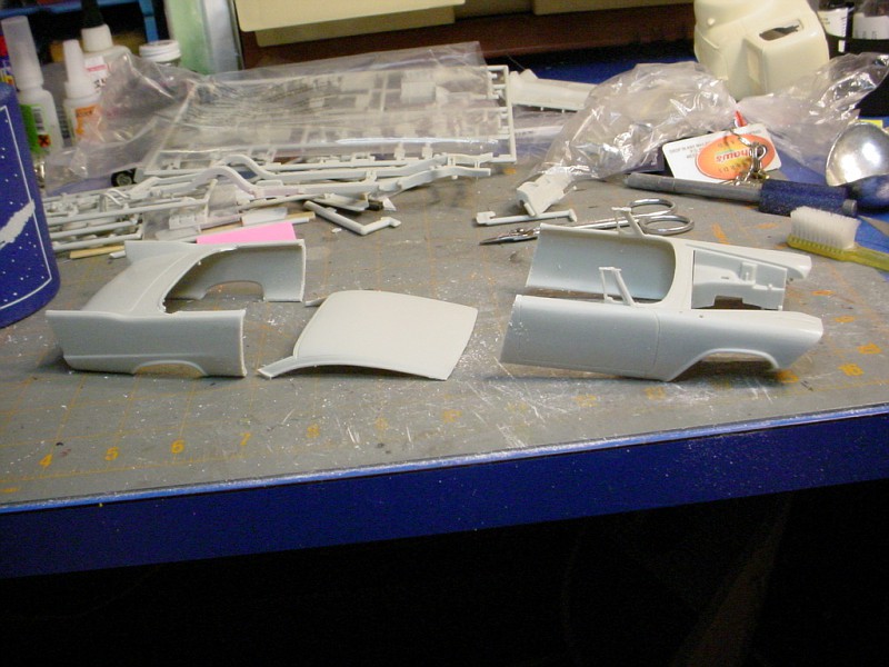

If you want to spend a TON of time (and some bucks), that '58 Belvedere CAN be fixed. It would take a '59 Dodge roof section (bodies turn up on the 'Bay occasionally) and "bending" the body along with what Jon Cole did on a thread some time ago.
Now you'd also have to change the windshield frame, and this is where AMT's '57 Chrysler 300 would come in handy here. A lot of work to be sure, but don't look for them to EVER fix the body on that one. BTW, I figured out that one of the reasons the kit was so wrong, is that RC2 based the kit on diecast tooling, which came out just before the kit IIRC.

Who knows........after I get done with that '59 Chevy, I MIGHT take on the monumental task of making a CORRECT '58 Belvedere/Fury. ;)
I've heard the SnapFast Slammer '58 Plymouth's body proportions actually aren't all that bad (compared to this one). Any truth to that? Might be a bit easier on the wallet to kitbash that body with this kit if you want a better looking model and don't quite feel like ponying up for a JoHan or Modelhaus body.
Chuck the slammer really isn't bad for what it is. Granted, the body has been stretched and modded. It is nowhere near stock but, It looks a whole lot closer to it's intended subject matter than the stock kit was. And at least the trim line is straight. I don't know what happened to mine but, here is one I found online. Apparently, this guy didn't like the kit's three point wheels though.

Here's some comparison pics:
AMT could at least mold the slammer body in white and package it with the glue kit to allow us the option to combine if they won't retool the glue kit body ;)
