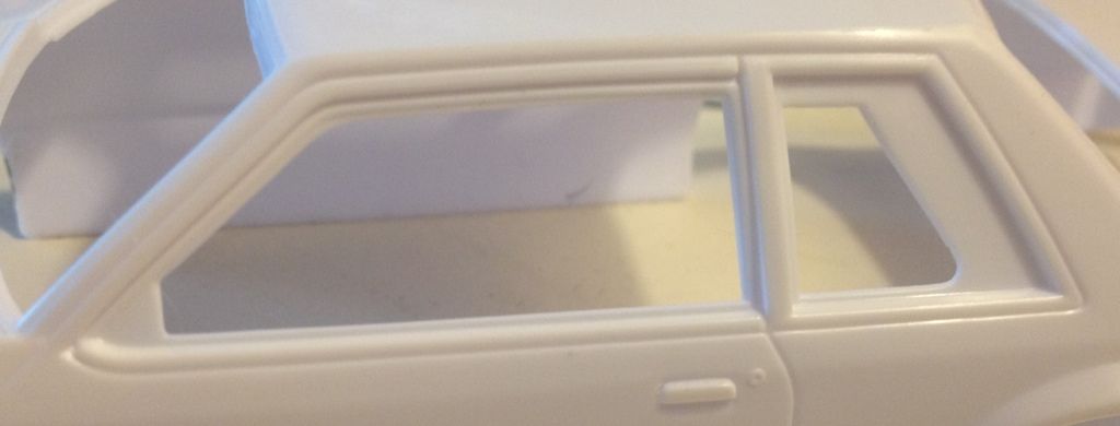

I did a quick greenhouse sectioning, taking out 2 scale inches or so:
I think some of the B-pillar angle differences can be accounted for by the angle and distance the pics were taken at, but the body proportions don't lie.

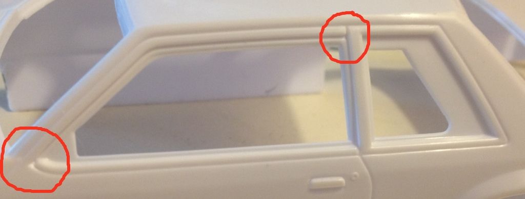

Okay, so now I can see for myself...
It appears that Revell totally engineered the door/trim incorrectly.
Here is the kit:

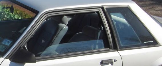

Here is the real car:
The trim and how the door would "open" on the model are incorrect - this could be compounding the issue as it appears they didn't take the time to correctly address not only the trim and door, but overall roof height. The gutter trim, if that's what it is, it way too thick and ends where it shouldn't and doesn't where it should.
I am focusing mainly on these areas:
Here is the kit:

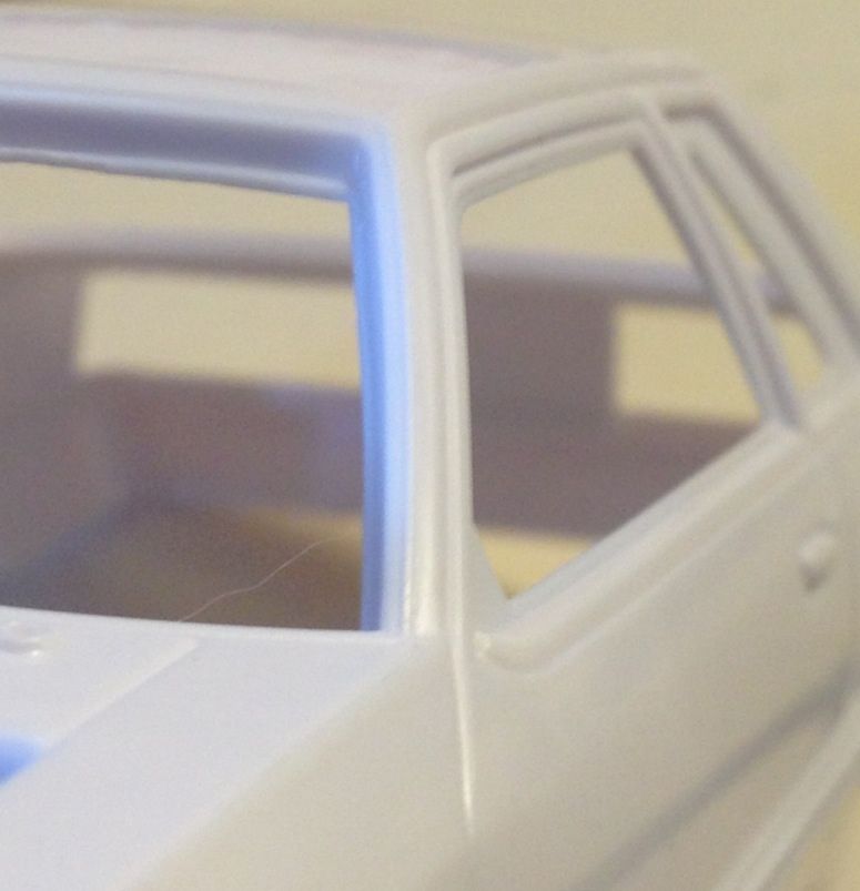

Look how overly thick, and yet lightly engraved the top windshield trim is - that is a feat in itself. Why does that bottom window trim not stop where the mirror is supposed to go? I presume that means the mirror isn't going to sit correctly. Why oh why is the rear "vent" window opening the wrong shape (although that's the easiest fix of the maladies)? Oh and while we're picking nits, the door handle isn't right - seems to wide, there's no indent around the door handle and where the sam heck is the keyhole going? Why is it listing lazly towards the NE when it's perfectly in-line with the door handle on the 1:1?

You can see a slight bow in the A pillar - I, at first glance, thought "what the heck, is the roof squished?", but in actuallity, the A pillar does bow out a slight bit - so nice work there, Revell
The windshield trim appears overly thick because the window mounts from the outside - I'll see how it looks during construction.
No I don't mean thick like deep, I understand the windows mount from outside. I guess I should have phrased it as "tall" as in the part that's above the windshield is taller (aka thicker) than the real thing's rather minimal trim. But shoot considering the half foot of scale window trim frosted onto the windshield itself, the external window trim is the least of that entire assembly point's problem.
