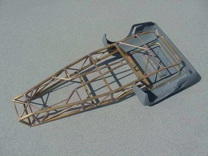

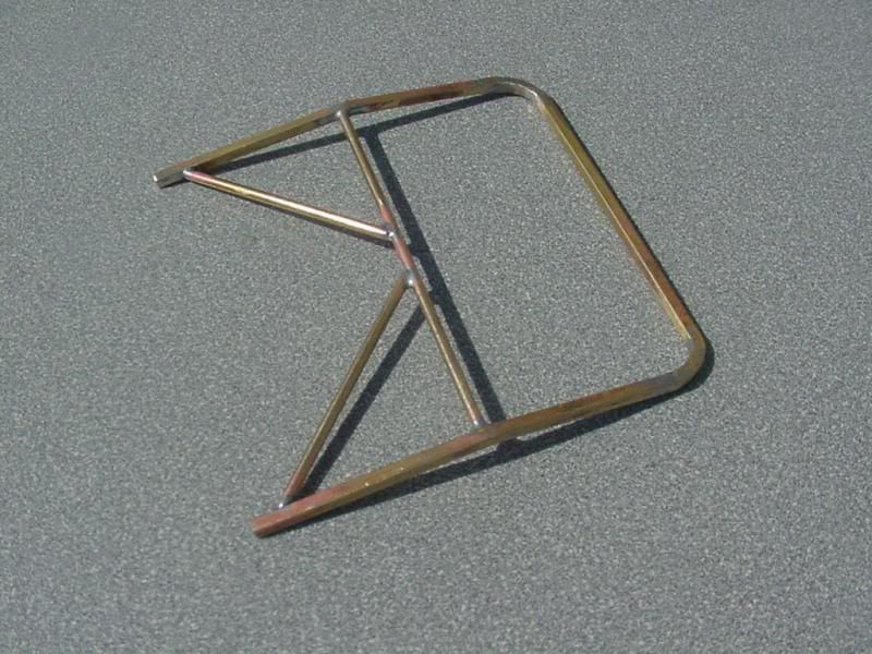

Scale-Master Posted April 12, 2013 Author Posted April 12, 2013 Thanks guys! More progress on the frame… This section plugs into the rear of the main frame. …as well as fine tuning the fit of the body to the frame.

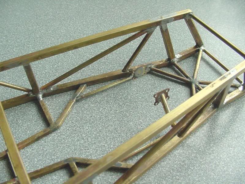

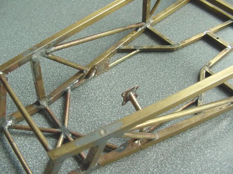

Scale-Master Posted April 16, 2013 Author Posted April 16, 2013 I made the motor mounts and soldered them to the frame. They are made of brass rod and acid etched brass sheet. Also added the cross member for the trans mounting point.

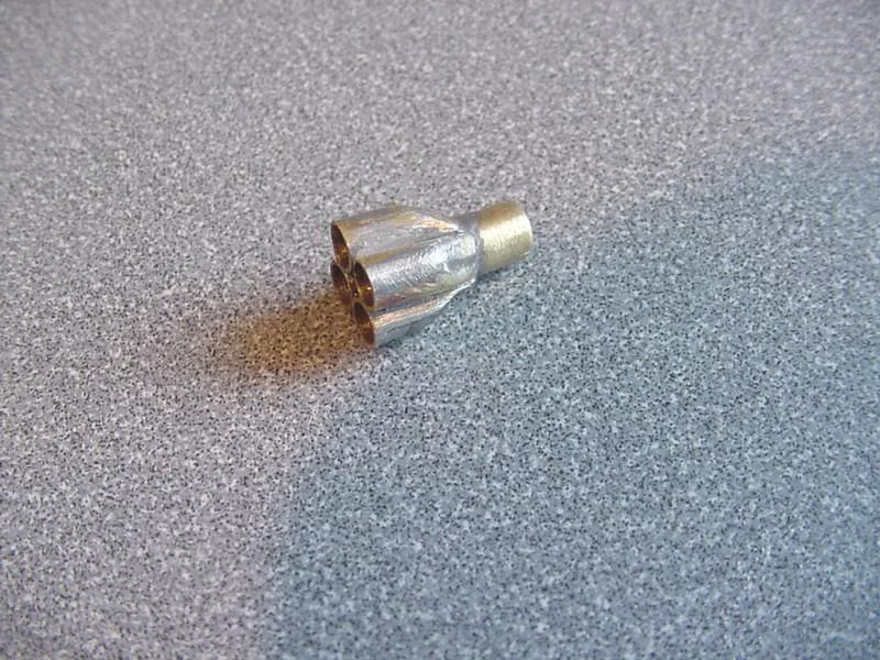

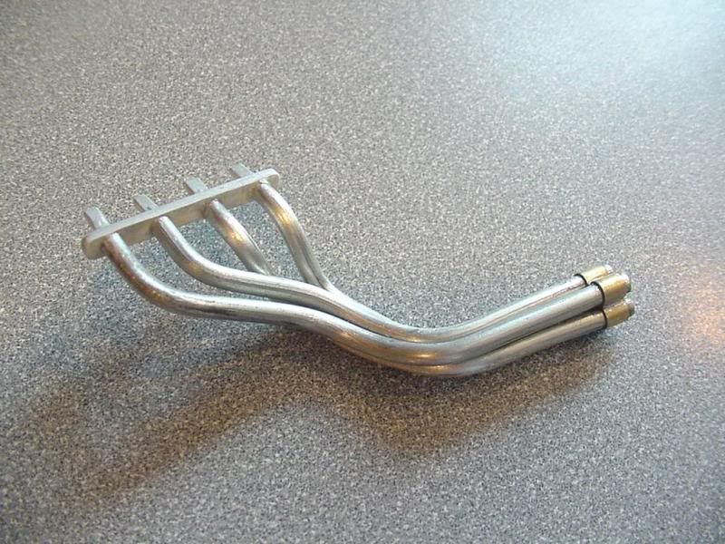

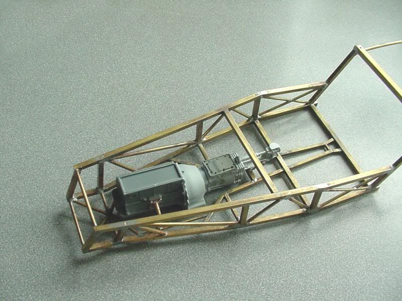

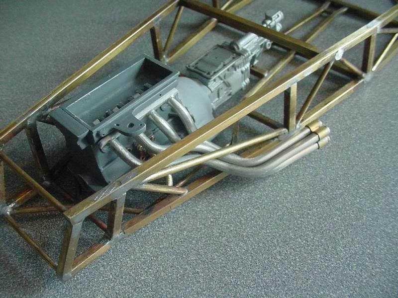

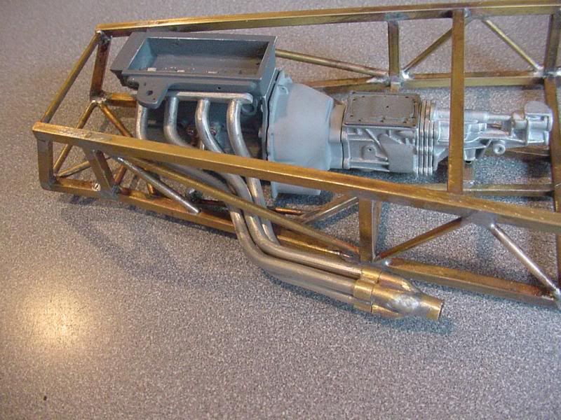

Scale-Master Posted April 17, 2013 Author Posted April 17, 2013 With the engine secured into the frame, I decided to make the header. Brass, solder, steel and styrene, (I made the flange while I was building the head). The collector is just brass pieces soldered together. It is a press fit to the header.

Pete J. Posted April 17, 2013 Posted April 17, 2013 Mark - Ya gotta admit, sometimes it is fun to do it in metal jus cuz ya can!
Scale-Master Posted April 17, 2013 Author Posted April 17, 2013 I must admit, after all the bending, filing and sawing on that header over the last two days, my fingers are really sore. Something plastic doesn't cause... It's still worth the effort. I think there are only two Crown Burgers, (both in SLC), only been to one myself, it's enough... Way better than In & Out!
