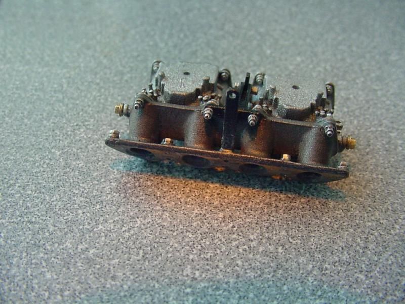

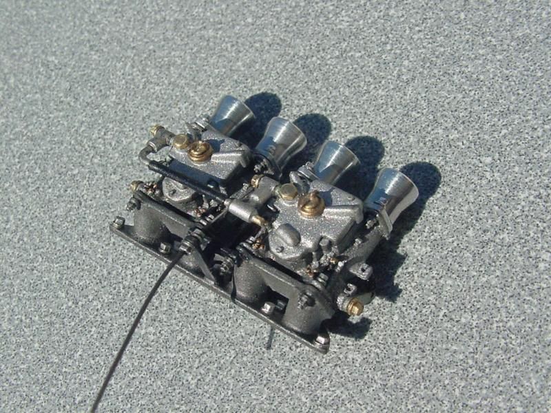

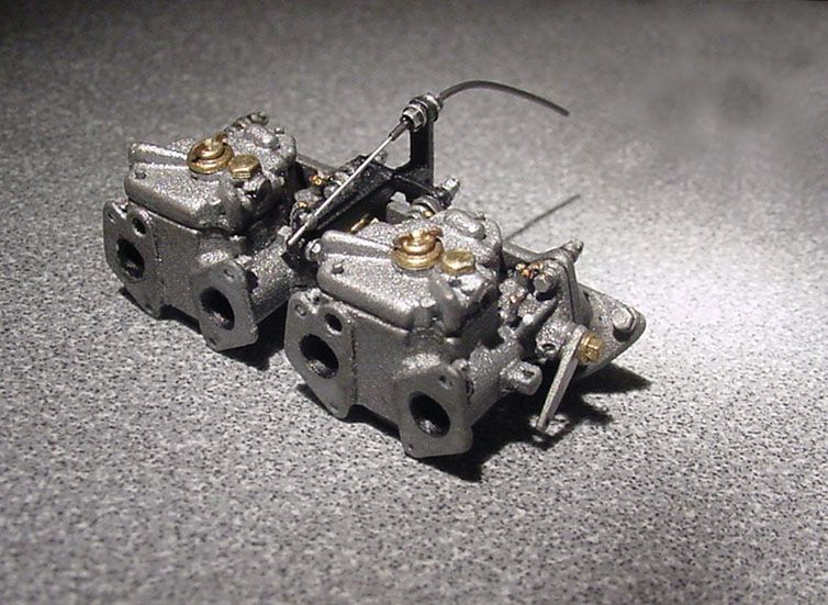

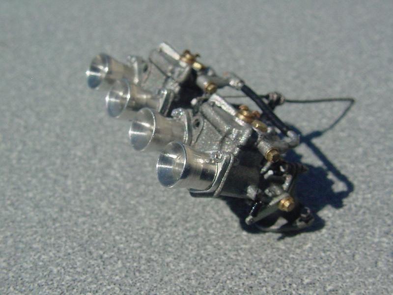

The carbs are mounted to the intake manifold and the linkages for the return springs are installed. I machined brass for those nuts and washers.
Still a little more detail work before the tops of the carbs go on.
Pretty fine photography, too! It lets all of us see all that great detail up close. When the image is bigger than the part is and it still looks real good, you know it is good!

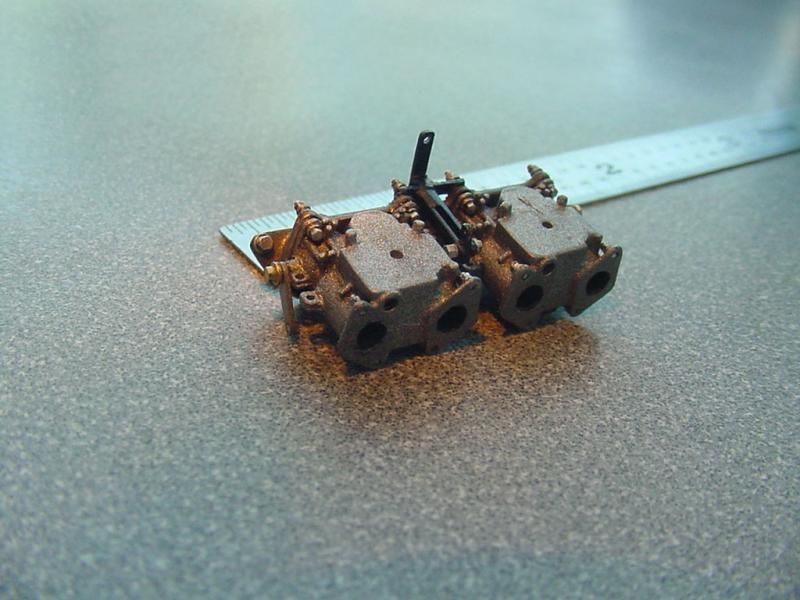

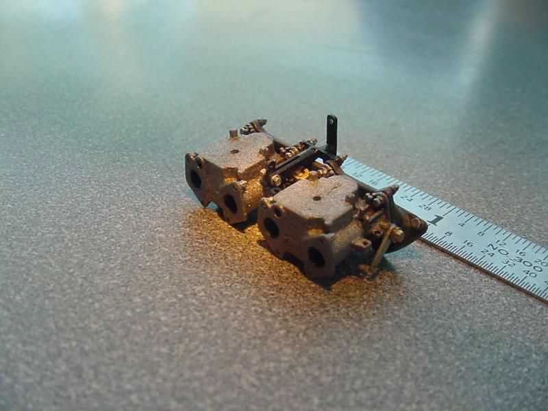

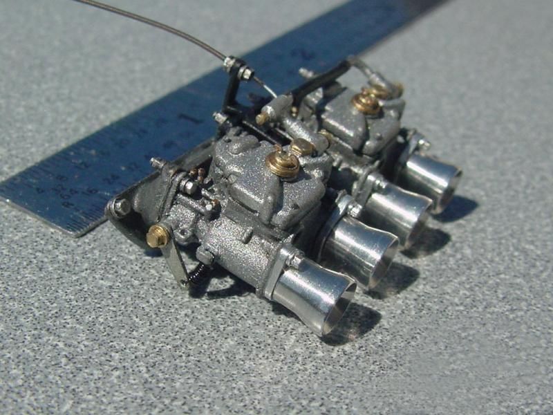

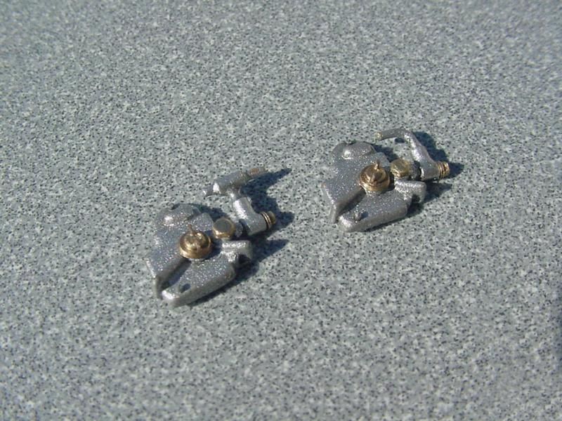

The tops of the carbs, ready to install. Brass for the fittings, wingnuts and hardware. The little flathead screws are stretched sprue with the slot cut into them.

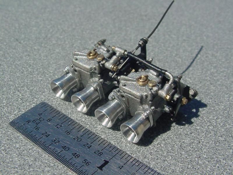

Return springs and a section of fuel line have been added. This assembly is ready to be installed onto the engine. Still a few details to add, like hose clamps and printing on the fuel line…
Amazing work! I've been following along since you started this build. This just amazes me and inspires me to build better models. Thank you for sharing your amazing talents with us.

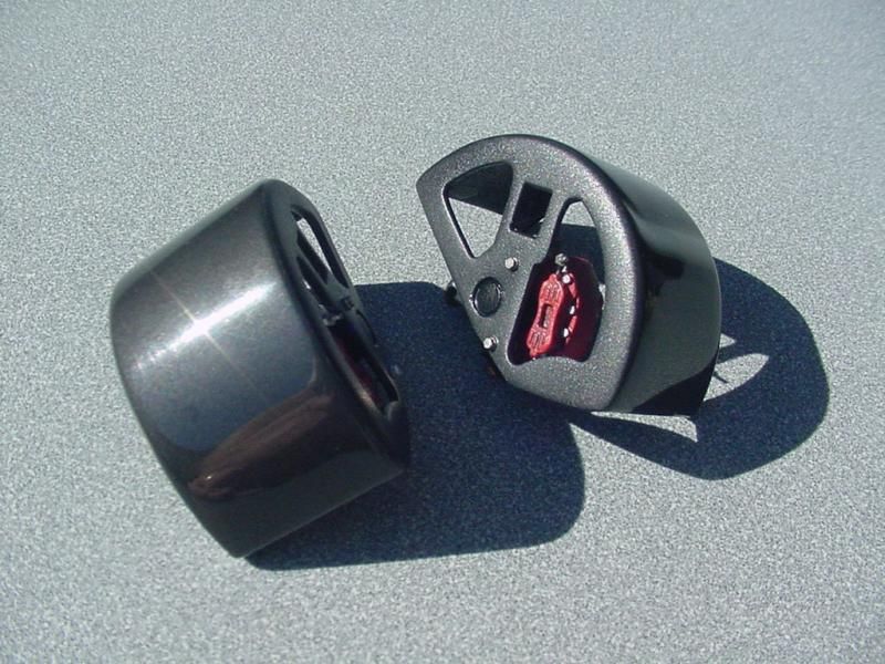

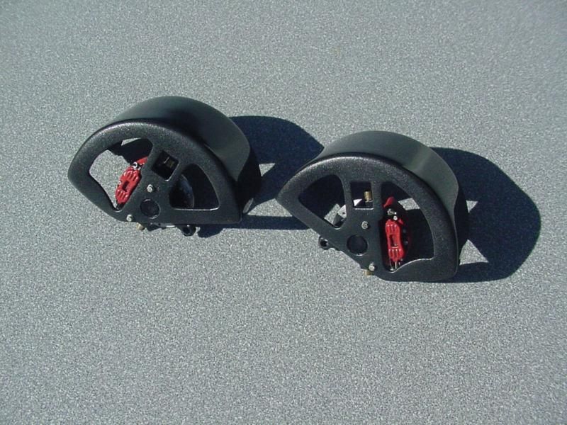

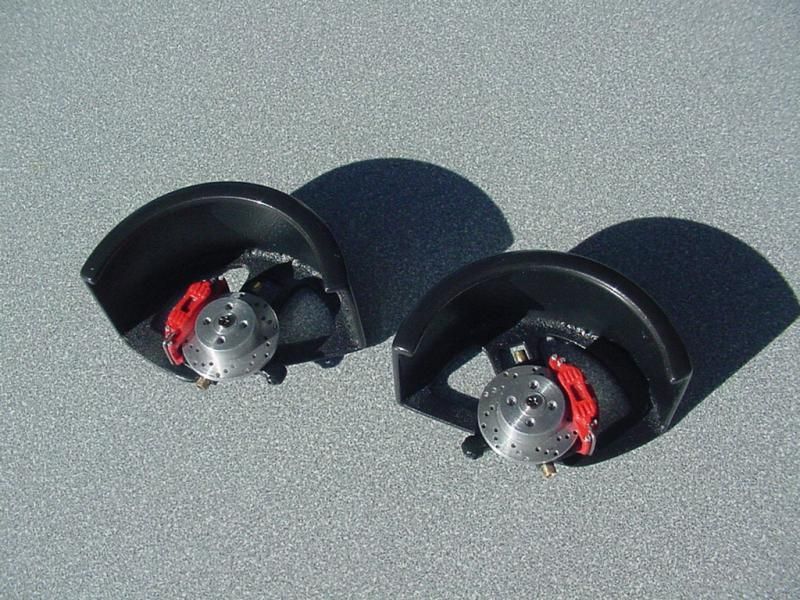

The front fenders have been finished with a rubberized paint on the inboard sides and mounted to the spindle/brake assemblies. Ready to install onto the suspension arms…
