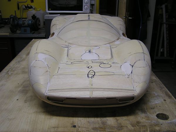

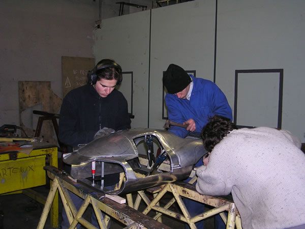

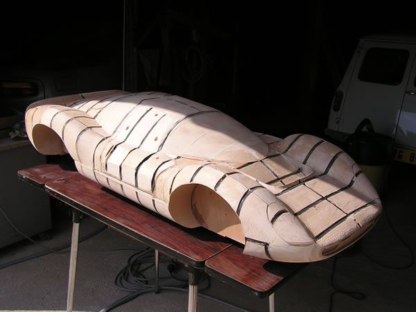

Ognib Posted May 4, 2013 Author Posted May 4, 2013 (edited) The ultimate in realism. Ferrari with running engine & functioning drive train. His name is Pierre Scerri. I believe the scale he builds in is 1:3. Here's an aluminum body shell for a 250 GTO he's doing. Can still identify where the seams are welded & being metal finished. This personifies the level of realism I am aspiring to here. Edited May 4, 2013 by Ognib

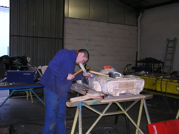

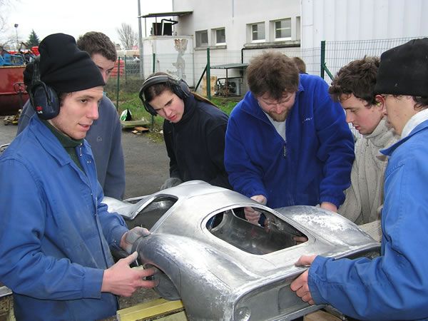

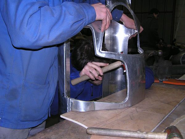

Ognib Posted May 5, 2013 Author Posted May 5, 2013 (edited) Old school coachwork going on here. Edited May 5, 2013 by Ognib

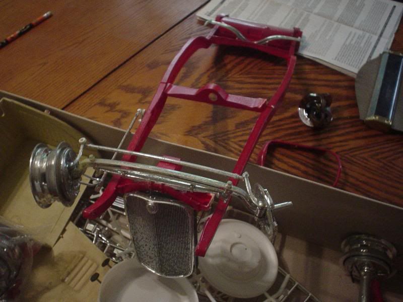

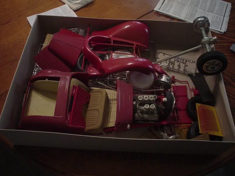

Ognib Posted May 8, 2013 Author Posted May 8, 2013 (edited) I attended my first meeting of the KC slammers modeling club last evening. Thanks to Bill Davis for inviting me. During the course of the evening I was introduced to a guy who has been in the hobby for 30ish yrs, I think he said, & is very into 1:8 deuces. He invited me to his home afterwards & showed me his very extensive collection of finished pieces & works in progress. Gave me a great deal on a 1:8 deuce kit to help me jump start my project.. So now I have all the parts to measure for working drawings & pulling templates for bucks over which to form the sheet metal panels on my build. I'll get some pics up later. Edited May 8, 2013 by Ognib

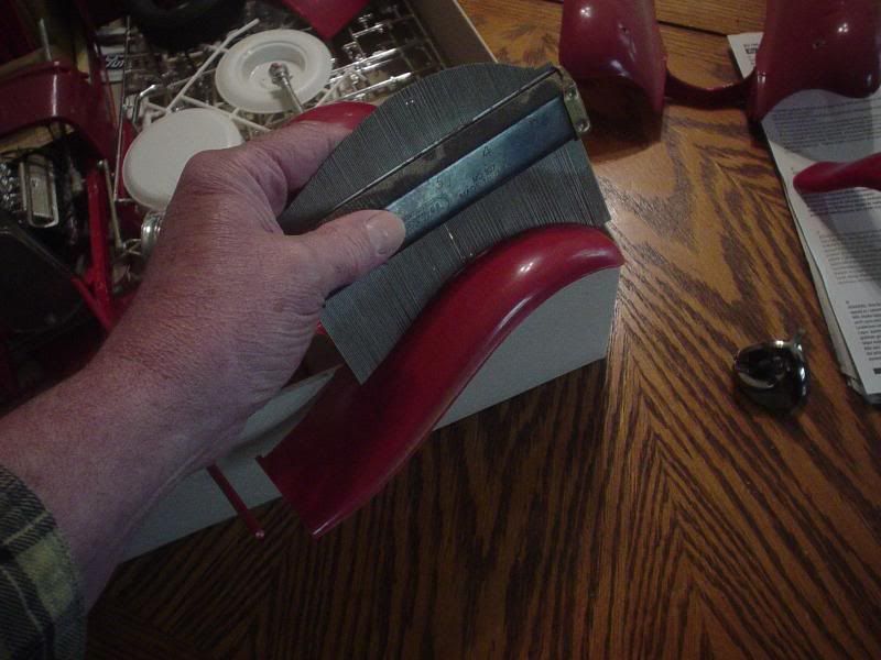

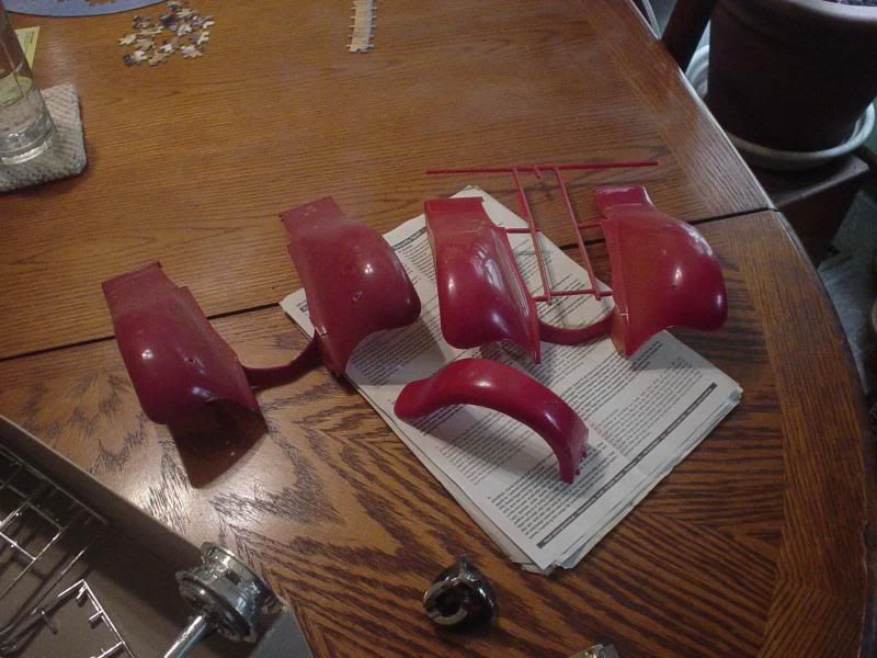

Ognib Posted May 8, 2013 Author Posted May 8, 2013 (edited) Extra set of front fenders as well as a spare rt rear. Contour guage will be used to pull shapes from model parts & transferred to 1/8 underlayment plywood & this used for shaping the panel bucks. Going to need a longer guage. Could be a barn find, all dusty & crusty looking. My first focus is to gently disassemble the frame for access to the crossmembers for measuring etc for build drawings. A couple of the old glue joints have come apart already, so hoping I can get this done with no damage. On 5/8/2013 at 2:06 PM, Danno said: Mindbending. Good luck with the project; will be watching! Thanks, Danno. Edited May 8, 2013 by Ognib
