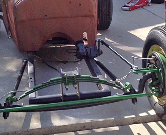

Harry P. Posted July 14, 2013 Posted July 14, 2013 Well, in real life a very common way to lower the front end on a car of this era is to fabricate a "suicide" style front spring mount. The spring mount is raised up higher than the original mounting position, so in effect the front end of the car sits lower. The front axle and spring doesn't have to be modified at all... the raised spring mount is what gives you the lowered front end...so you'd actually not be cutting the chassis, but adding onto it (the new spring mount). This model of mine has the front end spring done that way: As you can see, the top of the arch of the front spring is now located several scale inches above the front crossmember, vs. being mounted under the front crossmember in the stock position. That results in the front of the chassis sitting a few scale inches lower than it would have if the front spring were mounted in the stock position under the front crossmember. The raised spring mount is simply an upside-down "L" shape, the vertical part of the "L" would be welded (glued, in our case) to the front crossmember, and the horizontal leg of the "L" is what the spring gets bolted to via U-bolts that surround the front spring.
Harry P. Posted July 14, 2013 Posted July 14, 2013 Here's a real one... On the Lindberg kit you'd have to cut away the mounting bracket that's molded onto the front spring, but that's an easy enough thing to do. Then scratchbuild your "suicide" spring mount using sheet styrene and you'll have that lowered front end you're looking for. Of course, the stock "wishbone" (that V-shaped bar that connects from the transmission to the front axle and serves to hold the axle at a solid 90 degree angle to the chassis) probably won't work with the suicide axle, as the frame rails would get in the way. You would have to substitute radius rods (like those in the photo above) to hold the axle perpendicular to the frame and keep it from twisting.
