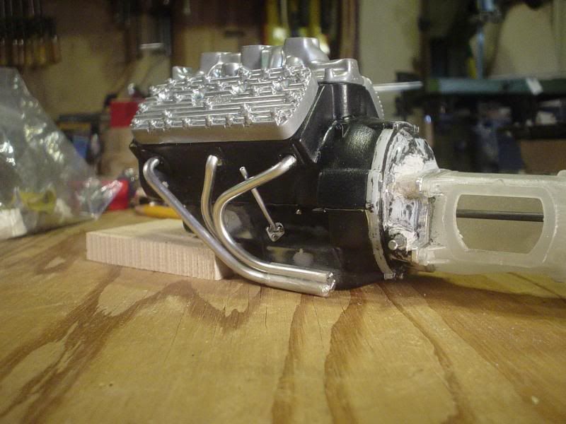

Ognib Posted July 12, 2013 Posted July 12, 2013 (edited) The casting texture can be seen on the back of the engine while the bellhousing is smooth. Any tips for adding a realistic casting texture to the bellhousing so it will visually match the engine? Edited July 12, 2013 by Ognib
Steven Zimmerman Posted July 12, 2013 Posted July 12, 2013 There are a couple ways to simulate this. One is to use "Faux Fabric" paint, and then paint over it with your chosen color. Another is to prime, then paint it with 'overspray', holding the can of paint at arms length and 'spritzing' the part with short bursts of paint until you get your desired result, then painting your color of choice. Another is to use hairspray, using the spritz method. I know there are other techniques, but these have worked for me.....'Z'
Ace-Garageguy Posted July 12, 2013 Posted July 12, 2013 Steven's advice is right-on. Personally, I've been able to achieve a variety of textures by simply misting paint on from various distances.
Harry P. Posted July 12, 2013 Posted July 12, 2013 The Faux-Fabric paint is foolproof, the "misting from a distance" method works too... but it's a bit hit or miss. It might take a few coats shot from various distances until you get the exact look you want.
Ognib Posted July 12, 2013 Author Posted July 12, 2013 Thanks everyone! Guess I'll be heading to hobby lobby for som faux-fabric paint & give it a try...I like foolproof methods.

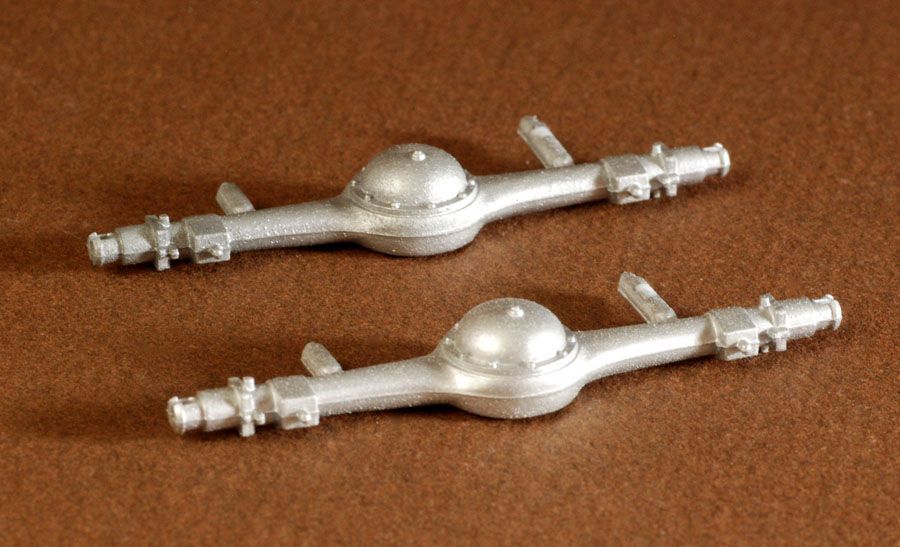

Foxer Posted July 20, 2013 Posted July 20, 2013 This thread got me to try some paints I had for texturing. The top rear end in the photo is Dupli-Color Textured Metallic Coating. The left side of the axle is the natural color and the right has a coat of Aluminum Plate Metalizer. The lower one has Rust-Oleum Textured Fine Textured Finish which is White. It too had a coat of Aluminum Plate Metalizer. Both gave similar texture which was pretty much to scale for 1/25 parts and I'll be using these in the future.
