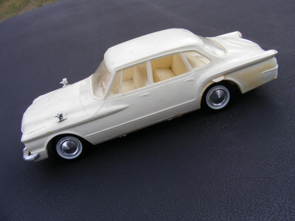

Porscheman gave me this worked over R&R 1960 Valiant wagon body and interior at my club meeting last weekend. It looks okay but...
Some numpty did a number on it, doing who knows what. It was built poorly to begin with, no prep at all and painted blue right on top of the resin. Wheel wells sanded flat, body sculpture lines ruined and all the drip molding gone from the drivers side. Then he stopped! I already have an R&R '60 wagon so it wasn't worth attempting to restore that. I thought about turning it into a sedan delivery, but the sanded body side ended that. Then I got an idea. (Like I needed another project)
Enter one Revell glitter metallic 1962 Valiant that has seen much better days. Assembled without any paint and junk glued all over it. I bought it many years ago for $5 so it was time to do something with it. Note that I did strip the blue paint off the wagon prior to cutting.
The first generation Valiants went from 1960 to 1962 and shared the same body. SMP did the 1960 that the wagon was based on, while the '62 is a Revell kit. The glitter thing was Jim Keelers brainstorm on how to sell kits in a second mid-year run. They did it once. As you can see, the big difference, aside from trim, between the cars is the tail lights. I did a ton of measurement checks and the two cars lined up very nicely for kits from different manufacturers back in the dark ages. So I started cutting...
I didn't take any progress shots, but this wasn't an easy task. The Revell car pretty much has the characteristic of cutting clear plastic windshields. So it was prone to shatter, which it did a couple of times. Then I started cutting the resin which was soft but brittle and yea, I fixed a few cracks on that side too. I went slow and took off a little material at a time. I finally got it all cut and set and it fit like it was made for it. All the posts lined up and everything fit pretty well.
Here's the two wagons together. I guess I'm going to need to build both of them to display together.
And an 'up on wheels' shot. I still have a lot of trim to add with round stock, but I'm well practiced on that. And there will no doubt be a bunch of clean up from the junk that was originally glued to our '62. And the good news is that the '62 has an open hood and a slant six engine.
I am very pleased with the results of my afternoon!
